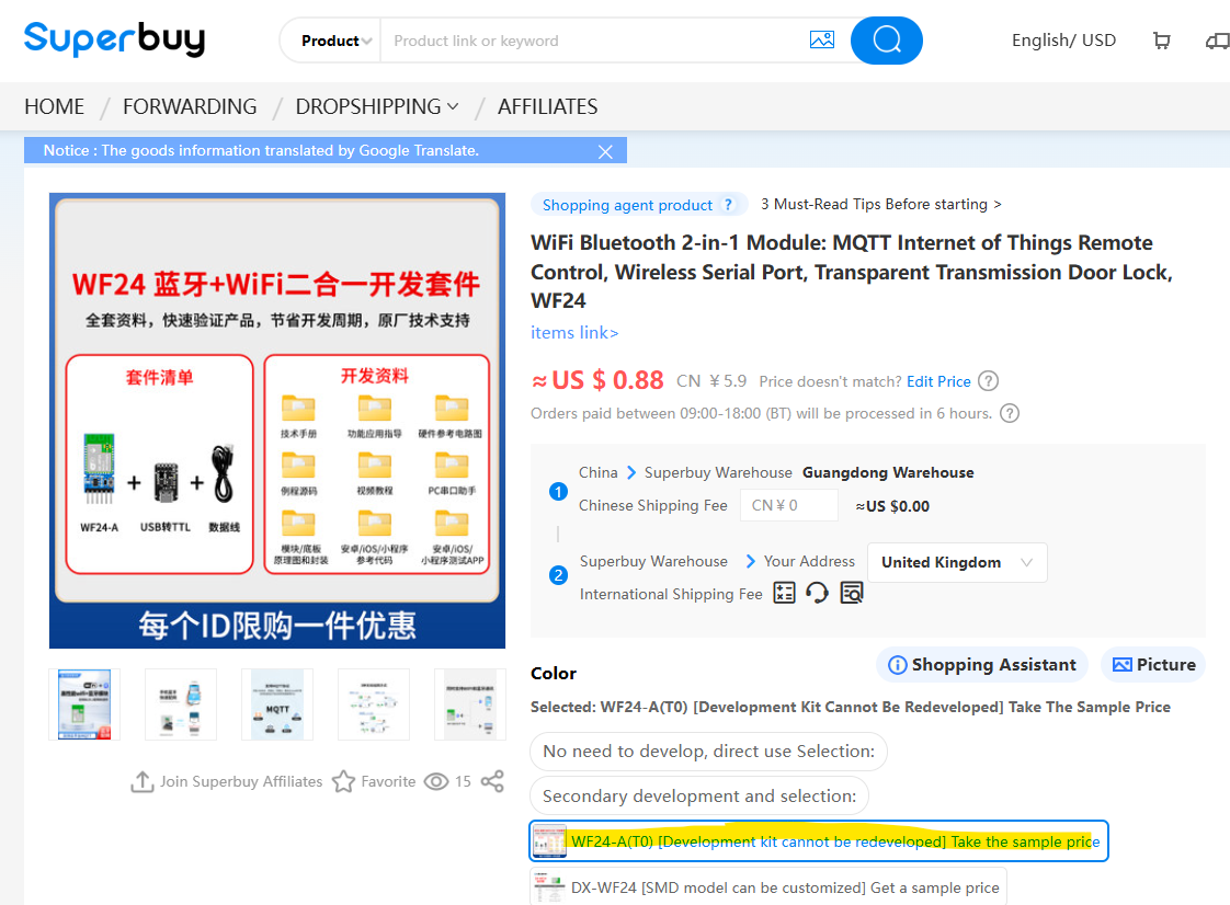

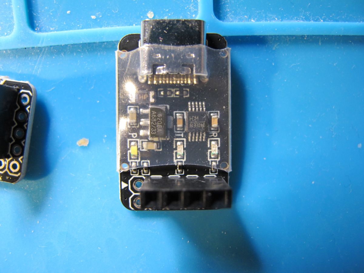

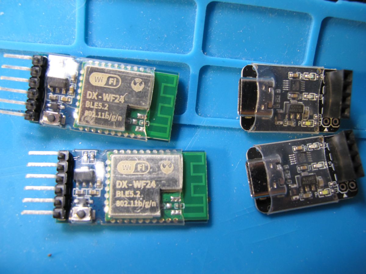

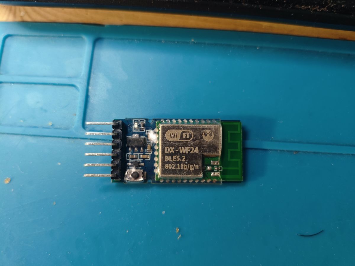

    Forgot I'd added these to an order of bits from Superbuy/Taobao just to see what they were and came with on their flash. Here's some info should anyone be looking for detail about these and come across this post. Maybe useful.
    https://item.taobao.com/item.htm?id=763512256407
    DX-Smart BK7238 DX-WF24A Module with DX-PJ16-V1.1 CH340 USB-TTL from Taobao/Superbuy
    http://en.szdx-smart.com/EN/cs2/117.html
    DX-Smart BK7238 DX-WF24A modules on tiny break-out boards. This particular bundle includes short USB-C cable and the DX-PJ16-V1.1 USB-TTL with the WinChipHead CH340.
    Pics

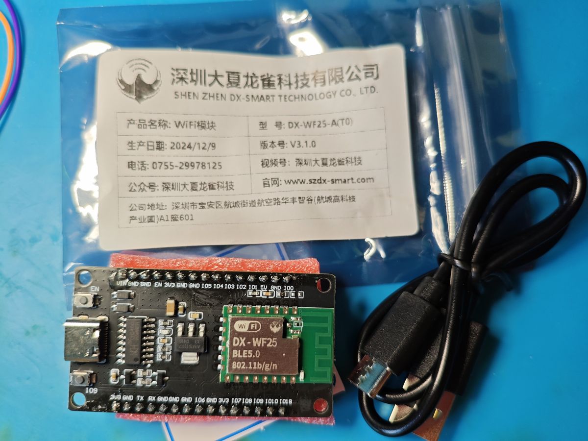

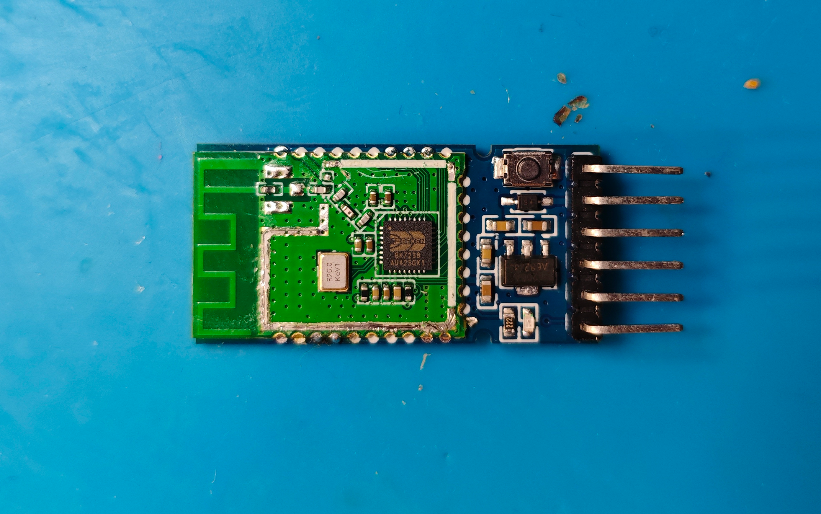

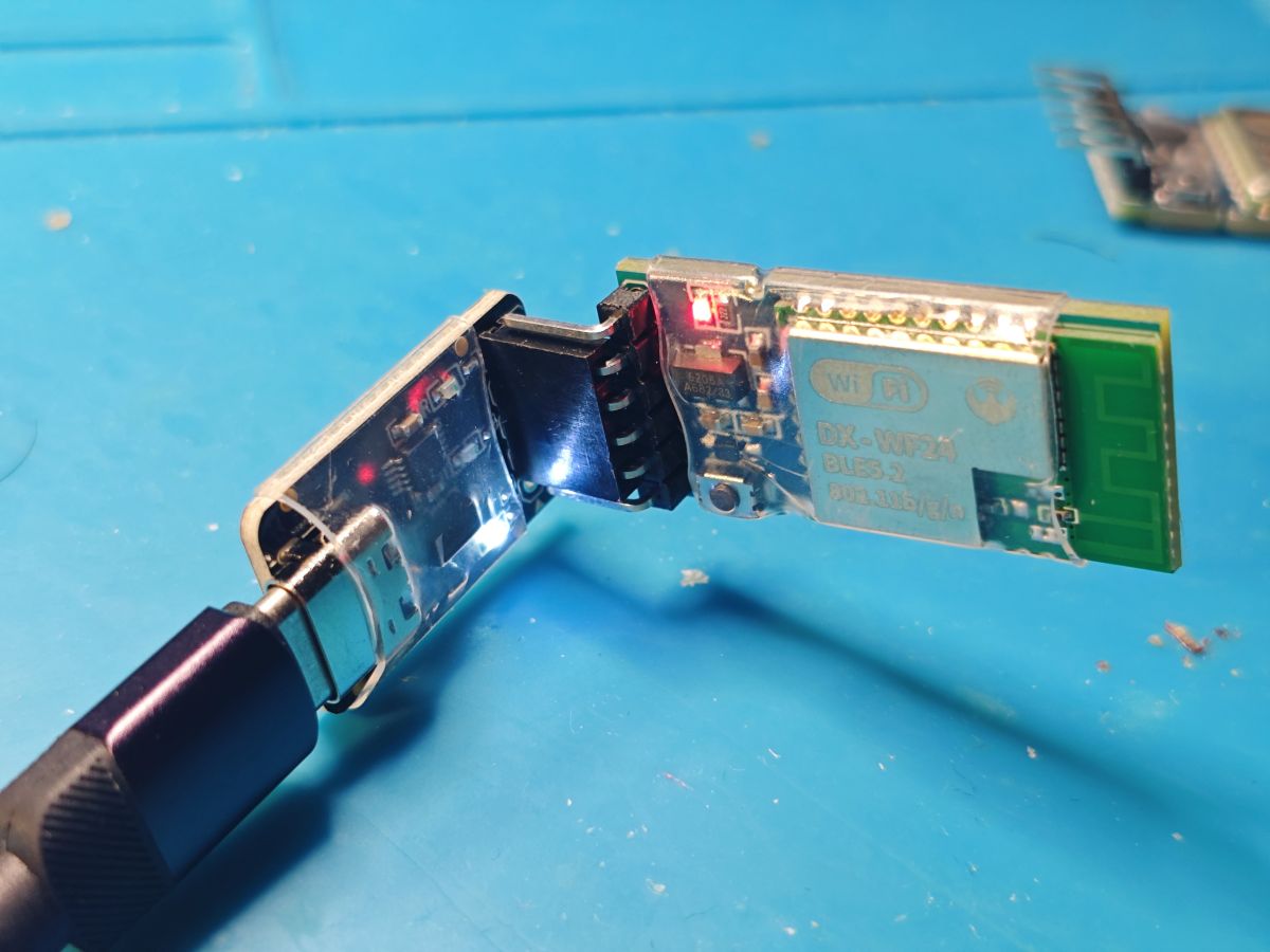

    DX-Smart BK7238 DX-WF24A Module with DX-PJ16-V1.1 CH340 USB-TTL from Taobao/Superbuy Two DX-WF24 BLE5.2 modules and two USB-TTL converters on a blue work surface. DX-WF24A module with BK7238 chip on a breakout board, placed on a blue service mat. Electronic module with connectors and SMD components on a blue service mat. HC-05 Bluetooth electronic module with labeled pins on a blue PCB. Two DX-PJ15-V1.1 electronic modules on a blue service mat. Bluetooth BLE module connected to a USB adapter on a blue background.

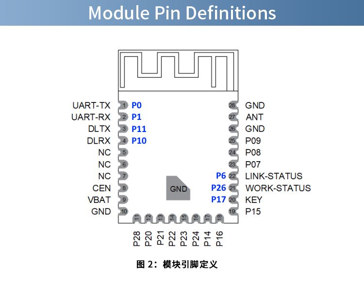

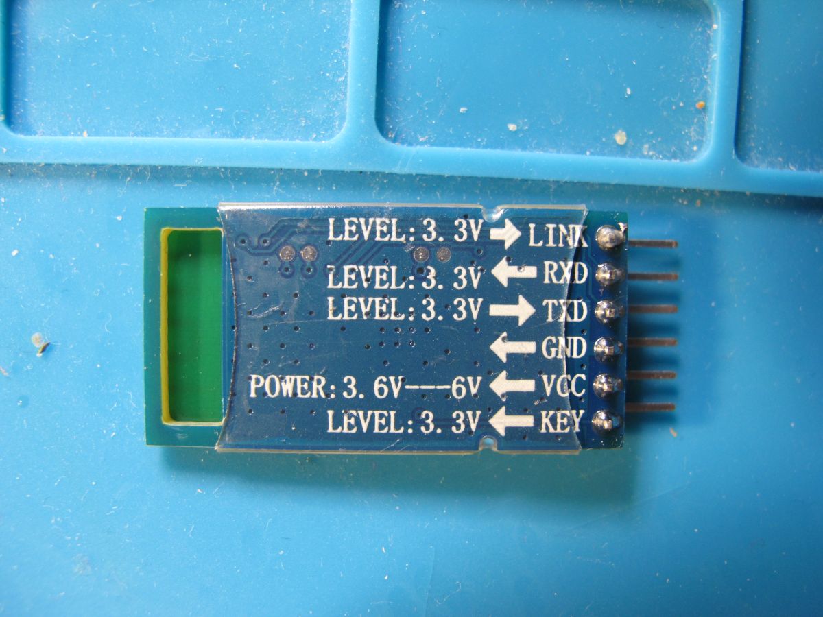

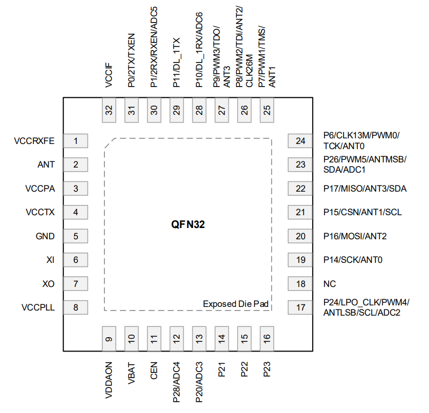

    The RX/TX headers on the DX-PJ16-V1.1 are not for programming - they trace to UART-TX (P0) and UART-RX (P1) - pins 1 & 2. Meaning P10/P11 need soldering up to read/write flash.
    After shield removal I can confirm it is the QFN32 BK7238
    Bluetooth electronic module with connection pins on a blue background.
    QFN32 integrated circuit pinout diagram with labeled pin functions.

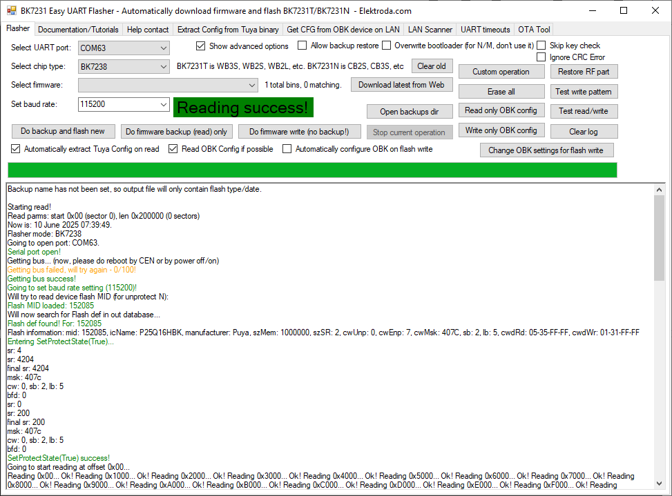

    dump with BKFIL
    https://github.com/openshwprojects/FlashDumps...mits/9ac8b34f85625ece82344a635c20ea3fa391fa22

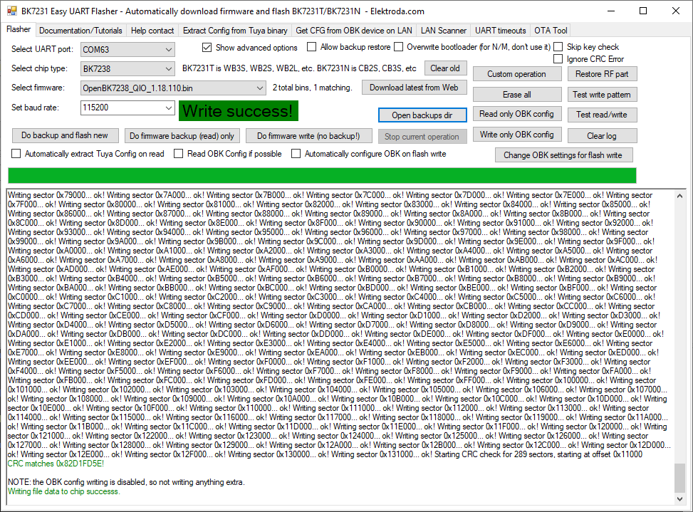

    and Easy Flasher. 2mb flash ID is 852015 - Puya P25Q16HBK
    Screenshot of the BK7231 Easy UART Flasher software showing a successful flash memory read from a BK7238 chip.
    in BK7231N mode encryption key is read as 48e16b04 48e16b04 48e16b04 48e16b04 (but note)

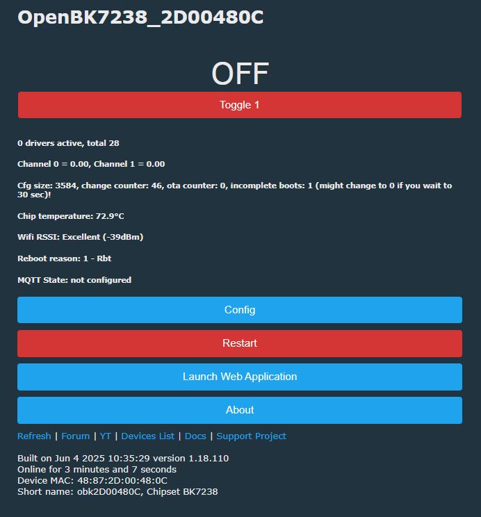

    OpenBK7238 write success from 0x11000
    Screenshot of BK7231 Easy UART Flasher software showing a successful firmware write with detailed flash sector write log.

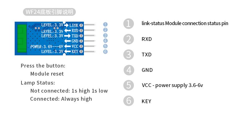

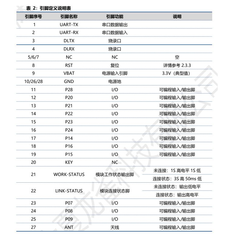

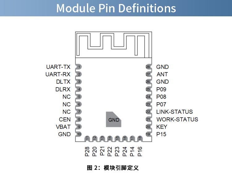

    P26 is WORK-STATUS/red LED, P17 is the KEY/button and P6 is the LINK-STATUS header
    Diagram of an electronic module with pin definitions and functions for each pin.
    Screenshot of OpenBK7238 device web interface with technical details and control buttons.
    #2 21577167
    Posts: 14755
    Rate: 12877
    So it's basically like NiceMCU. Thank you for interesting presentation! The "encryption key" mentioned is not really an encryption key, it's just a byproduct of the read disabled, I guess. I was also getting "random" keys on NiceMCU BK7238 and they all run well with unecrypted OBK.

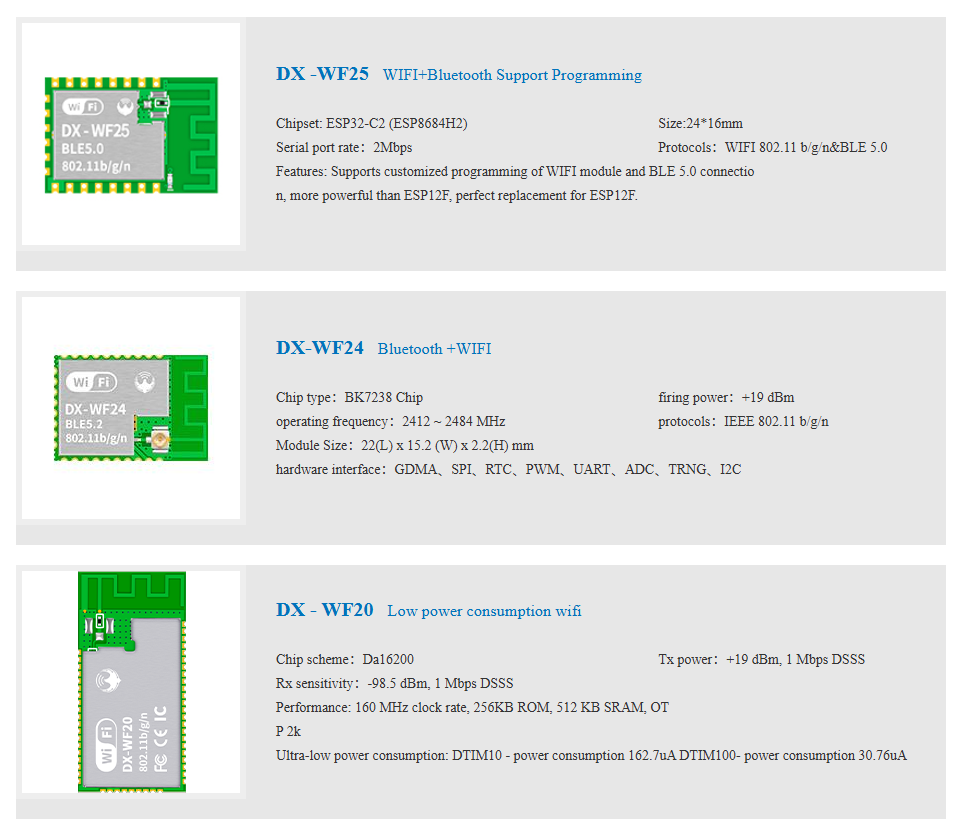

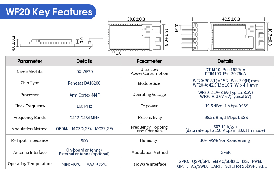

    This shop has more WiFi modules: http://en.szdx-smart.com/m/EN/WIFImk.html
    What is Da16200?
  • DA16200 identified as a Renesas Wi-Fi SoC

    What is Da16200?
    Some Renesas chip I've never heard of.
    https://www.renesas.com/en/products/wireless-...gzF16aRSi4t6eW124Gvwo3NM0BhCQ3y2tlDQ1bNRvnhNQ
    https://www.amazon.co.uk/PDDAXLQUE-Communicat...ansparent-Transmission-WF20-SET/dp/B0DT5L55KZ

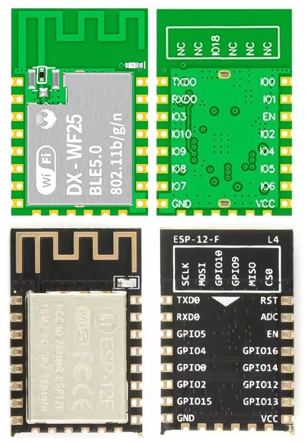

    I got the DX-WF25 ESP-C3 too, not that I needed any more ESPs

    It looks like NodeMCU clone, are the pinouts of the board/module here standarized? They call DX-WF25 a perfect replacement for ESP12E, so I would assume that at least VDD/GND/RESET/UART1 pins are matching..
  • #7 21583411
    Posts: 5209
    Help: 446
    Rate: 914
    12F* :)
    indeed

  • Need setup instructions for DX-WF24 Wi‑Fi module
    #8 21602756
    hotimothyeis124
    Hi, I got the DX-WF24 for the purpose of using the wifi. I got the USB adaptor board and plugged the module into the USB. I don't know how to set up the wifi and I don't see a user manual to set up. Any feedback on this? I don't see any option to connect it to wifi router, so I am not sure if it's defective or not (the USB insert did have a dent on it which I fixed with a plier. I can see the red flashing on the chip indicating nothing is connected to it wifi-wise.

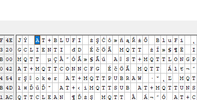

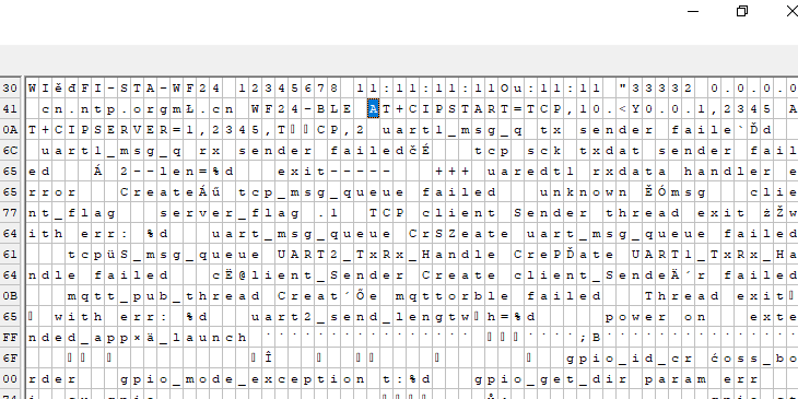

    Are you saying that you want to try it out with AT commands? Well, I don't know whether this module comes with preflashed AT package or not, maybe @divadiow knows? You still would need to connect it via USB to UART converter and try some commands over the terminal.
    Still, maybe it would be easier to use OBK, depending on what your goal is? What kind of project are you making?
  • #13 21602949
    Posts: 14755
    Rate: 12877

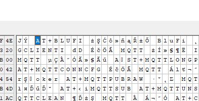

    There are some AT mentions in the binary strings.
