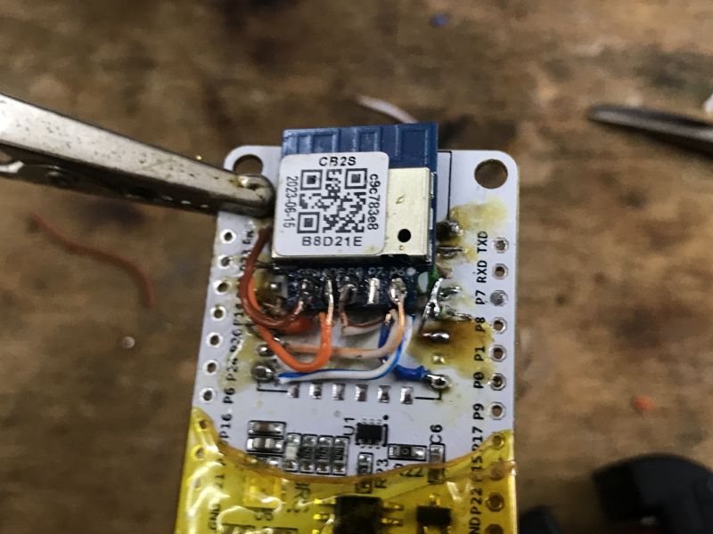

    NiceMCU_WB3S_V1 is a very cheap (possible to buy for as low as 1-2$) Beken development board. It comes with BK7238 chip, but with some soldering it's also possible to very easily swap the BK7238 module with any classic Tuya WB2S or CB2S and still get correct GPIO markings. Here I will show you how I've done it.
    The basic idea is to just get WB2S/CB2S, get some Ethernet wires and just solder the pads to their correct places, so the GPIO names on the board are correct.

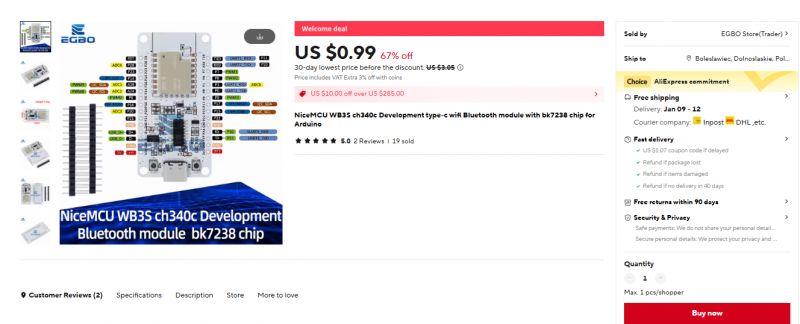

    You can get it for as low as about 1$ when you create new account:
    NiceMCU WB3S development board with BK7238 Bluetooth module, displayed on an online store page.

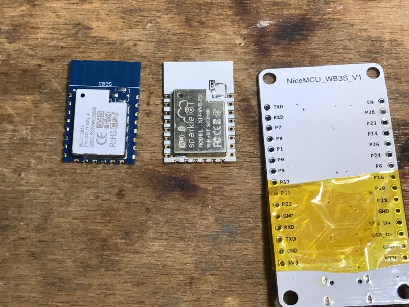

    Then you need to do a hot air BK7238 module removal, just like in my previous dev board hack (NodeMCU):

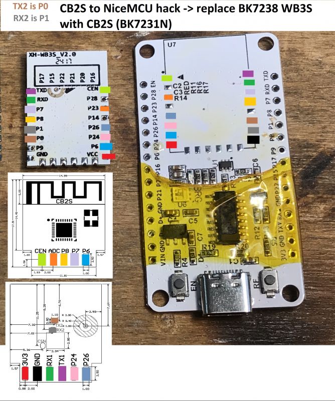

    By the way, here is pinout of BK7238 module:
    Comparison of pinouts for TUYA CB3S (BK7231N) and XH-WB3S_V2.0 (BK7238).
    Here is the other side view:
    Three different electronic modules lying on a wooden table, including NiceMCU_WB3S_V1 with visible pin labels.

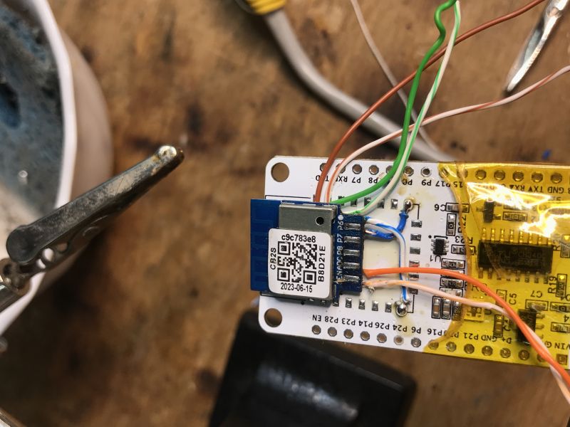

    Ok, with this information, we can just mark which pin goes where:
    NiceMCU_WB3S_V1 board with replaced CB2S module
    In this particular case, I've used BK7231M (not N) CB2S, but it does not matter, pins are the same.

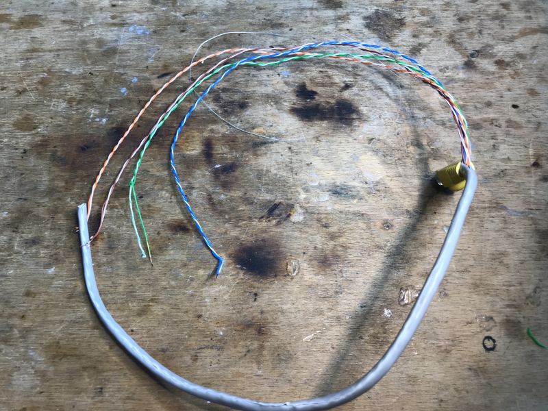

    I'm using such wires:
    Several colored Ethernet wires on a workbench.

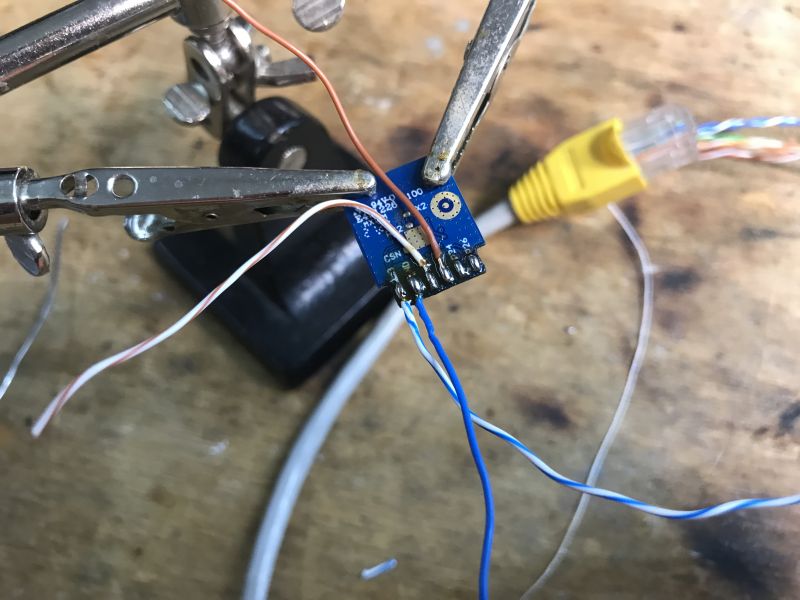

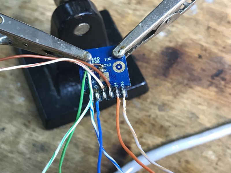

    Soldering should be very easy. Just follow the simple guidelines:
    - always keep soldering iron tip clean
    - use flux and Pb soldering iron (as it has lower melting point)
    - first apply solder separately to wire and to the pad, then solder wire to the pad
    - make sure to strip insulation from wires first
    - avoid bending wires repeatedly or they may snap
    While soldering wires, make sure to check where they should go and chose the best wire orientation:
    NiceMCU_WB3S_V1 board with soldered Ethernet wires Development board with attached Ethernet wires in a holder.

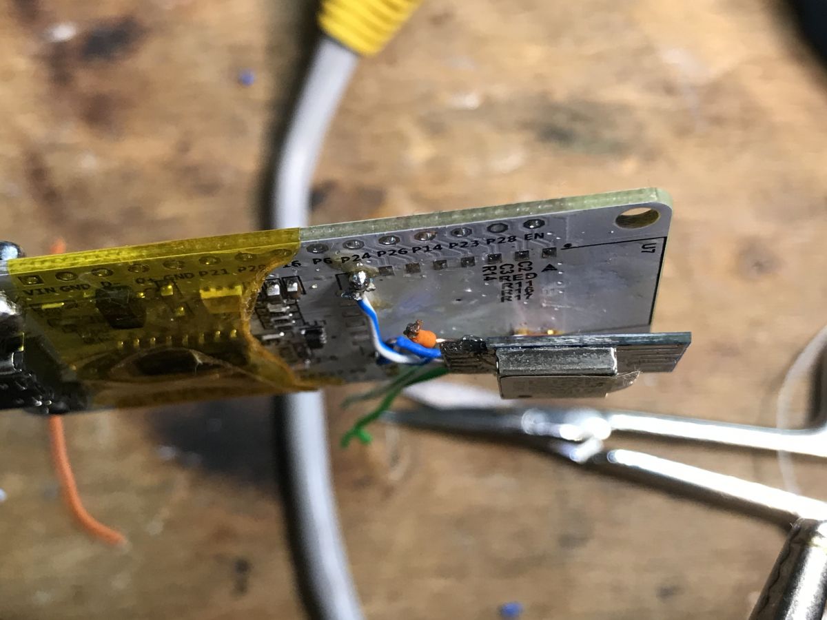

    Some little corrections:
    Close-up of NiceMCU_WB3S_V1 board with attached wires.
    Initial test with our flasher:
    Almost ready:
    Close-up of NiceMCU_WB3S_V1 board with attached CB2S module.

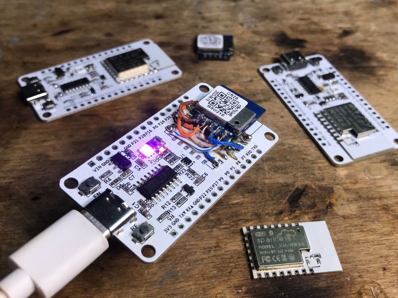

    Complete product:
    NiceMCU_WB3S_V1 board with mounted CB2S module and connected wires.
    Now all of CB2S pins (even RX2 and TX2, which are on module back) are routed to their correct places on the board. Futhermore, the onboard LED also works (PWM0 and PWM4 pins seems to control it).
    This way our new CB2S dev board is complete and it's better than NodeMCU hack because the markings on the board (like P9, P1, etc, TX, etc) are correct, so it's easier to quickly assembler a test setup with it. Now it's ready to be used for some OpenBeken development and testing.

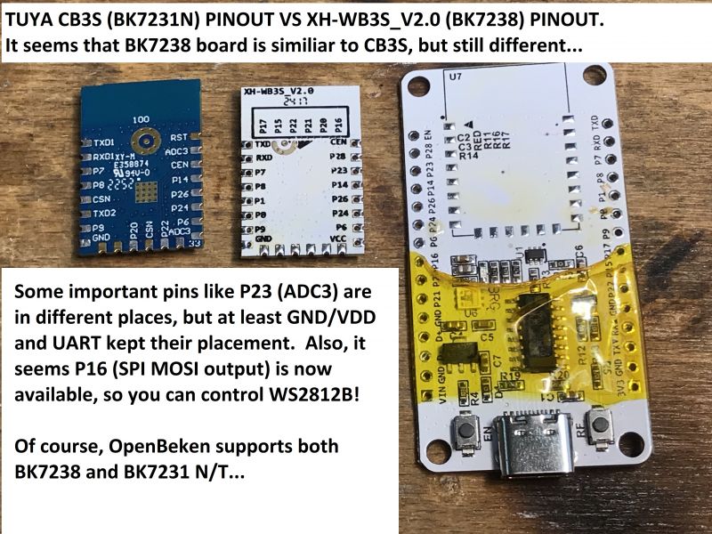

    going to do one too. Maybe CB3S. Fluxed, 63/37 pb solder to help lower melting point on each pad then air gun remove
    CB3S microcontroller board mounted in a service holder.Circuit board with a soldered electronic module and a holding clip.PCB with a micro USB port and marked components for soldering.
  • #8 21402379
    Posts: 14754
    Rate: 12875
    Keep in mind that CB3S pinout is not exactly the same a BK7238 WB3S version (which is also not the same as BK7231 WB3S), so you might need to cross out some IO markings or just remember they may be misleading.
