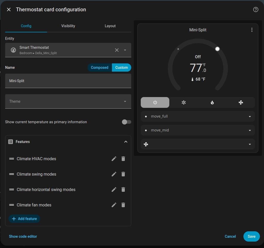

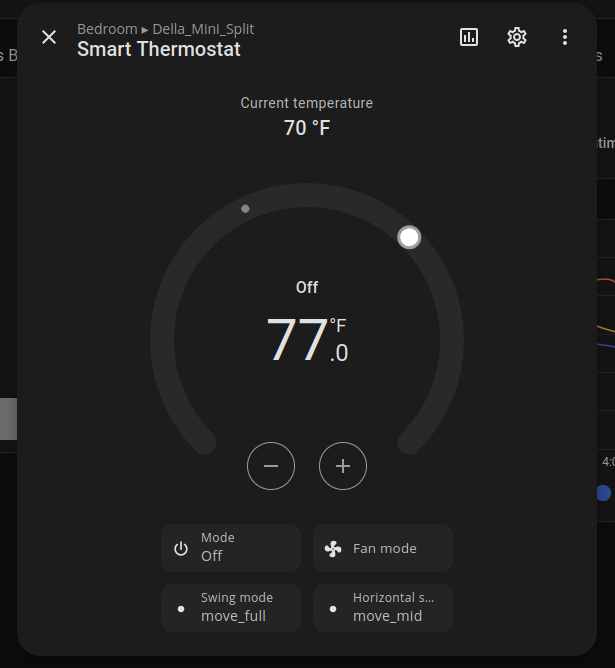

  • The system runs on 115V, 60Hz, carries a SEER2 rating of 23, and the flashing path targets RTL87X0C firmware with a 3.3 V UART setup.
  • OpenBeken installation enables local Wi-Fi control and Home Assistant MQTT integration, but removing the RF shield damaged the WBR3 pads and a replacement module was hard to source.

    Great work @dressyspider! I have 6 of these units and a couple of spare dongles. I see some flashing in my future.
    Question: I read that as soon as the new mqtt device is discovered, a new climate entity is created. In my experience, the HA climate entity is lacking controls like vertical and horizontal vane control. Have you been able to control those in HA and, if so, how? Is it an mqtt topic that gets exposed? Can you share your control card?
    Jeff
  • OpenBeken supports vertical and horizontal vane swing
    #3 21883903
    dressyspider
    Posts: 83
    Rate: 10
    >>21652284
    Sorry for the delayed response! Yes, you can control the vertical and horizontal vane swing. You can add them as "features" on the thermostat card to keep them readily accessible, or access them via the 3-dot menu in the top-right corner of the card when you're not in edit mode.
    [WIP] Della Mini Split TCWBRCU1 Wi-Fi Module Disassembly and Flashing Guide with OpenBeken [WIP] Della Mini Split TCWBRCU1 Wi-Fi Module Disassembly and Flashing Guide with OpenBeken
