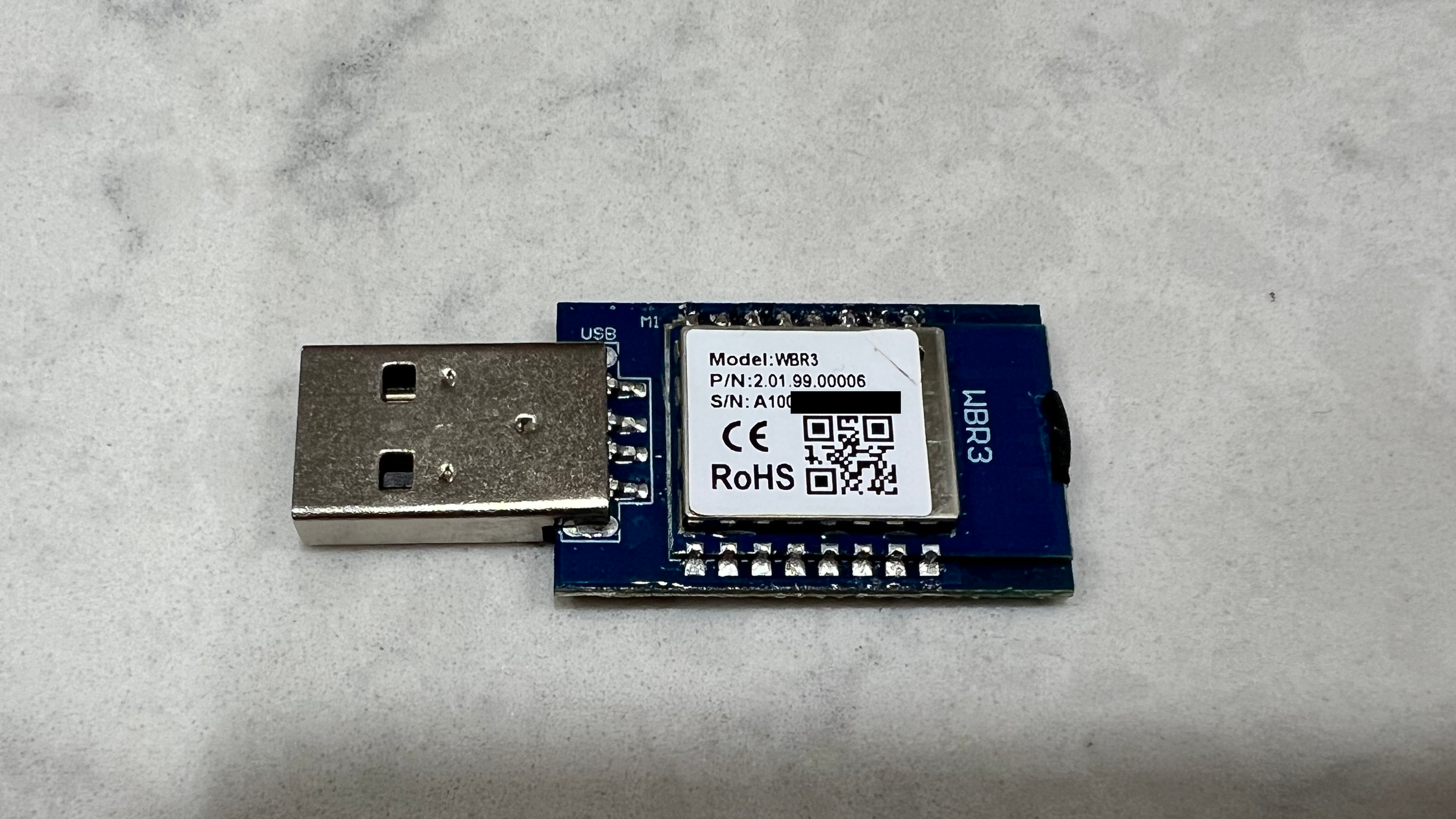

    TCWBRCU1_V1.0.0 & WBR3 Images
    Top view of the left WBR3 pins while still soldered to TCWBRCU1.
    Tuya WBR3 WiFi module on PCB with USB connector, top view, on a light surface.
    Top view of the right WNR3 pins while still soldered to the TCWBRCU1.
    Tuya WBR3 WiFi module with USB connector, top view showing label with model and serial number.
    Bottom view of the TCWBRCU1 while WBR3 is still soldered.
    Blue PCB with electronic components and a white QR code sticker.
    Closer image of the bottom view. I am fairly certain these are pass through holes to the WBR3 flashing pins. According to the datasheet, these should be pins A_0, A_1 and A_15.
    Blue printed circuit board with electronic components, labels, and a QR code.

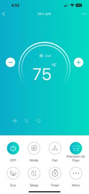

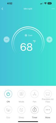

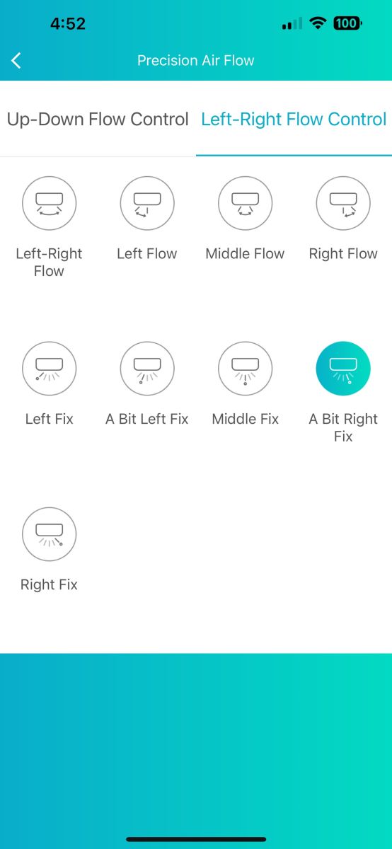

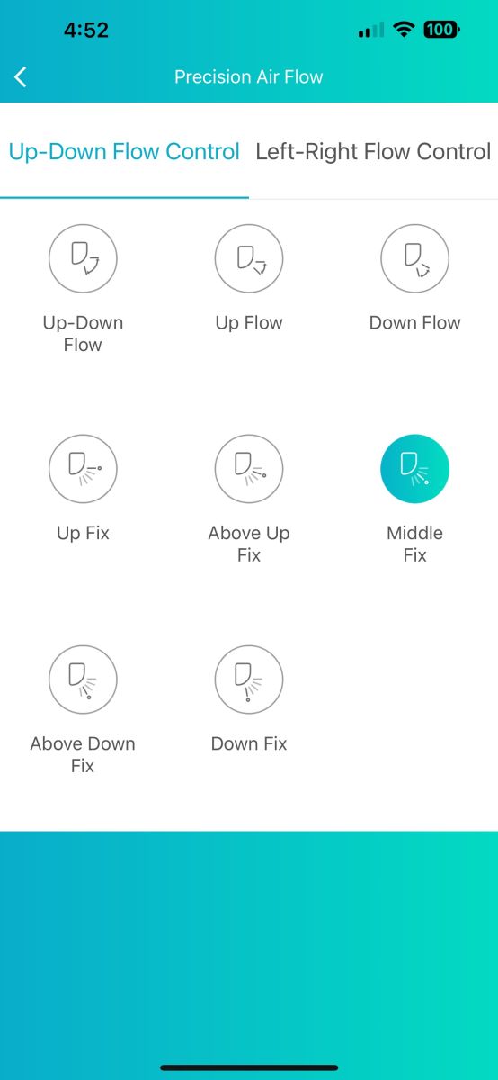

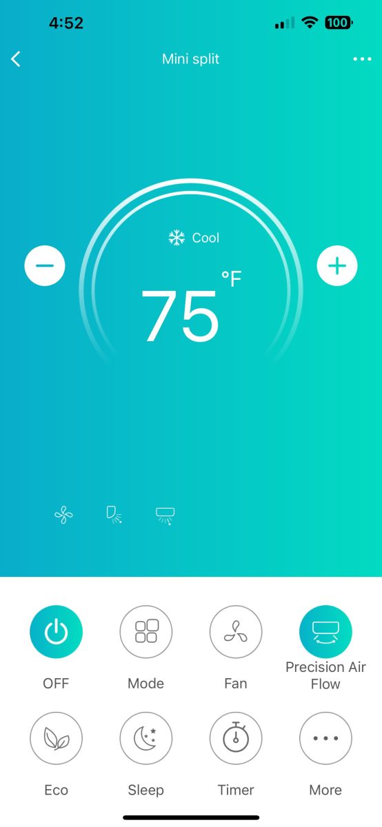

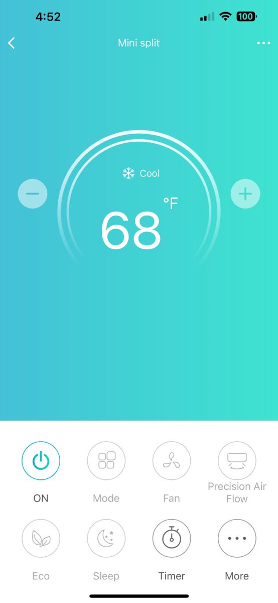

    The following datapoints were collected during my initial testing:
    Collected Datapoints via Tuya IoT Platform Website
    DPIDKeyNameTypeUnitRWRange/Notes
    1Power开关booltrue
    2temp_set设置温度valuetrue
    3temp_current当前温度valuefalse
    4mode工作模式enumtruecold, hot, wet, wind, auto
    5windspeed风速enumtruestrong, high, mid_high, mid, mid_low, low, mute, auto
    18humidity_current当前湿度value%true
    19temp_unit_convert温标切换enumtruec, f
    20Fault故障告警bitmapfalse
    23temp_current_f当前温度 ℉valuefalse
    24temp_set_f温度设置 ℉valuetrue
    101pm25PM2.5valuefalse
    102fresh_air新风enumtrueauto, low, mid, strong, off
    103freshair_filter新风脏堵boolfalse
    104SN_SW_verSN及软件版本rawfalse
    105sleep睡眠enumtrueoff, normal, old, child
    110markbit标识位bitmapfalse
    113up_down_sweep上下扫风enumtrue0, 1, 2, 3
    114left_right_sweep左右扫风enumtrue0, 1, 2, 3, 4, 5, 6, 7
    115totalN电量整数valuefalse
    116totalP电量小数valuefalse
    119money省钱看的见enumtrue0, 1, 2, 3
    120energy发电机模式enumtrueoff, L1, L2, L3
    122fault2故障报警2bitmapfalse
    123boolCode布尔型stringtrue
    125airquality空气质量enumfalsegreat, good, middle, bad, verybad, veryverybad

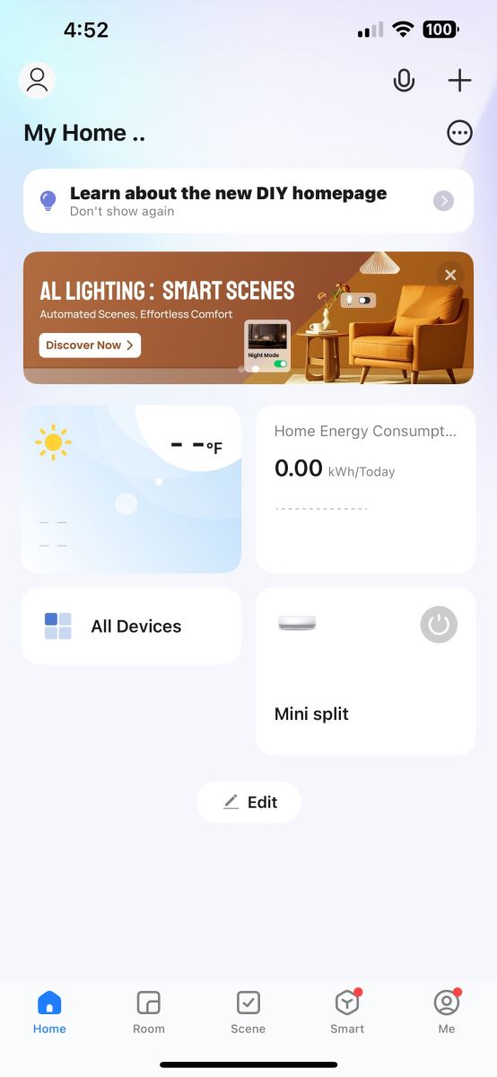

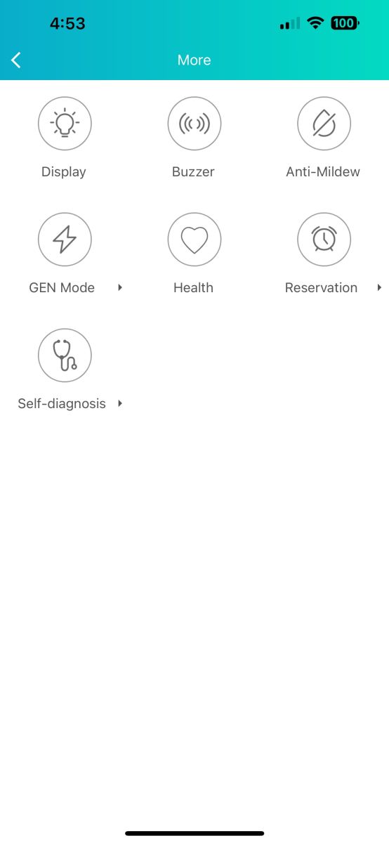

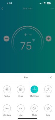

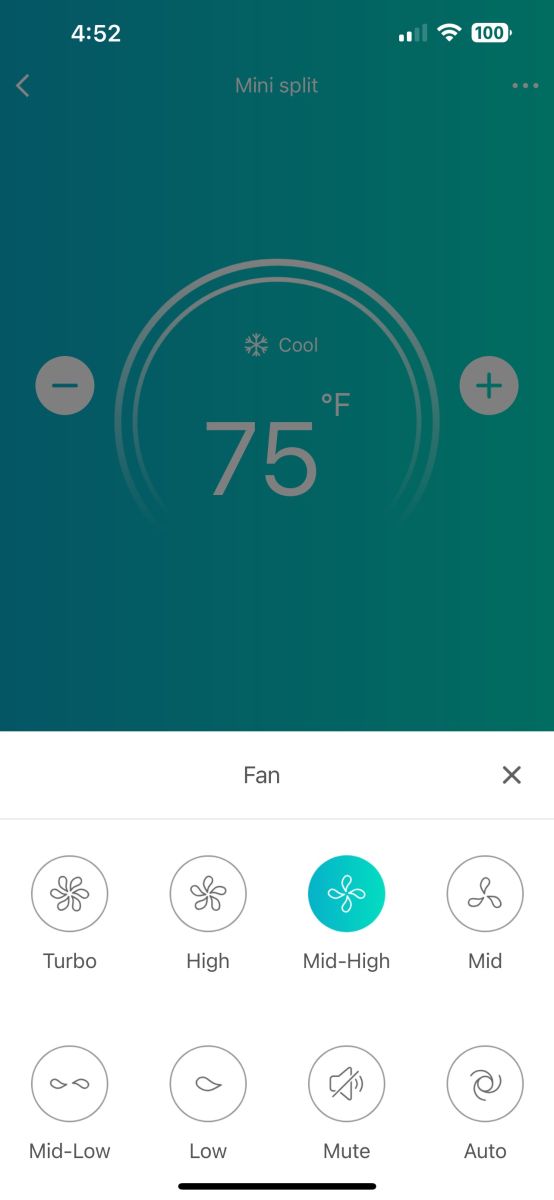

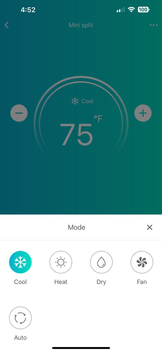

    Smart Life Application Screenshots
    Main screen of a smart home management app with device control options visible. Air conditioner control app screen showing 68°F cooling mode. Screen of an air conditioner control app, set to 75°F and cooling mode selected. Air conditioner control app screen set to cooling mode, temperature 75°F. Air conditioner control app screen set to 75°F in cooling mode, with fan mode Mid-High selected. Screen of an air conditioner app for controlling up-down air flow direction with various selectable modes. App screen for air conditioner's horizontal airflow control with multiple direction options. Mobile app screen with icons for functions: display, buzzer, anti-mildew, GEN mode, health, reservation, and self-diagnosis.
    Edit: Added Smart Life App screenshot images.

    I was able to:
    - De-solder the WBR3 module from the TCWBRCU1 module, but lifting GND pad in the process
    - Repair lifted GND pad
    - Scratch the bus line for A_0 and solder a line to it
    - Solder all points to communicate with UART cable
    - Connect soldered points and UART adapter leads to a breadboard via dupont cables
    As I was unplugging the EN cable on the breadboard, the A_16 pad lifted from the WBR3. This time I could not repair the lift. These module boards are very fragile and/or I am very out of practice.

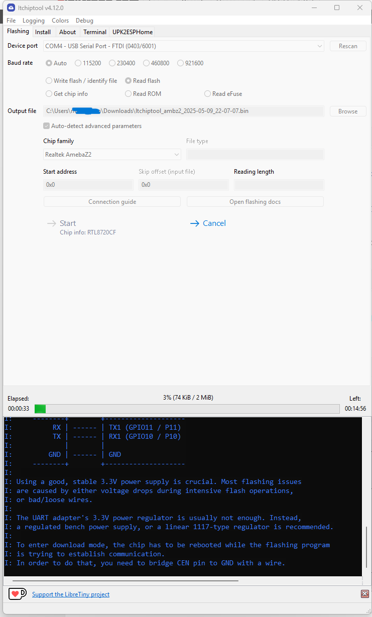

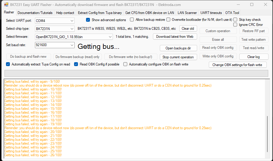

  • #14 21544721
    dressyspider
    Posts: 83
    Rate: 10

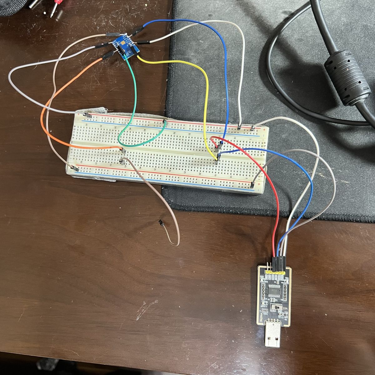

    @p.kaczmarek2 I was able to desolder the new WBR3. I have it connected to a UART adapter, but am not able to get past the "getting bus" message in BK7231 flash tool. Can you take a look at my wiring and let me know if you see anything obviously wrong?
    -This is what I have done after wiring everything up:
    -Verified it's COM4.
    -Tried the other preset baud rates.
    -Shorted EN to GND after clicking "Do firmware backup 'read' only". (I have also tried removing power from VCC on the WBR3 with the same timing)
    Breadboard with connected wires, electronic module, and USB programmer.
    Screenshot of the BK7231 Easy UART Flasher program showing connection bus failure errors.
  • #15 21544726
    Posts: 5106
    Help: 441
    Rate: 902
    Easy Flasher does not backup from or write to any Realtek chips. AmebaZ2 backups should be taken with ltchiptool for now and writing can be performed with AmebaZ2 PG Tool
    see https://www.elektroda.com/rtvforum/topic4097185.html for flashing. Tool downloadable from https://github.com/openshwprojects/FlashTools/blob/main/Realtek/AmebaZII_PGTool_v1.2.47.exe
    Please also backup and share the new module flash, it may contain interesting testing firmware.

    >>21544726 Sweet, Thank you. I will try now. Also, I was planning on sharing the dump and creating a separate teardown for anyone else with the same/similar mini split models. :)
    Edit: Looks like it's backing up.
    Screenshot of ltchiptool v4.12.0 reading flash memory from a Realtek AmebaZ2 chip via serial port.
    Added after 56 [minutes]:
    @p.kaczmarek2 @divadiow
    Do these files look correct? One is from choosing the "Read Flash" option and the other if from choosing "Read ROM".
    • ltchiptool_ambz2_2025-05-09_22-07-07.bin (2 MB) You must be logged in to download this attachment.
    • ltchiptool_ambz2_2025-05-09_22-23-55_rom.bin (384 KB) You must be logged in to download this attachment.

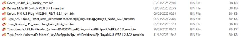

  • #17 21544743
    Posts: 5106
    Help: 441
    Rate: 902

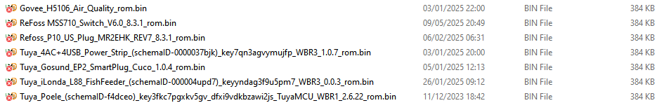

    yes, the rom should be 384kb
    A list of IoT device ROM BIN files, each with a size of 384 KB.
    and your 2mb backup does boot

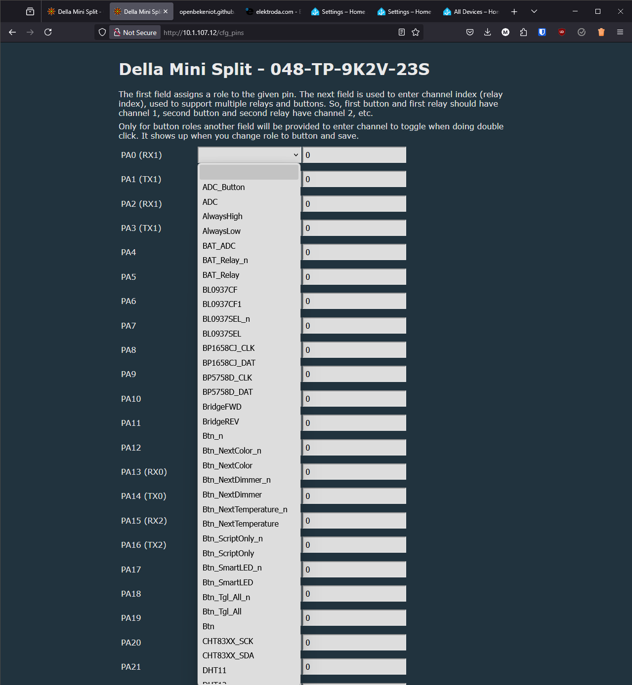

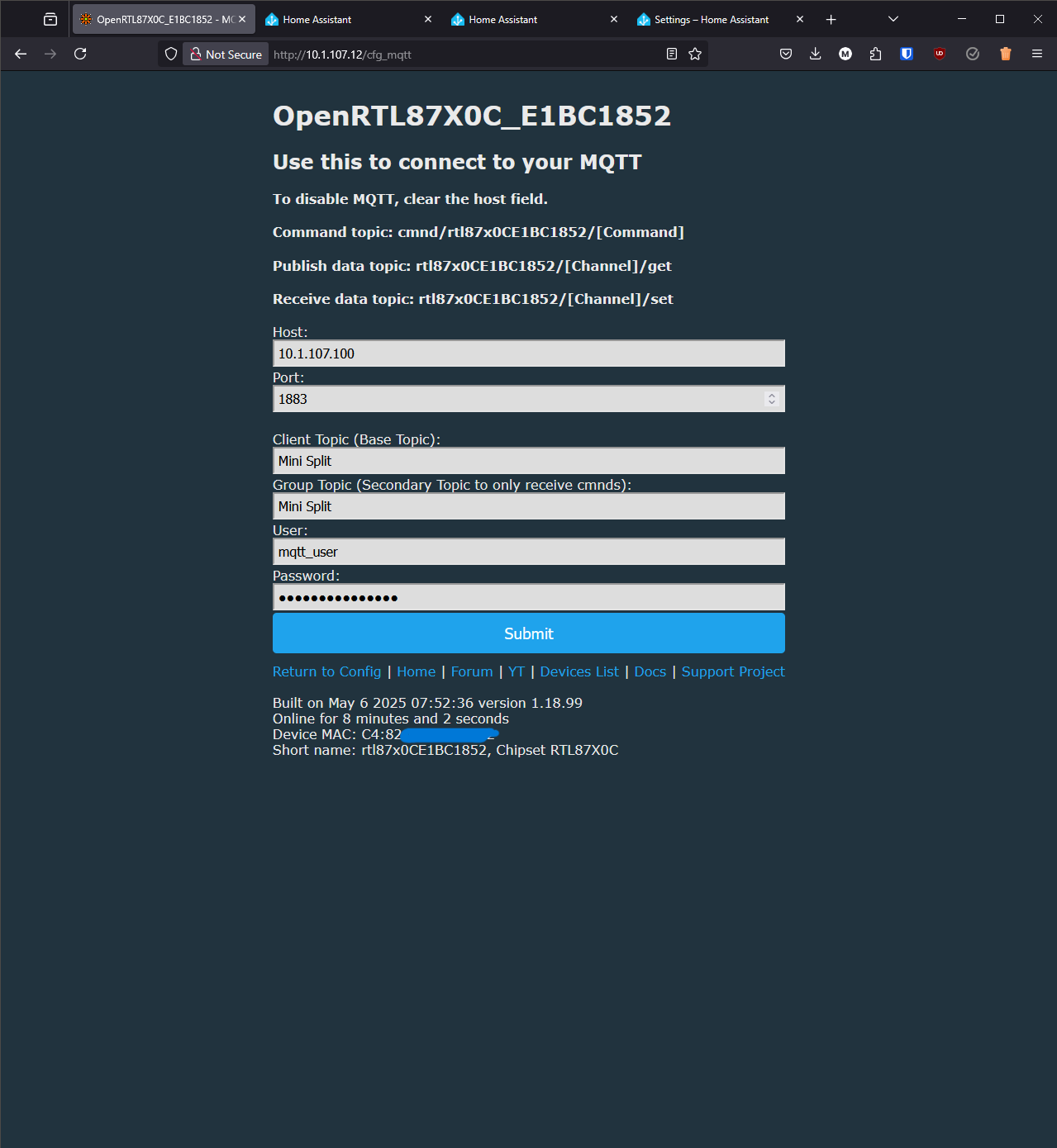

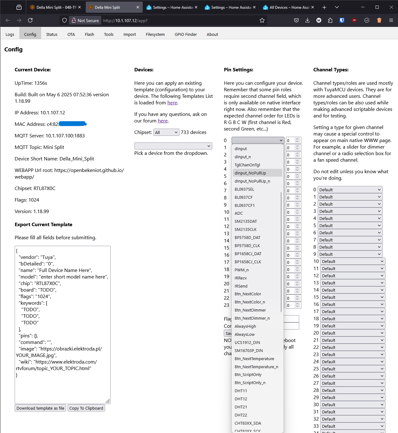

    I have successfully flashed the WBR3 and configured it to be on my IoT SSID.
    Configuration page for OpenRTL87X0C_E1BC1852 device for MQTT settings, with fields for host, port, and user credentials.
    I am a bit confused here because the names do not line up with the data points that were collected earlier.
    Screenshot showing the configuration page of a Della Mini Split device in a browser, with pin settings and device details visible.
    Screenshot of the Della Mini Split configuration page showing a list of GPIO pin assignments and dropdown function selectors.
  • #20 21547560
    Posts: 5106
    Help: 441
    Rate: 902
    ah, it's TuyaMCU so no GPIO assignments. You'll need to start with something like https://www.elektroda.com/rtvforum/topic4038151.html
    There are many TuyaMCU devices in the device list that will probably show the journeys others have taken https://openbekeniot.github.io/webapp/devicesList.html
    example autoexecs for devices with TuyaMCU https://github.com/openshwprojects/OpenBK7231T_App/blob/main/docs/autoexecExamples.md
    looks like you've got your work cut out for you https://www.elektroda.com/rtvforum/topic4119999.html#21536711

    I am genuinely curious, how can you tell? Im very new to flashing these kinds of chips and have only flashed Sonoff S31s with tasmota.
    Is it possible I flashed the incorrect BIN? I used "OpenRTL87X0C_1.18.99.bin"
    Also, would it make a difference if I swapped the WBR3 with another similar module? My guess is no because it appears the TuyaMCU handles the actual commands?

    Thanks for the clarification. I am going to stick with the stock WBR3 for now since it appears to be functional and I am still able to communicate with it via OpenBeken.
    In the meantime I have ordered a link analyzer to capture and analyze UART traffic between the WBR3 and the TuyaMCU. While I wait for it to arrive I am gathering as much data as possible from the Tuya IoT platform using the original firmware. I am especially focusing on identifying which DPID values correspond to which commands like power control and timers and how they are structured such as types and timing fields.
    Once the analyzer is here I plan to correlate the cloud commands with the actual UART traffic to fully map out the control scheme. If I learn anything useful I will share it here in case others are doing similar TuyaMCU reverse engineering.
