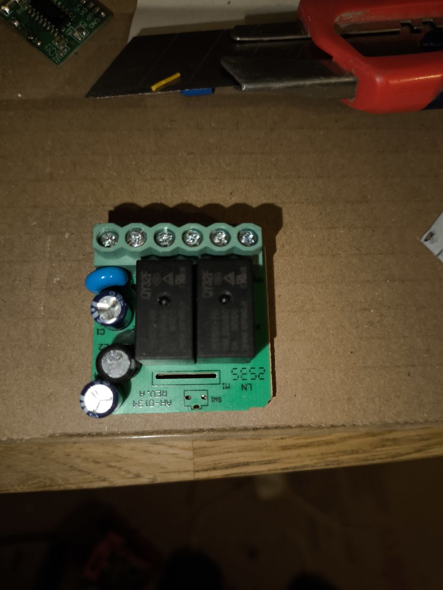

  • OpenBK flashing notes and pin map for CBLC9 board
    #1 21049246
    vincenzoernst1
    Posts: 100
    Rate: 7

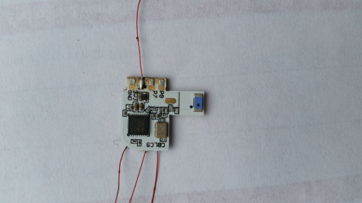

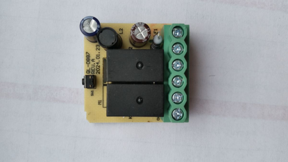

    This Curtain Module is similar to RTX WCM1MR which also uses the CBLC9/BK7231N
    Board ID: QL-0887
    Rev. A
    2024.01.23
    PIN CBLC9 Board
    P6ext. switch
    P7relay down
    P8LED
    P9relay up
    P24internal push button
    P26ext. switch
    GNDGND
    VCC3.3V
    I flashed OpenBK on Linux cli via python. The bus was not detected at 1st but as soon as i disconnected the board from 3.3V, started to flash and reconnected the board to 3.3V, the bus was detected and the flashing/backup started.
    i dont use the mechanical button right now.

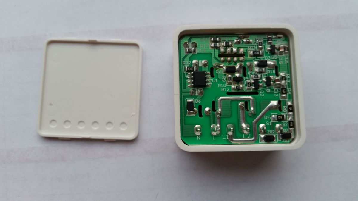

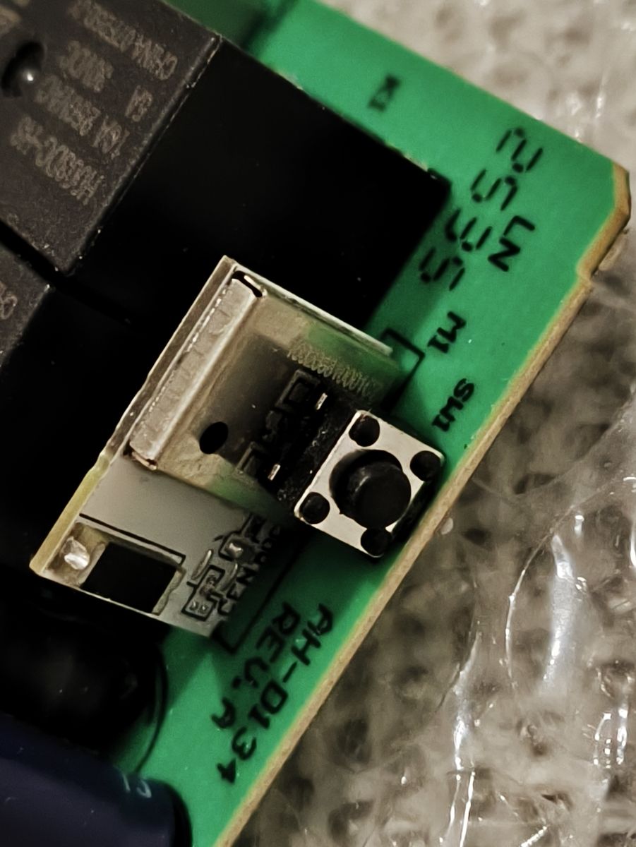

    Mini Wi-Fi Curtain Module QS-WIFI-S10-C04 with technical specifications printed on the casing and visible screw terminals. Green electronic module circuit board with open casing.Close-up of a printed circuit board with electronic components. Electronic module with QLRELAY relay and green terminal. Electronic board module labeled QL-0887 Rev. A.Curtain module circuit board with connected wires. Image of a curtain module with attached wires.
    Attached the orig firmware backup. I used the python cli tool. 1st backup with "-r", 2nd with "-r -s 0x0"

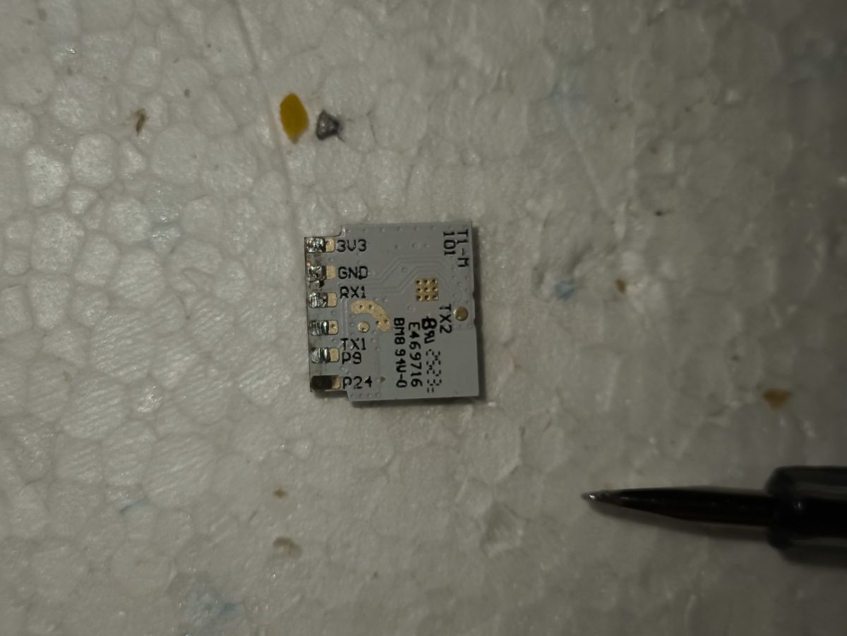

    it should also flashable without desoldering. you have access to all pins and if the flasher delivers enough current it should be working.

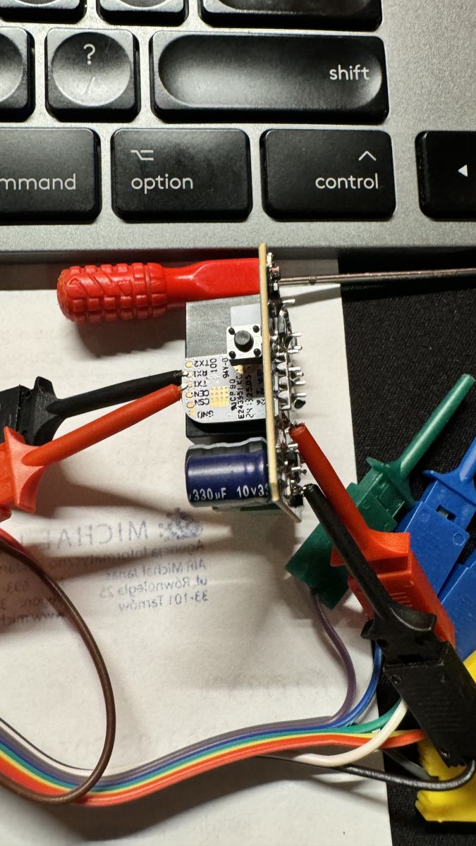

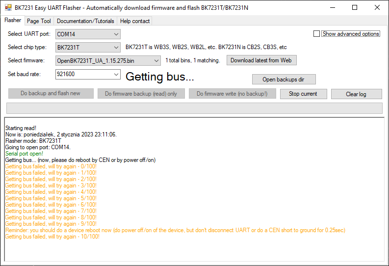

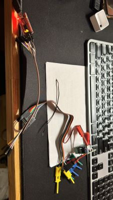

  • UART access appears blocked and flash dump crashes
    #7 21125913
    mic_jan
    Posts: 7
    It's either blocked or I'm doing something wrong.
    I made an attempt to connect to the UART without soldering, but could not establish communication.
    UART cables connected to a board next to a keyboard. Soldered PCB connected to colorful wires, placed in front of a keyboard. .
    I also tried tapping the UART via minicom , but to no avail.
    I tried downloading the firmware via BK7231GUIFlashTool , and here I had all the time (picture borrowed, but it was getting to 100/100 and crashing)
    Screenshot of the BK7231 Easy UART Flasher program showing a firmware download attempt with error messages.
  • #8 21125926
    Posts: 14743
    Rate: 12839
    Are you performing the operations as instructed?
    https://www.youtube.com/playlist?list=PLzbXEc2ebpH0CZDbczAXT94BuSGrd_GoM
    You need to enable flashing so that the flasher tries to "get bus", and then cut the power for a while so that the flasher "catches" the chip booting up.
    Added after 46 [seconds]: .
    In addition, the connections look unacceptably long.

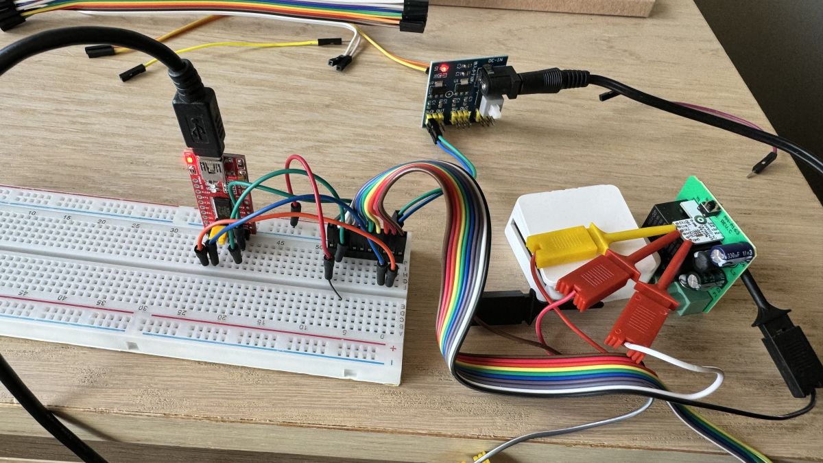

    Posts: 7
    I'm powering it 12V -> 3.3Vi I modified the connections a bit, shorter crocodiles I don't have.
    Breadboard with connected wires and electronic components. .
    I don't know if I should use any more components?
  • Shorten cables and swap RX/TX during flashing
    #12 21126071
    Posts: 14743
    Rate: 12839
    I still think the connections are too long. We have documented cases on the forum when users also had cables like yours and it didn't work, only shortening helped.
    Apart from that, try swapping the RX with the TX (as a general rule).
    When programming, proceed as follows:
    1. enable read flash in flasher
    2. let it try "getting bus"
    3. then disconnect the 3.3V from the WiFi module side
    4. connect the 3.3V from the WiFi Router (NOT from the power supply) to GND
    5. then connect the 3.3V back to the power supply...
    You can also try another USB to UART converter and try to connect 5V from USB to the AMS1117-3.3V input and use this 5V to do power off/on.

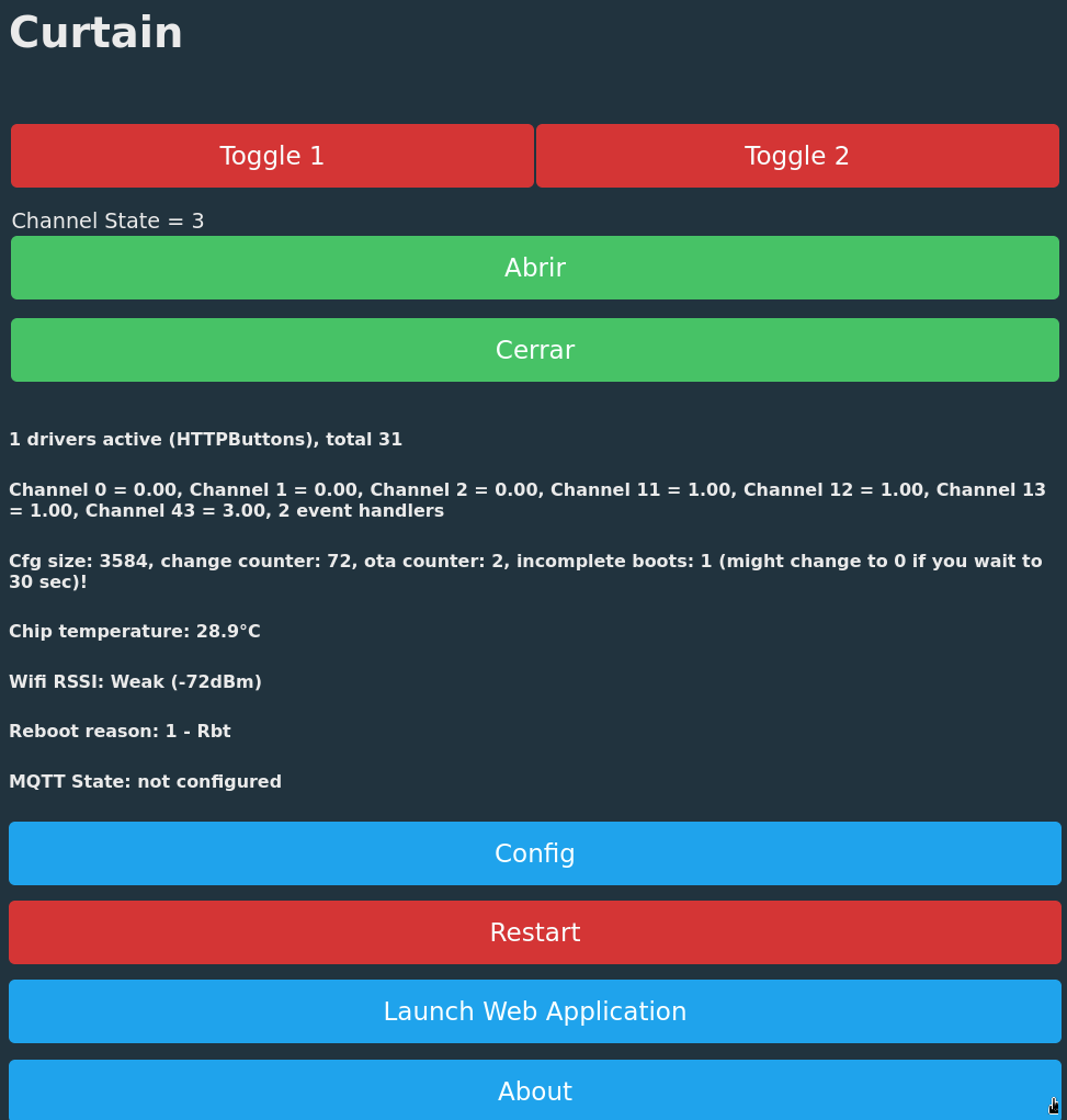

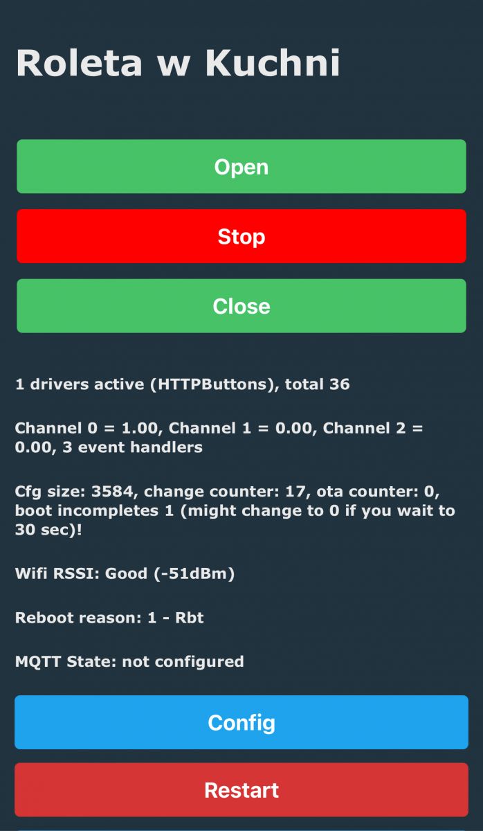

  • Relay interlock and blind control script issue
    #13 21142835
    mic_jan
    Posts: 7

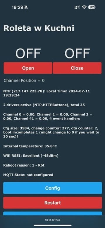

    We have managed to get the QS-WIFI-S10-C04 to flash with TUYA Cloud Cutter .
    And everything would work, but you can turn on both relays at once, which would burn up the motor, and the pairing button doesn't work like in the TUYA software, that when it's not in pairing mode, it handles the relays, that the first press turns on, the next press turns off the first relay, the next press turns on the second relay, and the next press turns off the second relay. I hope I haven't messed anything up.
    Also, the operation of the roller shutter buttons doesn't work properly, because pressing open will turn on the relay, but if I press close, it won't turn off the opening relay and it won't turn on the closing relay, it just brings both relays on.
    I used such an autoexec.bat:
    //Configurar alias  Aliases
    alias Set_Stop backlog setChannel 2 0; setChannel 1 0
    alias Set_Open backlog setChannel 1 1
    alias Set_Close backlog setChannel 2 1
    alias Start_Opening backlog stopAllScripts; startScript autoexec.bat openBlind
    alias Start_Closing backlog stopAllScripts; startScript autoexec.bat closeBlind
    alias Stop_All backlog stopAllScripts; startScript autoexec.bat stopBlind
    // Channel 60 segundos de trabajo
    setChannel 60 15
    //crear botones GUI  para el panel HTTP
    startDriver httpButtons
    setButtonEnabled 1 1
    setButtonLabel 1 "Open"
    setButtonCommand 1 Start_Opening
    setButtonEnabled 3 1
    setButtonLabel 3 "Close"
    setButtonCommand 3 Start_Closing
    setButtonEnabled 2 1
    setButtonLabel 2 "Stop"
    setButtonCommand 2 Stop_All
    setButtonColor 2 red
    // Ocultar los botones de los reles en la  GUI HTTP
    setChannelVisible 1 0
    setChannelVisible 2 0
    setChannelVisible 3 0
    // Cargar Event Handlers
    addEventHandler OnHold 26 Start_Closing
    addEventHandler OnHold 24 Start_Opening
    addEventHandler OnClick 11 Stop_All
    // Detener persiana al encender
    goto stopBlind
    return
    // Script abrir
    openBlind:
    Set_Stop
    delay_s 0.1
    Set_Open
    delay_s $CH60
    Set_Stop
    return
    // Script cerrer
    closeBlind:
    Set_Stop
    delay_s 0.1
    Set_Close
    delay_s $CH60
    Set_Stop
    return
    // Script detener
    stopBlind:
    Set_Stop
    return
    and I got the following and it works, but only from the web panel.
    Control panel for kitchen blind with buttons Open, Stop, and Close. .
    What am I doing wrong, or how do I get a situation similar with Tasmota so that there is an Interlock?
    I haven't zipped into HomeAssistant yet so won't comment.

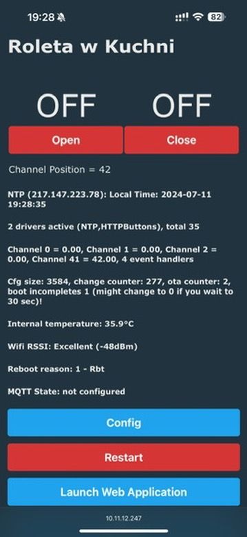

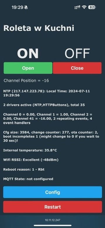

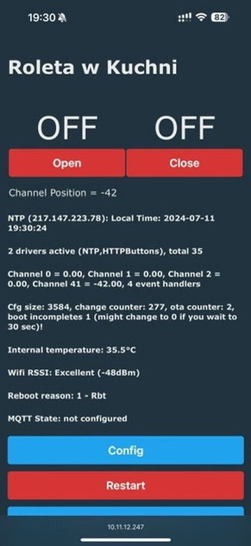

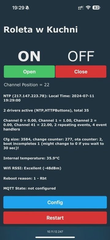

    Template import and autoexec for QS-WIFI-S10-C04 curtain module
    #14 21151245
    mic_jan
    Posts: 7
    Update:
    I have used as input the template import:
      "vendor": "Tuya",
      "bDetailed": "0",
      "name": "QS-WIFI-S10-C04",
      "model": "Mini WiFi Curtain Module",
      "chip": "BK7231N",
      "board": "CBLC9",
      "flags": "1024",
      "keywords": [
       "curtain",
       "blind",
       "rollers",
       "roller",
       "shutters",
       "shutter",
       "awning",
       "sunblind",
       "marquee",
       "WiFi"
    "pins": {
      "6": "Btn;1",
      "7": "Rel;2",
      "8": "WifiLED_n;0",
      "9": "Rel;1",
      "24": "Btn_Tgl_All;0",
      "26": "Btn;2"
    "command": "PowerSave 1",
    "image": "https://obrazki.elektroda.pl/1978468300_1713373135.jpg",
    "wiki": "https://www.elektroda.com/rtvforum/viewtopic.php?p=21049246"
    while as logic an autoexec.bat file modelled on thread user @maxim2002 modified under my Tuya:
    // drivers
    startDriver NTP
    ntp_timeZoneOfs 02:00
    // config
    powerSave 1
    setFlag 2 1 // MQTT Broadcast self state
    setFlag 6 1 // BTN Instant touch
    setFlag 27 1 // HASS discovery on IP change
    setFlag 41 0
    setButtonTimes 1 1 1
    // shutter cycle
    setChannel 40 42 // seconds
    // position (open 0 - N closed in seconds)
    setChannelType 41 ReadOnly
    setChannelLabel 41 "Position"
    setChannel 41 $CH40 // closed
    // relays
    setChannelType 1 toggle
    setChannelLabel 1 "Open"
    setChannel 1 0
    addChangeHandler Channel1 == 1 backlog cancelRepeatingEvent 1; cancelRepeatingEvent 2; setChannel 2 0; addRepeatingEventID $CH40 1 1 setChannel 1 0; setChannel 41 $CH41-1; addRepeatingEventID 1 -1 11 setChannel 41 $CH41-1

    Generally everything works correctly except the position, which when closed is 42, when opened goes to 0, but when I have closed, click OPEN and click again OPEN, the position becomes -42 and so on. The other way it is also the case that if I have a position at 0 and I give CLOSE it goes to 42, and if I CLOSE again I have 84 as in the attached screens:
    Screenshot of a curtain control application for the kitchen on a smartphone. Curtain control screen in the kitchen with Open and Close buttons. App screen for managing a kitchen blind with Open and Close buttons. App screen for controlling a kitchen roller blind with Open and Close buttons. Screenshot of a kitchen blind control app interface. Screenshot of a kitchen blind control app interface.
    I've tried to understand what's going on in autoexec.bat, but I think I've given up for the time being.
    Maybe someone has already struggled with such a problem?
    And is it possible to add a progress bar?
    What I still have to do is tilt the slats upwards, as I have the option to do so (C slats as shown in the video - https://www.youtube.com/watch?v=D9ZvJiSfyYU)

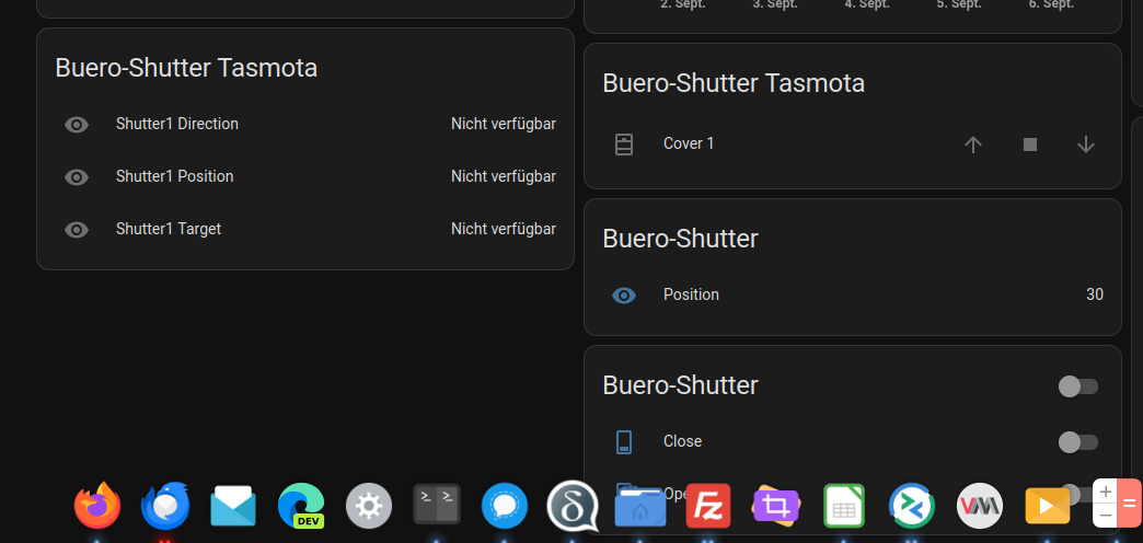

    hmmm.
    i see a different behavior of Tasmota and Openbeken on HA.
    User interface showing Tasmota and OpenBeken settings on Home Assistant.
    I marked the Tasmota as Tasmota.
    The Tasmota buttons are matching much better the function. Its it how OB is sending its mqtt messages? How can we achieve this: up/down arrow and stop button in the middle?

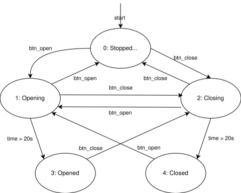

  • OpenBeken state machine for curtain module
    #19 21395311
    lktrdng
    Posts: 15
    Hi guys, thanks for the info in this post. I also got one of these BK7231N with CBLC9 board soldered to the main board.
    I managed to get it working, but since I was not fully confident in understanding the automations posted here (I'm new to openbeken) and I didn't want any blocking logic, I built my own and I wanted to share it with you all, maybe someone feels it useful :D.
    This is the State Machine Drawing of my logic:
    State machine diagram illustrating the opening and closing logic.
    And here is the code of my autoexec.bat (I needed to create the IO channels on it just in case).

    You will notice I used dInput instead of button, that's because I wasn't able to make it work otherwise :P.
    Also, the time for the curtain to be considered fully open or closed is 20 seconds, this might be adjusted depending on the real world of your implementation.
    This is the web interface:
    User interface of curtain management software with buttons and channel state.
    Basically added 3 fields:
    Channel state: Here you can check in which state the state machine is, in the screenshot is in state = 3, meaning fully opened.
    Button "Abrir": AKA soft_btn_open, to trigger the opening command.
    Button "Cerrar": AKA soft_btn_close, to trigger the closing command.
    Everything else is default
    My next step now is to automate to open/close on certain hours of the day.
    UPDATE: Added a few lines at the end of the code to open the curtain at 8am of working days and close every day at 6pm. New pendings: consider sunrise/sunset, consider daylight saving times.
    UPDATE2: I just discovered (it might be obvious) that you could trigger the commands to open/close directly calling the aliases created, like http://deviceip/cm?cmnd=btn-open or http://deviceip/cm?cmnd=btn-close respectivelly.

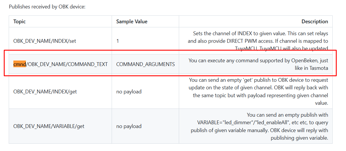

    Hello! How do I call these commands from the Home Assistant?
    #28 21708902
    Posts: 14743
    Rate: 12839

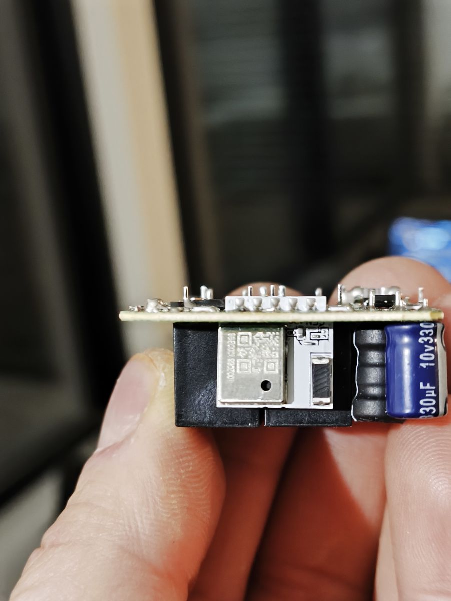

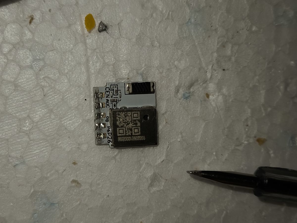

    Small electronic module with pin labels on white backgroundSmall electronic module with QR code on white surface with screwdriver tip nearbyRelay module with two relays and screw terminals on a green PCBClose-up of green printed circuit board with visible surface-mount components

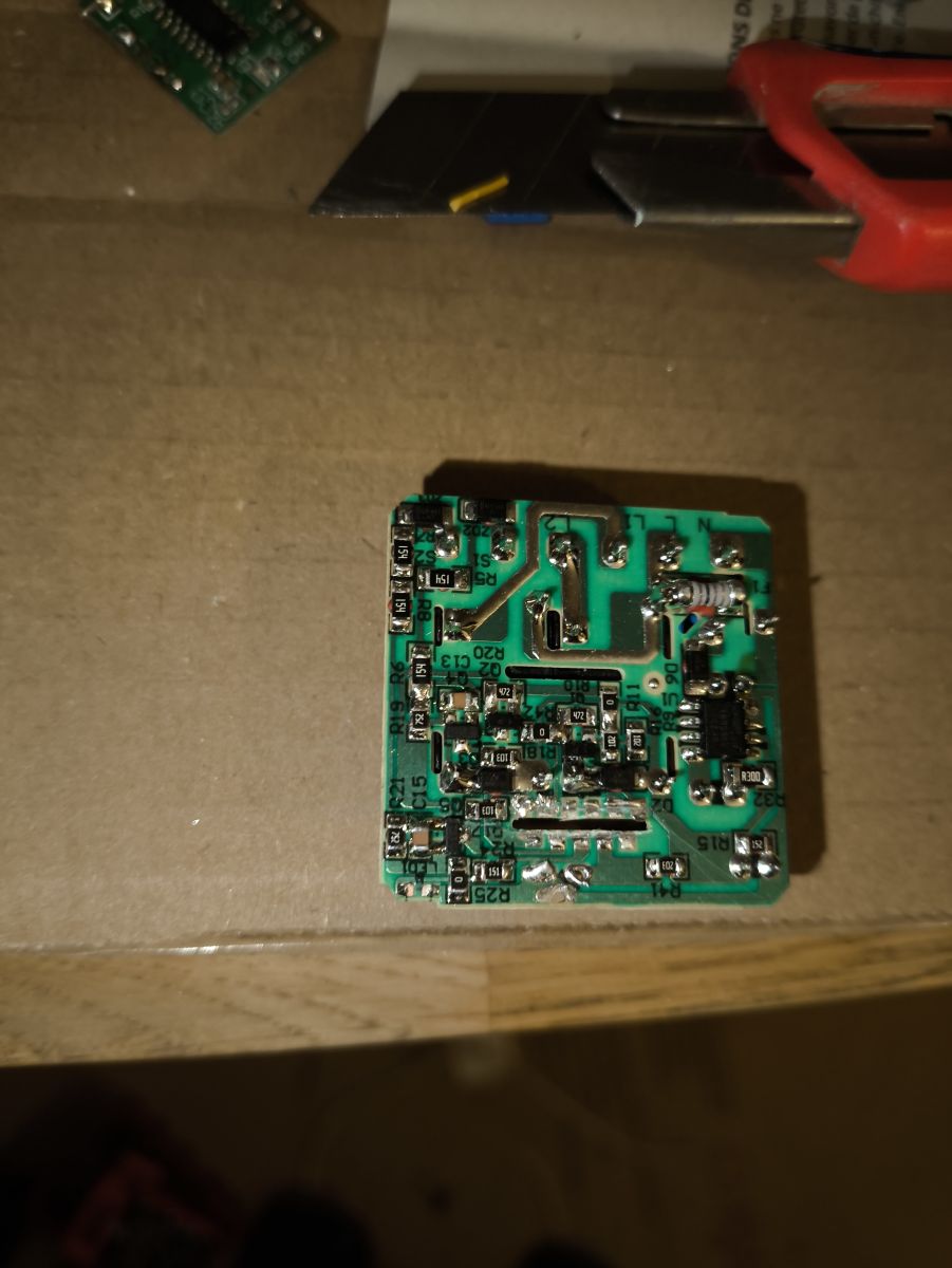

    got fresh revision of this module, it has different mcu, pinout, and some minor pcb changes.
    managed to read it as 7238, other failed
    Encryption key read done!
    Encryption key: 00e06e00 00e06e00 00e06e00 00e06e00
    WARNING! Non-standard encryption key!
    If it's all zero, it may also mean that read is disabled.
    Please report to forum https://www.elektroda.com/rtvforum/forum51.html
    Or just try using BK7231M mode
    Looks the same from outside, same text, same case, different pcb.
    Close-up of electronic module with capacitor and chip bearing QR codeClose-up of a button and USB port on a green printed circuit board
    • readResult_BK7238_QIO_qq_2025-12-11-22-16-51.bin (2 MB) You must be logged in to download this attachment.

    Posts: 5195
    Help: 446
    Rate: 913
    Interesting. I've not see a T1-M in a device yet I don't think
    https://developer.tuya.com/en/docs/iot/T1-M-Module-Datasheet?id=Ke33yw7g0vimt
    Do you have a complete working device template?
    Added after 21 [minutes]:
    here is boot log from your backup. it's a very chatty firmware
