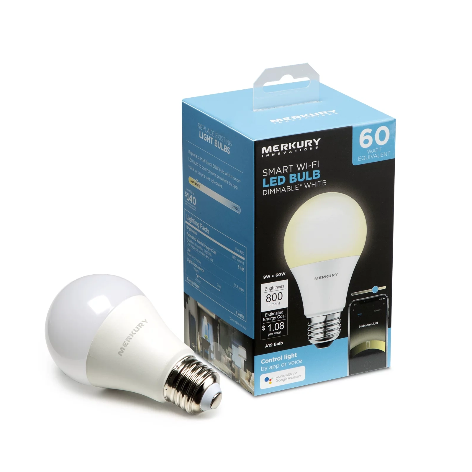

    I have the Merkury mi-bw942-999w which is $5 at Walmart working with OpenBeken.
    I flashed it with Tuya Cloud Cutter and used P8 PWM ch 4.
    How can this be added to the working devices list?
    It is an easily obtainable, cheap, and wirelessly flashable smart bulb.
    I don't have teardown pics as I didn't have to tear it down to get it working.
