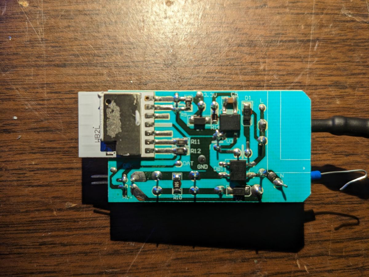

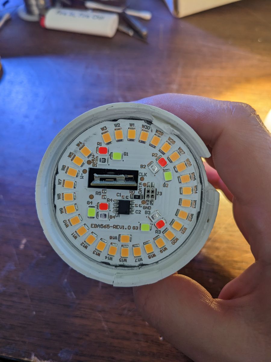

    These were recently on sale on meh.com for $2USD each: https://meh.com/deals/merkury-innovations-sma...r-white-3?mc_cid=a2a1c6c11c&mc_eid=d62580ffd4
    [BK7231T/WB2L/BP5758D] Merkury MI-BW210-999WW RGBW WiFi LED Bulb
    The ones shipped are vulnerable to the tuya-cloudcutter exploit and I successfully performed an OTA flash of Openbeken 1.17.128 for the BK7231T.
    Pin 7 = BP5758D_DAT
    Pin 8 = BP5758D_CLK
    Config Command: BP5758D_Map 2 1 0 4 3
    These are not RGBCW bulbs, but only RGBW, so flag 24 is needed.
    HA works as expected.

    I see that your bin still produces "LED remap is 2 1 ? 4 ?" in Easy UART Flasher.
    Does BP5758D_Map 2 1 0 4 3 work OK? Are you setting flag 24?
    Screenshot showing Flag 24 enabled in Easy UART Flasher.
    also shouldn't your current be BP5758D_Current 29 65
    also, device is not in the the list, so https://github.com/OpenBekenIOT/webapp/pull/89

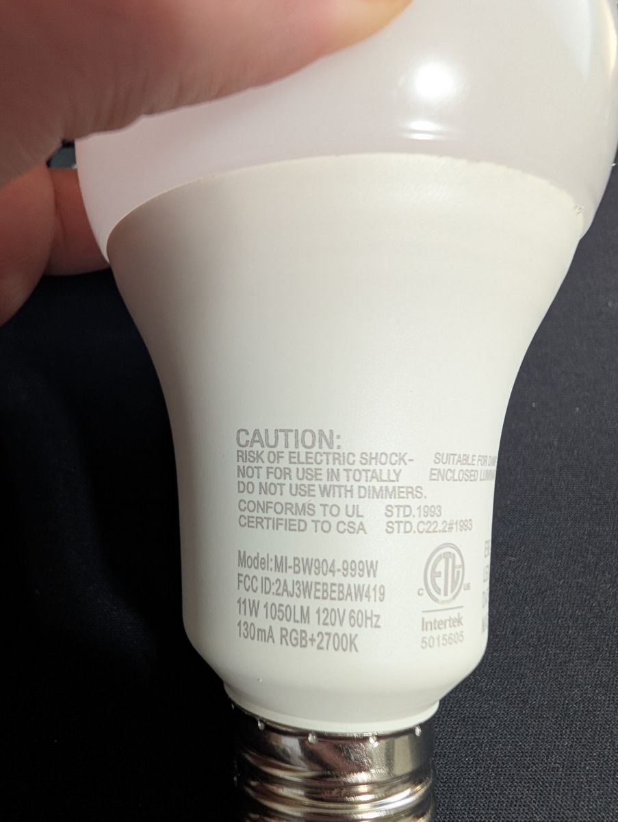

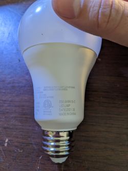

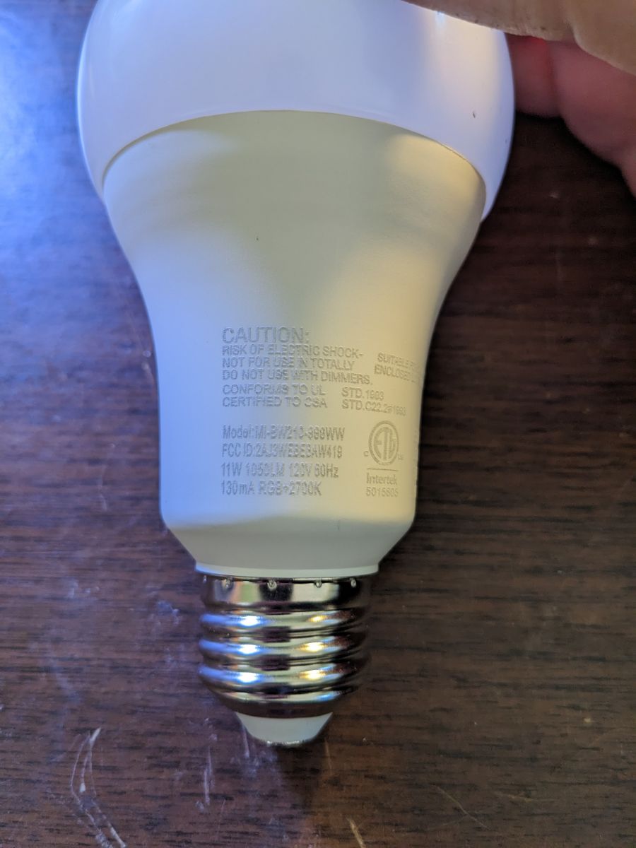

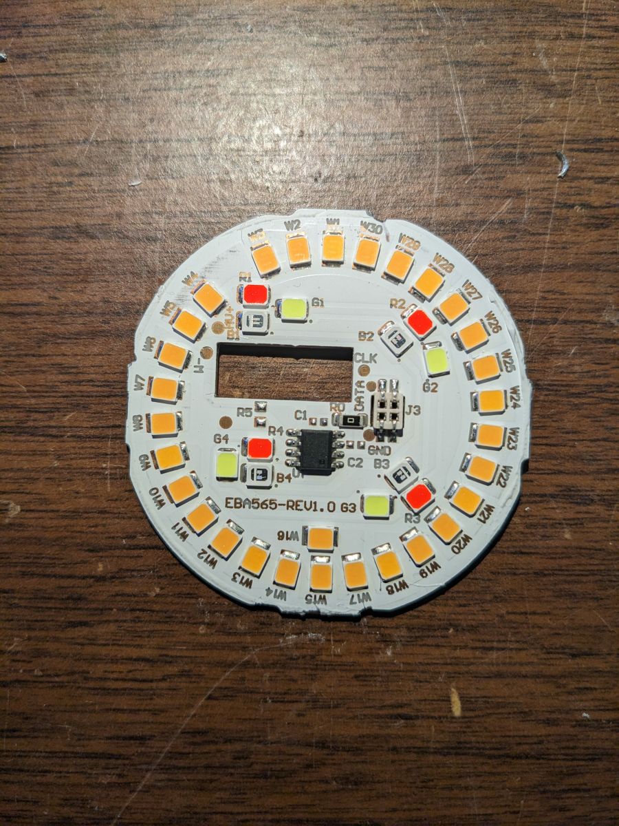

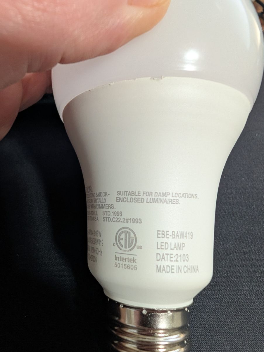

    #6 21422381
    hcgonzalezpr

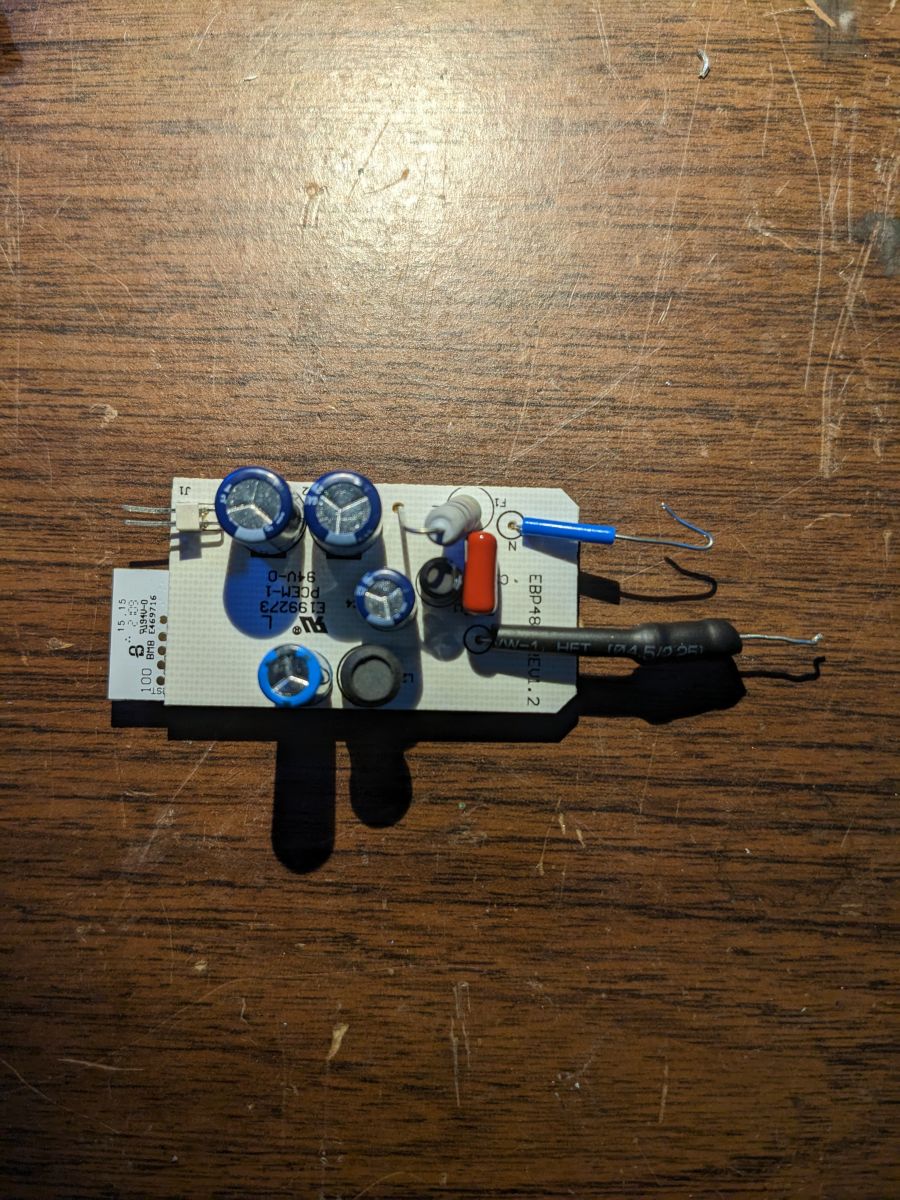

    I have the same bulb but different revision board, as FCC ID different but the model is the same. Mine seems to use SM2135 instead of BP5758D.
    The power board looks different but seems to the chip was marked as WB2L chip, I try to take the bulb apart again to show the board at some point.
    Mine seems to use:
    Pin 7 = SM2135DAT
    Pin 8 = SM2135CLK
    Full Blue/Red/Green colors look ok, but mix colors seems to be completely off, enabling flag 24 fixes Cool White, but Warm White just shows as off.

    - SM2135DAT on P7
    - SM2135CLK on P8
    - LED remap is 2 1 0 3 3
    Device seems to be using WB2L module, which is using BK7231T.
    Close-up of an LED bulb with markings on the casing.
    LED bulb with manufacturer markings and certifications.
