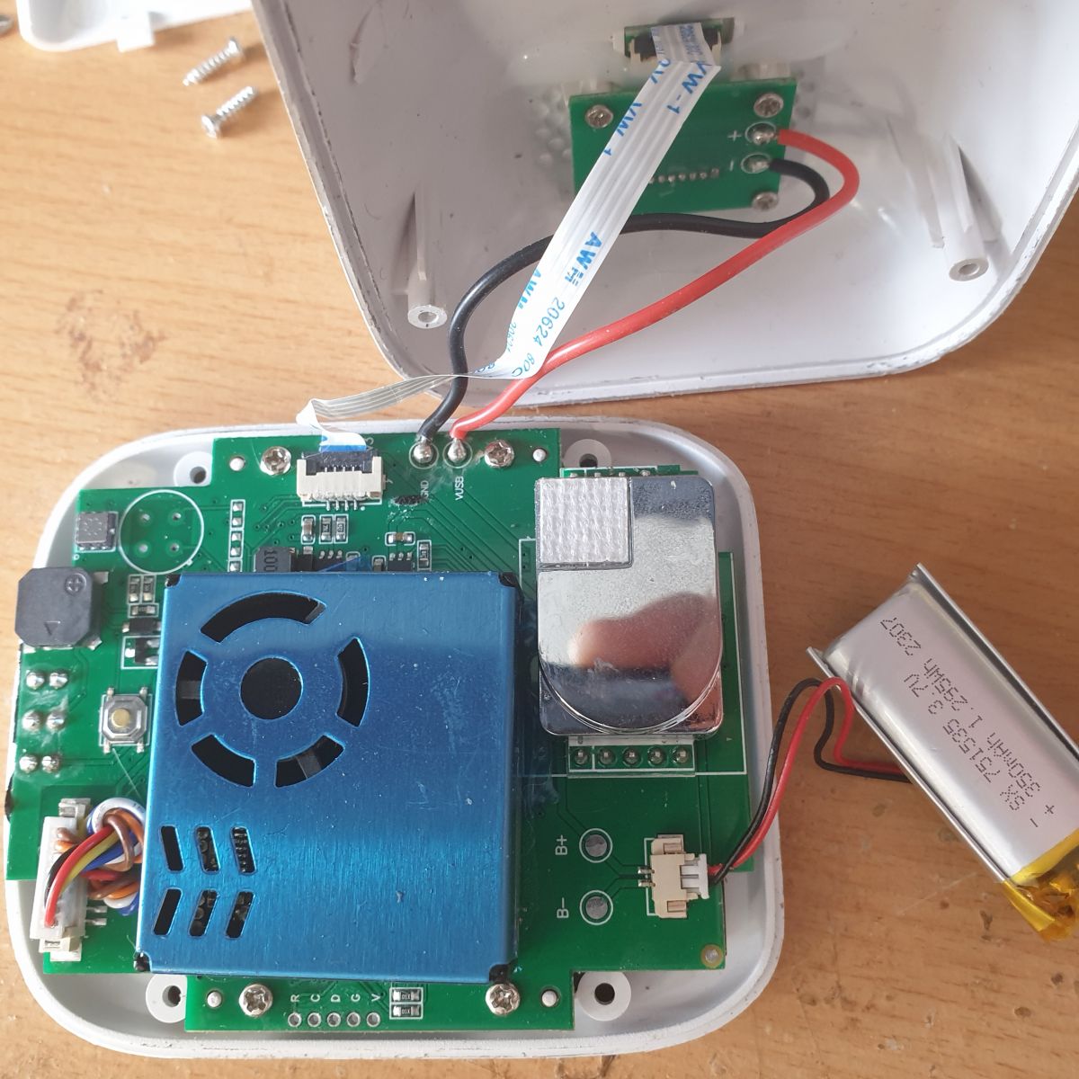

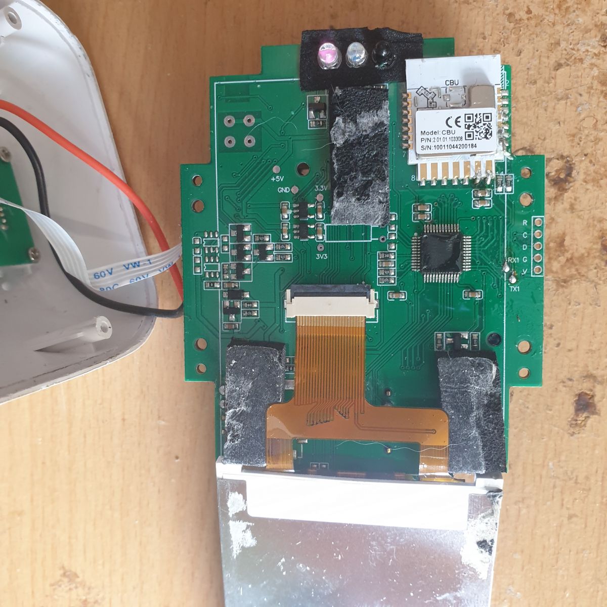

    Hi,
    This is the device. It's wifi, and needs to be powered from USB, as the internal battery seems to quickly run down.
    I've managed, through luck and determination to get OpenBeken on this device using Tuya Cloudcutter on a Rpi4. Whilst there is no current template for it, I managed to flash it by choosing Tuya Generic and the PM2.5 device selected. Strangely, it put the device in cloudcut mode when the initial upload failed, but after another attempt at connecting the AP with connection errors, and more waiting, it finally uploaded OBK. I was lucky not to brick it.
    So far all I know is it's a BK7231N chip as indicated on the config screen (I'm a noob at OBK having only flashed one other device). As the flash was successful I didn't want to risk damaging the sensors opening it up. Updating the build via OTA also worked without any issues.
    It's a blank canvas, and I can't find a similar template to play with. Is there a way I can get more info experimenting from the web interface without damaging the unit? Also, is there a safe way to find out if it has a MCU?

    Does it still go to sleep automatically (after firmware change)? If yes, it's TuyaMCU.
    Is there a baud key in Tuya config? If yes, then it's TuyaMCU.
    For TuyaMCU devices, you can try to query state via command:
    Tuya config extraction: https://www.youtube.com/watch?v=WunlqIMAdgw&ab_channel=Elektrodacom
  • TuyaMCU buffer shows unwanted non-header bytes

    The device doesn't sleep when plugged into USB or internal battery (which lasts about half an hour on a full charge)
    Here's the output from startDriver TuyaMCU & tuyaMcu_sendQueryState at Debug log level in the web app:
    (I've replaced my actual wifi info with 'MYWIFI')

    It then repeats the heartbeats, parseStates and wifi info over and over. On a reboot, the MCU driver is lost and has to be reactivated.
    And here's the extraction from the UART Flasher app, although it doesn't give us much info:
    Sorry, no meaningful pins data found. This device may be TuyaMCU or a custom one with no Tuya config data.
    Baud keyword found, this device may be TuyaMCU or BL0942. Baud value is 9600}e
    No module information found.
    And the Tuya section starts at UNCOMMON POSITION 0

    Info:TuyaMCU:Received: 55 AA 03 07 00 10 14 02 00 04 00 00 00 0A 66 02 00 04 00 00 00 06 AF
    Info:TuyaMCU:ProcessIncoming[v=3]: cmd 7 (State) len 23
    Info:TuyaMCU:ParseState: id 20 type 2-val len 4
    Info:TuyaMCU:ParseState: int32 10
    Debug:TuyaMCU:ApplyMapping: id 20 (val 10) not mapped
    Info:TuyaMCU:ParseState: id 102 type 2-val len 4
    Info:TuyaMCU:ParseState: int32 6
    Debug:TuyaMCU:ApplyMapping: id 102 (val 6) not mapped

    Info:TuyaMCU:Received: 55 AA 03 07 00 48 02 02 00 04 00 00 04 62 14 02 00 04 00 00 00 09 66 02 00 04 00 00 00 06 65 02 00 04 00 00 00 0B 16 02 00 04 00 00 00 01 15 02 00 04 00 00 00 01 12 02 00 04 00 00 00 17 13 02 00 04 00 00 00 41 67 02 00 04 00 00 00 41 3A
    Info:TuyaMCU:ProcessIncoming[v=3]: cmd 7 (State) len 79
    Info:TuyaMCU:ParseState: id 2 type 2-val len 4
    Info:TuyaMCU:ParseState: int32 1122
    Debug:TuyaMCU:ApplyMapping: id 2 (val 1122) not mapped
    Info:TuyaMCU:ParseState: int32 9
    Debug:TuyaMCU:ApplyMapping: id 20 (val 9) not mapped
    Info:TuyaMCU:ParseState: id 101 type 2-val len 4
    Debug:TuyaMCU:ApplyMapping: id 101 (val 11) not mapped
    Info:TuyaMCU:ParseState: id 22 type 2-val len 4
    Debug:TuyaMCU:ApplyMapping: id 22 (val 1) not mapped
    Info:TuyaMCU:ParseState: id 21 type 2-val len 4
    Debug:TuyaMCU:ApplyMapping: id 21 (val 1) not mapped
    Info:TuyaMCU:ParseState: id 18 type 2-val len 4
    Info:TuyaMCU:ParseState: int32 23
    Debug:TuyaMCU:ApplyMapping: id 18 (val 23) not mapped
    Info:TuyaMCU:ParseState: id 19 type 2-val len 4
    Info:TuyaMCU:ParseState: int32 65
    Debug:TuyaMCU:ApplyMapping: id 19 (val 65) not mapped
    Info:TuyaMCU:ParseState: id 103 type 2-val len 4
    Debug:TuyaMCU:ApplyMapping: id 103 (val 65) not mapped

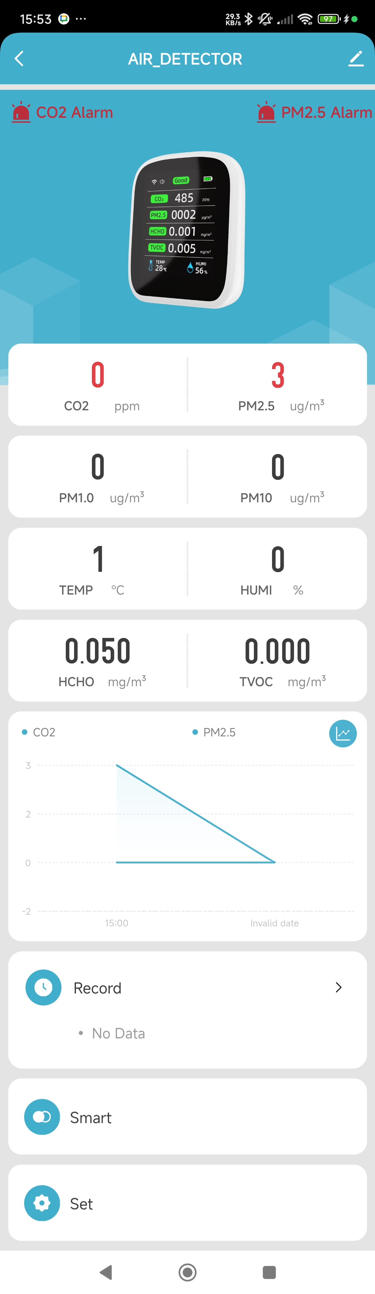

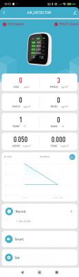

    Great, and thanks again. This is progressing well. Matching the values to the screen readings was fairly easy. After this line:
    Info:TuyaMCU:ProcessIncoming[v=3]: cmd 7 (State) len 79 - a summary list appears.
    I focused on one and verified the changes. Here's what I've found:
    (Note: zeros are not actual figures - just displaying the number format & measurement for info)
    All the air quality sensor ids are 'type 2-val len 4' and 'int32'
    id2 = CO2 (format is 0000 ppm)
    id20 = PM2.5 (0000 ug/m3)
    id102 = PM1.0 (0000 ug/m3)
    id101 = PM10 (0000 ug/m3)
    id22 = HCHO (0.000 mg/m3)
    id21 = TVOC (0.000 mg/m3)
    id18 = Temp (00 c)
    id19 = Humidity (00%)
    id103 = Humidity (00%)
    id15 = Battery (00%)
    id17 = Screen wake timeout (17 or less?)
    The HCHO & TVOC ids were both at 0.001 so until one changes I can't verify which way round they are.
    Humidity
    A mystery why this is reported on both id19 and id103, but it is.
    The battery
    id15 reports as a decreasing number until USB is plugged in, then increases. Once at 100% id15 isn't reported at all - even when unplugged it got to 96% before being reported again.
    Screen wake
    id17 is erratic. Gets reported as 11 - 17 when tapping the on button when asleep. When waving my hand over the sensor, sometimes the value starts at 4 or 5 - 9. When persistently activated sometimes the number increases. I'm not sure if this is a light level of some kind. The wait is too long to be in seconds, but it might be accumulative.
    I still need to work out the ids for, the 'unhealthy', 'poor', 'good' labels, as well as the alarm beeps, but this is a good start.

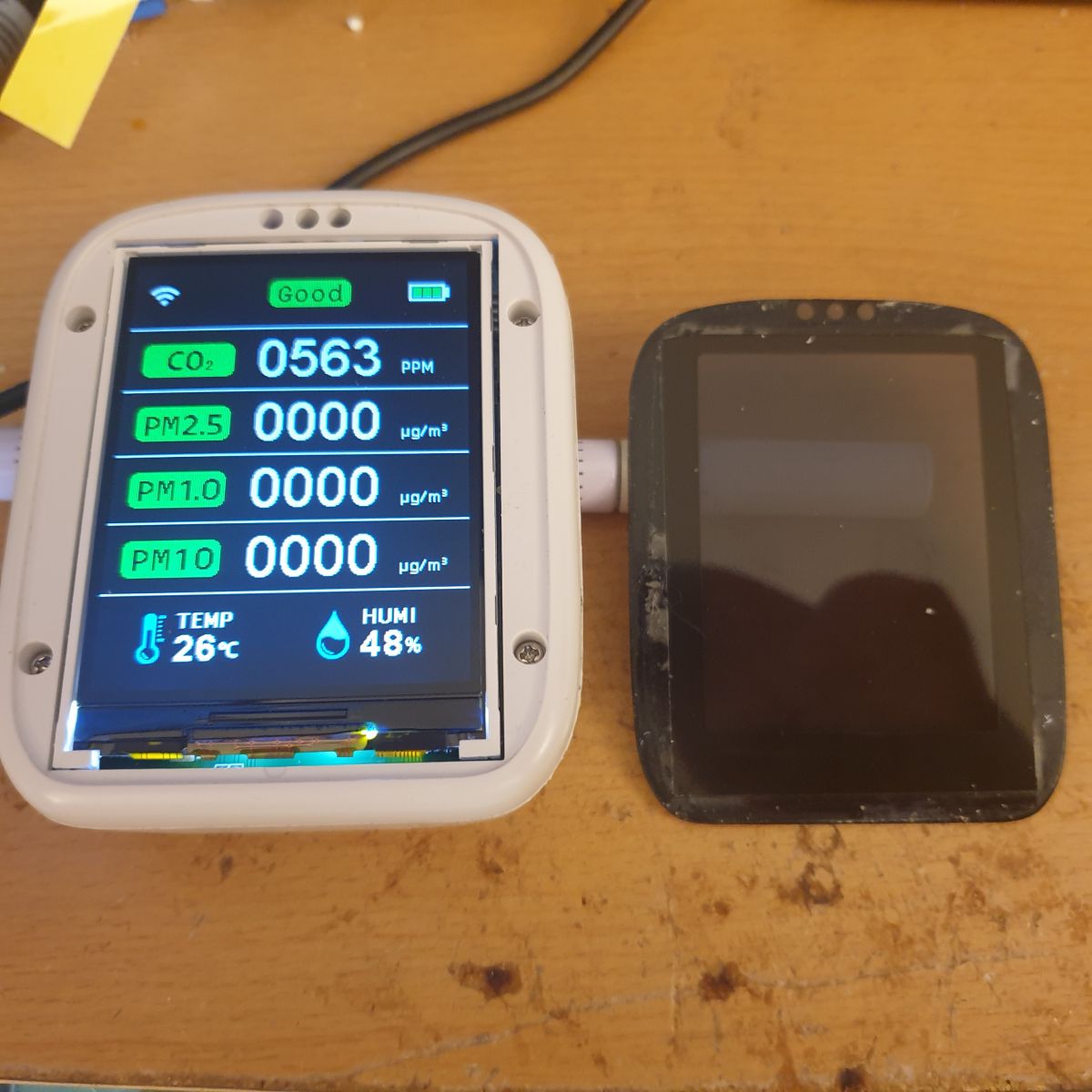

    It's surprisingly easy to get it open.
    The LCD bezel is held on by double-sided tape and can be (carefully) popped off with a fingernail
    Then there are simply 4 screws to remove

    stoatwblr
    Posts: 7
    >>21078921
    If a fingernail doesn't work, I've found a miniature "dent puller" suction cup works pretty well on these kinds of devices - they're only a couple of euros (less on Aliexpress) and very handy additions to the toolkit

    I see, it indeed looks easy. Do you have some photos showing the inside board of this device?
    More and more devices are patched these days so it's crucial to know how to flash by wires. Check out our Elektroda IoT device flashing guides for more info:

    To flash this, the Tuya module must be removed, or the TX/RX tracks temporarily cut
    There are 100R resistors in series to the MCU, so these can be unsoldered
    Unfortunately all of these parts are under the display and the adhesive holding it down is _strong_. Be careful or you'll pulling the display backlight reflecting sheet off
    Comms to the MCU is at 9600bps

    Additionally. the MCU sometimes stops providing sensor updates - Does anyone know if there's a Tuya command to reset the MCU?
    The unit's maker appears to be ggele.com (http://www.ggele.com/productinfo/937823.html)

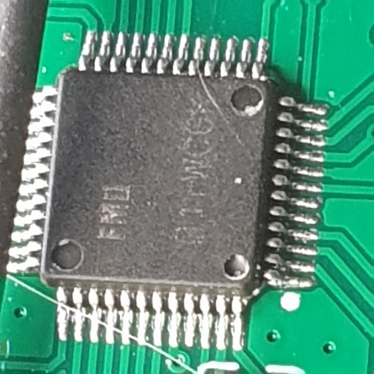

    MCU is a FMD (Fremont Micro devices) B1rWCGK - https://www.fremontmicro.com/en/ - and appears to be one of their LQFP48 package ARM M0 or M3 cpus (tech docs are on the chinese side of the site, the english side is sparse)
    The battery is only 350mAh and appears to be mainly for bridging use - it only lasts about an hour when not plugged in
    CO2 sensing uses NDIR and appears to be extremely accurate
    PM sensing is using a PMS7003 clone
    NOTE WELL: Check your unit for fan noise.
    If there isn't any, check the fan inside the PM sensor - in mine, the fan rotor assembly was completely dismounted from the frame. I assume the package was dropped.
    Repairing was easy - carefully pop open the unvented side of the sensor case and put the roter shaft back into the bearing. Magnetic forces will grab and centre it (no need to worry about a clip on the end of the rotor) The unit still works with the fan stalled, but lask of air ciculation inside the case makes it very slow to respond to environmental changes

    Image of an electronic circuit board with surface-mounted components, including a CBU module and a flexible ribbon cable.
    Open casing of an electronic device showing a battery module and circuit board.
    Close-up of an integrated circuit on a green circuit board with visible pins on the sides.

    Tuya product name: PV28_空气检测仪(8合1) - PV28_Air Detector (8 in 1)
    Air detector app screen with CO2 and PM2.5 alarms and various readings and a chart.

Wire flash Recovery when cloud paths are patched Confirmed possible after opening the unit and isolating MCU serial lines Display adhesive is strong and access is awkward

  • The hardware teardown identifies an FMD Fremont Micro MCU, a PMS7003-clone PM sensor, and an NDIR CO2 sensor; the PM module fan must spin or response becomes very slow. [#21177255]

What's the safest way to open and wire-flash the Tuya PV28-CW if cloud flashing is patched, including handling the display adhesive and MCU serial lines?
Open it from the front and isolate the MCU serial path before wiring. 1. Lift the LCD bezel carefully; it is held by double-sided tape. 2. Remove the 4 screws underneath. 3. For flashing, remove the Tuya module or cut the TX/RX tracks, or unsolder the 100R series resistors to the MCU. The thread warns that the display adhesive is strong and can pull the backlight reflector sheet loose. It also confirms MCU communications run at 9600 bps after access. [#21177255]
