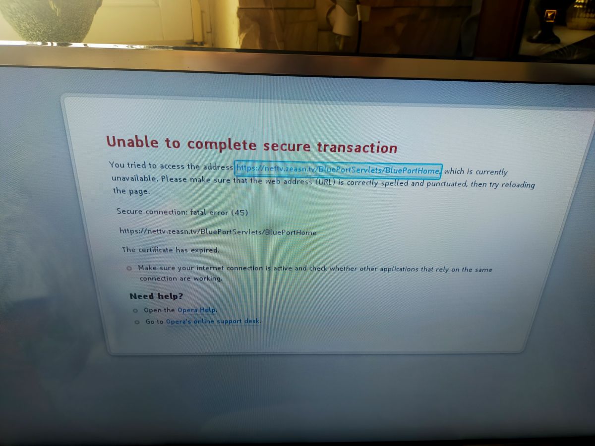

    Hello, I have a problem with the OPERA browser on my Philips 40PFL4528K TV. The problem is that a message appears: "Unable to complete secure transaction".
    Opera on Philips 40PFL4528K - message Unable to complete secure transaction .
    I think I've checked everything: net connection, date, time, restart TV, router, etc. TV update done, so net connection is there. All the time the same problem.
    How to fix it????
    Greetings
    AI: Does this message appear on all pages, or only on specific pages (if so, which ones)? .
    I don't know, because I can't do anything.
    AI: What is the version of the Opera browser installed on the TV and was it updated separately or only by updating the TV system? .
    Only through the TV update. I don't know what version of Opera it is.

    @ArturRutkowski
    TV vintage is somewhere in 2013.
    Forget to run any Smart TV on there.
    Same for any apps.
    If you're happy with your TV, buy some kind of Smart TV attachment like Google TV Streamer.
