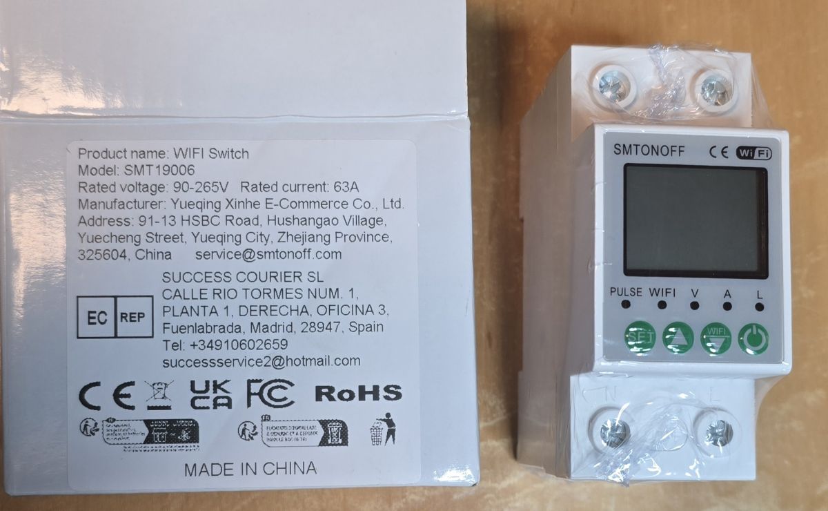

    The patient is an energy meter, single phase.
    SMS-19006 by SMTONOFF.
    SMTONOFF SMT19006 energy meter with LCD screen and control buttons. .
    Product label with barcode and description of SMTONOFF WiFi switch .
    The device paired nicely with Tuya and Home Assistant.
    Unfortunately after about 2-3 days, sometimes even after one, it starts to bounce.
    Namely, even though it is visible in the router, no data is transferred from it.
    The interesting thing, however, is that the device can be remotely switched off.
    To get back to the feed I have to uninstall the meter in the app and HA and re-add it.
    A little inconvenient.
    This state of affairs was not immediately but after about two months of use.
    Has anyone encountered anything like this?
