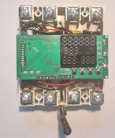

    From what I can see this device is not yet broken apart and I cannot resist the challenge :-)
    Disassembled SMTONOFF energy monitor showing main circuit board, screw terminals, and attached antenna.
    First step, removing top enclosure.The keen observer will note that the antenna cable was not connected from factory. What happened to quality control?

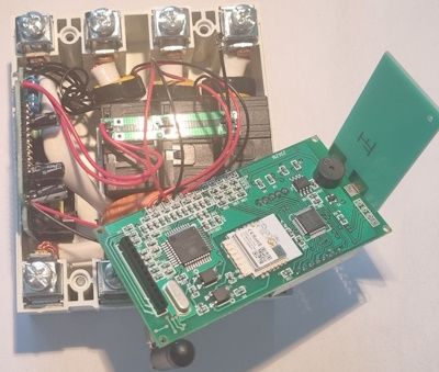

    Opened three-phase energy meter with the main circuit board extended and visible wiring and electronics.
    Second step, pulling the main board up. Nicely connected with the power board by pin-connectors, the angled pcb is a "foot". Transformers soldered directly to main board. Overall good quality and workmanship.

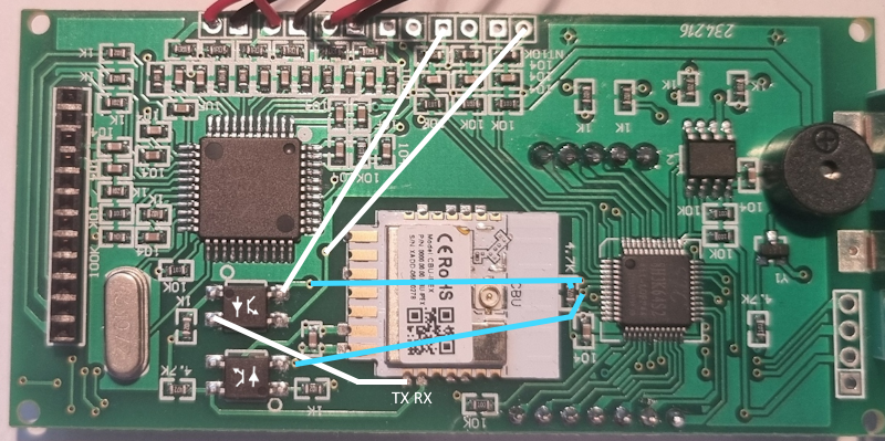

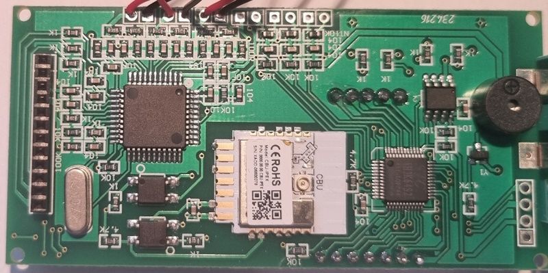

    SMTONOFF device mainboard with integrated CBU-IPEX module, BK7231N chip, and various electronic components.
    Third step, the main board. Uses a CBU-IPEX module with a BK7231N chip, an STC8H3K64S2 MCU in a 48 pin package, and a V9203 3-phase energy monitoring chip.
    Close-up of SMTONOFF mainboard with highlighted TX and RX UART communication traces.
    Fourth step, some brief analysis shows that serial RX1/TX1 of the CBU module is connected to the STC8H RXD2/TXD2 through opto-couplers. There are different power domains, no shared ground or VCC. It seems probable that hooking up the CBU module with external power and RX/TX would work without any modifications to the board. Verified to work. Remove the board and connect power and RX/TX to the CBU, and then flash
    What are the next steps?

  • 1 MHz pulse stream on CBU RX/TX lines
    #3 21536904
    thermiq
    Level 4  
    Posts: 14
    I installed openBK7231N with the EASY UART Flasher and got the "webserver" up and running. Good.
    After that I did some logic capturing with a saleae device in hope of figuring out the baud parameters, but it did not make sense. Looks like a serial stream clocked at 1MHz with an active high start bit. But most data is low, no parity or stop bit. In other words, I get a 1MHz pulse high followed by lows until next 1MHz pulse.
    I did this on the RX/TX of the CBU assuming a "floating ground" wrt the saleae and my PC's ground. This might be wrong of course.

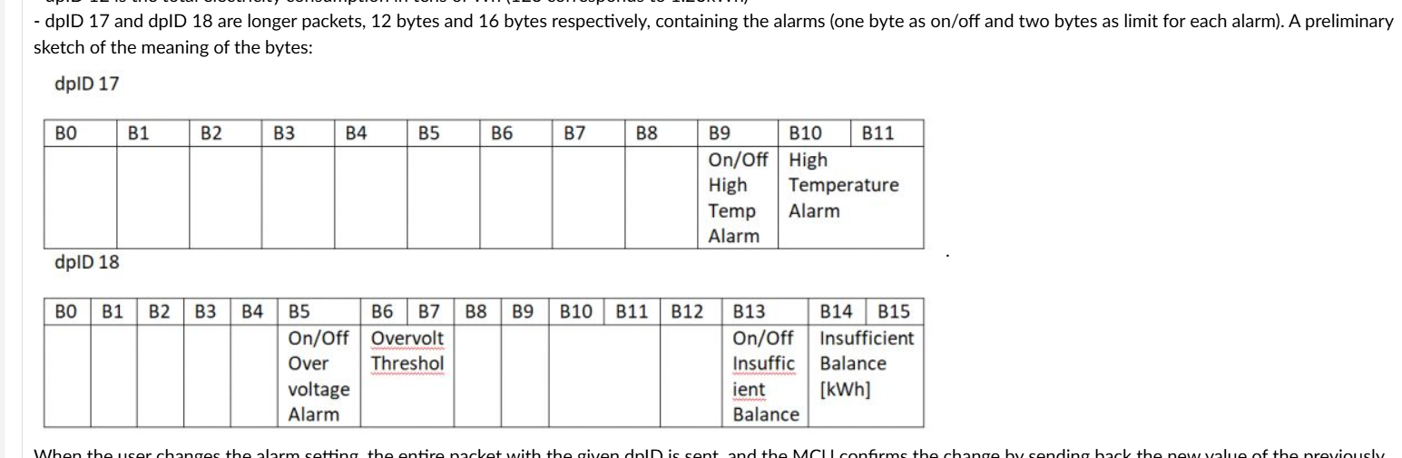

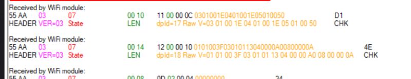

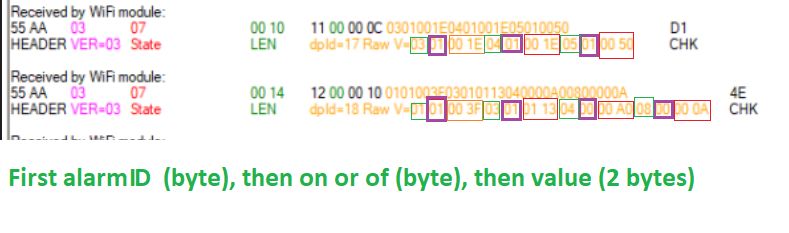

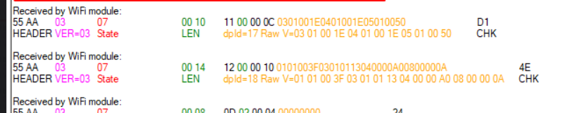

    #10 21540500
    Posts: 14760
    Rate: 12886
    Alarms are stored in those large "raw" type packets in format, as far as i remember, byte 1 or 0 (enabled or disabled) and then 16 bit value. I've already spoke about it a bit more in a previous topic related to this device. I've been planning to add some kind of configurable support of them in OBK, but didn't have time yet.
    Berry can now access raw TuyaMCU data and you can parse it in Berry as bytes, so virtually anything is possible with Berry. It's just that Berry TuyaMCU tutorial is not ready, I havent managed to publish it yet, but the functionality is already in the OBK code.
    Added after 9 [hours] 8 [minutes]:
    I looked at it again. See here: https://www.elektroda.com/rtvforum/topic4101799.html
    Screenshot showing the byte layout for dpID 17 and 18 alarms, explaining the meaning of each byte in the packet.
    Screenshot showing raw TuyaMCU packet data received by a WiFi module, displayed in hexadecimal with highlighted field names and values.
    Two examples of raw data packets from WiFi showing structure with alarmID, on/off (byte), and value (2 bytes).
