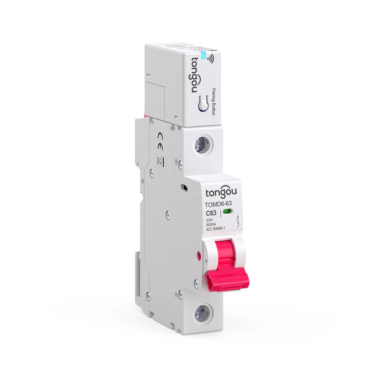

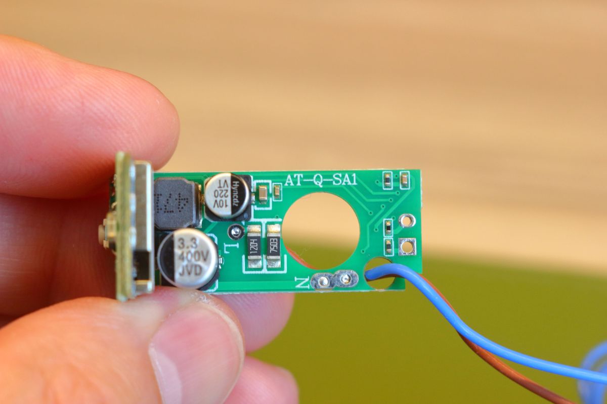

    Hi everyone,

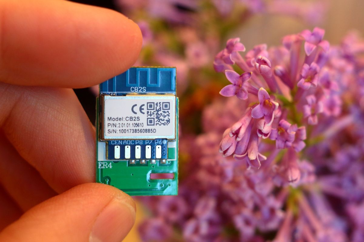

    I recently came across a very compact and seemingly well-designed smart energy meter called **Tongou TO-Q-SA1**. https://tongousmart.com/products/to-q-sa1-smart-energy-accessory-tongou
    It's a WiFi-enabled DIN-rail mounted meter, based on the Tuya platform. What's interesting is that it **doesn't have a relay inside**, which makes it potentially safer for inline monitoring use.
    It looks like a new device — I couldn’t find any threads or teardowns on Elektroda or anywhere else online. Even on Tongou’s official website, details are quite limited.
    Some key features:
    - WiFi connectivity (likely Tuya-based)
    - Measures voltage, current, active power, energy, and internal temperature
    - No relay, just pure monitoring
    - Easily disassembled (snap-fit case)
    - Two versions: Single-wire and Dual-wire input
    📌 **Questions:**
    1. Has anyone opened this unit and identified the **main controller or energy measurement chip**?
    2. Does it use **BK7231N** (Tuya’s Wi-Fi SoC), or something else?
    3. Has anyone successfully **flashed it with OpenBeken, Tasmota, ESPHome, or any other custom firmware**?
    4. Any info on UART pads or programming headers inside?
    I’d appreciate any pictures, insights, or experiences you can share!

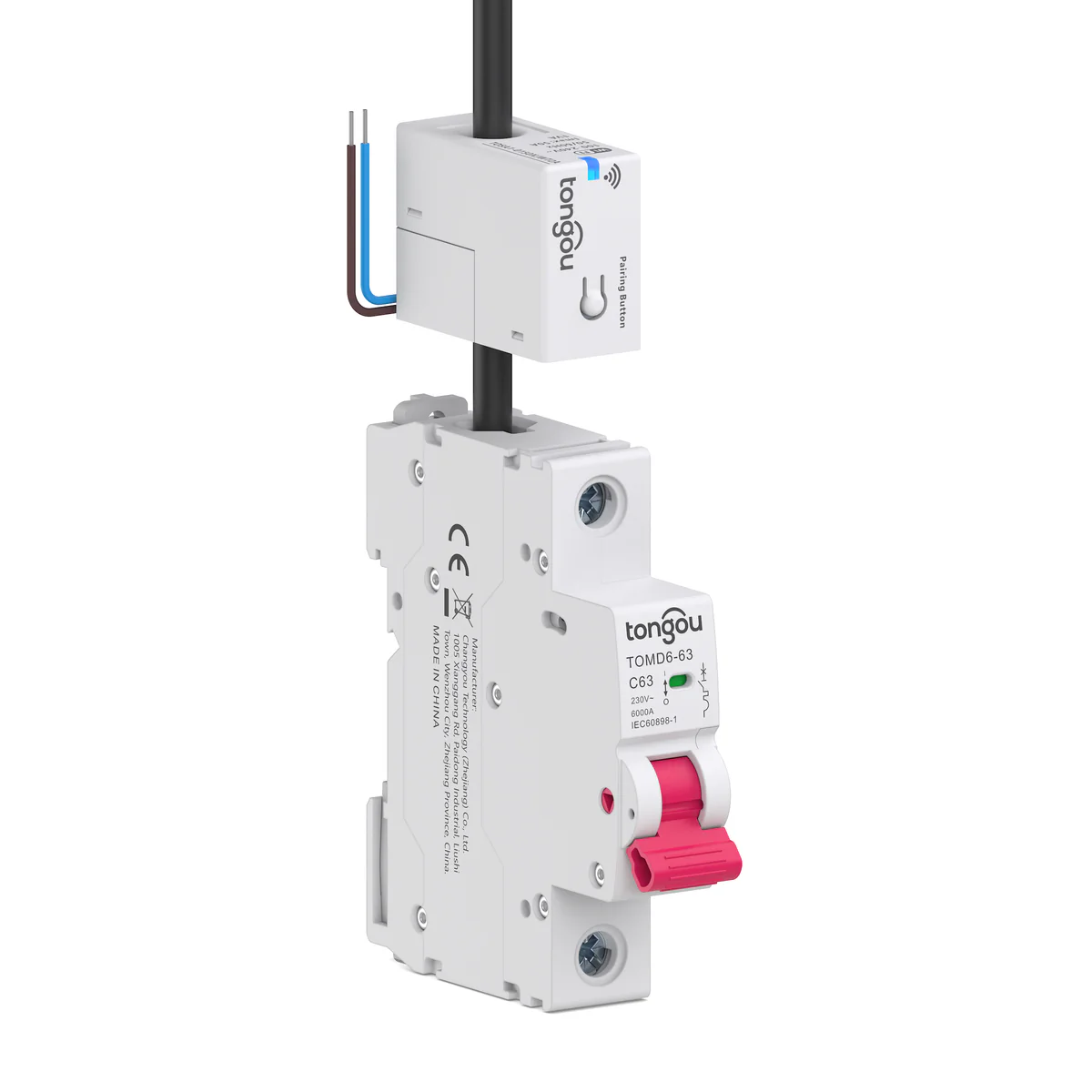

    TO-Q-SA1-Single-wire Version
    Automatic circuit breaker with a red switch, brand tongou, model TOMD6-63.
    TO-Q-SA1-Dual-wire Version
    Tongou circuit breaker with smart control module attached.

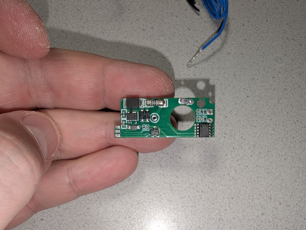

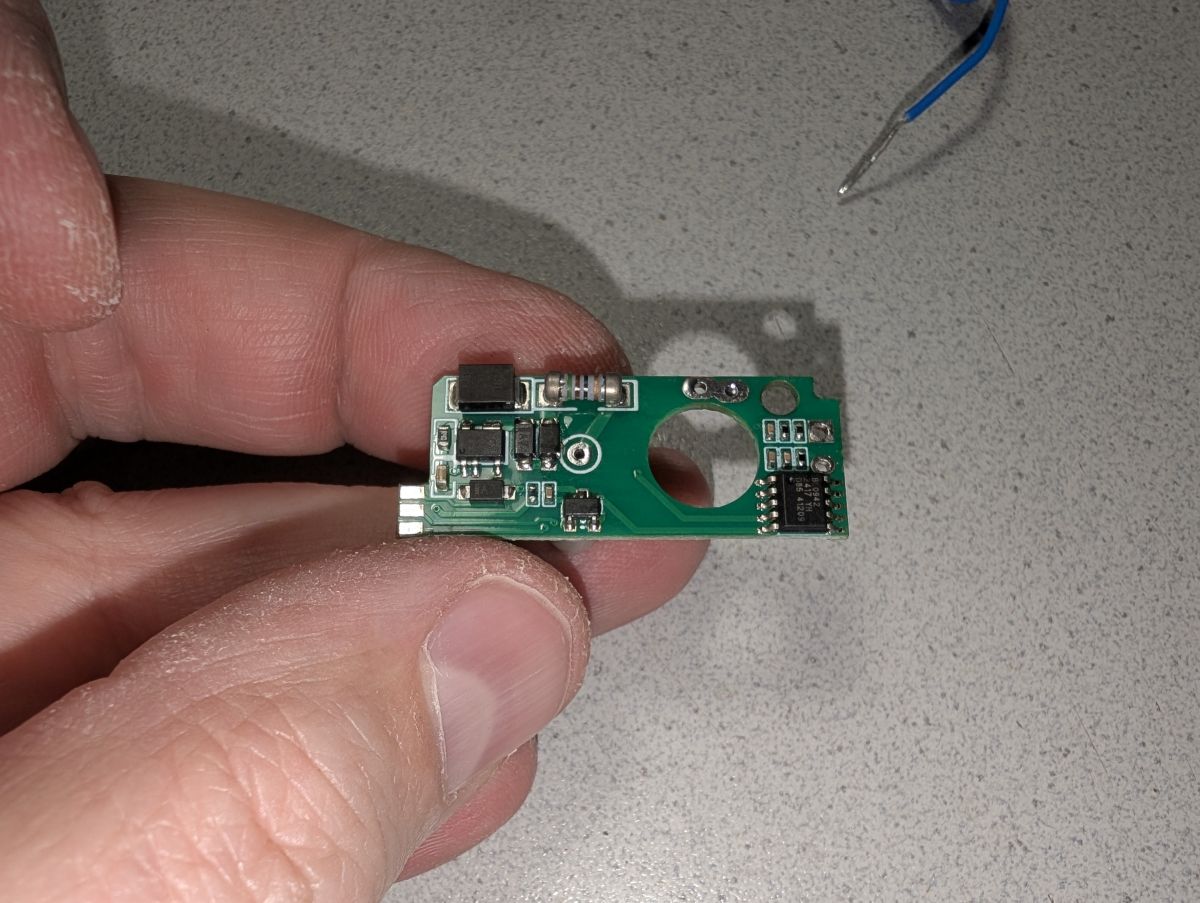

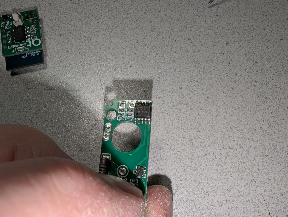

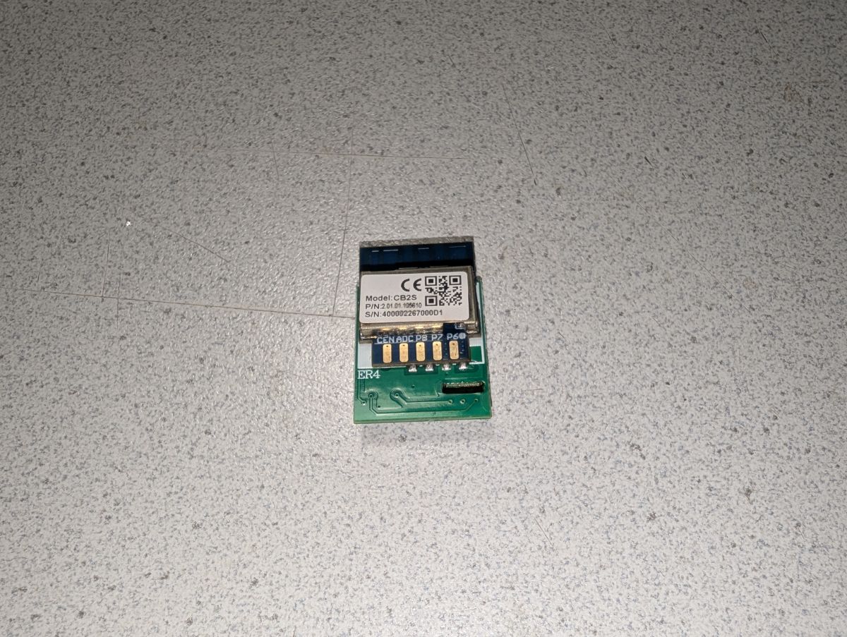

    We have flashed similar devices, but not this specific model. We can help you with whole process, but first you need to take one apart and make some photos from the inside. I can help with PCB analysis.
    Identified STC8H3K64S2, CB2S, and BL0942 chips

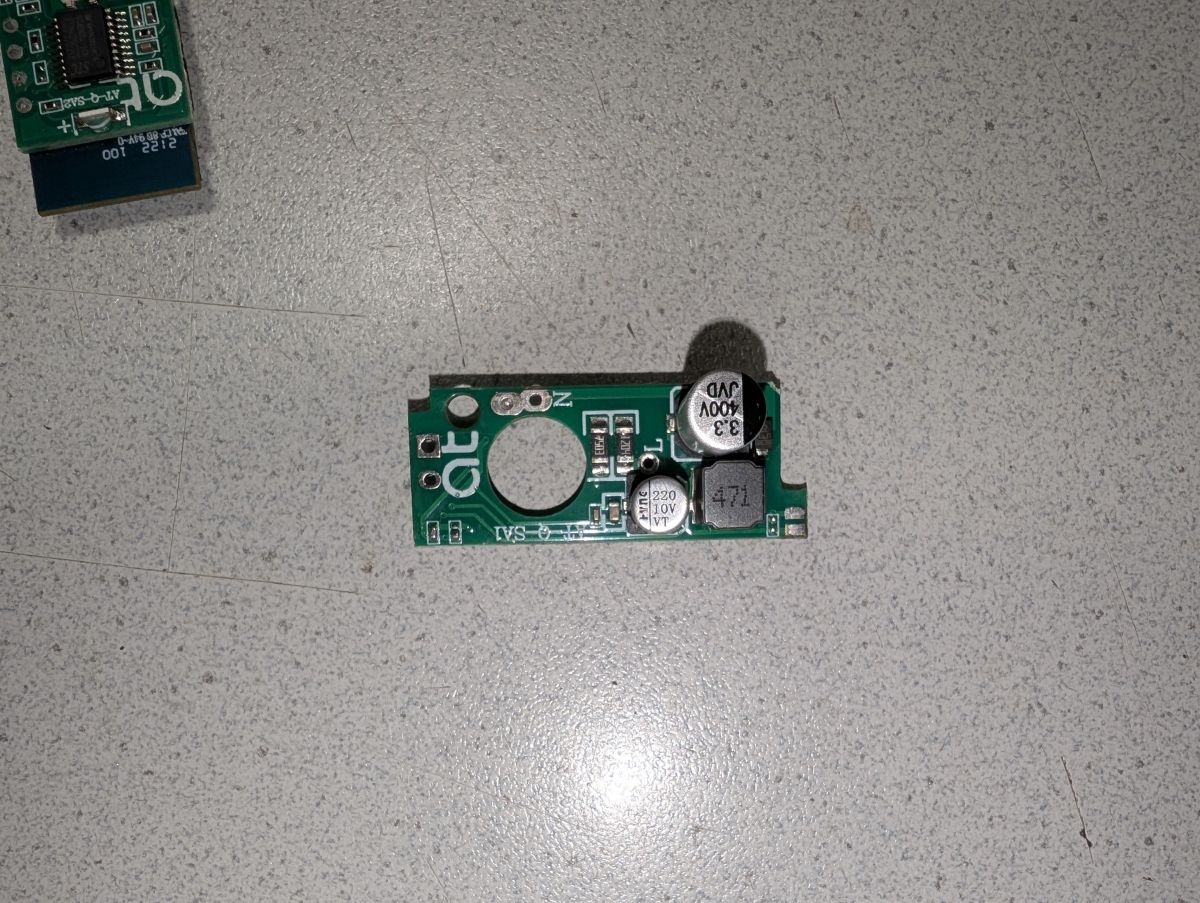

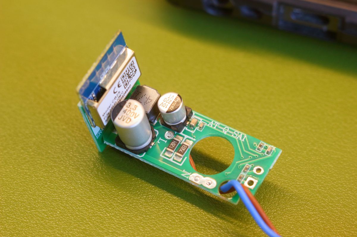

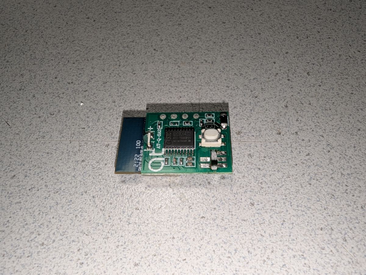

    #3 21562880
    kymlalu
    Posts: 13
    #4 21563065
    Posts: 14770
    Rate: 12913
    STC chip and only 4 pads of WB2S soldered? Well, it looks like TuyaMCU. We have a good TuyaMCU support in OBK.
    #5 21563237
    kymlalu
    Posts: 13
    Yea, only 4 pins.

    Can you take 2MB flash backup?
    BL0942 or TuyaMCU detected at 115200 baud
    #7 21563307
    kymlalu
    Posts: 13
    I hope i did that correctly.
    ( also edited post with pictures and added link to the power measuring chip for convinience)
       "baud":"115200"
    Sorry, no meaningful pins data found. This device may be TuyaMCU or a custom one with no Tuya config data.
    Baud keyword found, this device may be TuyaMCU or BL0942. Baud value is 115200
    No module information found.
    • readResult_BK7231N_QIO_TO-Q-SA1_2025-28-5-23-51-41.bin (2 MB) You must be logged in to download this attachment.

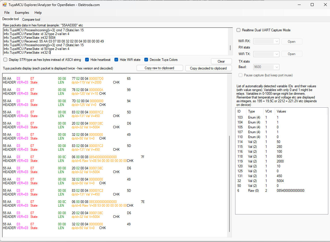

  • TuyaMCU analyzer failed to capture voltage DpIDs
    #10 21569307
    kymlalu
    Posts: 13
    Thank you for reply.

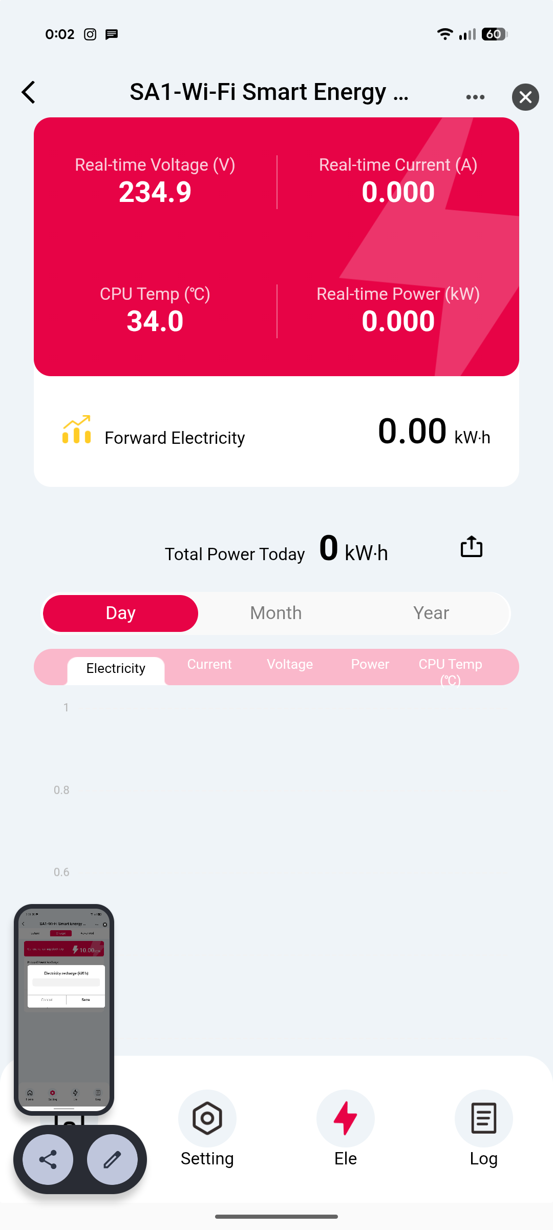

    Yesterday I tried to get DpIDs by using TuyaMCU analyzer (as I found tutorial) but it wasn't helpful at all. Mainly keep alive packets and switch from UI. I wasn't able to catch any data related to voltage (I had it connected through variac), which confuses me because in Tuya app I could see how it's changing but no data on serial.
    Also I tried to find in database but I guess that I used wrong keywords.
    I try to extract them by that linked tutorial (which I didn't find because I wasn't looking enough), just to learn how to do it (hopefully).
  • VCP format requires a different special key
    #11 21569350
    Posts: 14770
    Rate: 12913
    This is VCP:
          "desc_en": "1. Phase A voltage, current and power\n2. Big-endian HEX format, total 8 bytes\n3. Units: voltage 2 bytes (0.1V), current 3 bytes (0.001A), power 3 bytes (0.001kW)\n4. Example: 08 80 00 03 E8 00 27 10 means 217.6V, 1.000A, 10.000kW\n5. Communication: (1) Panel queries on entry, sends 0x08 to meter, meter reports to cloud, panel displays data (WiFi supported). (2) Meter periodically reports: every 15 seconds for WiFi, every hour for NB.",
    It seems I need to add a special key for this format, because the one we have, RAW_TAC2121C_VCP, does not match.

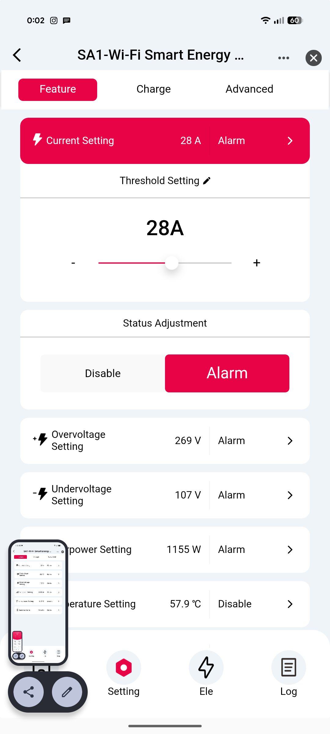

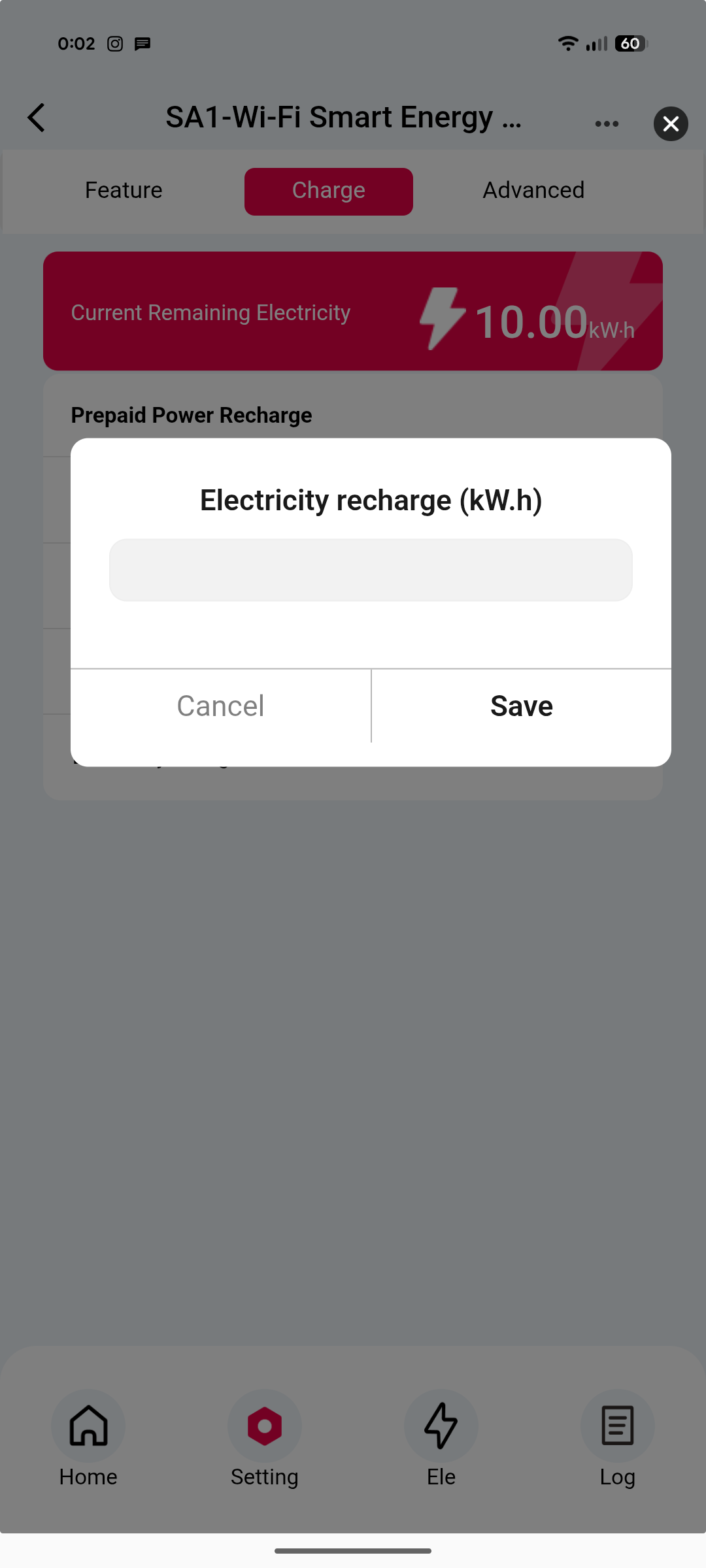

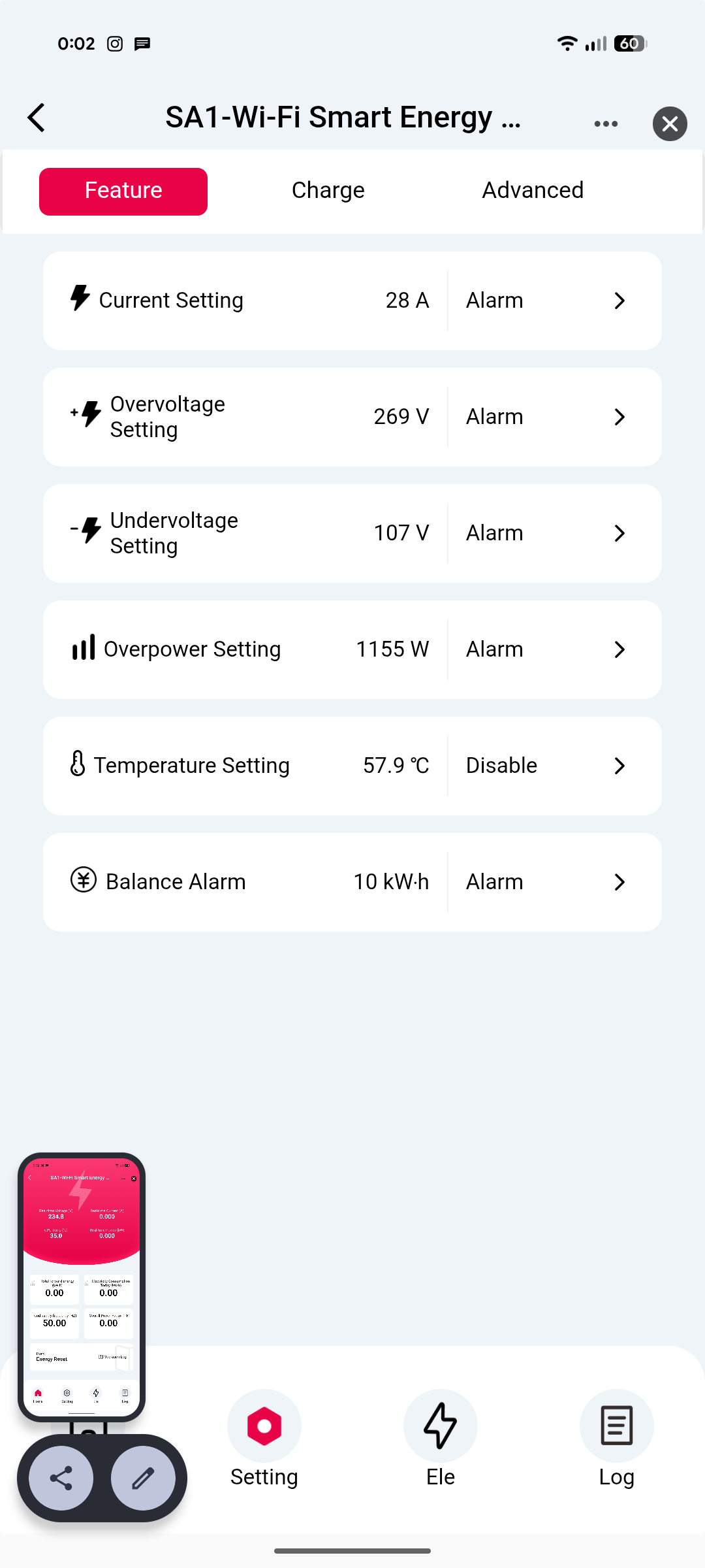

  • Captured Tuya protocol traffic and 26V DC supply test
    #16 21570161
    kymlalu
    Posts: 13
    There is some capture. Didn't have much time today to play with it.

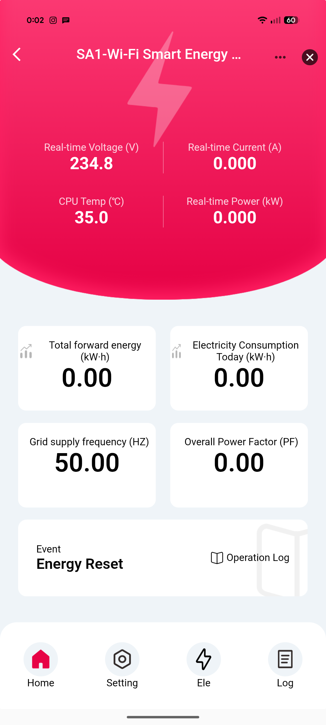

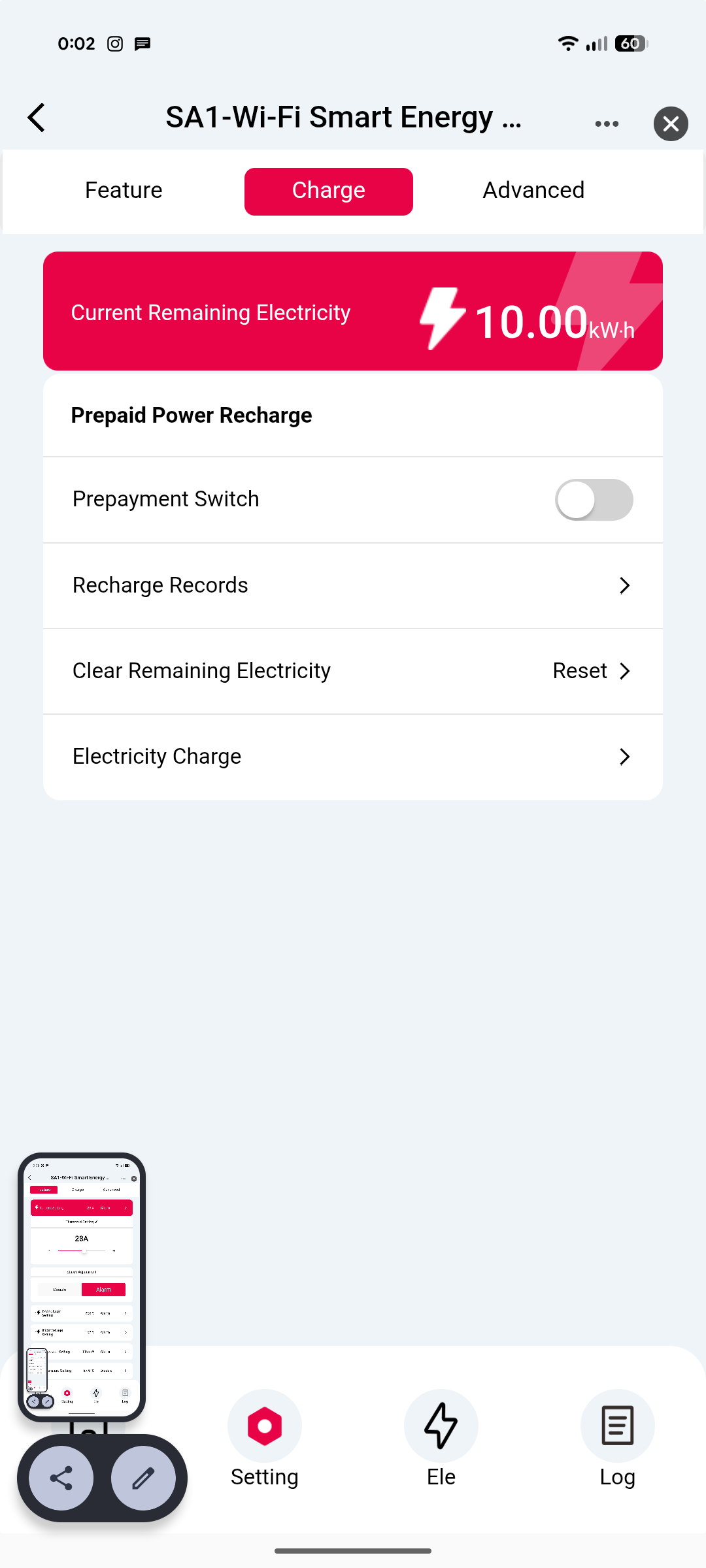

    Device with original FW, powered from socket (through variac, I also discovered that it works if you supply it with 26V DC - connected to wires that supposed to go on 230V).
    Device was booted up and I went through most clickable things in UI (see. screenshots) in that order.
    Captured HEX
    55AA00060008720200040000001CA155AA0006000568040001007755AA00000000FF55AA0006000568040001017855AA00060008730200040000010E9555AA00060008730200040000010E9555AA00060008730200040000010D9455AA0006000566040001007555AA0006000566040001017655AA00060008740200040000006BF255AA0006000567040001007655AA0006000567040001017755AA0006000877020004000004831155AA0006000569040001007855AA0006000569040001017955AA000600087602000400000244CF55AA000600087602000400000243CE55AA00000000FF55AA000600056B040001007A55AA00060008780200040000000A9555AA00060008780200040000000A9555AA0006000565040001007455AA0006000565040001017555AA000600050B010001011855AA000600050B010001001755AA00000000FF55AA000600050C010001011955AA000600080E020004000003E80C55AA00000000FF55AA000600050B010001011855AA00000000FF55AA00000000FF55AA00000000FF55AA000600050B010001001755AA0006000522010001012F55AA00000000FF55AA00000000FF
    I guess it didn't catch any measurements - I switched on 100W bulb as load. And I also changed voltage few times (from roughly 230V to 150V and back) - saw that in app but not in console (or maybe I'm doing something wrong) .
    A screen from an energy monitoring app showing voltage, current, and power consumption data.App screen for energy management with current, voltage, power, and temperature alarm settings.A screen of an app managing a smart energy meter with current, voltage, power, and temperature settings.App screen for managing a smart energy meter, displaying 10 kWh of remaining electricity.Smart energy app screen showing 10 kWh remaining and an electricity recharge input window.App screen for energy monitoring showing real-time voltage, current, CPU temperature and power.

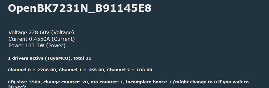

  • RAW_V2C3P3 config gives near-correct readings
    #17 21570955
    kymlalu
    Posts: 13
    more i read, more i am lost and confused.
    Anyway, i flashed it and there could be that DpID 6 ? ( only powered up, no current flowing through )
    Screenshot of TuyaMCU Explorer/Analyzer software, showing decoded UART communication data in text format.
    EDIT: I did some config ( use some examples and changed it to RAW_V2C3P3 ) and it seems that reading is almost correct. It is possible to do some "calibration" to have it more precise (voltage is off by 1V and current is off by 2mA )?
    Screenshot from OpenBK7231N interface showing device voltage, current, and power readings.
    Autoexec.bat
    // Start TuyaMCu driver
    startDriver TuyaMCU
    // set TuyaMCU baud rate
    tuyaMcu_setBaudRate 115200
    // set TuyaMCU default wifi state 0x04, which means "paired",
    // because some TuyaMCU MCUs will not report all data
    // unless they think they are connected to cloud
    tuyaMcu_defWiFiState 4
    // Measurements - Dpid 6 "phase_a" - channel RAW_V2C3P3
    // TAC2121C VoltageCurrentPower Packet
    // This will automatically set voltage, power and current
    linkTuyaMCUOutputToChannel 6 RAW_V2C3P3
    setChannelType 0 Voltage_div10
    setChannelLabel 0 "Voltage"
    setChannelType 1 Current_div1000
    setChannelLabel 1 "Current"
    setChannelType 2 Power
    setChannelLabel 2 "Power"

    Info:TuyaMCU:ProcessIncoming[v=3]: cmd 3 (WiFiState) len 7
    Info:TuyaMCU:Received: 55 AA 03 07 00 08 01 02 00 04 00 00 00 AF C7
    Info:TuyaMCU:ProcessIncoming[v=3]: cmd 7 (State) len 15
    Info:TuyaMCU:ParseState: id 1 type 2-val len 4
    Info:TuyaMCU:ParseState: int32 175
    Info:TuyaMCU:Received: 55 AA 03 07 00 05 0B 01 00 01 00 1B
    Info:TuyaMCU:ProcessIncoming[v=3]: cmd 7 (State) len 12
    Info:TuyaMCU:ParseState: id 11 type 1-bool len 1
    Info:TuyaMCU:ParseState: byte 0
    Info:TuyaMCU:Received: 55 AA 03 07 00 05 65 04 00 01 00 78
    Info:TuyaMCU:ParseState: id 101 type 4-enum len 1
    Info:TuyaMCU:Received: 55 AA 03 07 00 05 66 04 00 01 01 7A
    Info:TuyaMCU:ParseState: id 102 type 4-enum len 1
    Info:TuyaMCU:ParseState: byte 1
    Info:TuyaMCU:Received: 55 AA 03 07 00 05 67 04 00 01 01 7B
    Info:TuyaMCU:ParseState: id 103 type 4-enum len 1
    Info:TuyaMCU:Received: 55 AA 03 07 00 05 68 04 00 01 01 7C
    Info:TuyaMCU:ParseState: id 104 type 4-enum len 1
    Info:TuyaMCU:Received: 55 AA 03 07 00 05 69 04 00 01 00 7C
    Info:TuyaMCU:ParseState: id 105 type 4-enum len 1
    Info:TuyaMCU:Received: 55 AA 03 07 00 05 6B 04 00 01 01 7F
    Info:TuyaMCU:ParseState: id 107 type 4-enum len 1
    Info:TuyaMCU:Received: 55 AA 03 07 00 05 6E 04 00 01 00 81
    Info:TuyaMCU:ParseState: id 110 type 4-enum len 1
    Info:TuyaMCU:Received: 55 AA 03 07 00 08 72 02 00 04 00 00 00 32 BB
    Info:TuyaMCU:ParseState: id 114 type 2-val len 4
    Info:TuyaMCU:ParseState: int32 50
    Info:TuyaMCU:Received: 55 AA 03 07 00 08 73 02 00 04 00 00 01 18 A3
    Info:TuyaMCU:ParseState: id 115 type 2-val len 4
    Info:TuyaMCU:ParseState: int32 280
    Info:TuyaMCU:Received: 55 AA 03 07 00 08 74 02 00 04 00 00 00 64 EF
    Info:TuyaMCU:ParseState: id 116 type 2-val len 4
    Info:TuyaMCU:ParseState: int32 100
    Info:TuyaMCU:Received: 55 AA 03 07 00 08 76 02 00 04 00 00 03 20 B0
    Info:TuyaMCU:ParseState: id 118 type 2-val len 4
    Info:TuyaMCU:ParseState: int32 800
    Info:TuyaMCU:Received: 55 AA 03 07 00 08 77 02 00 04 00 00 07 D0 65
    Info:TuyaMCU:ParseState: id 119 type 2-val len 4
    Info:TuyaMCU:ParseState: int32 2000
    Info:TuyaMCU:Received: 55 AA 03 07 00 08 78 02 00 04 00 00 00 0A 99
    Info:TuyaMCU:ParseState: id 120 type 2-val len 4
    Info:TuyaMCU:Received: 55 AA 03 07 00 08 7D 02 00 04 00 00 00 AF 43
    Info:TuyaMCU:ParseState: id 125 type 2-val len 4
    Info:TuyaMCU:Received: 55 AA 03 07 00 08 83 02 00 04 00 00 02 3A D6
    Info:TuyaMCU:ParseState: id 131 type 2-val len 4
    Info:TuyaMCU:ParseState: int32 570
    Info:TuyaMCU:Received: 55 AA 03 07 00 08 20 02 00 04 00 00 13 8E D8
    Info:TuyaMCU:ParseState: id 32 type 2-val len 4
    Info:TuyaMCU:ParseState: int32 5006
    Info:TuyaMCU:Received: 55 AA 03 07 00 08 32 02 00 04 00 00 00 46 8F
    Info:TuyaMCU:ParseState: id 50 type 2-val len 4
    Info:TuyaMCU:ParseState: int32 70
    Info:TuyaMCU:Received: 55 AA 03 00 00 01 01 04
    Info:TuyaMCU:ProcessIncoming[v=3]: cmd 0 (Hearbeat) len 8
    Info:TuyaMCU:Received: 55 AA 03 07 00 08 01 02 00 04 00 00 00 B0 C8
    Info:TuyaMCU:ParseState: int32 176
    Info:TuyaMCU:Received: 55 AA 03 07 00 08 7D 02 00 04 00 00 00 B0 44
    Info:TuyaMCU:Received: 55 AA 03 07 00 08 0D 02 00 04 00 00 00 00 24
    Info:TuyaMCU:ParseState: id 13 type 2-val len 4
    Info:TuyaMCU:ParseState: int32 0
    As you can see, dpID 6 is completely missing, and only other IDs like 1, 11, and 101–103 are returned. This confirms that the MCU is alive and responding, but simply stops sending measurement data after ~30 minutes, even when explicitly queried.
    This strongly suggests that the MCU is intentionally suppressing dpID 6, probably due to missing Tuya cloud handshake or timeout. I don’t believe this is a hardware fault — it seems more like Tuya MCU firmware behavior.
    Let me know if you want me to try anything else.

    Add some photos of the device
    Tongou TO-Q-SA1 WiFi Smart Energy Meter – Anyone tried flashing it? Tongou TO-Q-SA1 WiFi Smart Energy Meter – Anyone tried flashing it? Tongou TO-Q-SA1 WiFi Smart Energy Meter – Anyone tried flashing it? Tongou TO-Q-SA1 WiFi Smart Energy Meter – Anyone tried flashing it? Tongou TO-Q-SA1 WiFi Smart Energy Meter – Anyone tried flashing it? Tongou TO-Q-SA1 WiFi Smart Energy Meter – Anyone tried flashing it? Tongou TO-Q-SA1 WiFi Smart Energy Meter – Anyone tried flashing it?

  • #25 21576633
    Posts: 14770
    Rate: 12913
    I just meant that you can try the same thing as @xury , add this to autoexec.bat and check again for few hours:
    addRepeatingEvent 10 -1 backlog uartSendHex 55AA000300010407; uartSendHex 55AA0008000007;uartSendHex 55AA00000000FF
    I just want to know. If it fails, we'll try to connect BL0942 directly to WiFi module.
  • Autoexec.bat commands to restore TuyaMCU reporting
    #26 21576662
    casiopeia80
    Posts: 15
    I added the following commands to the startup set:
    startDriver TuyaMCU
    addRepeatingEvent 10 -1 backlog uartSendHex 55AA000300010407; uartSendHex 55AA0008000007; uartSendHex 55AA00000000FF
    Then I power-cycled the module so that the MCU would start sending data every five seconds again, instead of once per hour like it does now.
    I’ll report back the results after half an hour.
