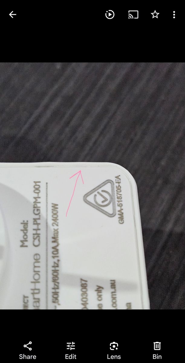

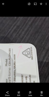

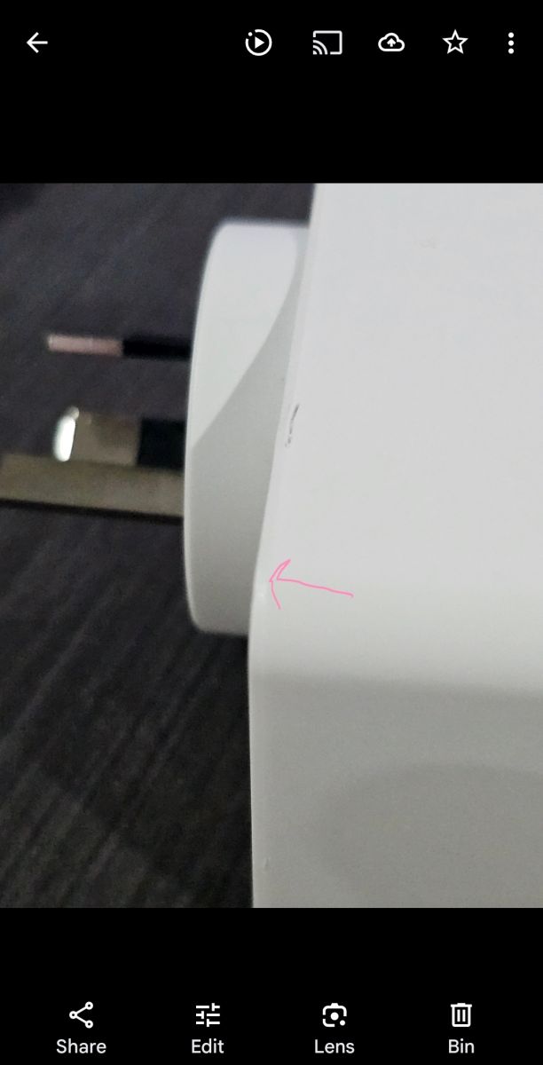

  • Asking which seam to use for opening the housing
    #5 21410569
    teeedubb
    Hi,
    Thanks for documenting and uploading the info on how to flash these devices.
    Do you have any pointers for opening the switch? There are no screws and it appears to be plastic welded closed - I don't want to damage the device trying to open it. There are two seams on the back of the drive - one around the face where the prongs are and another on the corner of the rear edge - which one did you use to open the housing? I've attached some photos which hopefully show the two seams I have identified.
    Thank you
    Close-up of a white electronic device with visible plug part, arrow pointing to a seam on the casing.
    Photo of the back of a device with model markings and a logo, with a plastic seam highlighted by an arrow.
  • #6 21411851
    andrewmarkcongdon
    Posts: 22
    The seam is the one in the second photo.
    I used a sharp chisel and a small hammer.
    You're trying to give it a shock more than cut.
    It's quite easy.
  • #7 21411881
    teeedubb
    Thank you very much, that did the trick. Gotta pry near the corners a bit to get them loose.
