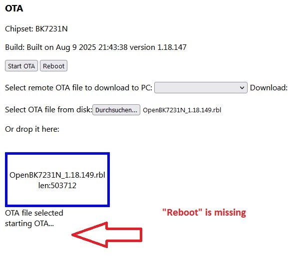

    After new versions of OBK were released, I investigated the problem further.
    Starting with my autoexec.bat, I found the line causing the problem:
    SetupEnergyStats 1 60 1440 1
    The problem appears as follows in the web interface:
    OTA interface with uploaded file and missing Reboot button after update starts
    The reboot is triggered too early. The "Reboot" entry in the web interface does not appear.

    Probably this is related to this:
    https://www.elektroda.com/rtvforum/topic4133787.html
    It looks like we need to stop all drivers when OTA is running. I was kinda sure we already do it? I need to check.

  • #7 21632081
    Posts: 14534
    Help: 654
    Rate: 12536
    I can see there are some ota_progress guards in some places, but DRV_RunQuickTick is still called without it.
