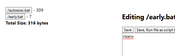

  • #6 21649361
    Posts: 5220
    Help: 449
    Rate: 918
    oops.
    Screenshot of an editor showing editing of early.bat file with a typo in the word clear.
    no joy still

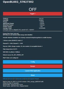

  • #13 21649473
    Posts: 5220
    Help: 449
    Rate: 918
    insmod wrote:
    https://github.com/openshwprojects/OpenBK7231T_App/pull/1782
    works for me. no autoexec now
    Screenshot of the OpenBL602 device interface showing OFF status and detailed device statistics.
