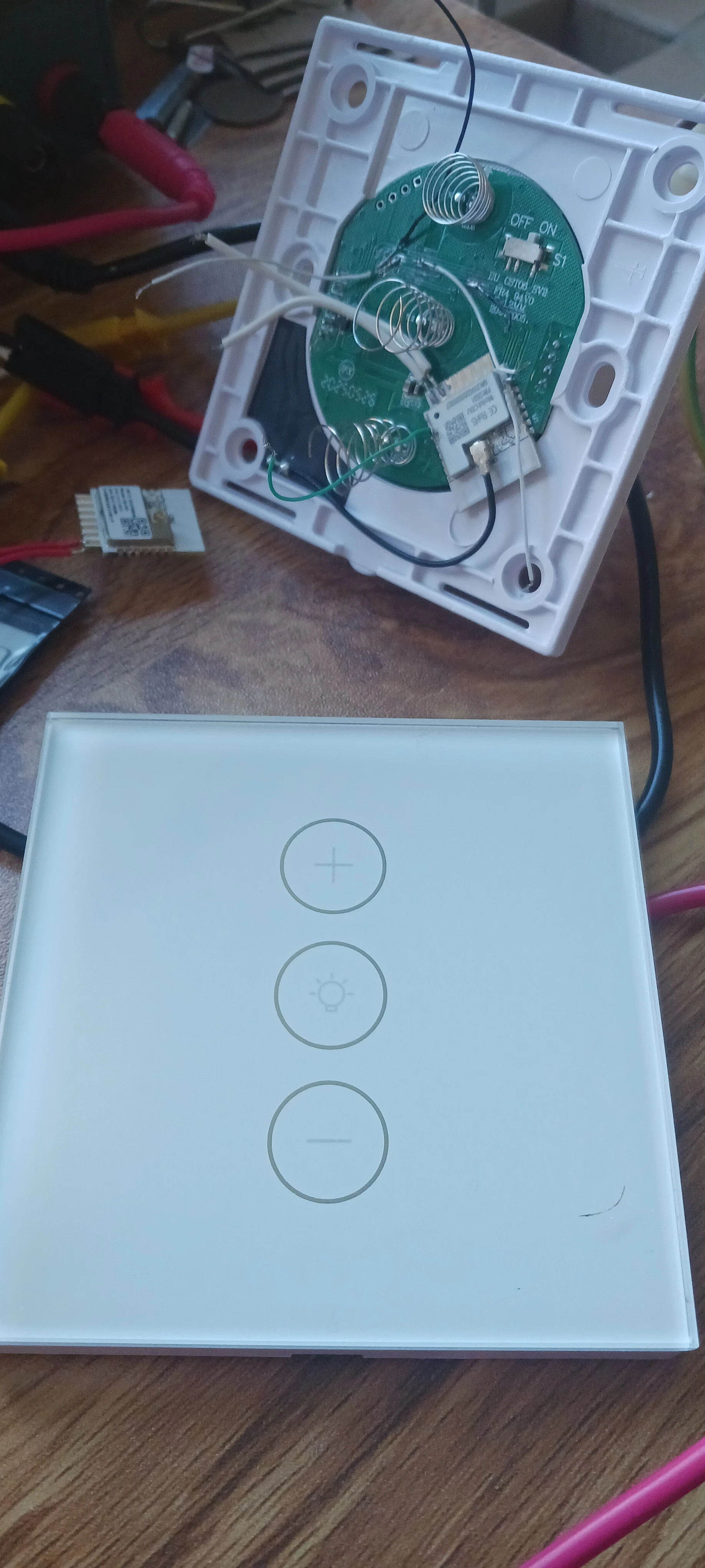

    I have a Tuya dimmer switch, It has a Beken unit in it BK7231N it had a and and - symbol on it and a middle on and off switch.
    It talks serial to a chip that is unmarked with a baud rate of 9600

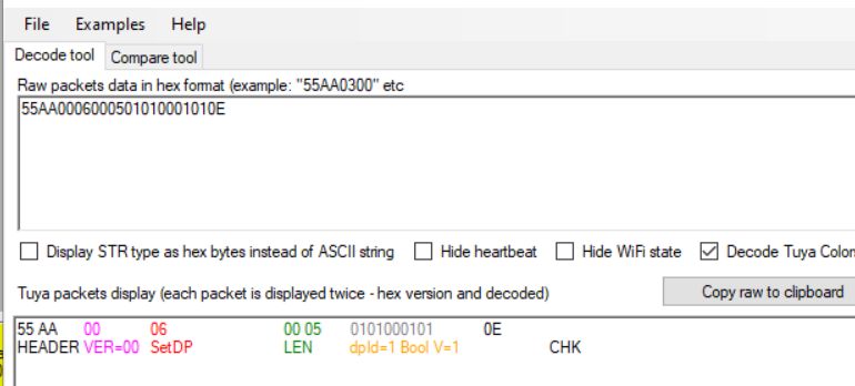

    AddChangeHandler Channel1 == 1 uartSendHex 55AA0006000501010001010E
    AddChangeHandler Channel1 == 0 uartSendHex 55AA0006000501010001000D

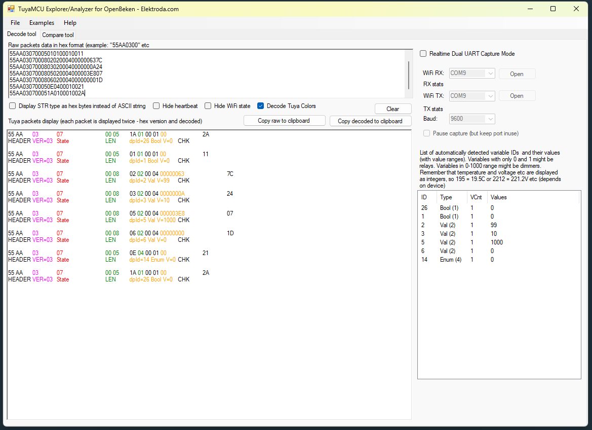

    You are manually sending data via UART. You're sending SetDP command:
    Screenshot of a tool decoding Tuya data packets in hexadecimal format
    Why not do it directly, with our TuyaMCU driver?
    It will work in both directions then.
    Our command is: linkTuyaMCUOutputToChannel
    https://www.elektroda.com/rtvforum/find.php?q=linkTuyaMCUOutputToChannel
    Here is one of my dimmer guides:
    https://www.elektroda.com/rtvforum/topic3929151.html
    You can see my autoexec.bat there and how I used linkTuyaMCUOutputToChannel to link TuyaMCU dpIDs to OBK channels.
    It's very easy to run TuyaMCU with OBK, it's the recommended solution. You can do it also manually with OBK scripts and uartSendHex , but why?
    My suggestion: remove all uartSendHex calls and use linkTuyaMCUOutputToChannel for all dpIDs.
