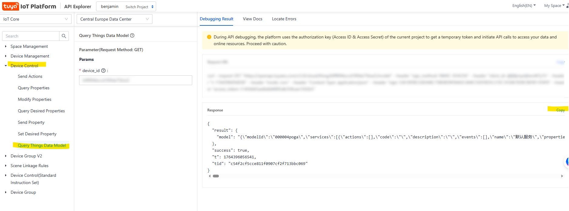

    I was able to fetch the DIP list from the Tuya Developer Console. It's attached in the post.
    I also attached a list of commands generated by ChatGPT, but the values are always zero. I'm not sure if I need to configure anything extra on pin config.

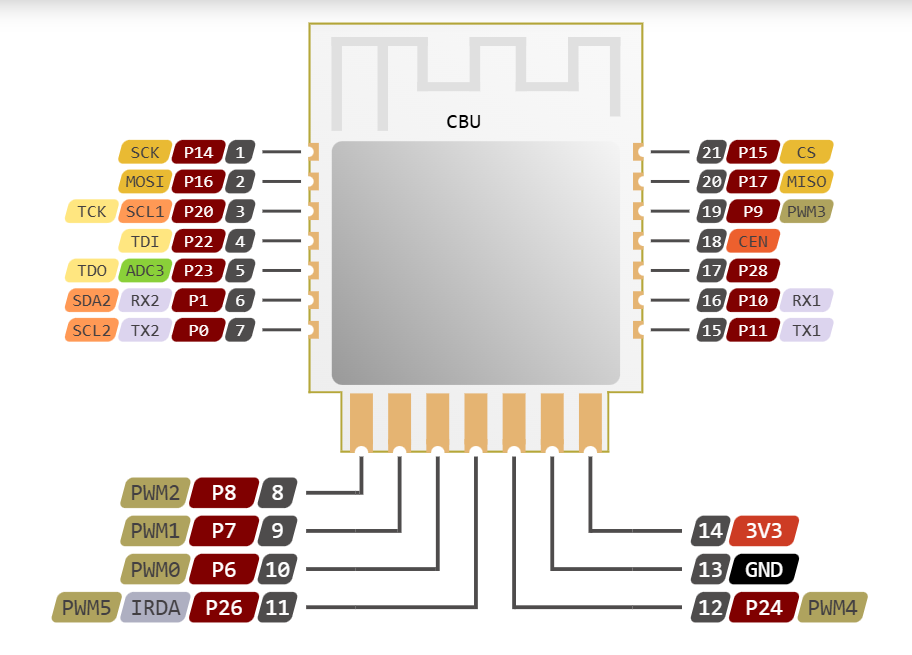

    any signs of life if you toggle flag 26
    have you determined which UART is connected to the TuyaMCU? from which are debug logs output?
    Pinout diagram of an electronic module with labeled functions and pin numbers
    If you have a flash backup I can check it's talking TuyaMCU and on which UART. If there's a chance it contains your wifi creds from pairing before backup feel free to DM it to me and I'll give it a go/reset it.

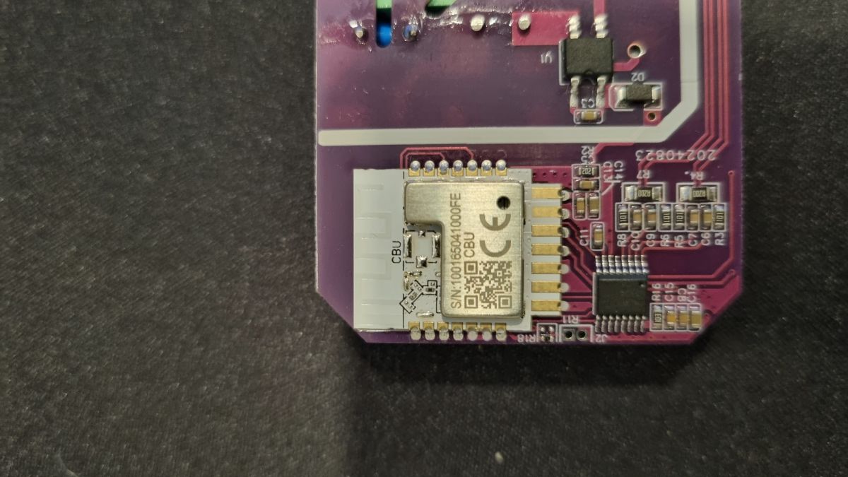

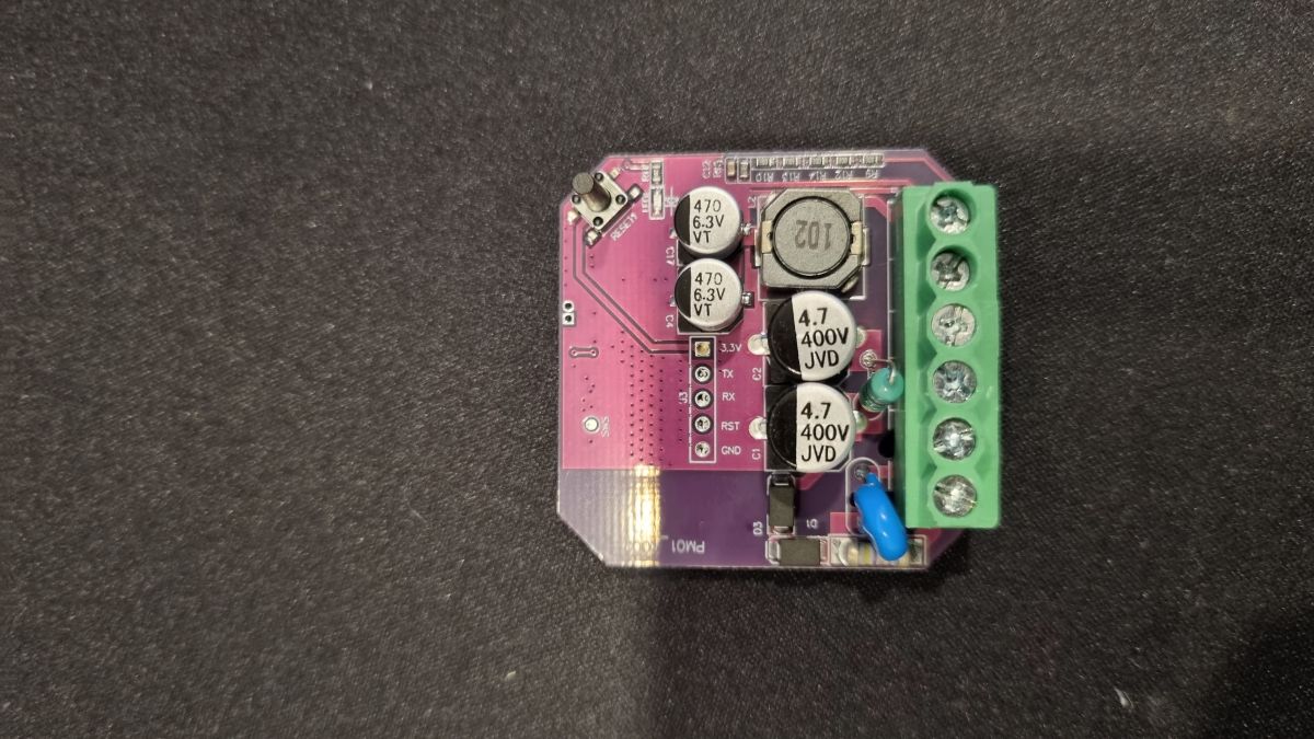

    got any pics of the insides?
  • #5 21775682
    emanuellopespt
    Hey @divadiow, sorry for the delay, but I was out of the home.

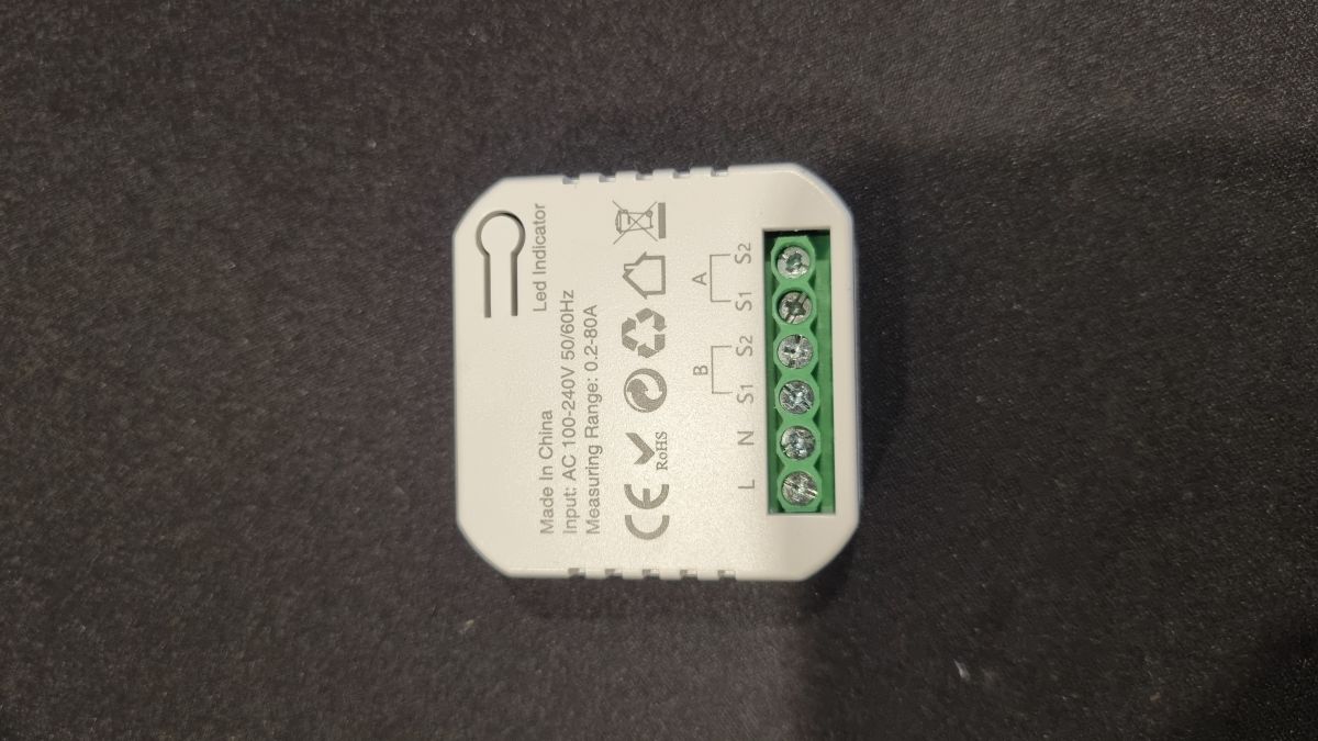

    This is dual, but I only use one.
    Small electrical device with six screw terminals labeled L, N, S1, S2
    PCB with capacitors, coil, and screw terminals on a black background Purple PCB with Wi-Fi module and surface-mounted components Radio module on a purple PCB with visible traces and SMD components
  • #6 21862655
    gompkaa
    I have the same module, also was able to get openbekin on the module and connected to Wi-Fi, but not sure where to go from here. The unit has an HLW8112 chip for power metering.
