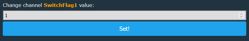

    I have some questions about Web GUI customization:
    I have a Channel setup for GUI like this:
    Channel SwitchFlag1 value input with numeric box and blue “Set!” button
    When you click Set! button the channel value get updated and I can get an addChangeHandler to recognize the change. That works fine.
    I want to be able to set few Channel values like this and then finally execute a command alias from the script.
    Questions:
    1. Is there a way to create a web button on the GUI and when clicked trap that click in the script (some sort of event handle or channel value change)?
    2. Is there a way to change the label of the "Set!" button to something else?

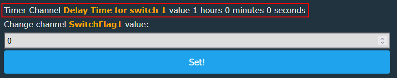

    Now I have this issue:
    I setup a channel to store a timer value:
    setChannel 19 3600
    setChannelType 19 TimerSeconds
    // Add a label in GUI
    setChannelLabel 19  "<b><span style='color:orange'\>Delay Time for switch 1</span></b>"
    However on the GUI it does not give an option for changing the value:
    GUI screen with a timer label and input for changing SwitchFlag1 channel
    How can I create a changeable channel value on the GUI?
