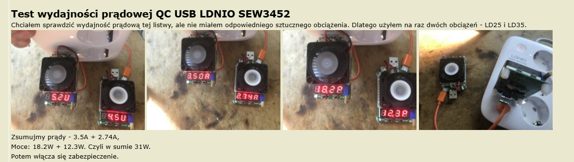

    I have sent you two extensive reviews of this type of product, have you read them? Such comprehensive topics are a small who's who, and there is probably an answer to your question there too.
    Load test of two USB ports showing current and voltage readings with cooling fans .
    In the pictures above, I'm drawing 3.5A from one port and 2.74A from the other. At slightly higher currents the protection is already switching on. So yes, in general it is rather manageable to safely draw 2A each from the two ports (4A in total).
    In the pictures above, I am drawing 3.5A from one port and 2.74A from the other. At slightly higher currents the protection is already switching on. So yes, in general it is rather possible to safely draw 2A from the two ports (4A in total).
    Thanks for the hints.
    That's how I read the review, I suggested that you load from port C and A at the same time. But from the 2xA port it will also manage.
