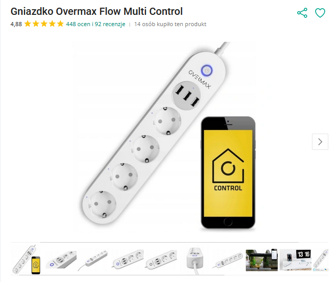

    Purchase Overmax Flow Multi Control
    The strip was purchased for PLN 125:
    Overmax Flow Multi Control power strip with four sockets and three USB ports next to a smartphone with an app.
    Below are screenshots of the offer:
    Overmax Flow Multi Control power strip with four outlets and three USB ports.
    Declared 2.1A at 5V - we will check.
    The rest of the description praises the manufacturer`s application, but we will still upload our own firmware:
    Overmax Flow Multi Control smart power strip with smart home features in informational images.

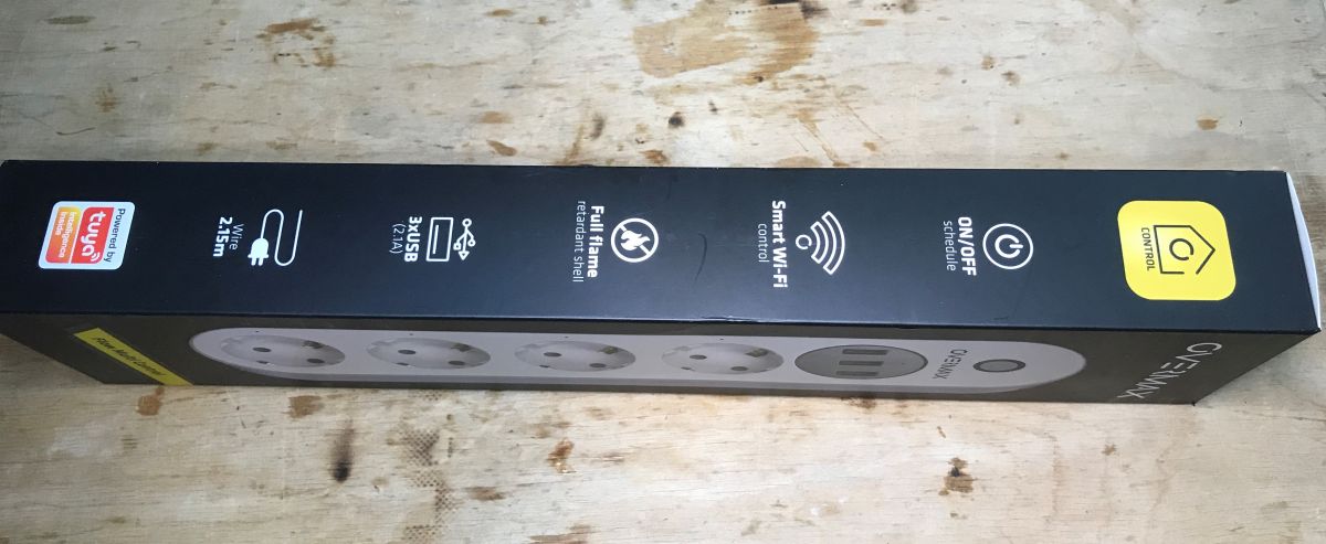

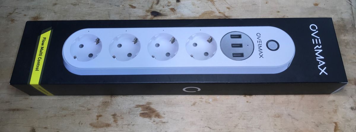

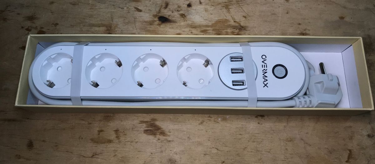

    Packaging with markings:
    Packaging of the Overmax Flow Multi Control power strip. Packaging of the Overmax Flow Multi Control power strip with four Schuko sockets and three USB ports. Packaging of Overmax Flow Multi Control power strip
    Unfortunately, I don`t see any specific model number here...
    Power strip with four SCHUKO sockets and three USB ports in a box.

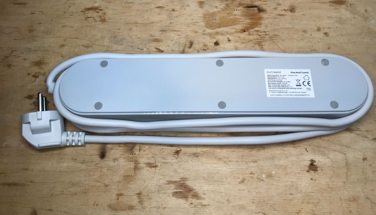

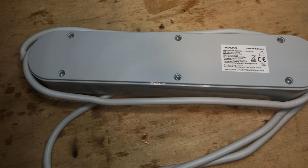

    The bottom of the strip, the nameplate, this model is actually called Flow Multi Control:
    Bottom view of Overmax Flow Multi Control power strip with a nameplate label. Bottom of Overmax Flow Multi Control power strip with a specification label.

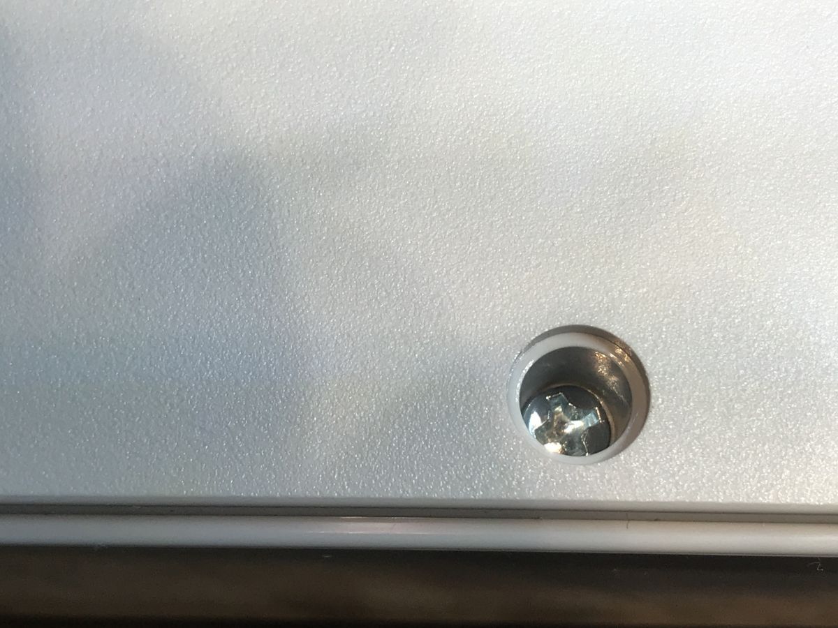

    The screws are hidden under the legs:
    Screw in a white electrical device casing.

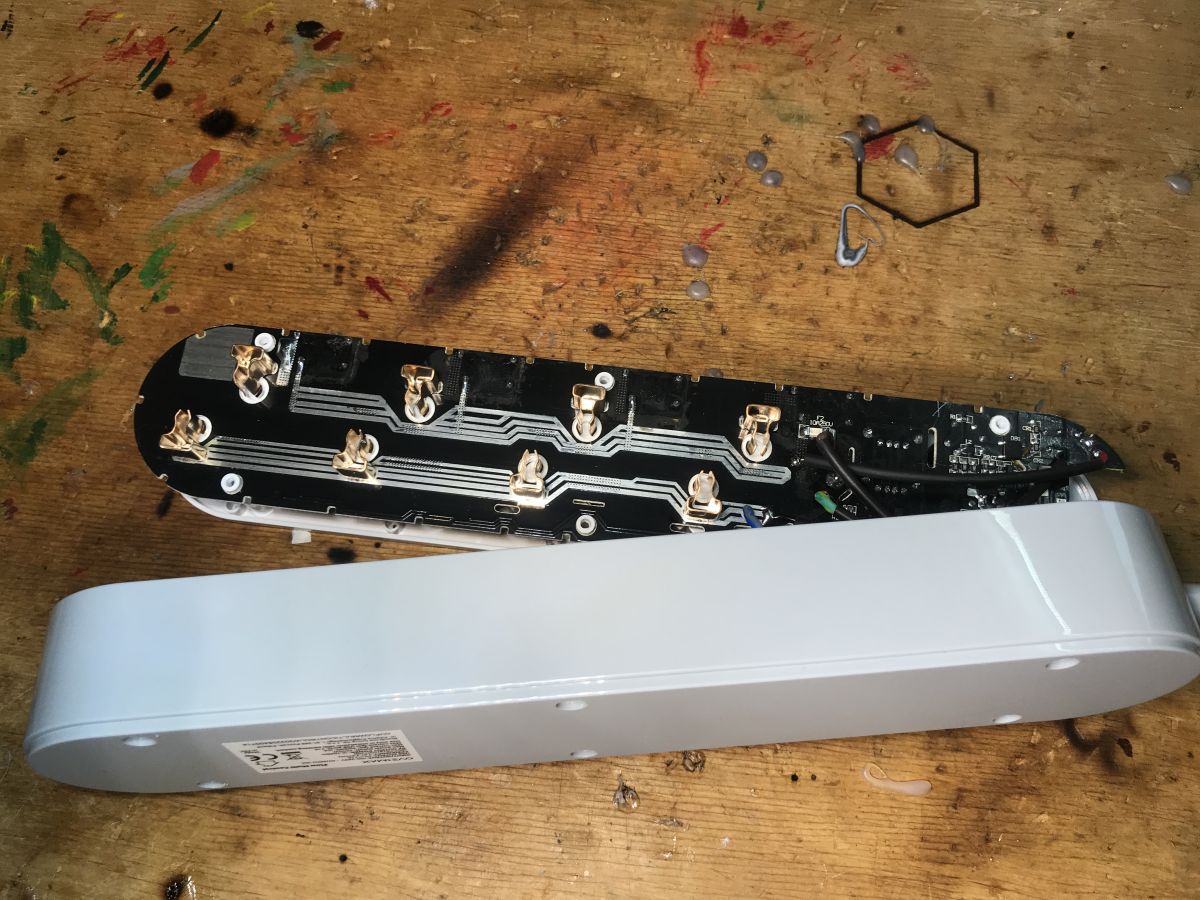

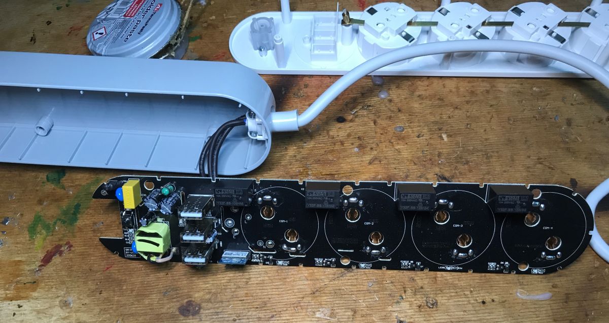

    We unscrew it and look inside:
    Interior of the Overmax Flow Multi Control power strip on a wooden table.

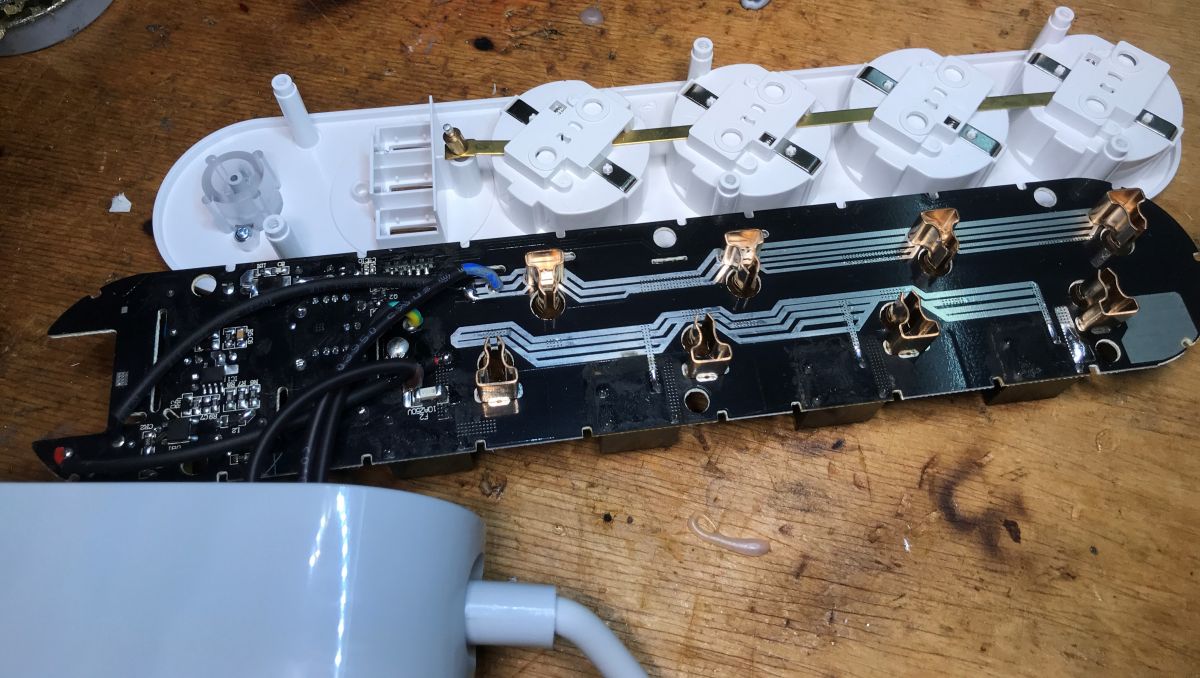

    The wires hold the board, but it can be removed to some extent:
    Interior of Overmax Flow Multi Control showing PCB and wires.

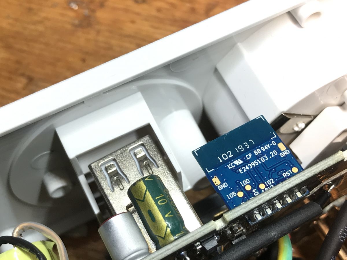

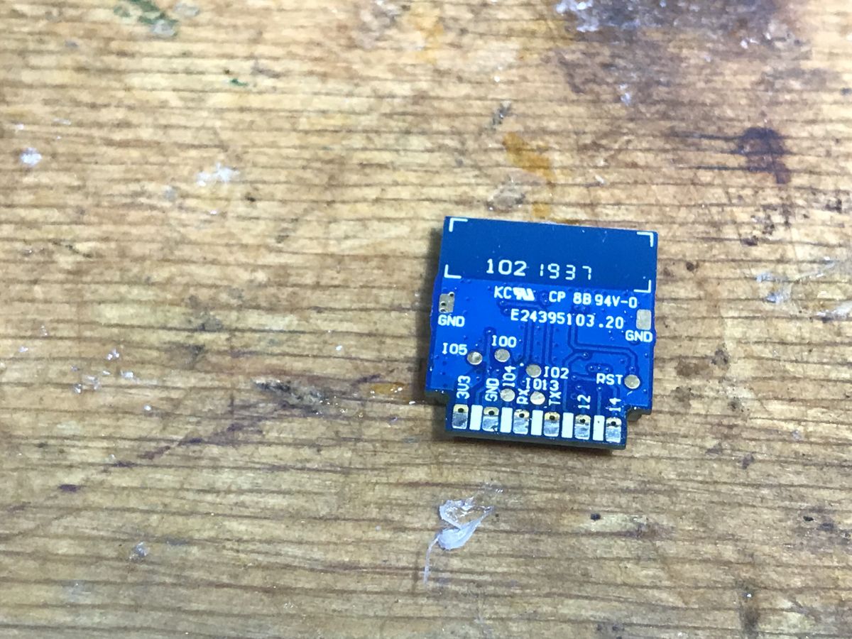

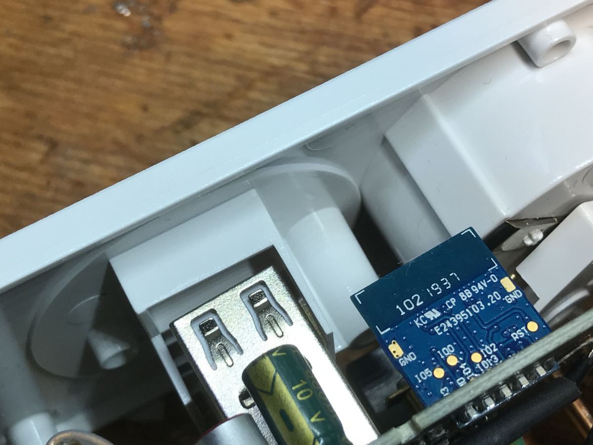

    You can already see the WiFi module, IO0 indicates that there is ESP there:
    Interior of a power strip showing a WiFi module and USB ports. Interior view of Overmax Flow Multi Control device with WiFi module and USB port.

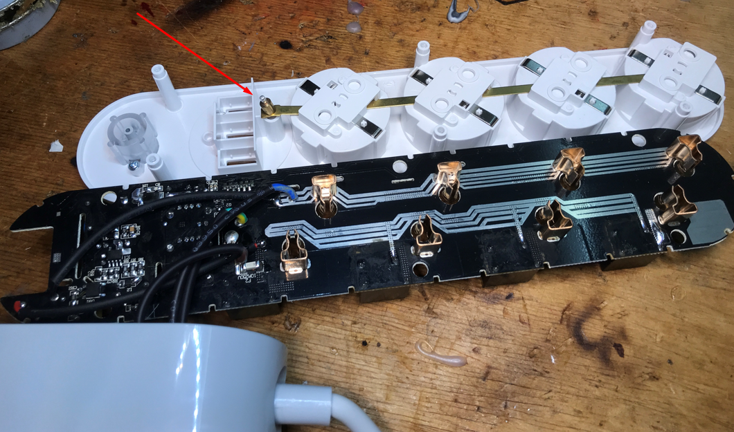

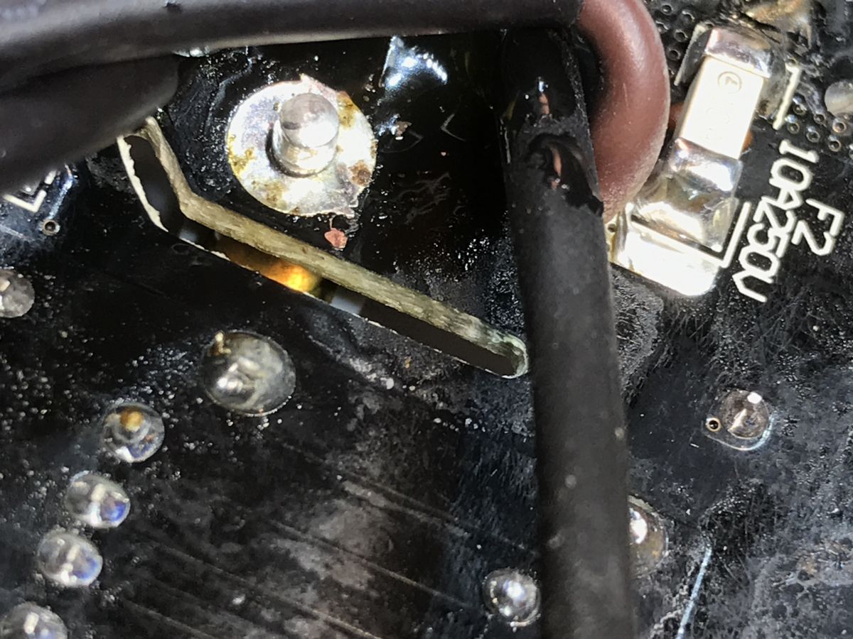

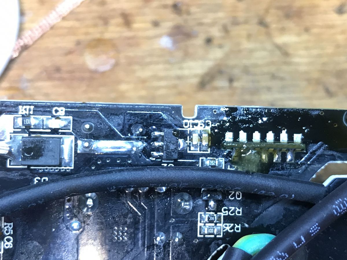

    It is necessary to separate the upper part of the housing from the PCB unsoldering the thick pin from ground : :
    Interior of a power strip with four sockets and circuit boards, showing electronic components.
    Interior of the Overmax Flow Multi Control power strip after partial disassembly.
    You can already see the relays and LEDs illuminating the sockets and the power supply section:
    Interior of a disassembled power strip with four outlets and three USB ports.

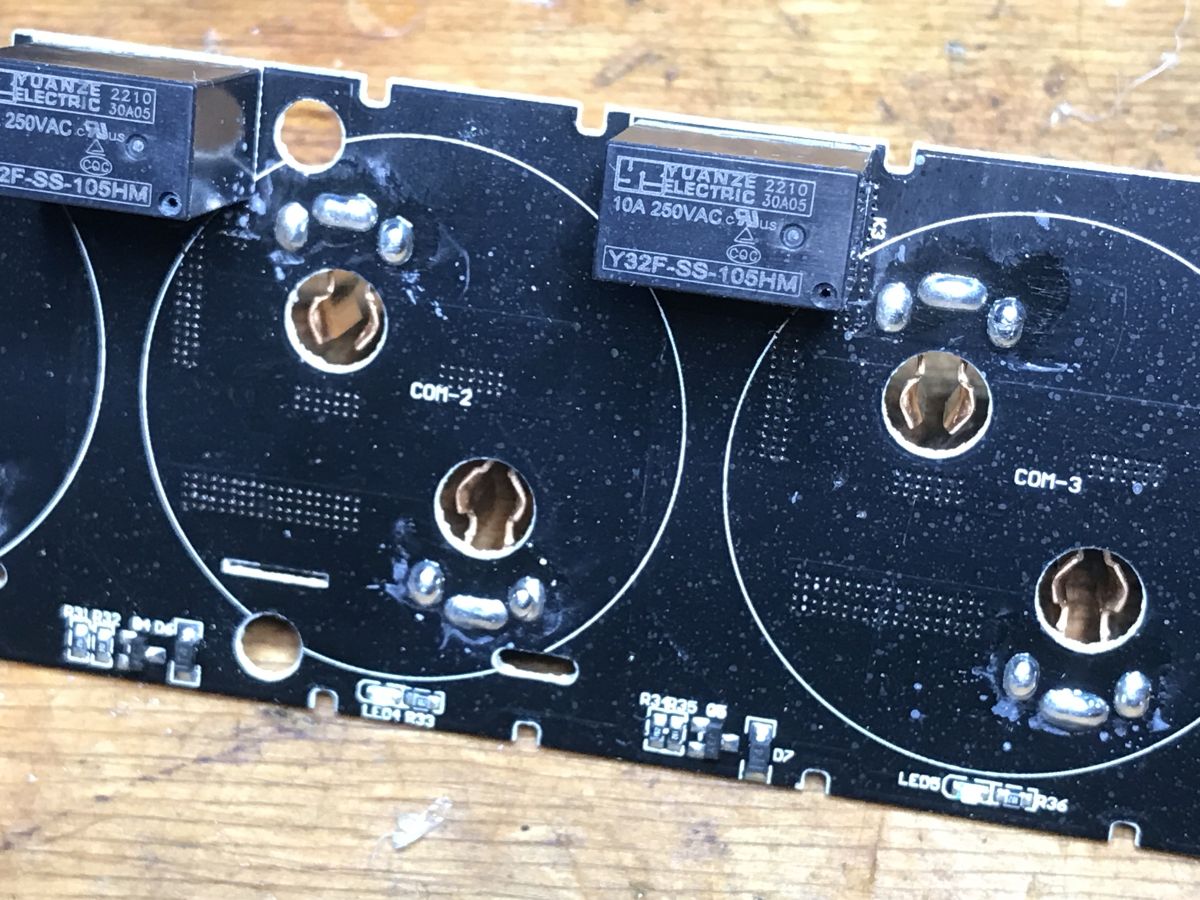

    The relays are Y32F-SS-105HM:
    PCB with Yuanze Y32F-SS-105HM relays

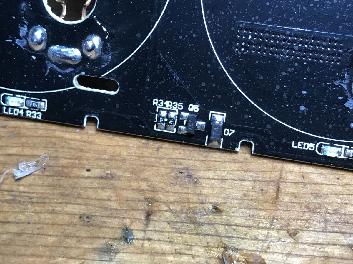

    They are controlled by J3Y transistors:
    Close-up of a circuit board with electronic components.

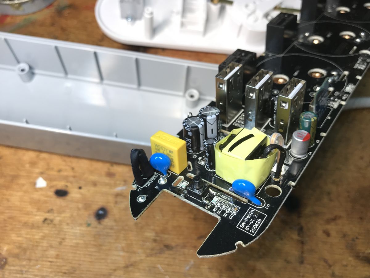

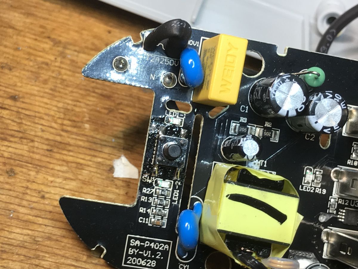

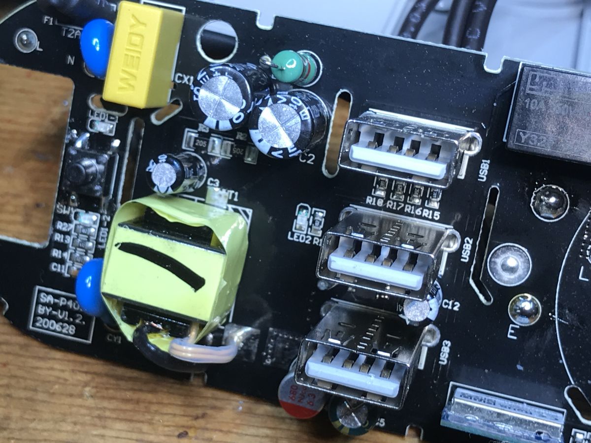

    Let`s look at the power supply section - it`s a regular flyback, without QC, it`s good that at least there is a fuse resistor, a varistor and a filter capacitor at the input:
    Close-up of the Overmax Flow Multi Control power strip's main board. Close-up photo of the interior of the Overmax Flow Multi Control power strip, showing electronic components on the circuit board. Close-up of PCB with components marked T2A250V, Wedy capacitor, and blue component.

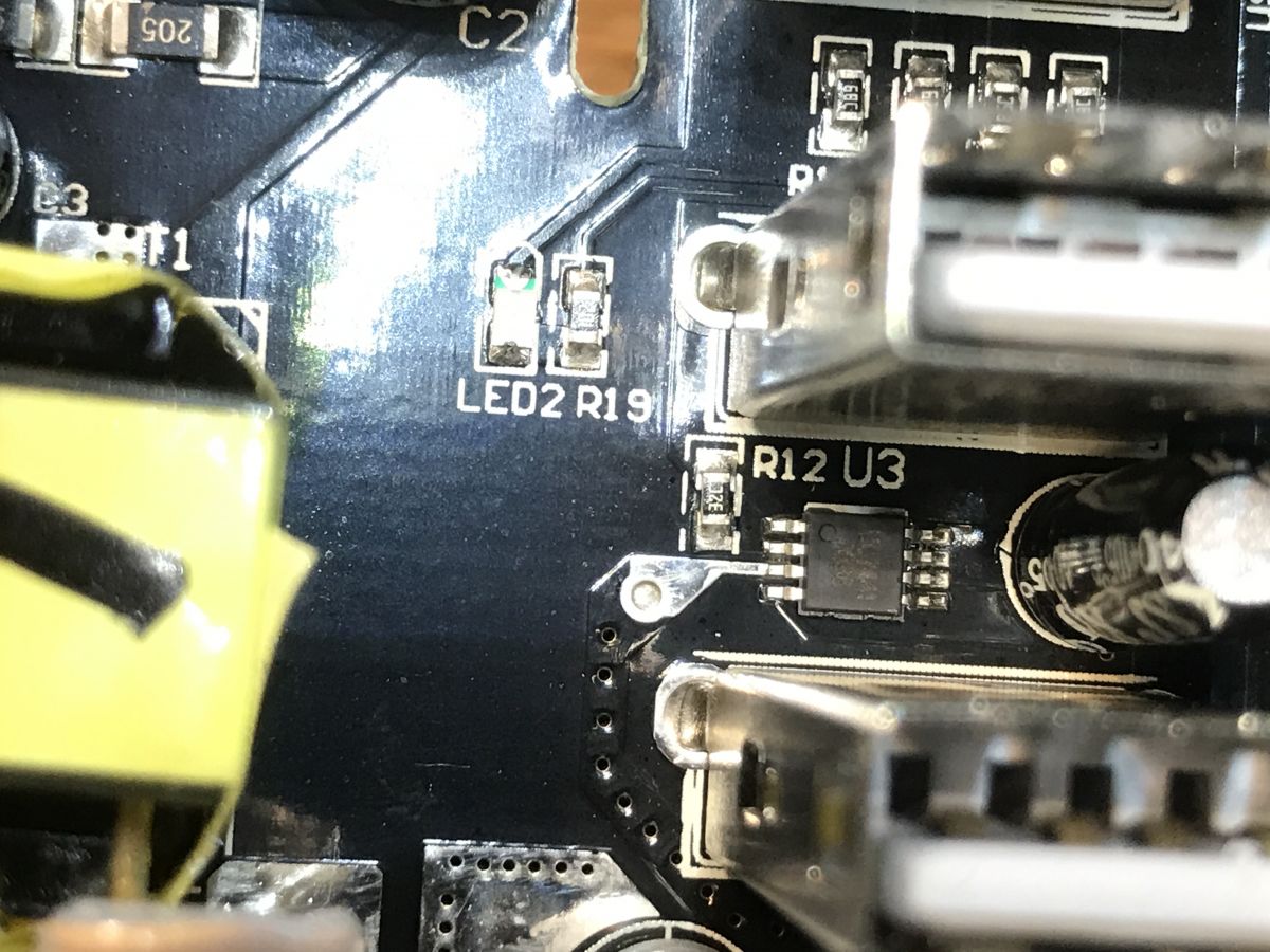

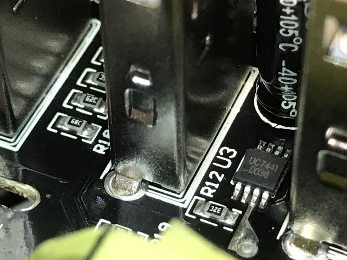

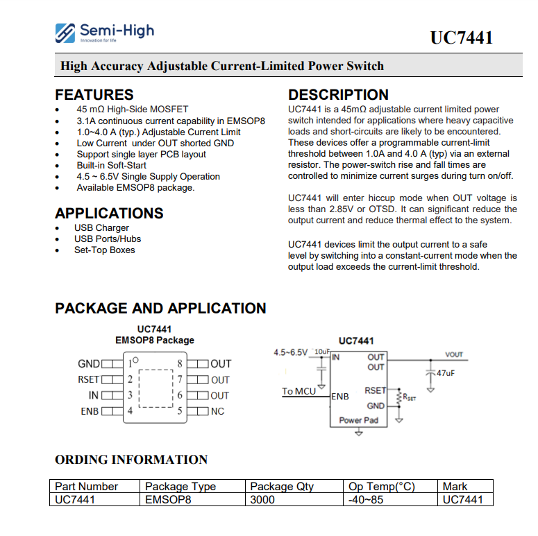

    LittleI was surprised by the U3 circuit near the USB connectors, I thought it was something to do with charging negotiations, in cheaper products we simply have resistors that set the levels at D+ and D-:
    Close-up of the PCB of Overmax Flow Multi Control showing a UC7441 chip and USB ports. Close-up of the interior of an Overmax power strip showing electronic components
    And yet UC7441 seems to be an overload protection, interesting:
    Technical specification of the UC7441 current-limited power switch.
    We look further:
    View of the interior of the Overmax Flow Multi Control power strip with visible electronic components.

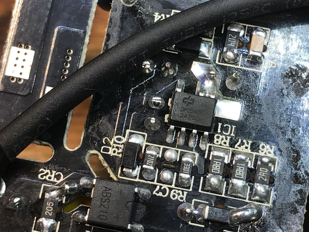

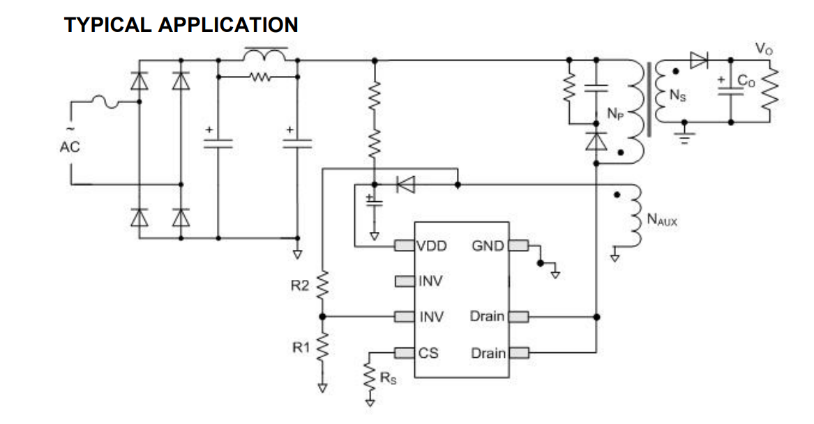

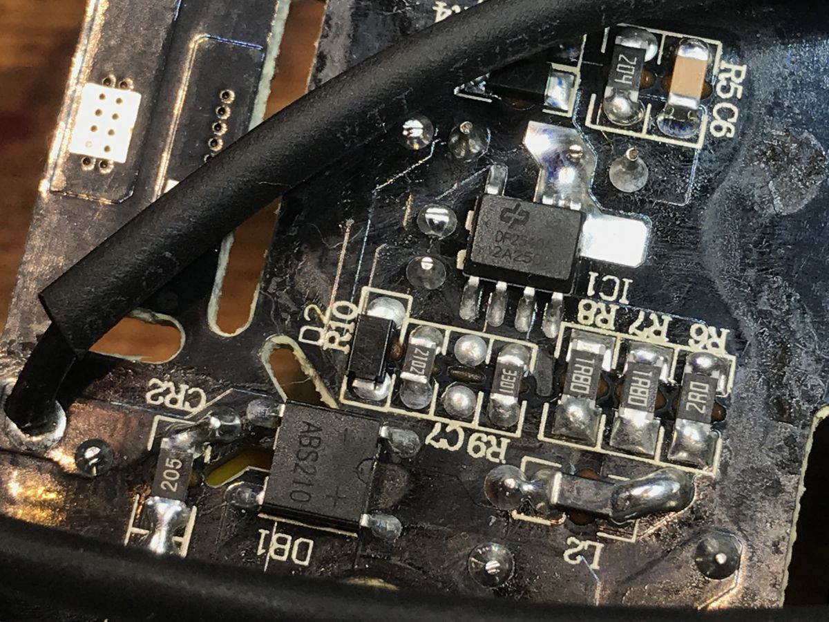

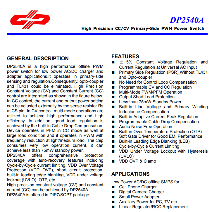

    The power supply itself is based on DP2540A:
    Close-up of PCB electronic components with resistor and semiconductor labels. Close-up of a circuit board with electronic components.
    There is some information about it on the Internet:
    Technical description of the DP2540A chip on a white background.
    There is also an example diagram of such a converter, which in my opinion is the most typical circuit, which I have already discussed several times, so I will not comment on it further here:
    Typical flyback converter application schematic with components and connections.

    It is best to desolder TYWE2S, I recommend the flux + braid method:
    Close-up of internal components on the Overmax Flow Multi Control circuit board. Electronic module TYWE2S on a wooden background
    Then, according to the topics already described:

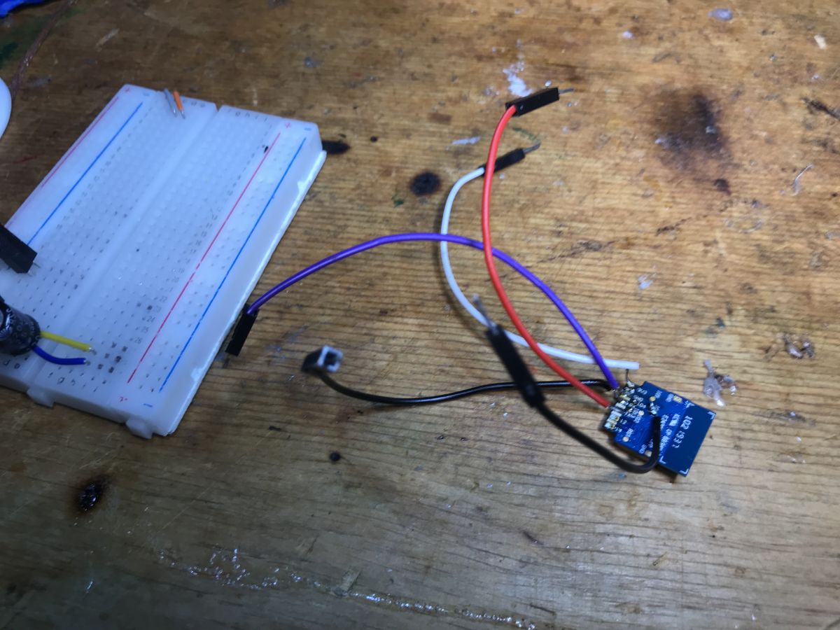

    Here`s my layout:
    Breadboard prototype with wires and connected USB power supply
    Breadboard with TYWE2S Wi-Fi module and connected wires

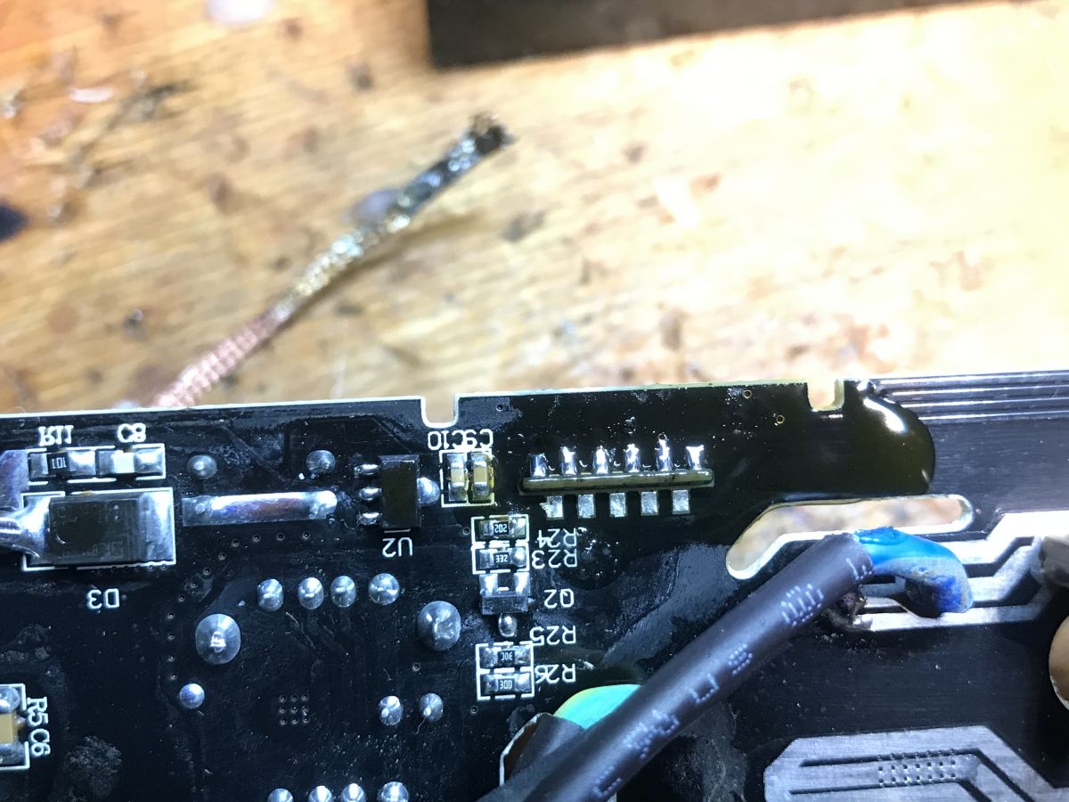

    After a short test whether Tasmota creates an access point, TYWE2S returns to its place:
    Image of a circuit board with various components, including wires and a connector.

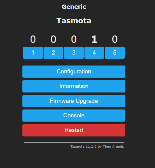

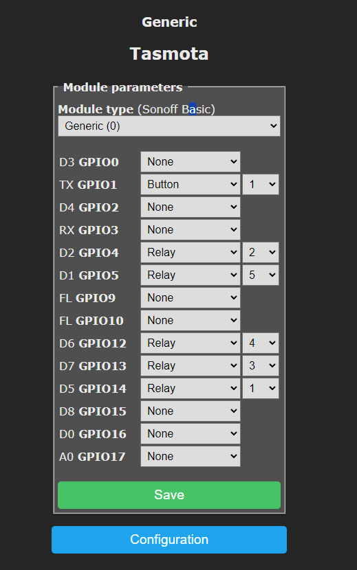

    I quickly experimentally checked which GPIO was which relay:
    Here is the final Tasmota configuration:
    Tasmota interface displaying activation of one channel. Screenshot of Tasmota configuration for Overmax Flow Multi Control.

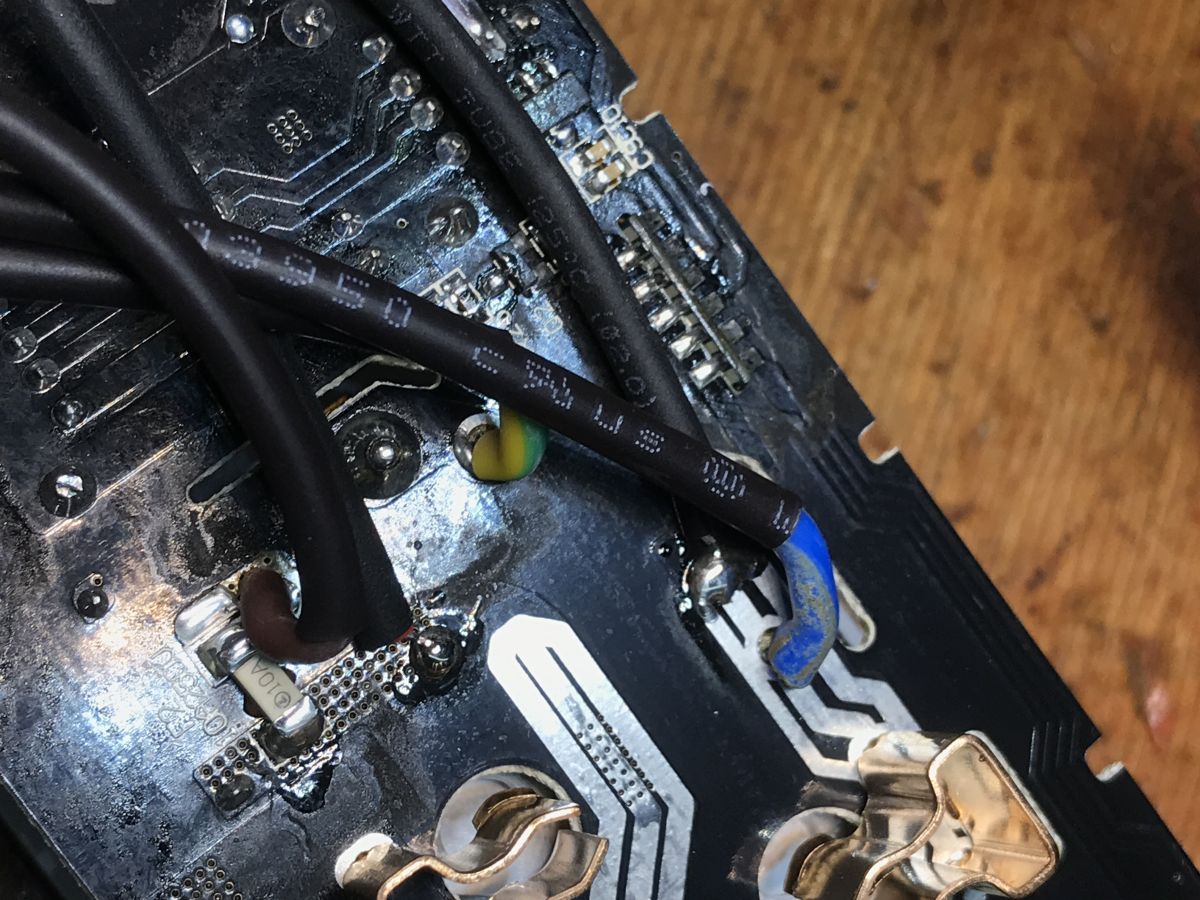

    NOTE - when assembling, you need to solder the ground pin!
    Close-up of the power strip's interior showing electronic components and wires.

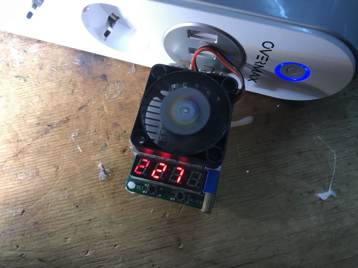

    Current efficiency test
    As a rule - looking at the interior, I think it will be OK, it`s not a total budget, but I don`t trust your word - will there be these 2.1A:
    Overmax Flow Multi Control power strip with a voltmeter showing 2.27 and a cooling fan.
    There is even more, 2.3A activates the protection, it`s ok.

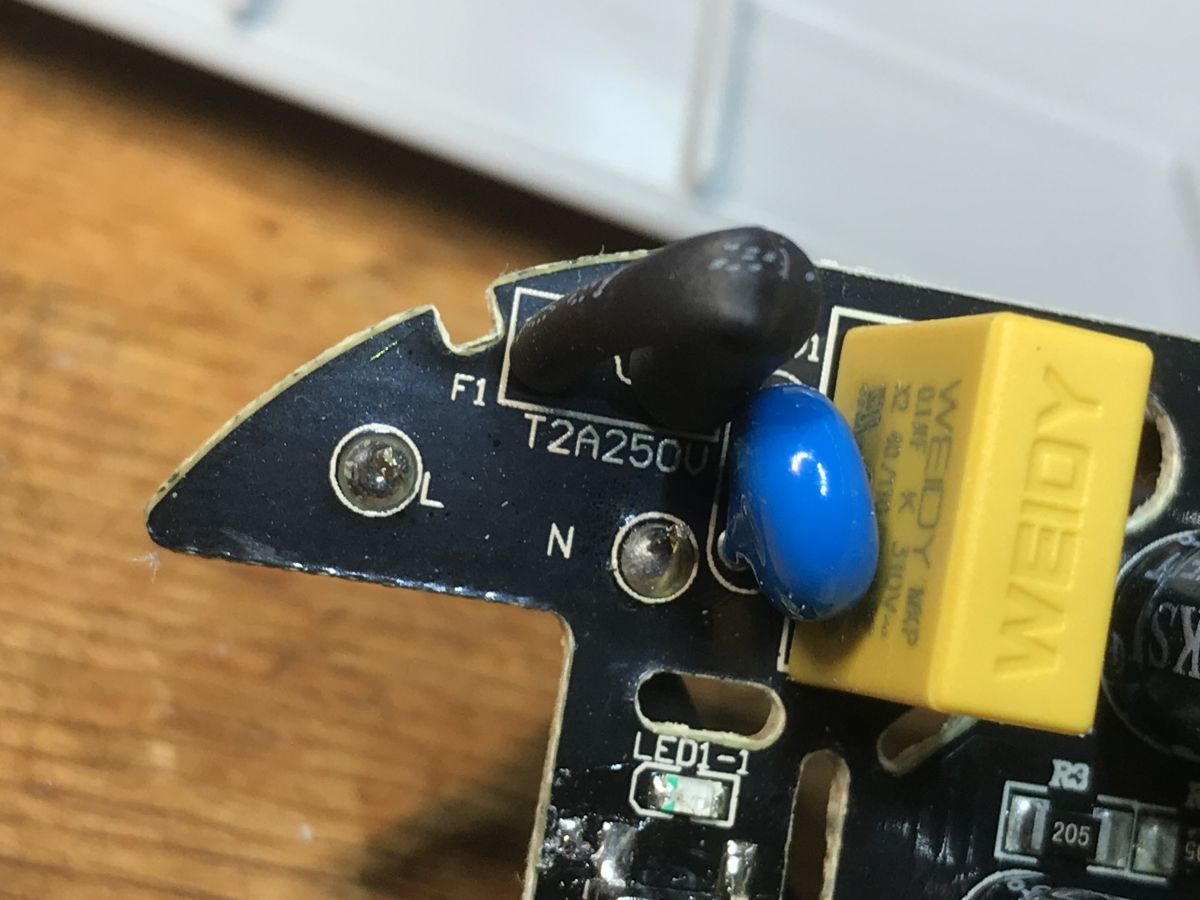

    I am always afraid of such power strips with a USB port.
    Because the Dutchman knows what the designer wanted to save on.
    It`s good that in this case he used a varistor and a filter capacitor, and the UC7441 is the height of debauchery
