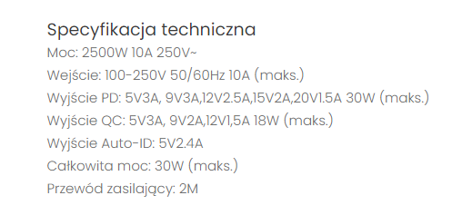

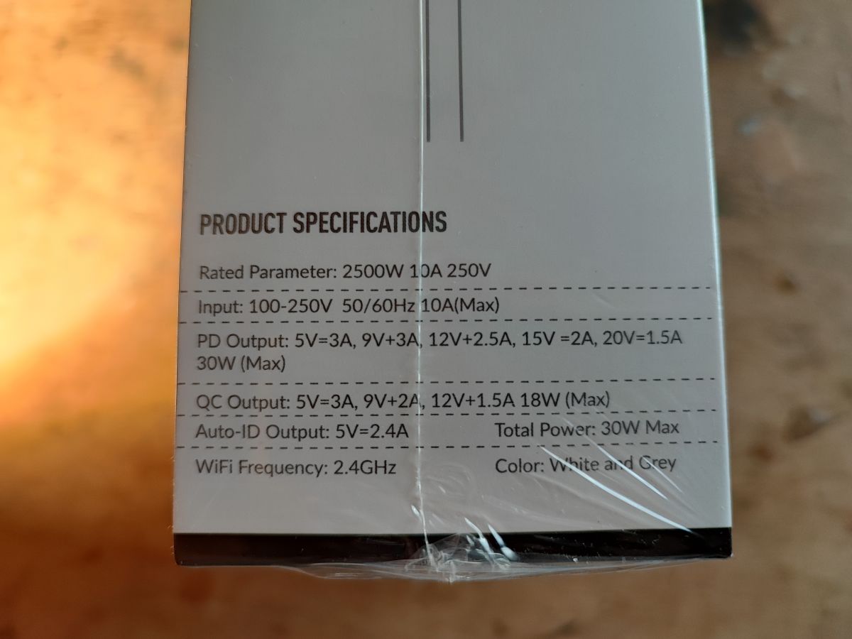

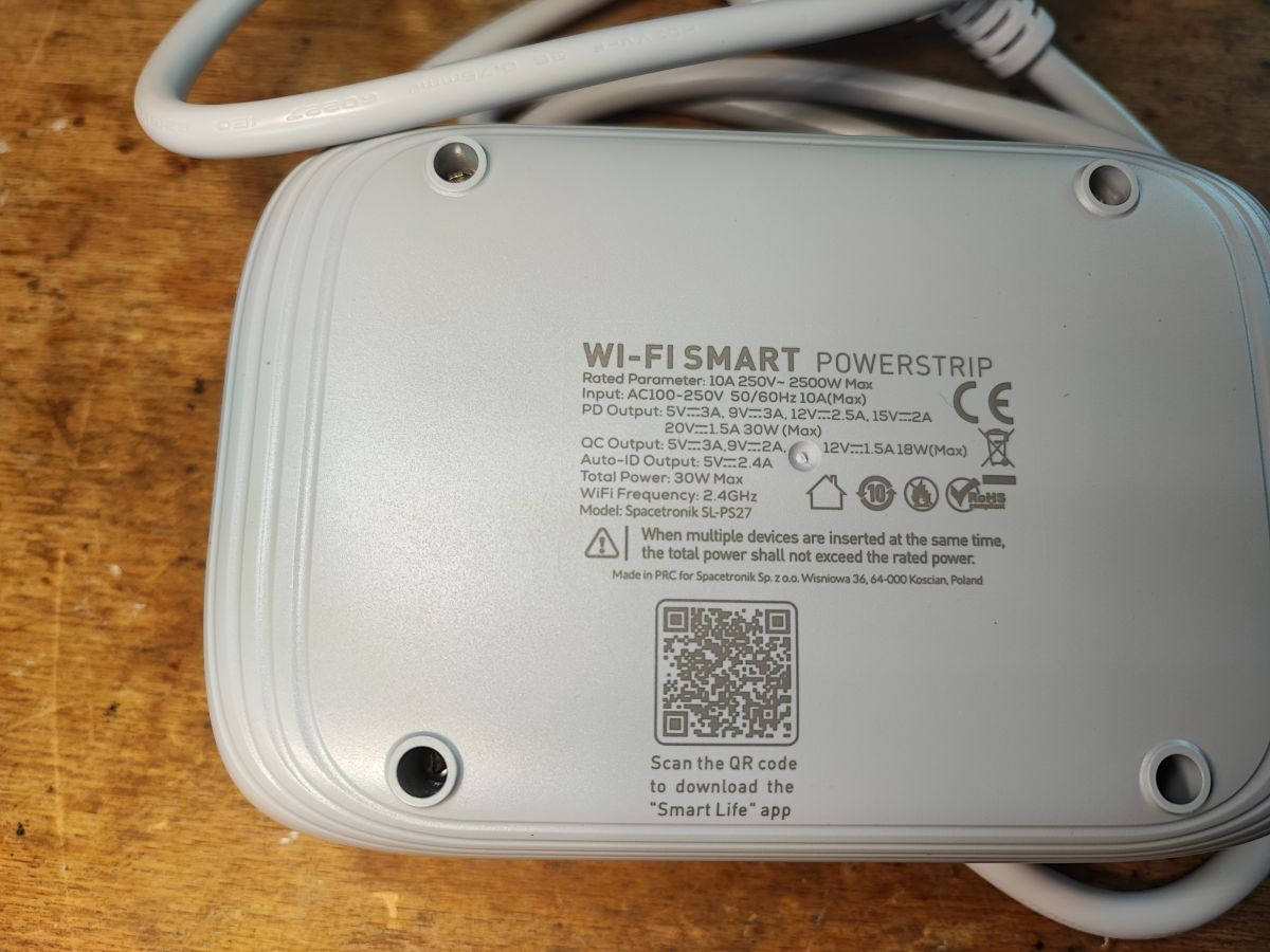

    Technical specs of SL-PS27 power strip with 2500W rating and multiple USB outputs .

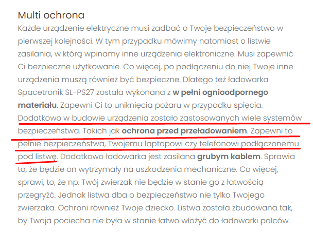

    No mention of anti-surge I noticed, but this bit is interesting:
    Description of safety functions in the Spacetronik SL-PS27 power strip .
    To quote:
    In addition, a number of safety systems have been incorporated into the design of the device. Such as overload protection. This will ensure the complete safety of your laptop or phone connected to the power strip.
    f1
    What's the point here? About the fact that in Tuya you can set a timer that will switch off charging after a certain amount of time? But for what?

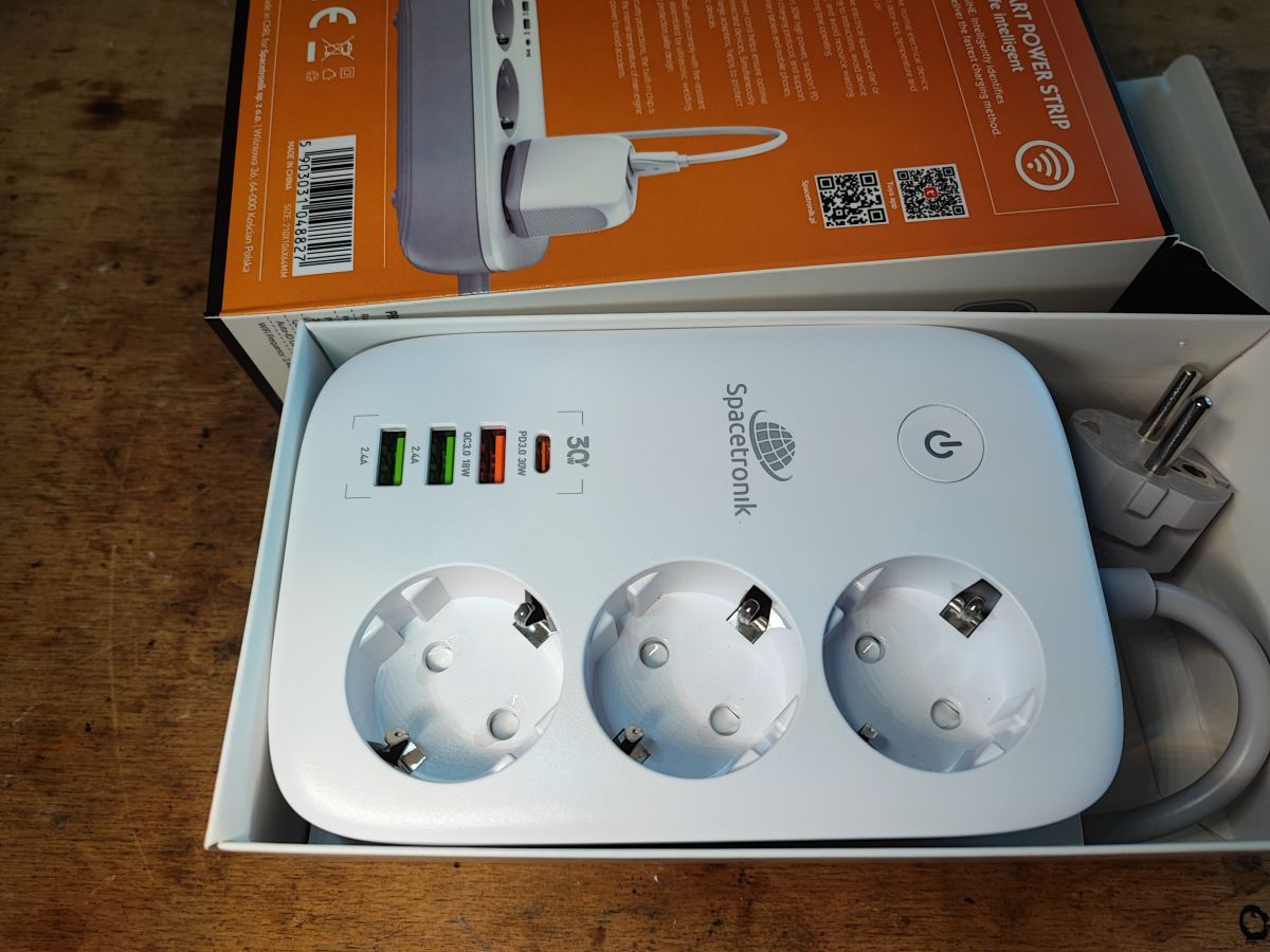

    So let's see what you get after purchase:
    Back of Spacetronik SL-PS27 smart power strip packaging on wooden surface Part of Spacetronik power strip box with barcode and CE symbol Packaging of Spacetronik SL-PS27 smart power strip with WiFi and 4 USB ports. Technical spec label for the SL-PS27 power strip on package. Technical spec label for the SL-PS27 power strip on package. .
    Contents:
    Spacetronik power strip with 3 outlets and 4 USB ports inside the box
    Instructions;
    User manual for power strip with illustrations and feature description .

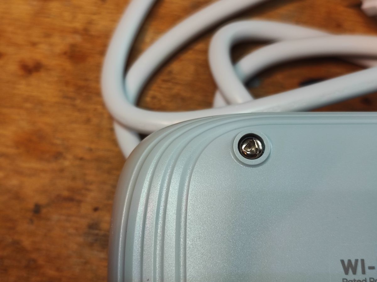

    We take a look inside, a special screwdriver will come in handy:
    Close-up of SL-PS27 power strip bottom with printed technical specifications Close-up of triangular screw on the SL-PS27 power strip casing .

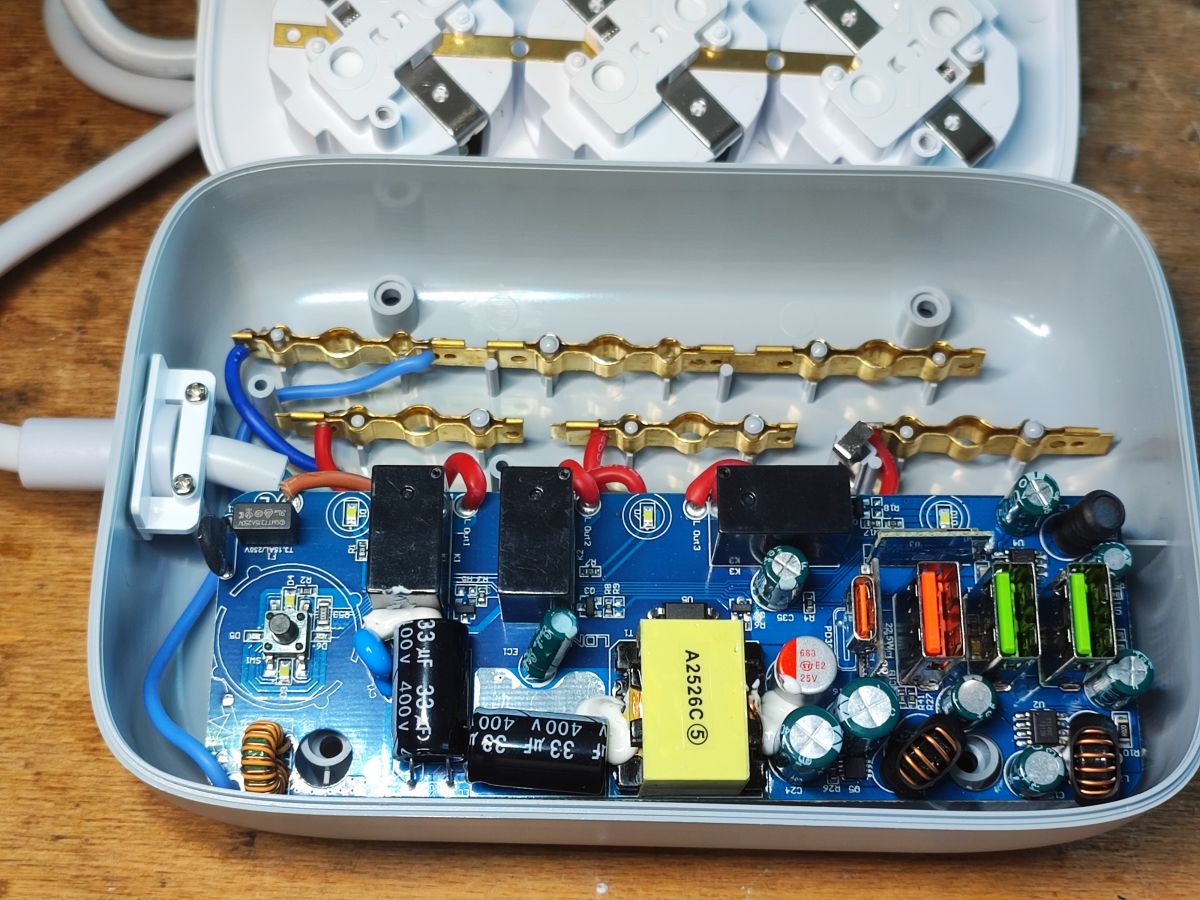

    Remove the cover:
    Inside view of SL-PS27 smart power strip showing electronic components and USB ports .

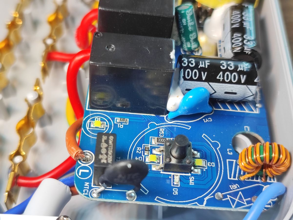

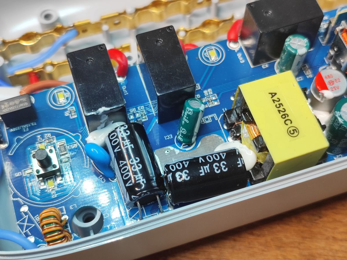

    The first thing that catches the eye is the presence of an NTC starting thermistor- better than nothing. Secondly, I also see here that there is no normal on/off switch, this button on the casing only gives the WiFi module the signal that all four relays need to be switched off....
    SL-PS27 power strip interior with NTC thermistor and colored wires visible Close-up of SL-PS27 power strip circuit board with capacitors, switch, and wiring.
    Well, and you can see (as usual) the empty space for the varistor. Well, because why protect against surges?

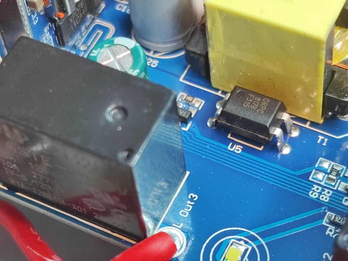

    The power supply itself is probably in flyback topology:
    Close-up of electronic components on the SL-PS27 power strip PCB Close-up of power strip interior showing capacitors and A2526C module .
    This time it's not the usual budget PSR (Primary Side Regulation), there's an optocoupler here, a classic 817, for feedback from the secondary side.

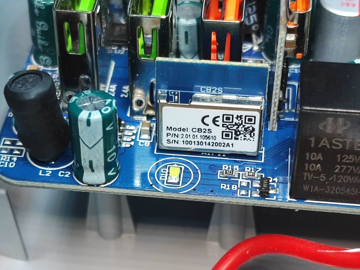

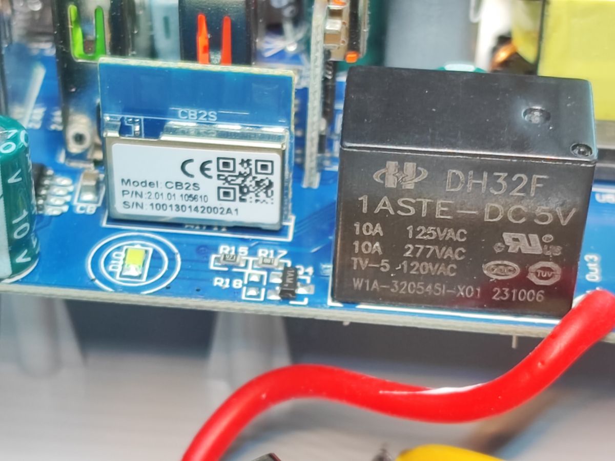

    And then there's the WiFi module:
    CB2S WiFi module on a power strip PCB with visible electronic components CB2S module and DH32F relay on SL-PS27 power strip circuit board .
    OpenBeken can be uploaded on the CB2S, but let's look at the rest of the board first.

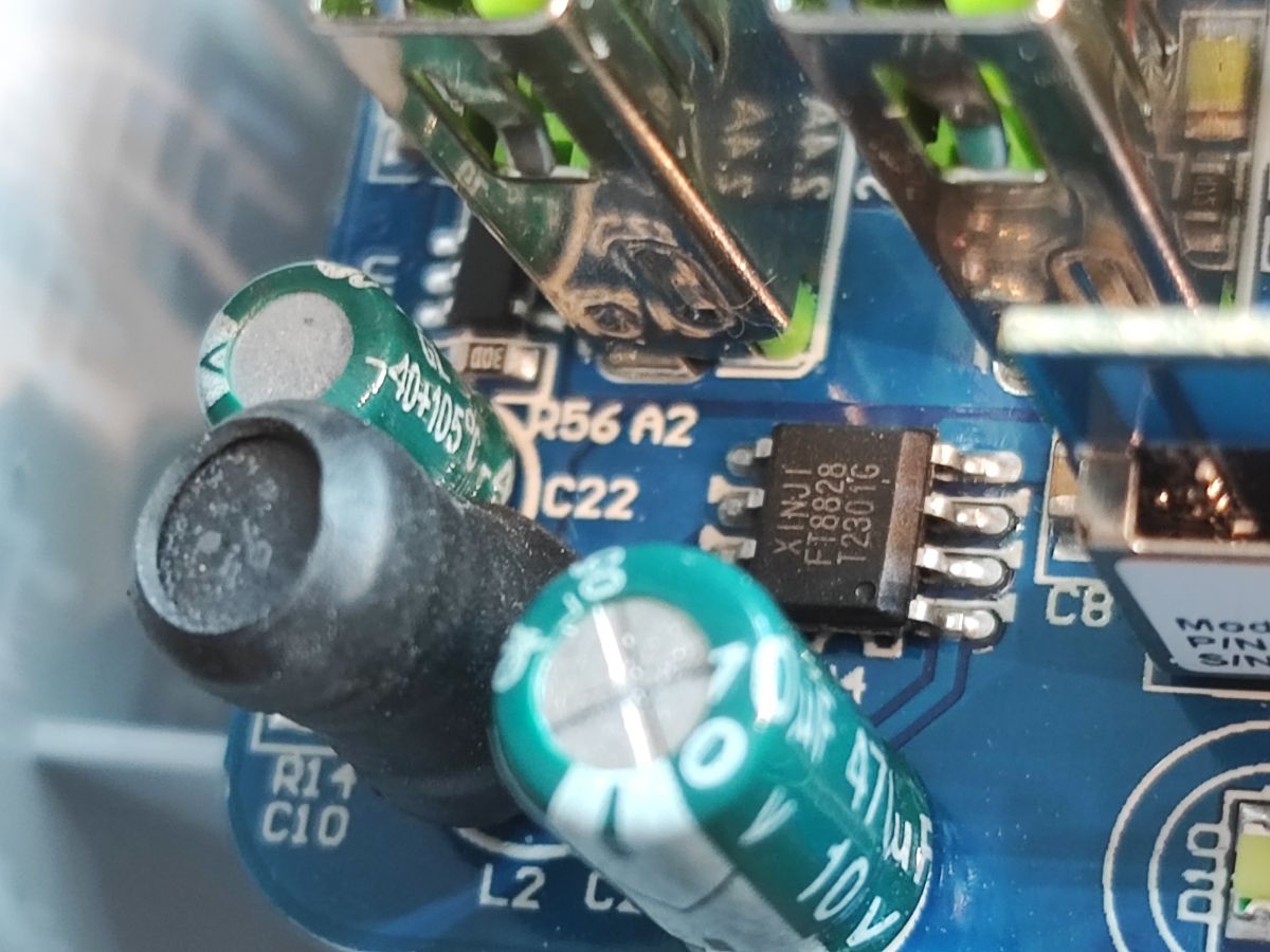

    Close-up of FT8828 chip on circuit board with capacitors and USB ports Close-up of SL-PS27 power strip interior with USB ports and electronic components Close-up of electronic components inside SL-PS27 power strip .
    What is this MOSFET? Maybe it's what the WiFi module uses to switch on the USB outputs?

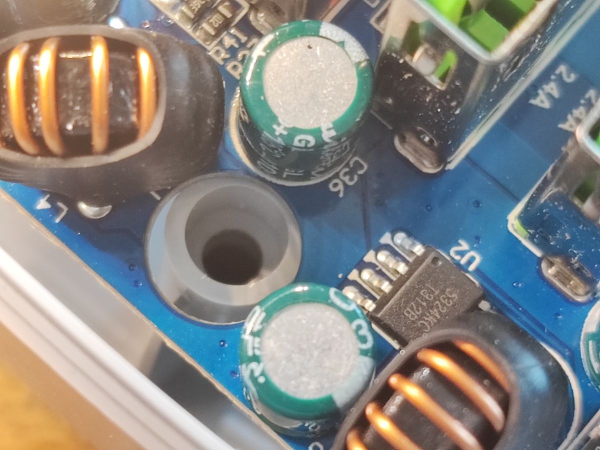

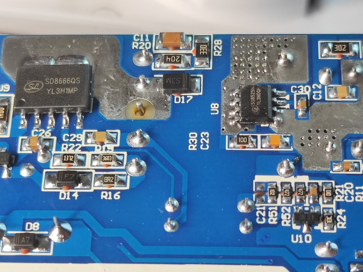

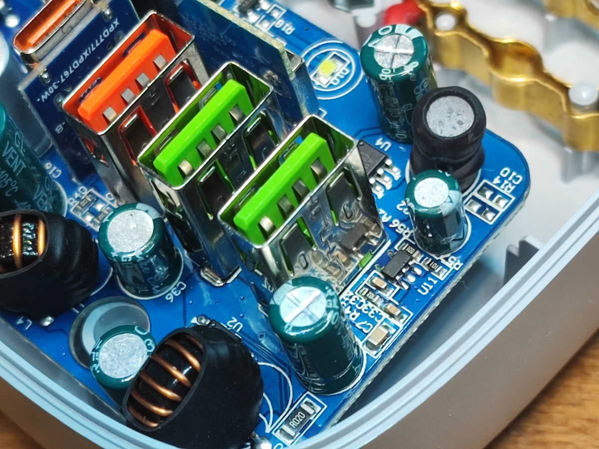

    On the USB side I see components suggesting another inverter. This is rather as expected, as QC attached and e.g. 9V on one port should not switch on 9V on the other ports, plus not all ports here have QC. Unfortunately the FT8828 datasheet note was not found, maybe someone will have more luck?

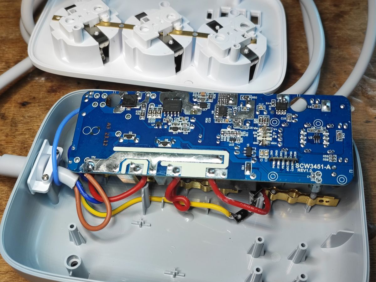

    Interior of a disassembled power strip showing PCB SCW3451-A REV1.0 .

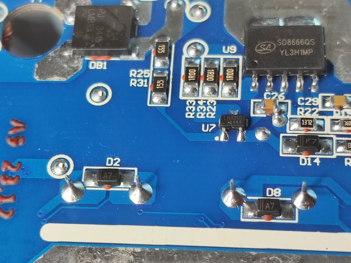

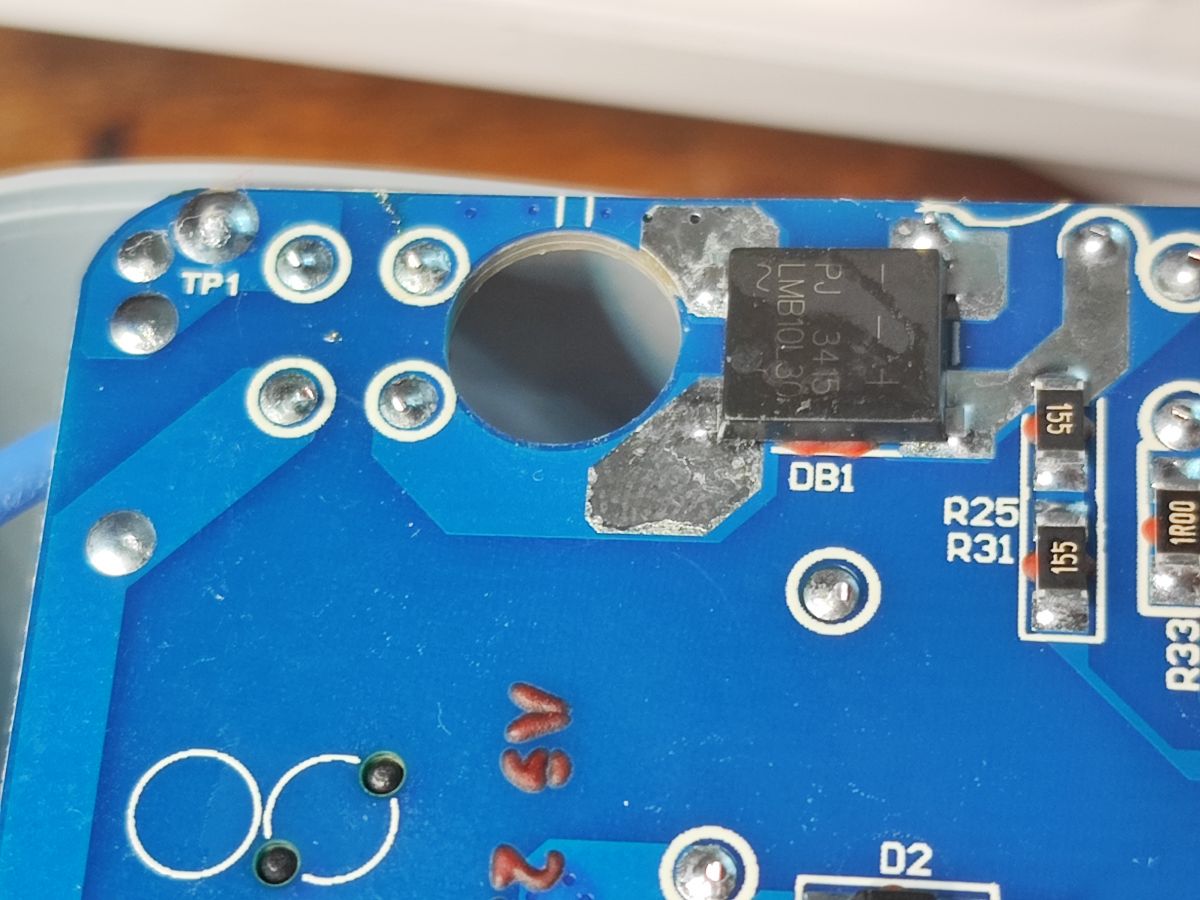

    There's still the bottom of the PCB left.... On which there are quite a few components. You can see the rectifier bridge, then the main inverter controller, then (on the secondary side) a component which I suspect to be a synchronous rectifier (instead of a Schottky diode) and then I can still see the 3.3V supply for the WiFi module.
    Close-up of PCB with bridge rectifier marked PJ3415 LMB1031 Close-up of PCB with SD8666QS, LN3210, and multiple SMD components and diodes Close-up of PCB with SD8666QS and SD8525H components on SL-PS27 power strip .

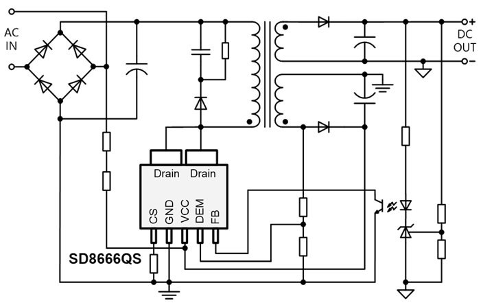

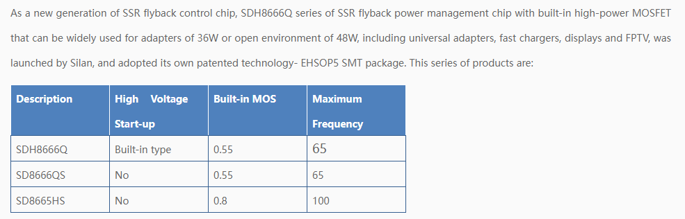

    So the inverter is built here based on the SD8666QS. I haven't seen one realised using an optocoupler for a long time:
    Power supply circuit diagram with SD8666QS controller and optocoupler feedback .
    Power up to 36W, this would coincide with the description, as you still need to power the WiFi module and relays too.

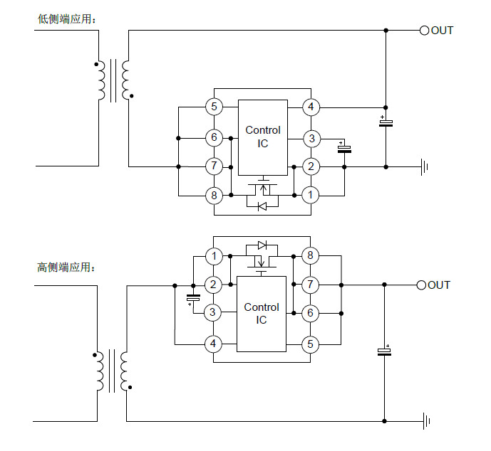

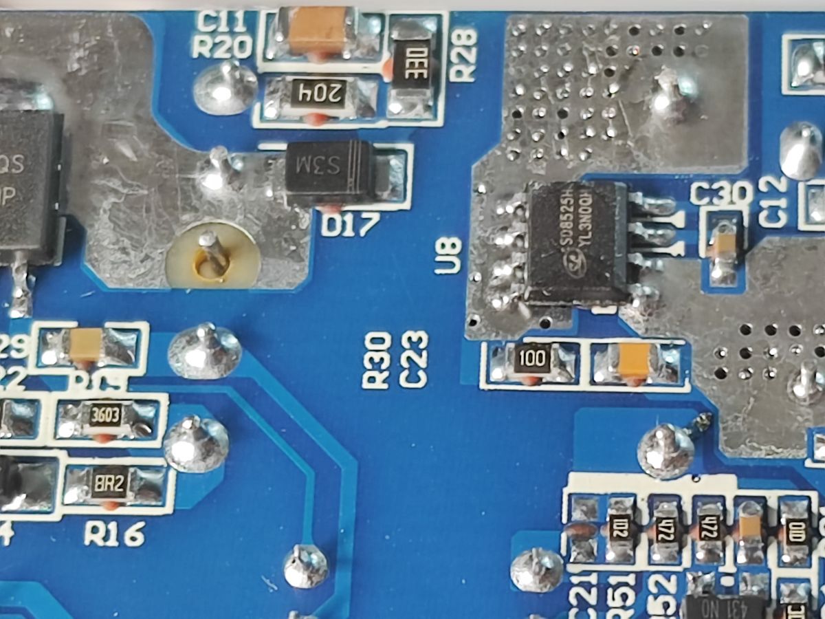

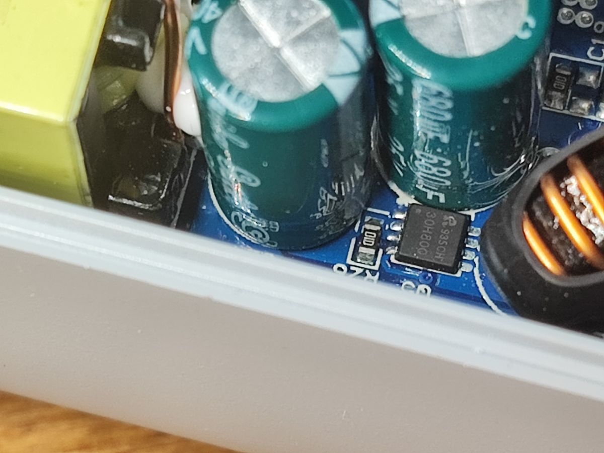

    Next we have the SD8525H, just as I thought, a synchronous rectifier:
    Close-up of SL-PS27 power strip PCB with visible NDP1340KC and SD8525H ICs Close-up of PCB with SD8525H chip and multiple SMD components .
    Diagram:
    Application diagram of an 8-pin control IC managing MOSFET switching .

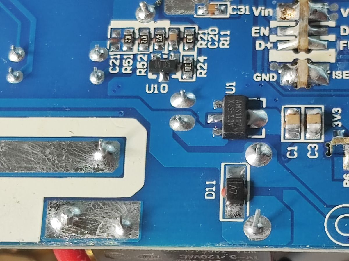

    U1 is AMS1117-3.3V - LDO supplying the WiFi module:
    Close-up of PCB showing AMS1117-3.3V voltage regulator and diode labeled A7. .
    Here we undoubtedly have a circuit that "reports" the charger to the phones, I wrote about this in more detail in the topic:
    Two-port USB charger that accelerated the charging of my iPhone

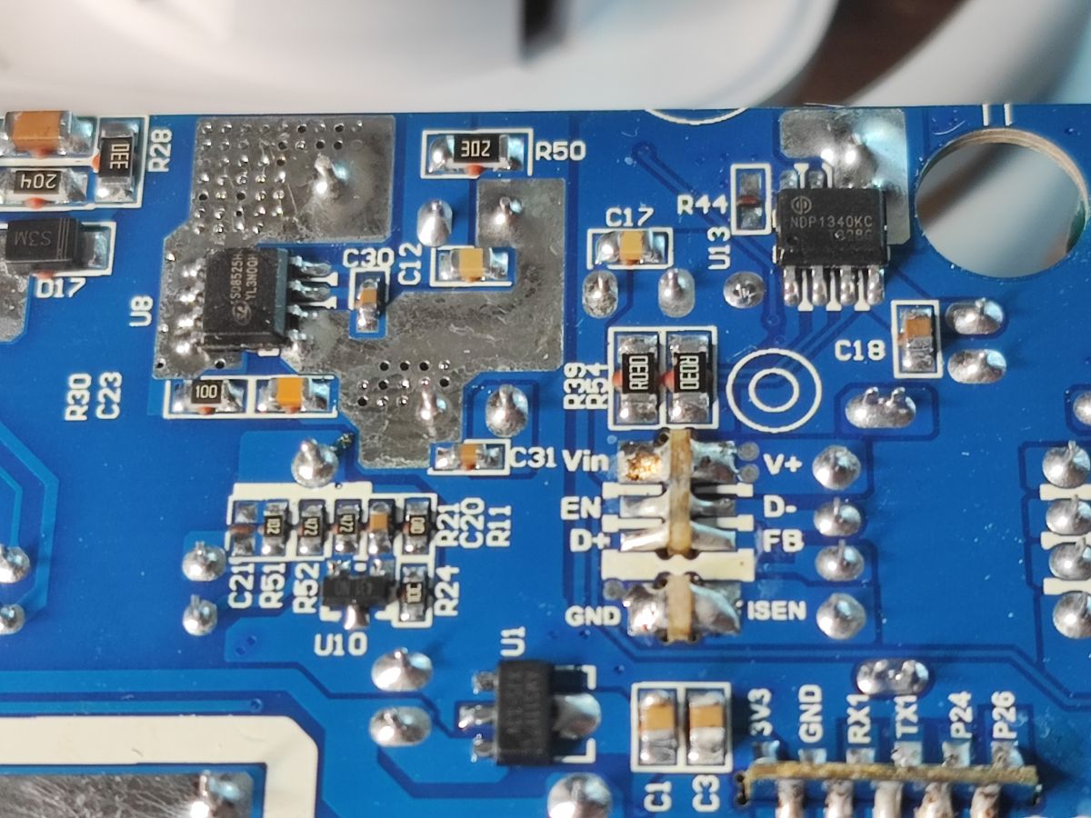

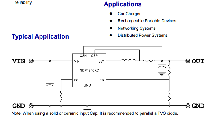

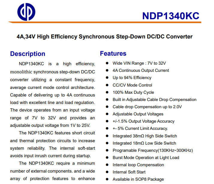

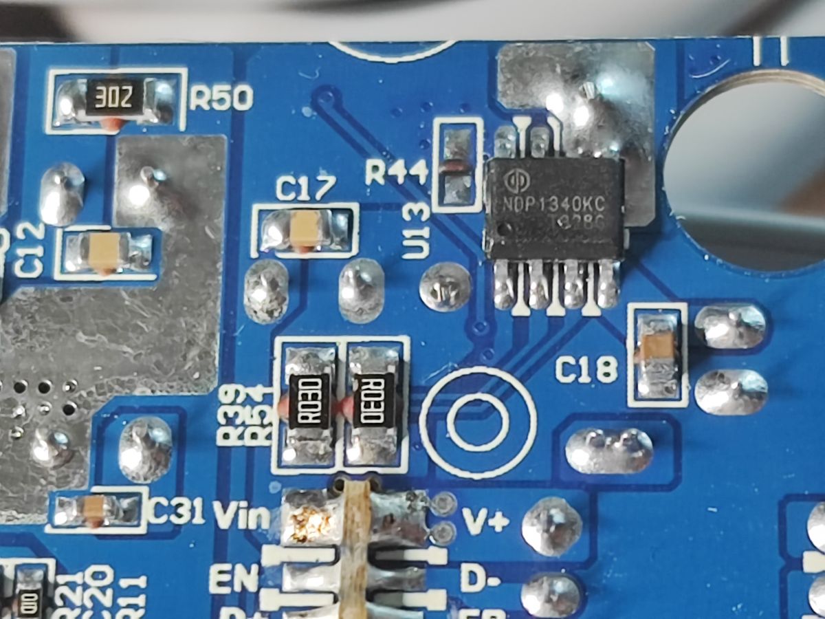

    The NDP1340 remains:
    Close-up of NDP1340KC chip on blue PCB with labeled components and solder points .
    Buck inverter controller. So much for step down:
    Section of NDP1340KC datasheet with description and feature list. .
    From this it would appear that the main power supply generates the higher voltage and only the NDP1340 gives 5V for the USB?
    Application diagram of NDP1340KC controller with labeled VIN, GND, and OUT

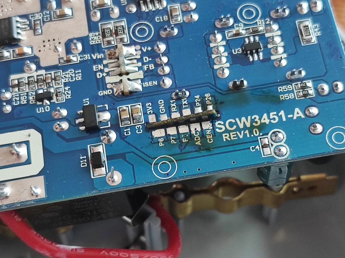

    PCB designation: SCW3451 REV1.0.
    I have already seen this product in REV1.5, then I can now compare it with the 1.0 version.

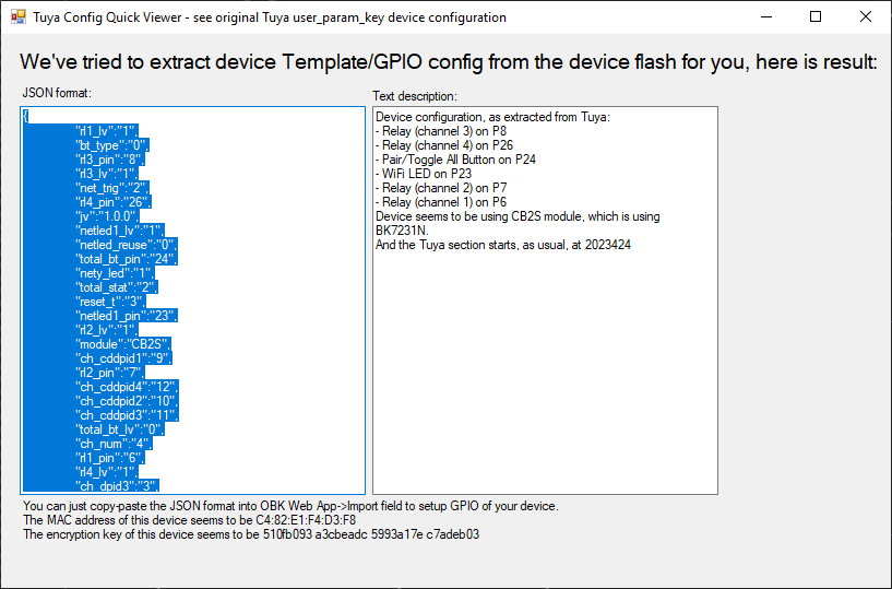

    Firmware change .
    As per the flasher's instructions:
    and with Elektroda's videos for BK7231:
    https://www.youtube.com/playlist?list=PLzbXEc2ebpH0CZDbczAXT94BuSGrd_GoM

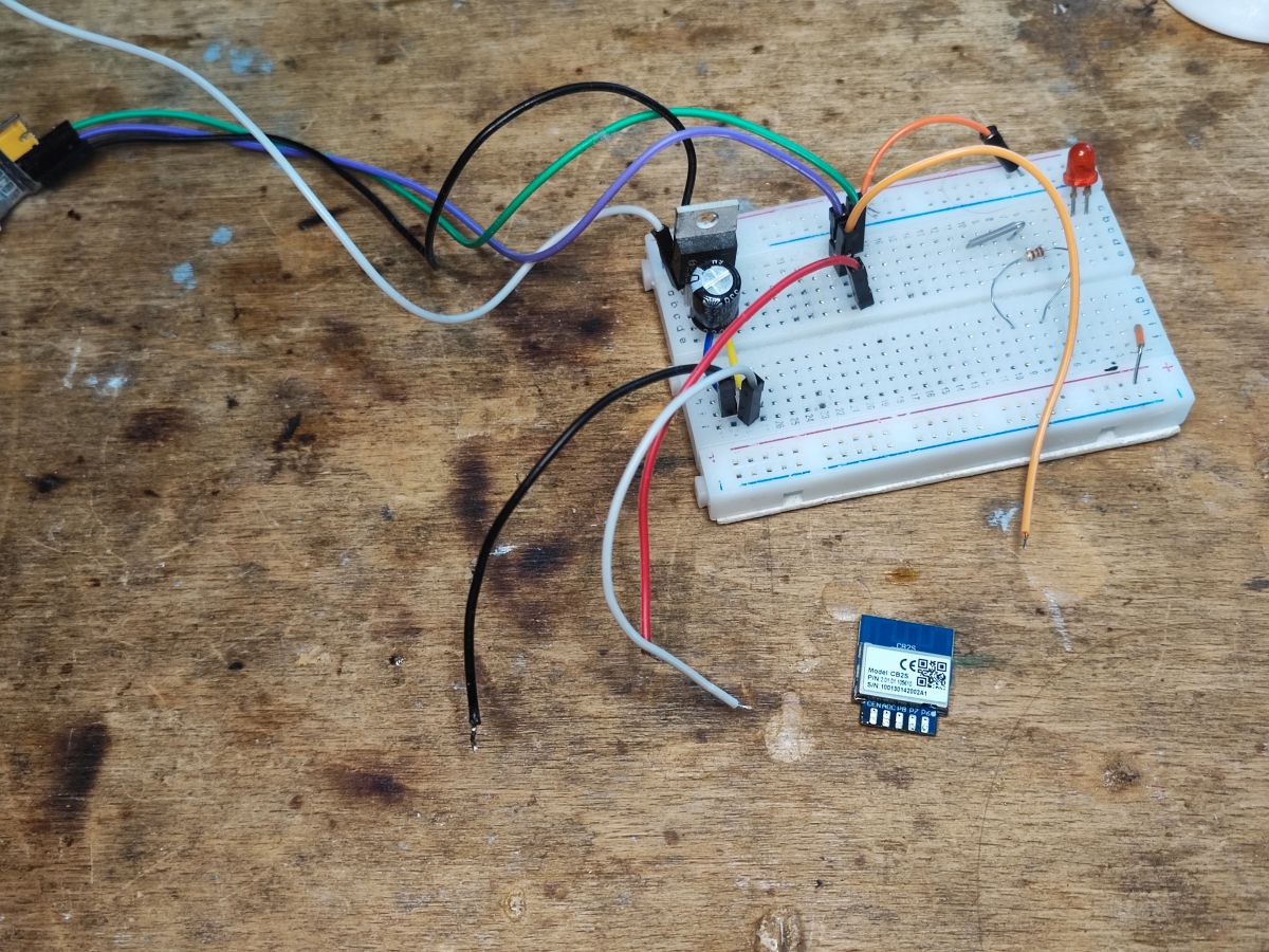

    CB2S I soldered out:
    Close-up of SCW3451-A REV1.0 PCB showing pin headers and SMD components .
    I powered via an external 3.3V LDO:
    Breadboard with connected wires and CB2S Wi-Fi module placed nearby on table Breadboard with electronic test circuit, sensor module and USB adapter on wood surface
    BK7231 easy gui flasher self-detected configuration:
    Screenshot of Tuya Config Quick Viewer showing CB2S module GPIO config
    JSON Tuya:
    OBK template:
    The list can now be paired with HA:

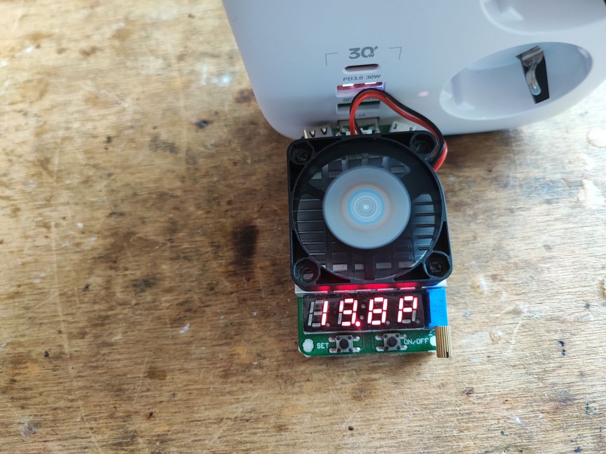

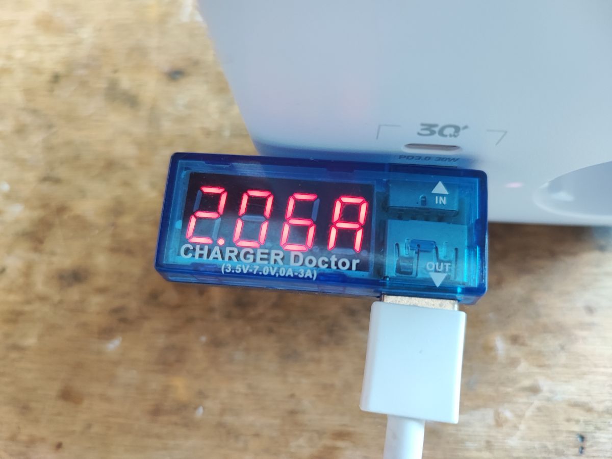

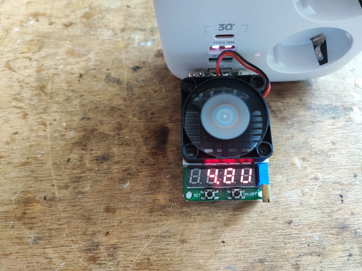

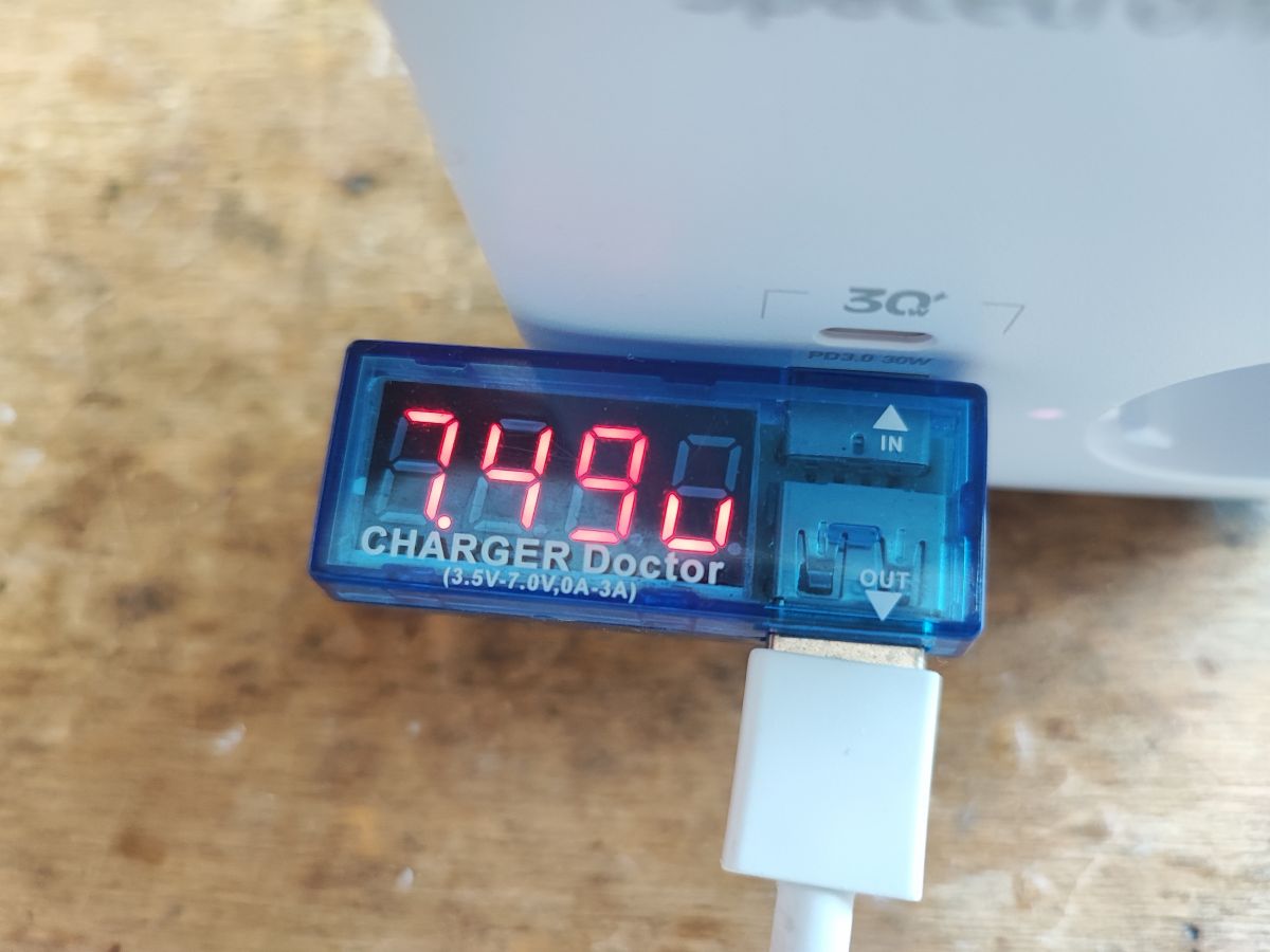

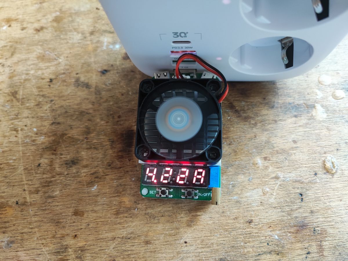

    Current and charging capacity test .
    20W at 5V I am able to draw. With QC I was able to attach 7.5V at 2A for my phone, but I did not test with QC Trigger:
    Charger Doctor meter showing 2.05A current during USB charging USB voltmeter showing 7.49V during QC charging test. USB tester with fan connected to a 30W PD outlet, voltage display showing 4.80V USB tester with fan showing 4.821 V output, connected to a power strip. USB load tester showing 19.8V, connected to SL-PS27 power strip .
