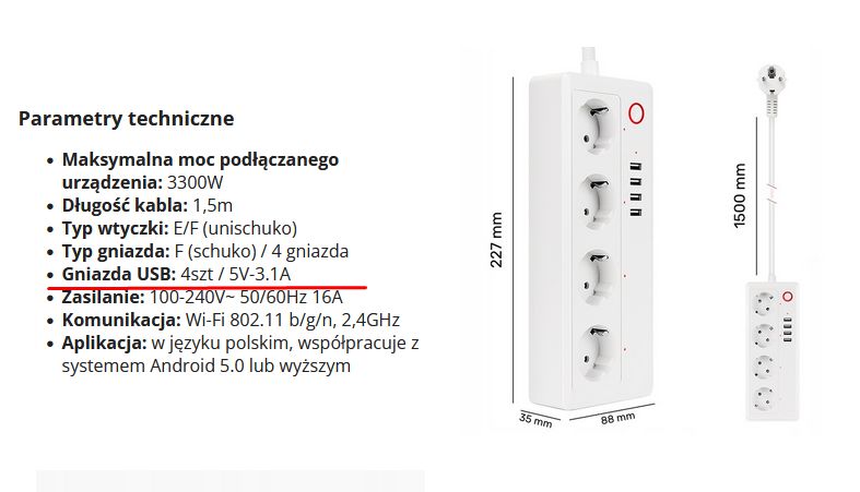

    The product description is interesting in that it mentions anti-overvoltage (such as '100%' - I wonder how this was calculated).
    Wi-Fi power strip with 4 Schuko sockets and 4 USB ports (5V/3.1A), 1.5 m cable length
    The USB power supply (5 V, up to 3.1 A) is also present. There is no QC support, USB will not attach higher voltage.

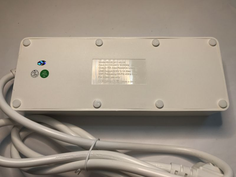

    Bottom of white power strip with label showing model RH-EU411-4U-W
    There is a different model on the bottom - RH-EU411-4U-W.

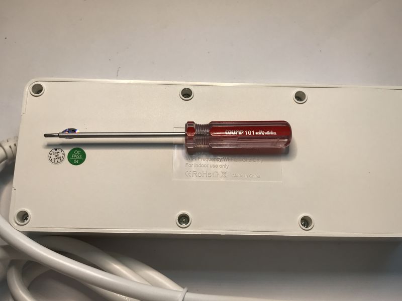

    Bottom of white power strip with triangle screws, red triangular screwdriver on top
    Inside of the product
    It's time to take a look inside.
    The interior is secured by slightly less typical screws requiring a triangular-tipped screwdriver.

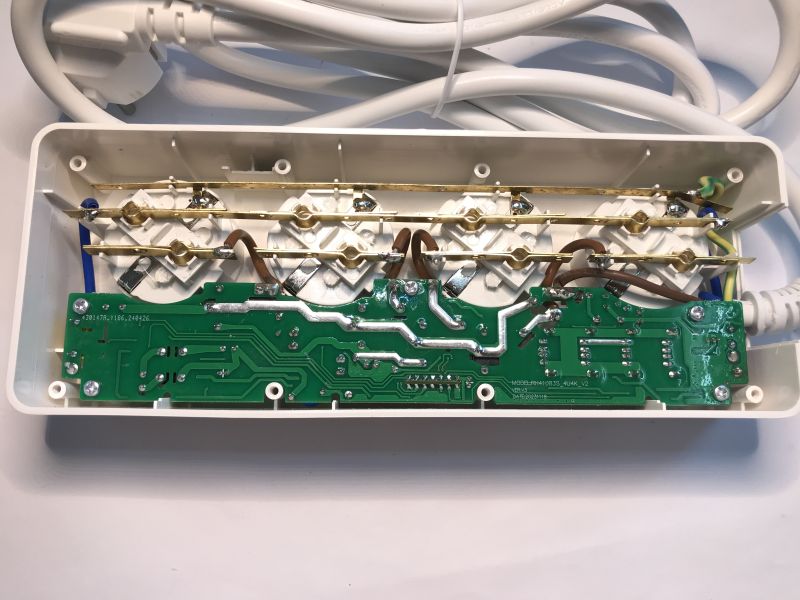

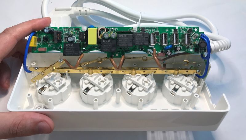

    Interior of disassembled power strip showing PCB and internal wiring
    The design of the strip is not that bad. Even the earthing is connected - in the cheapest products only "pretend" happens. The thickness of the wires is not significantly underrated either.

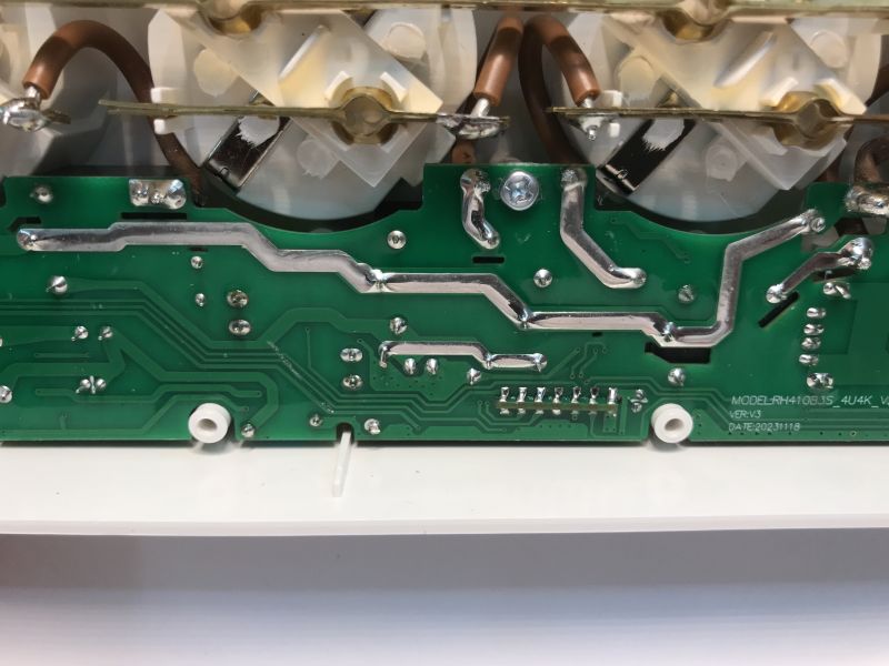

    Bottom side of SMART_STRIP_EU4_M PCB with model marking RH410B3S
    The PCB designation is RH410B3S_4U4K_V2, version V3. Date 20231118 Interestingly, you can also see the Wi-Fi module soldered into the board, but its pads do not resemble the standard CB2S/WB2S.
    By removing the screws from the centre, the PCB can be lifted:

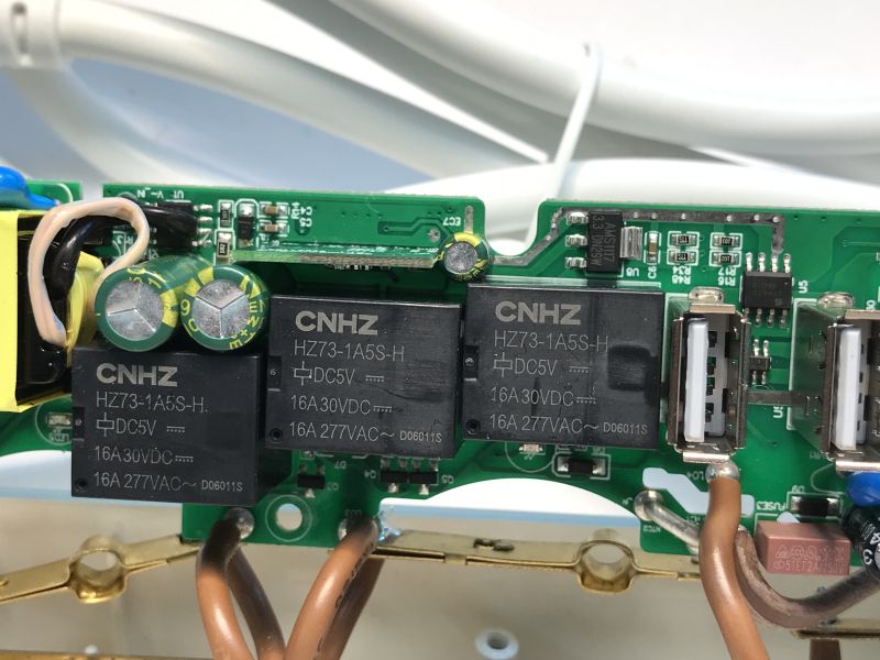

    Inside view of power strip with four relays and USB charging ports
    The whole thing doesn't look so bad. There are even filters against EMI emissions on the input. In addition, I can even see a varistor (surge protection) and, of course, relays - one per socket, CNHZ HZ73-1A5S-H at 5V.

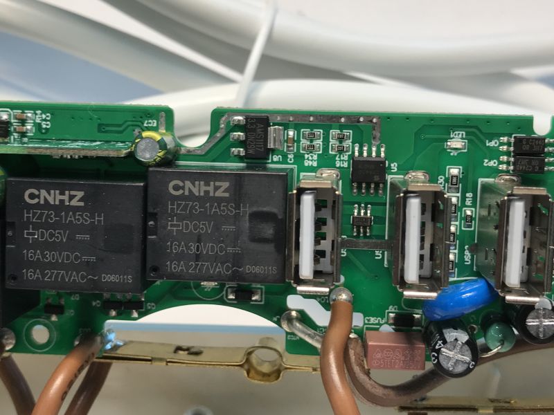

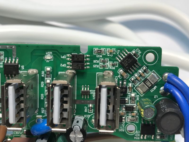

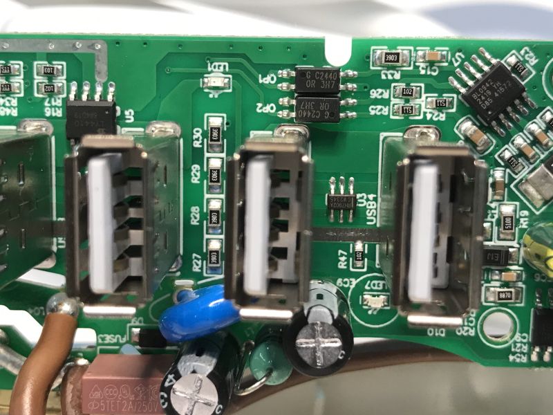

    Close-up of a PCB with three USB ports and integrated circuits labeled RH7902A and BL0942
    Here we see the BL0942 chip, it is used to measure voltage, current and power. It communicates with the Wi-Fi module via the UART. It looks like this UART is isolated - I can see two optocouplers there. Also visible next to it are the USB ports along with the U3 chip, which I'm betting is responsible for the power supply reporting to the connected device. Phones and mobile devices will not draw more than 500 mA without this. Sometimes you short-circuit the D+ and D- pins or set levels on them with resistors, but this is also not the best method and many devices will then not draw more than 1 A. A dedicated circuit is the best solution.
    Close-up of four USB ports and electronic components on a power strip PCB

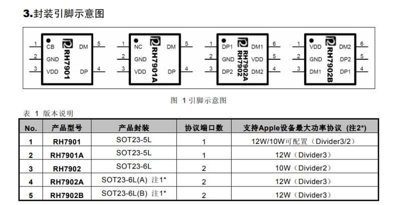

    The designation of this circuit is RH7902A. It is designed for two USB ports.
    RH790x chip package diagrams with pin labels and version comparison table
    According to the catalogue note, this chip supports the following power supply notification protocols:
    - Divider1 / Divider2 / Divider3 - charging protocols used in Apple devices
    - D+ / D- = 1.2 V - Samsung compatible mode
    - BC1.2 DCP - standard Battery Charging 1.2 protocol (Dedicated Charging Port)
    - CTIS YD/T 1591-2009 - Chinese standard for charging mobile devices
    Here you can see its second piece. There is an LDO AMS1117-3.3V next to it, too. And the L4410 (if I read it correctly), which is the MOSFET that the Wi-Fi module uses to switch on the 5 V line.

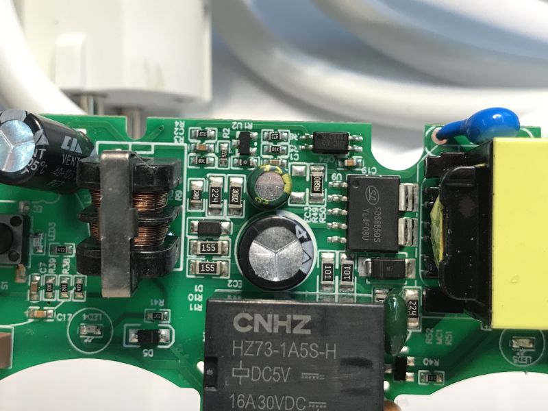

    Close-up of power strip interior with CNHZ relays and USB ports
    The relays are controlled by small transistors, here you can also see the secondary side of the inverter next to it, the distance between the "hot" and "cold" side seems to be ok:
    Close-up of smart power strip interior with CNHZ relays and USB ports

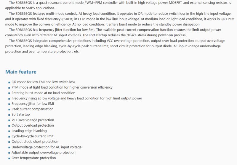

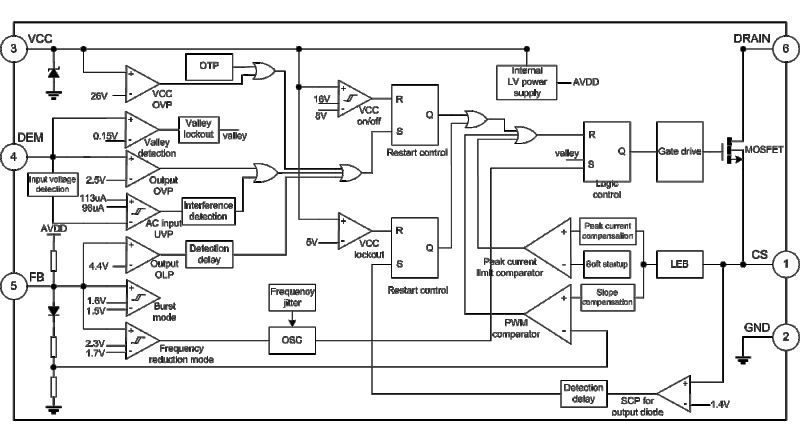

    The inverter is in flyback topology and is based on an SD8666QS chip with an integrated MOSFET transistor.
    Close-up of PCB components: CNHZ relay, capacitors, coils, SD8666QS chip
    Specification of SD8666QS controller with protection feature list
    Internal construction and leads:
    Block diagram of SD8666QS power IC showing MOSFET control and input protection

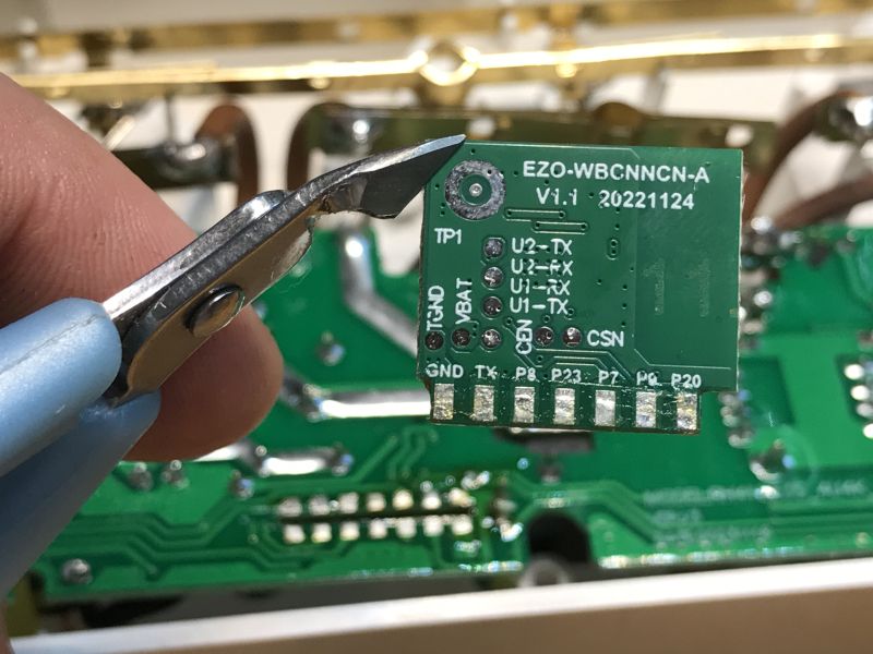

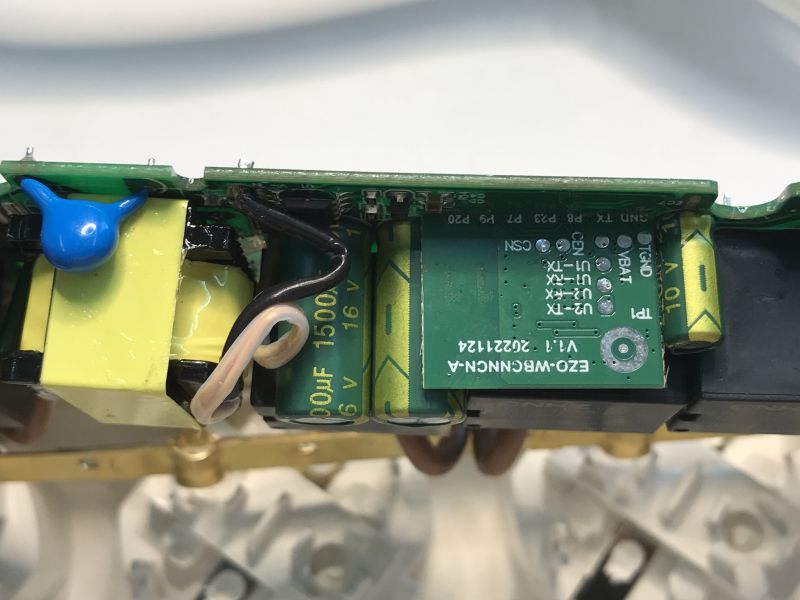

    That leaves the Wi-Fi module - EZO-WBGNNCN-A V1.1 20221124 - I haven't seen this type yet:
    Wi-Fi module EZO-WBGNNCN-A V1.1 inside power strip with visible PCB components

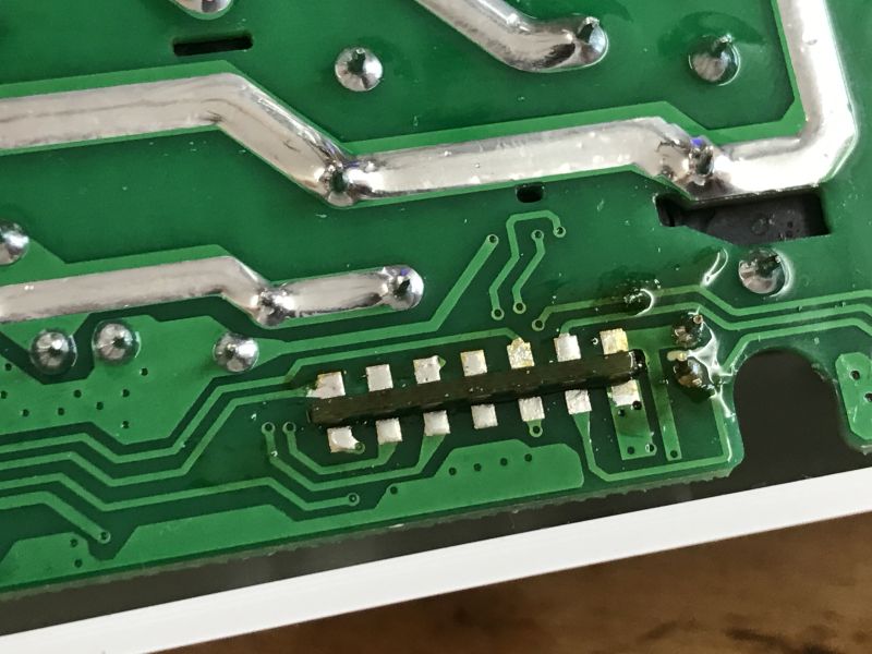

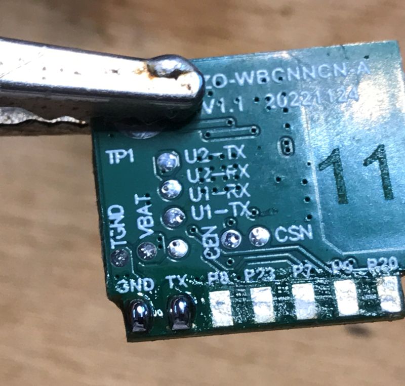

    To upload our open-source firmware this serves our flasher , it too can detect the GPIO configurations of the device. You will need a USB to UART converter. You need to get to TX1/RX1 of the Beken chip, it is best to solder out the whole module to be sure. I use flux and braid for this. The flux makes it easier to melt the binder and the braid allows us to collect it and clean the pads.
    Close-up of PCB underside showing exposed row of pads and prominent traces.
    The module is based on the BK7231N, the pads are signed, no need to guess.

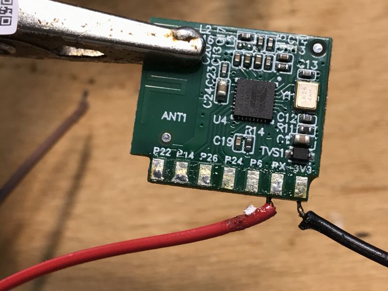

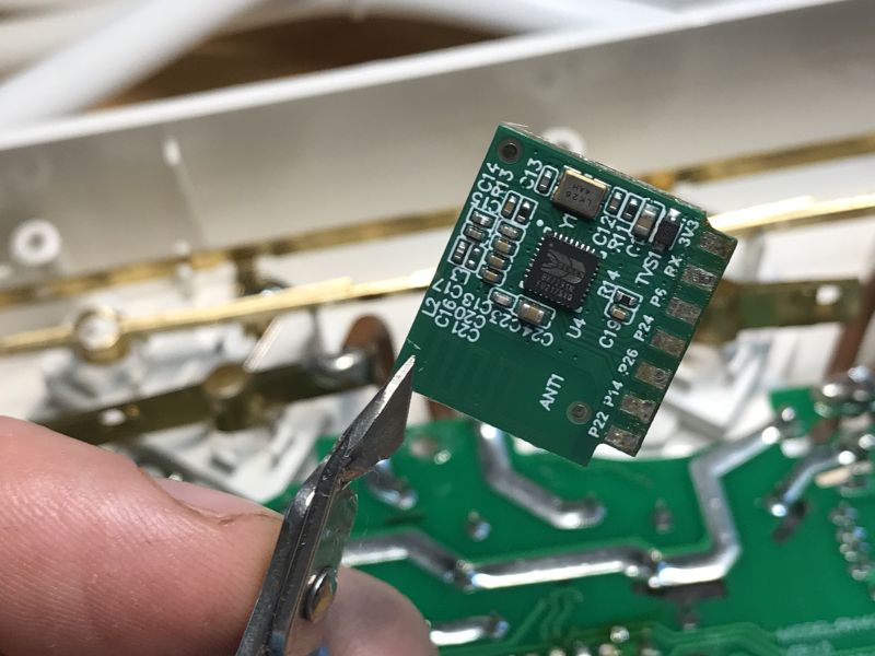

    BK7231N Wi-Fi module held by pliers above power strip PCB
    EZO-WBCNNCN-A V1.1 Wi-Fi module held by tweezers above a circuit board
    Before soldering, I will braze the pads with lead binder, such has a lower melting point:
    Close-up of EZO-WBGNNCN-A Wi-Fi module showing labeled pins and version number

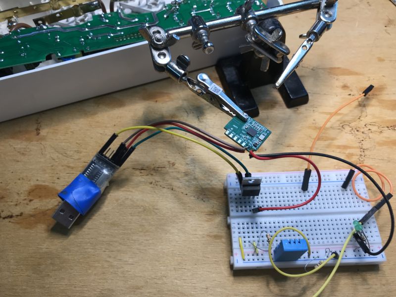

    Then I solder the four wires - power supply and UART:
    Wi-Fi module with BK7231N chip, soldered with power and UART wires
    I additionally power the whole thing from an external 3.3 V LDO (the 3.3 V pin from the USB to UART converter does not have enough current capacity).
    Wi-Fi module connected to UART programmer on a solderless breadboard

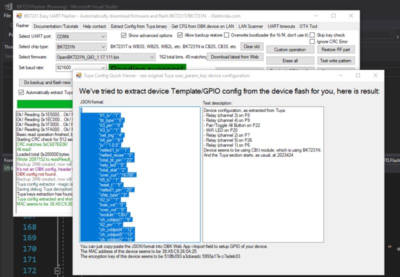

    For programming I use our flasher , the flasher correctly detects the GPIO configuration:
    BK7231 Flasher app with JSON template and extracted GPIO configuration visible.
    JSON Tuya:
    Verbal description:
    Device seems to be using CBU module, which is BK7231N chip.
    - Relay (channel 1) on P6
    - Relay (channel 2) on P7
    - Relay (channel 3) on P8
    - Relay (channel 4) on P9
    - Relay (channel 5) on P26
    - WiFi LED on P20
    - Pair/Toggle All Pin on P22

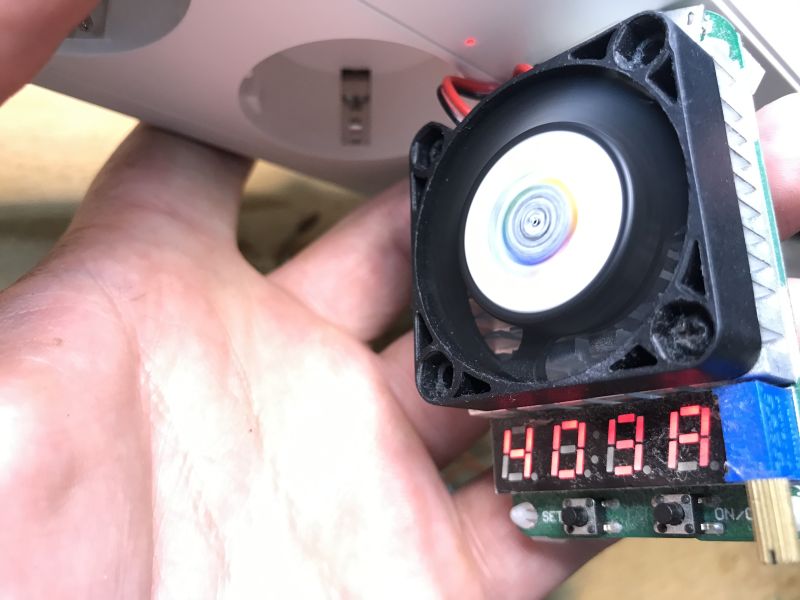

    Current capacity test
    I was able to draw up to 4 A from the strip, then the voltage drops significantly.

    The offer description mentioned a current capacity of 3.1 A, and managed to achieve up to 4 A, so it's ok here, although there could also be QC supported.
