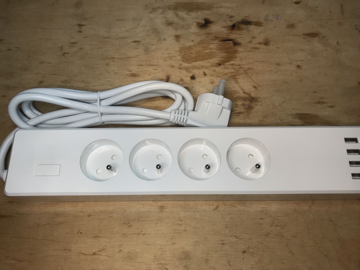

  • White four-socket power strip with built-in USB charger. I will present here the interior, a short test and a firmware change of a four-slot power strip/extender that also offers a rather powerful USB charger, all controlled via WiFi. This power strip allows us to control each socket individually and, in addition, to switch on or off the entire USB charger module, which is essentially built around five relays. In addition, I will also point out that the quality of this product is not as low as it usually is, there is even an overcurrent protection inside!

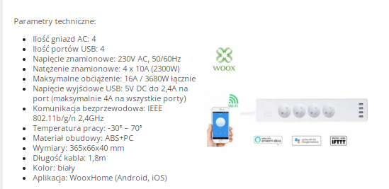

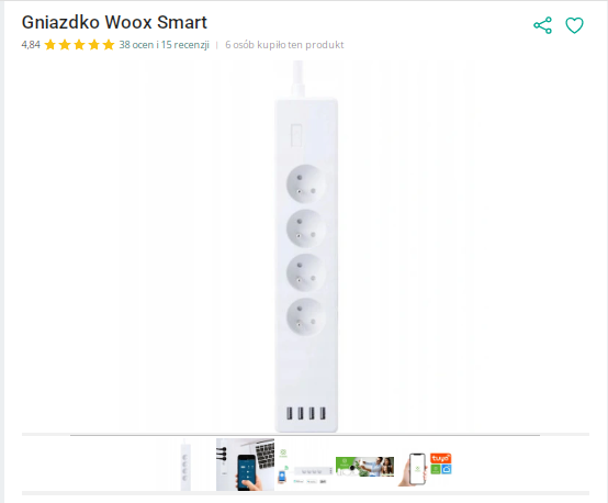

    Purchase Woox R4027 In a Polish shop it costs 140 zł:
    Woox Smart power strip with four sockets and four USB ports
    The seller praises it very much, although in my opinion the downside is that it has to work with Woox cloud, but I will also solve this problem in this topic:
    Woox Smart Power Strip WiFi with four AC sockets and four USB ports
    Technical parameters, 4A USB current capacity?
    Technical specifications of Woox R4027 power strip with built-in USB charger and WiFi features.

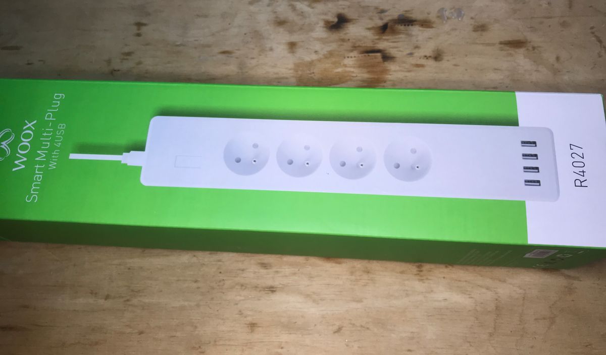

    Let's see what the product looks like in practice:

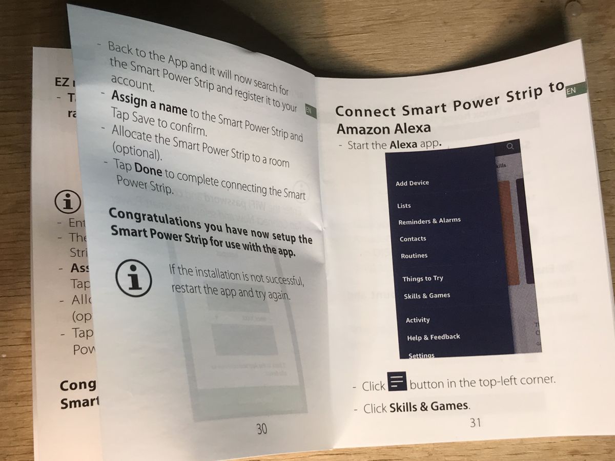

    Green packaging of Woox R4027 power strip with graphics and feature descriptions on the back. Green packaging of the Woox R4027 multi-socket strip with features described in multiple languages. Packaging of the four-outlet Woox R4027 power strip with USB charger. . Close-up of the Woox R4027 power strip technical specifications. Woox R4027 four-socket power strip with USB ports. Label of Woox R4027 power strip with technical data on a wooden background. Instructions:
    User manual for Woox R4027 power strip. Woox Wi-Fi power strip user manual page. Instruction manual for setting up the Woox power strip with the app. Instructions for setting up the Woox R4027 smart power strip. User manual for Woox Smart Power Strip. Section of the user manual for the Woox R4027 smart power strip.

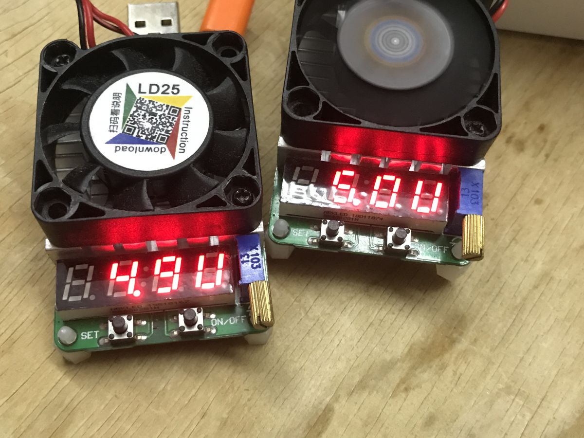

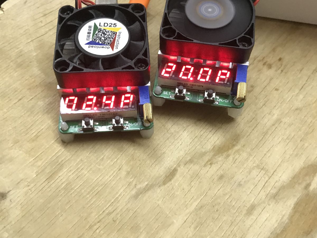

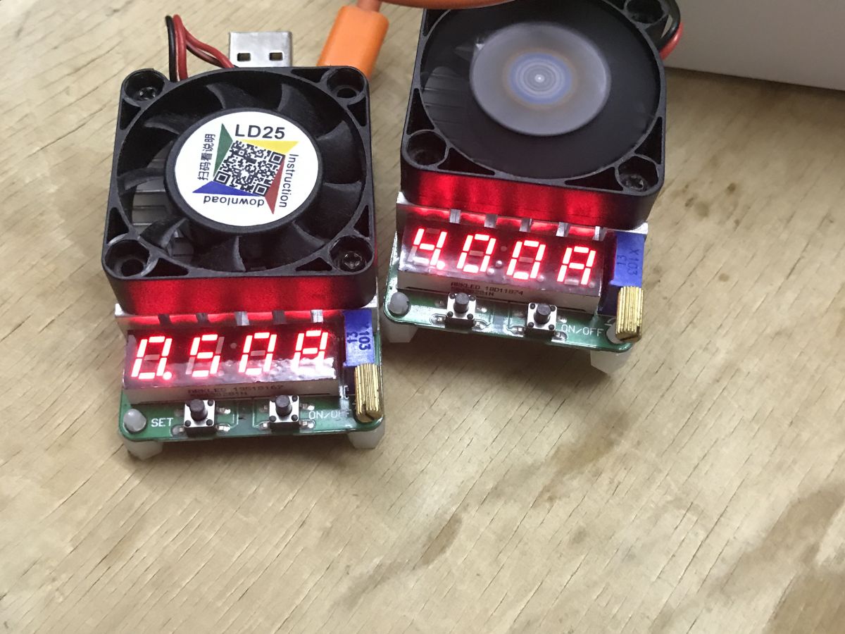

    Current capacity test A short test with LD35 and LD25 loads shows, that the strip can provide up to 4.5A, which is 0.5A more than promised by the seller. This is very good.
    Two load testers with LED displays on a table. Two electronic load testers with fans on a wooden surface. Two LD35 and LD25 test modules with LED displays showing current values. Interior of Woox R4027

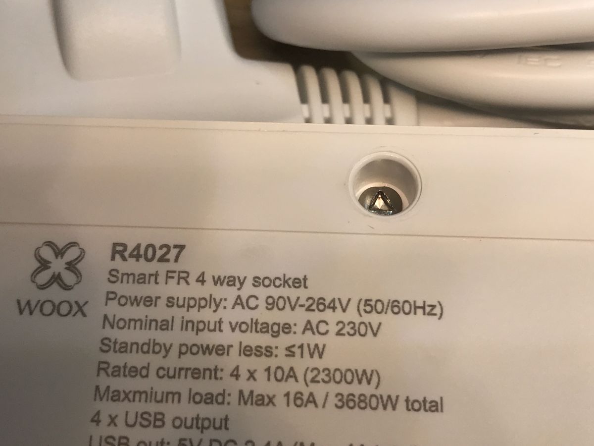

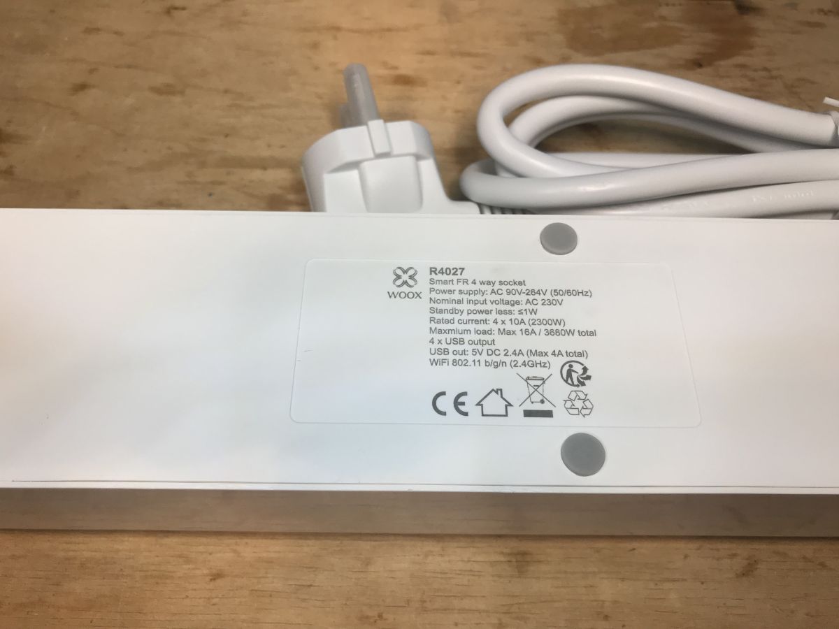

    List has screws hidden under the feet, but the screws require a triangular screwdriver:
    Nameplate of the Woox R4027 power strip with technical specifications.

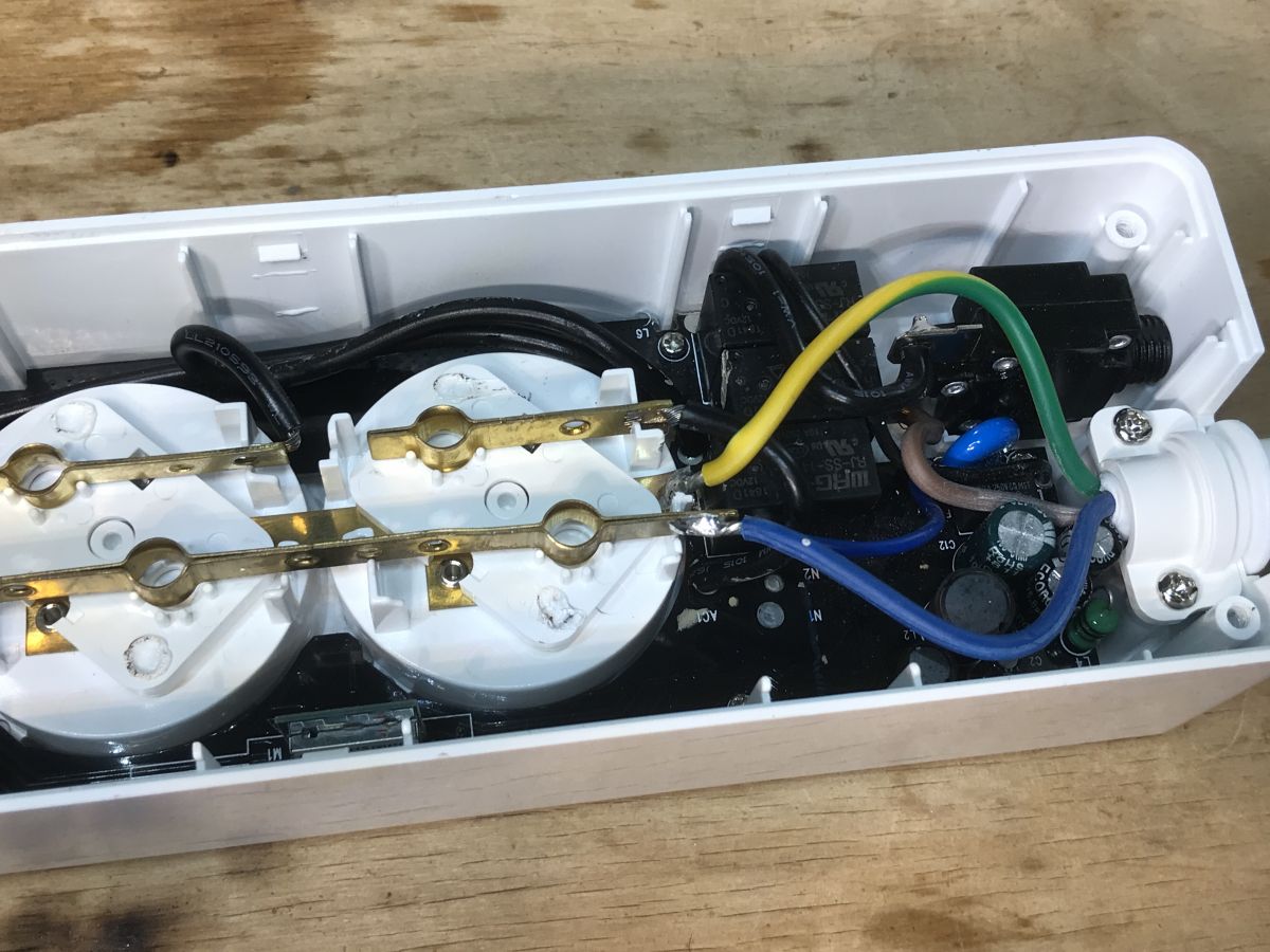

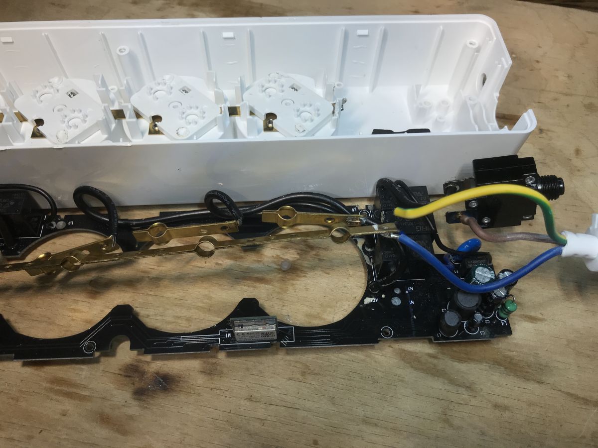

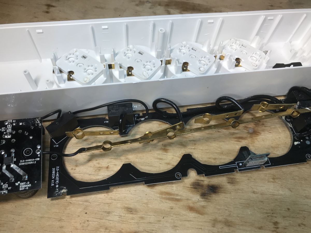

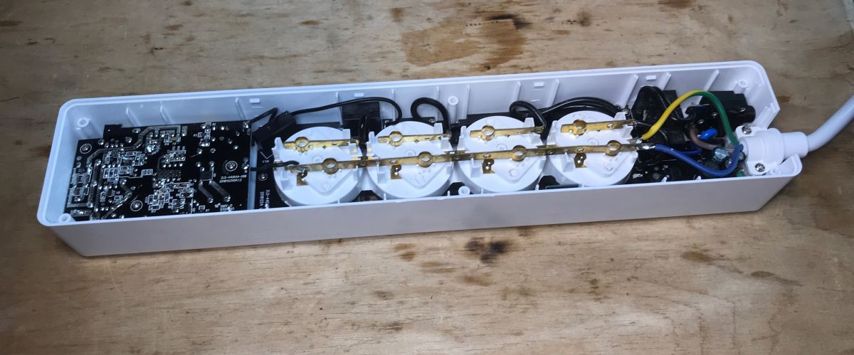

    When the screws are removed, we discover a rather rich interior:
    View of the interior of the Woox R4027 power strip, showing electronic components.

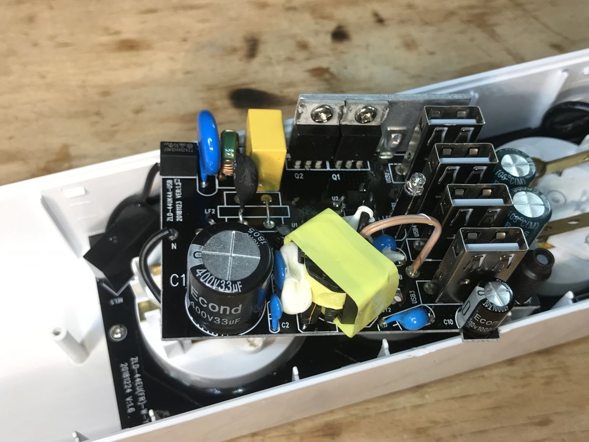

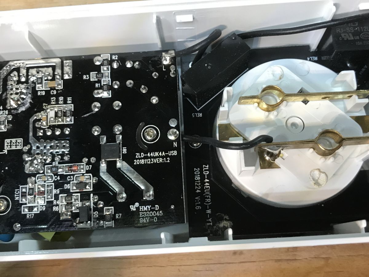

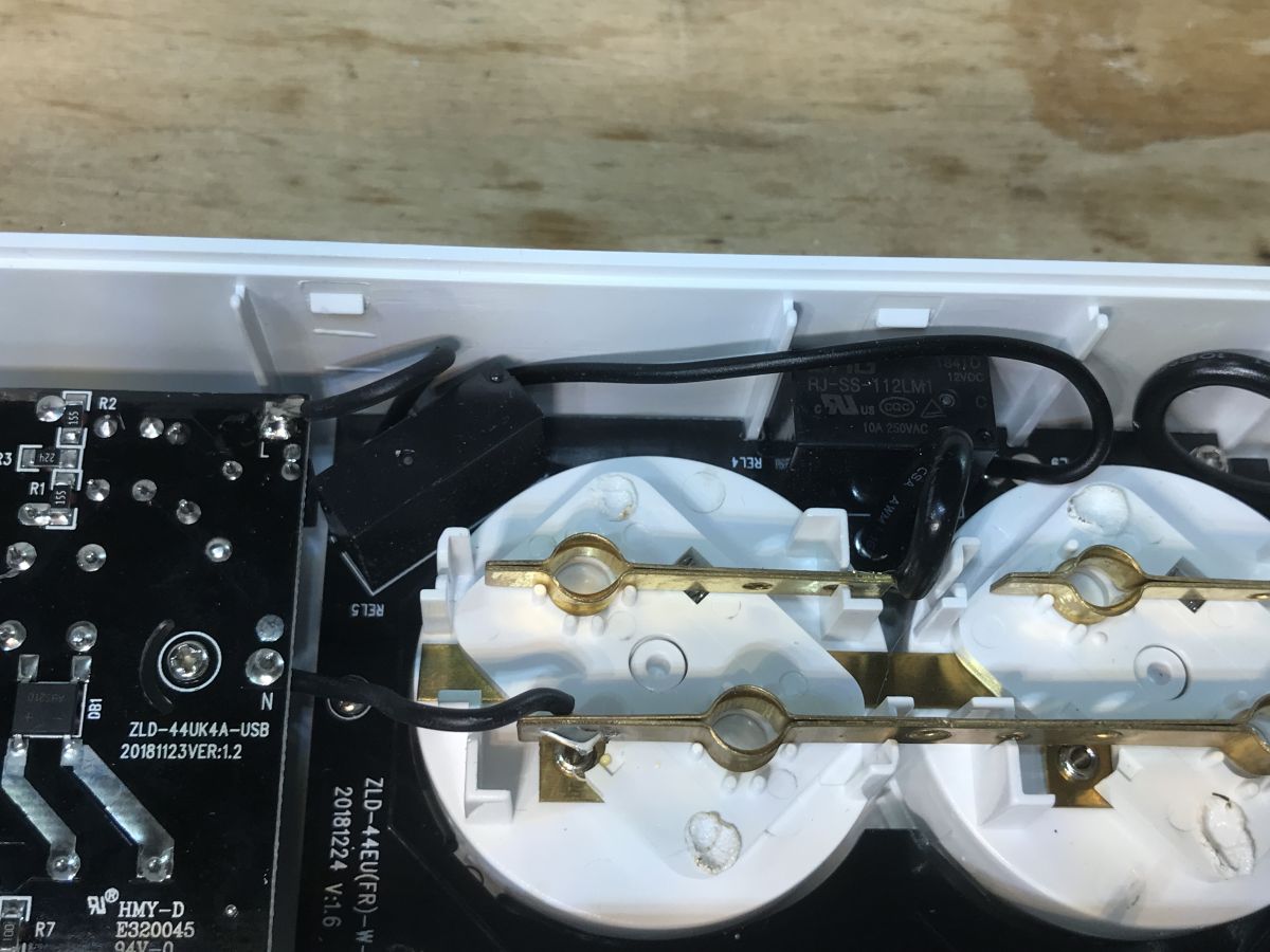

    This is the charger module, it is connected with only two wires, N and L:
    Interior of an electrical power strip showing a PCB and components.

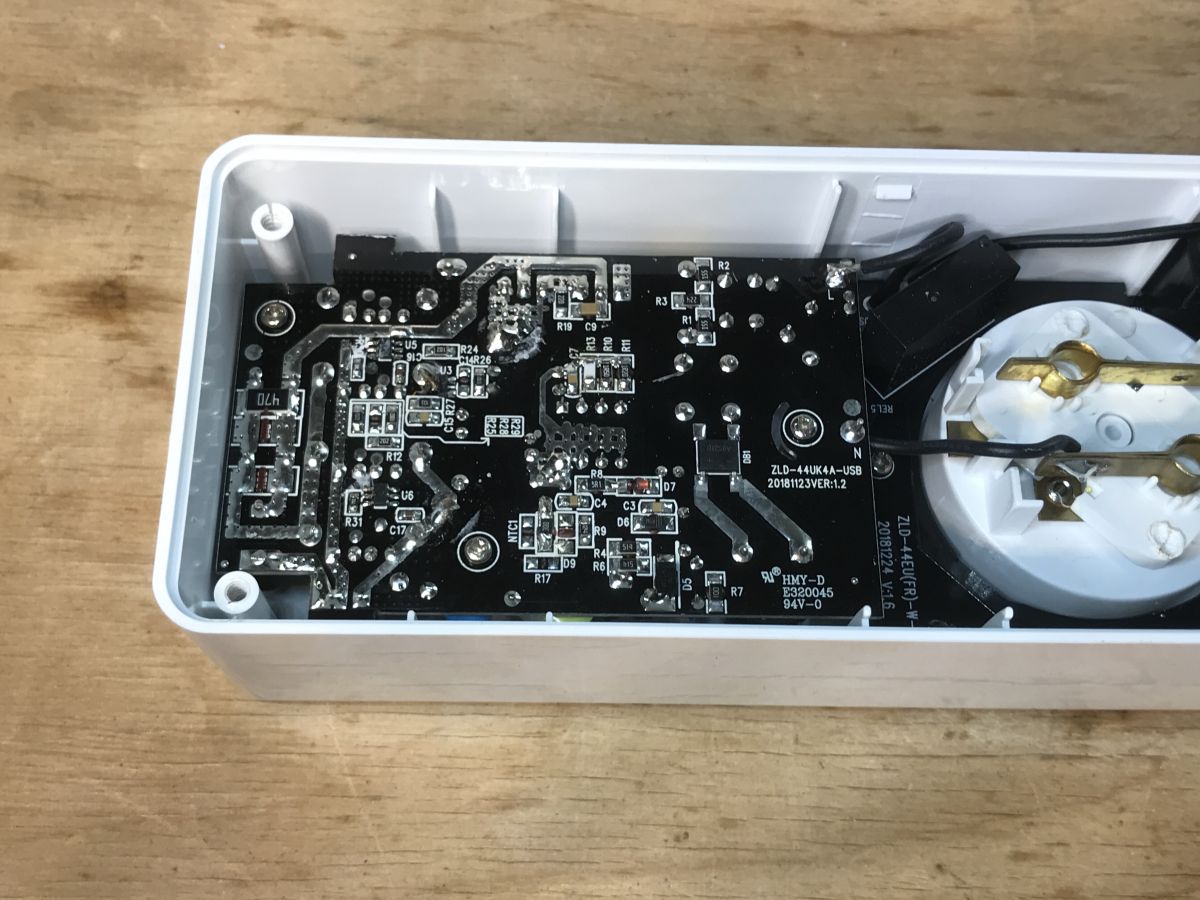

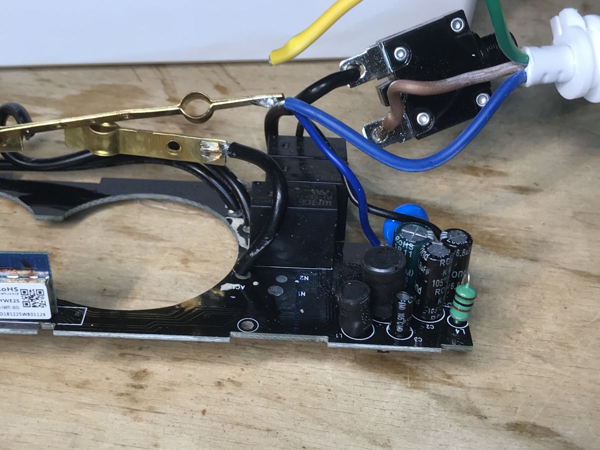

    Underneath you can see the PCB with relays and WiFi module, there is also a ground connection and a fuse:
    Interior of a power strip with visible wires and electronic components

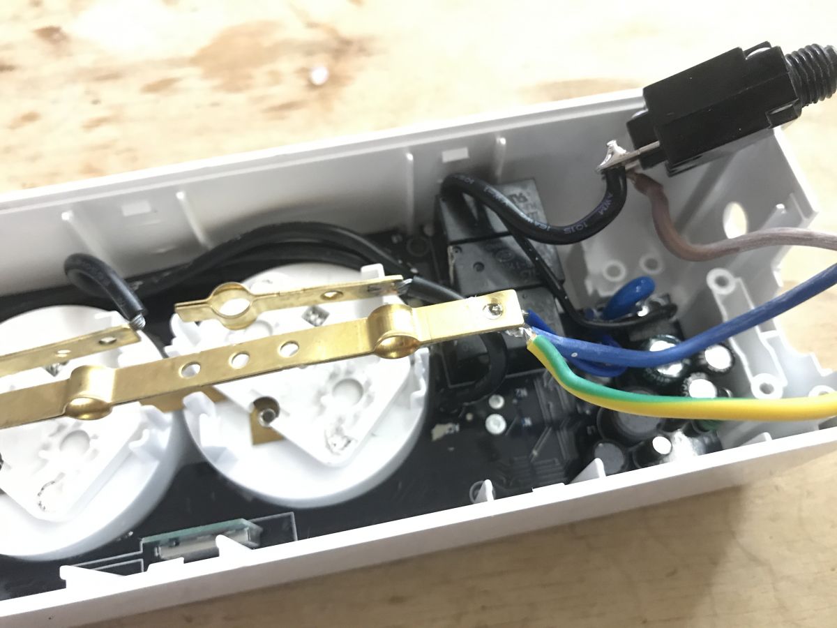

    Removing screws:
    Interior of Woox R4027 power strip showing electronic components and wiring. Interior of the Woox R4027 power strip showing electrical components. Interior of the Woox R4027 power strip showing electrical components.
    Power supply module removed. You can see that this 4.5A gives, this is not a typical 2A power supply:
    Interior of the Woox R4027 power strip with visible electronic components. Interior of Woox R4027 power strip showing electronic components.

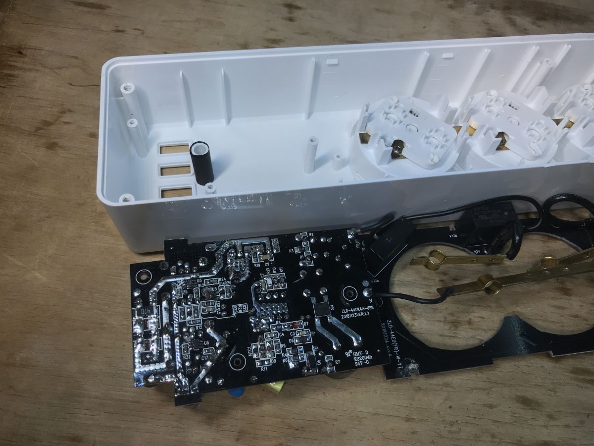

    To remove the second PCB you have to desolder the ground. It must be soldered in place after the firmware change:

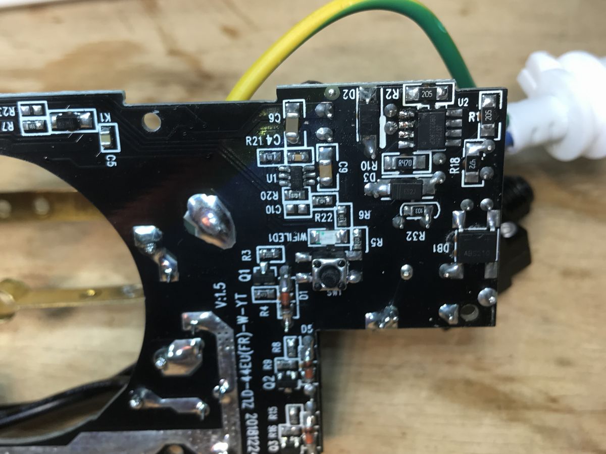

    Finally freed PCB:
    Interior of a power strip with surge protection and USB charger module View of the interior of a power strip with exposed PCB and white casing. Disassembled interior of the Woox R4027 power strip with visible components.

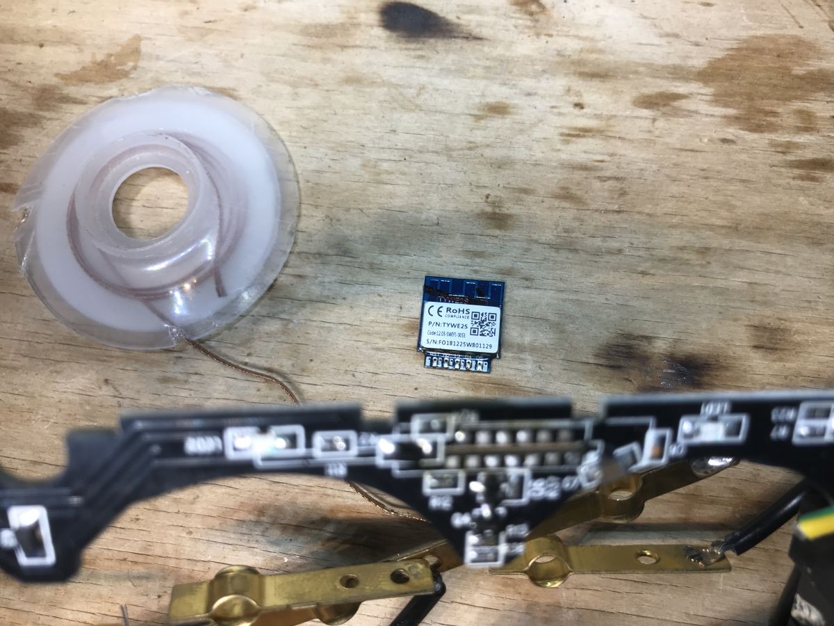

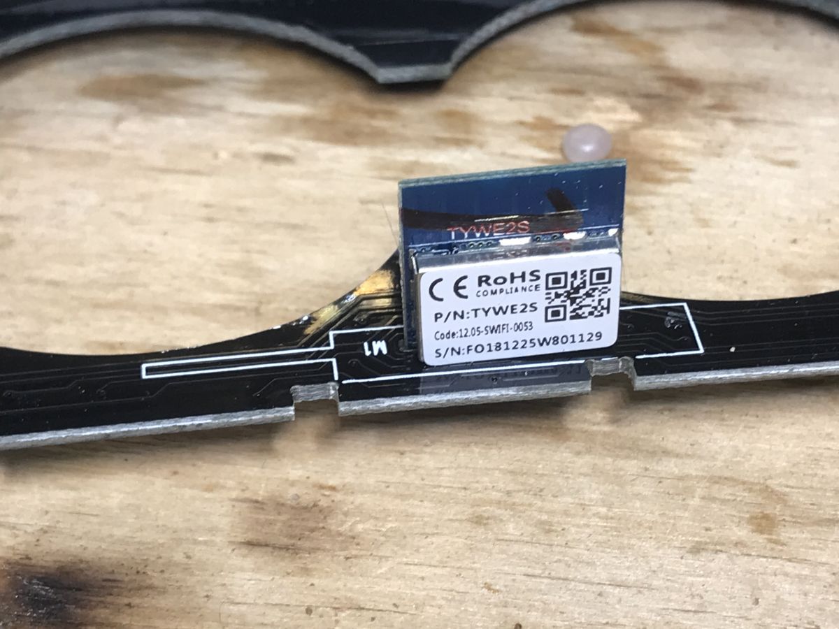

    Well, there's the WiFi module - TYWE2S:
    WiFi Module TYWE2S on PCB.
    There you can see the ground cut and the power supply module:
    The interior of the Woox R4027 power strip with visible WiFi module and electronic components.

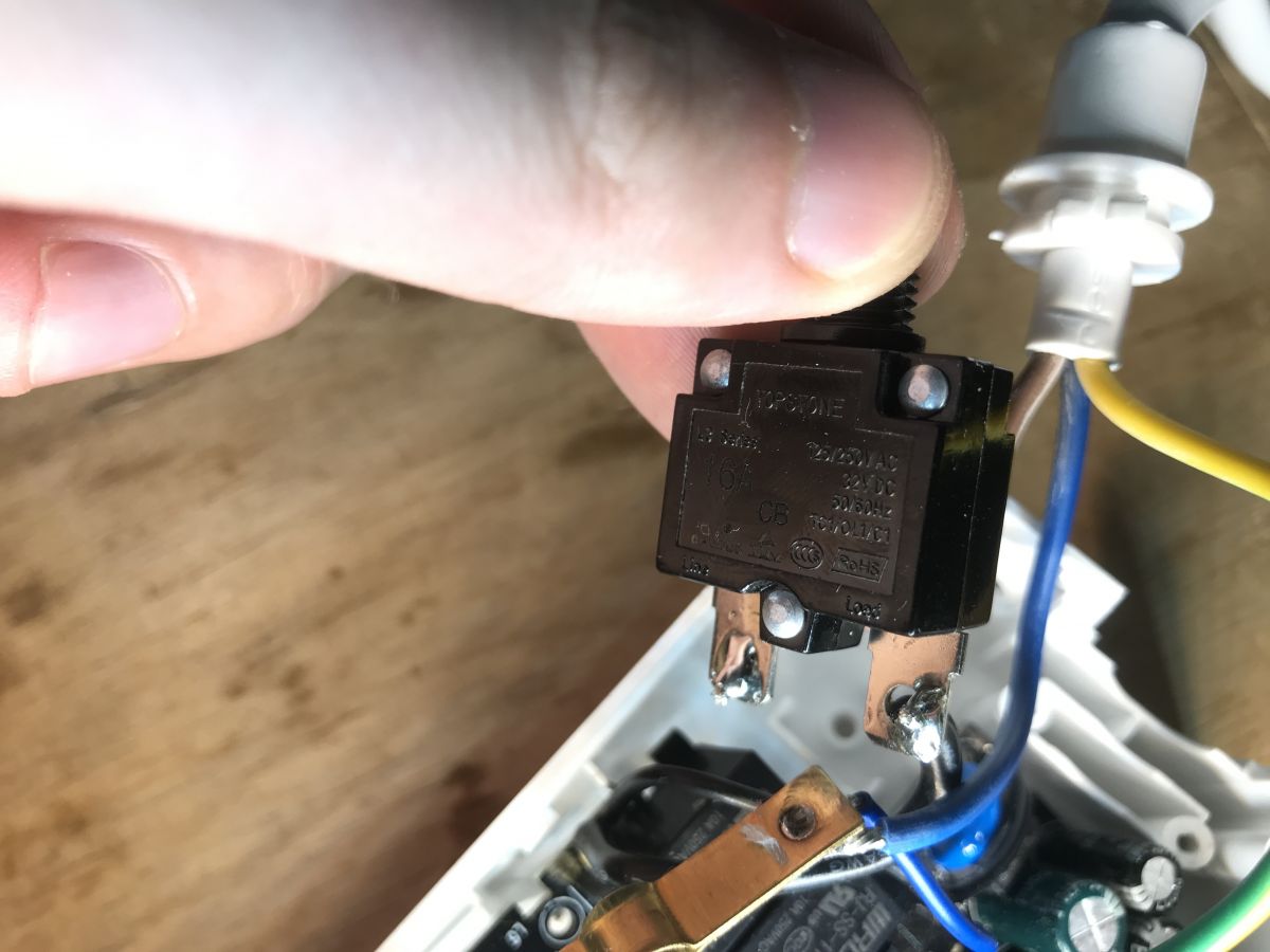

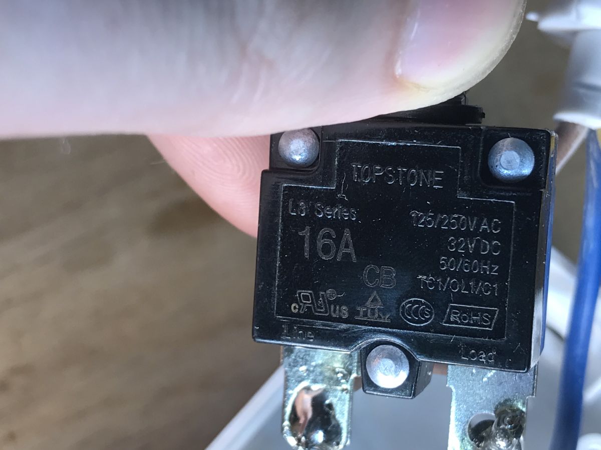

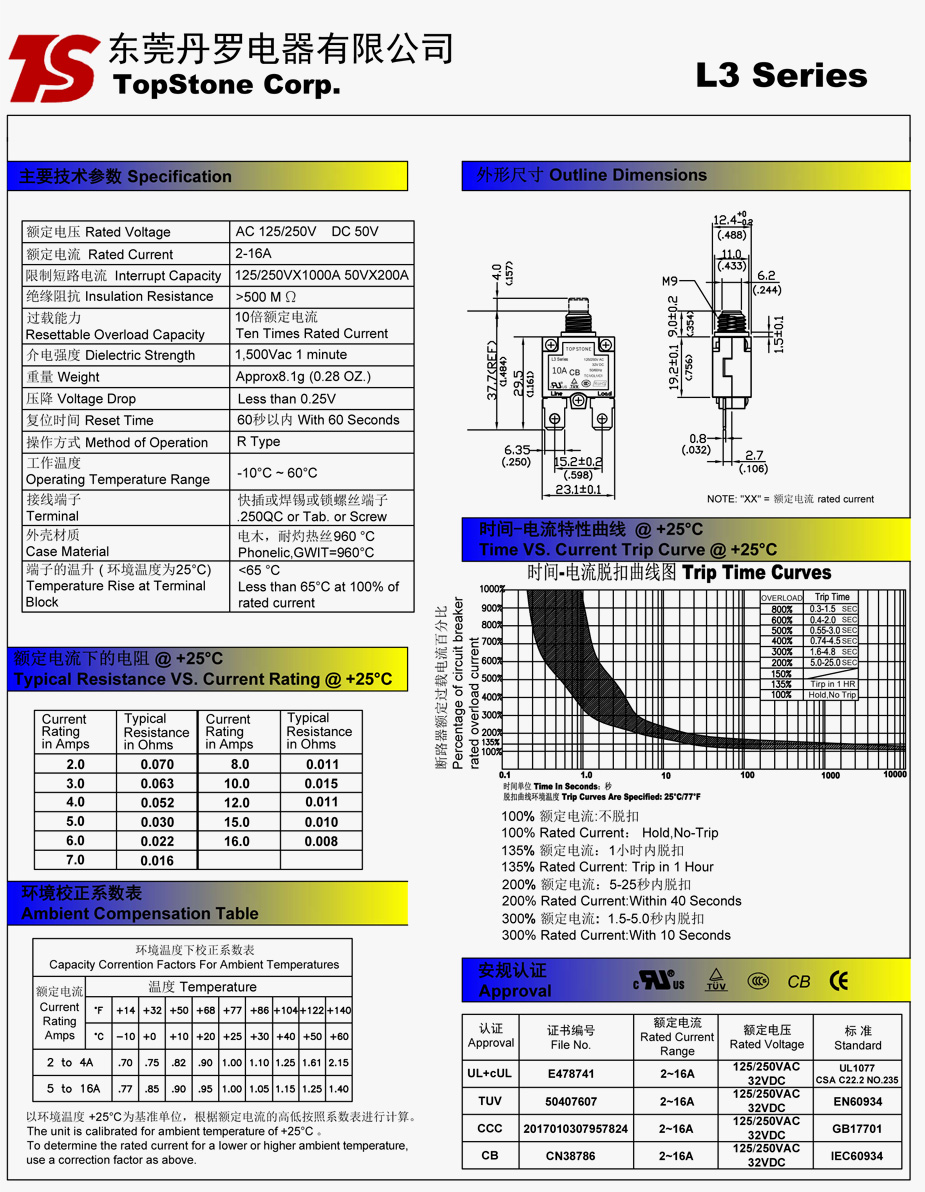

    For this strip we are protected by Topstone L3 Series 16A:
    Close-up of a Topstone L3 Series 16A relay held in hand. Close-up of a Topstone L3 Series 16A overcurrent protection device.
    This is a definite plus! Other reviewed strips offered nothing like this:
    Specifications and dimensions of the TopStone L3 Series circuit breaker

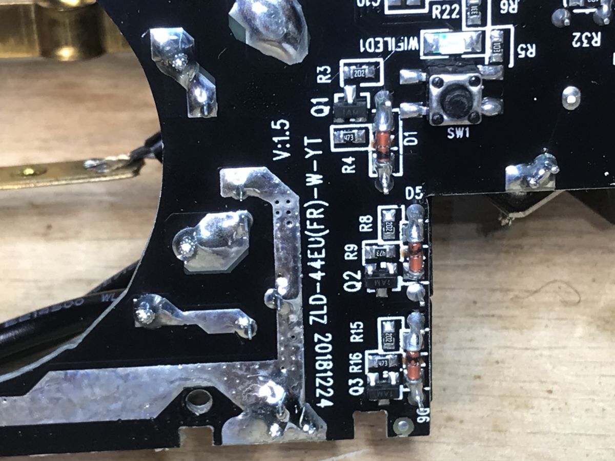

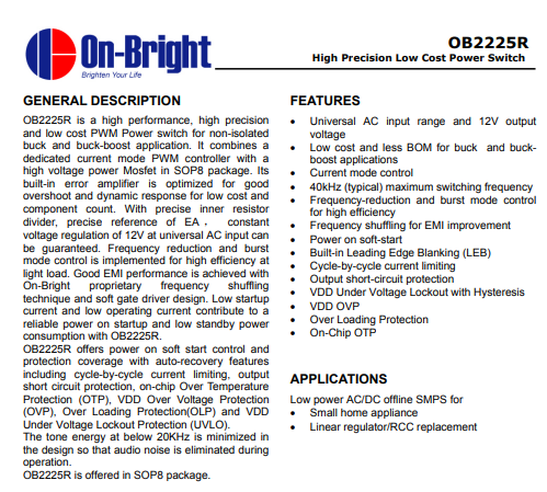

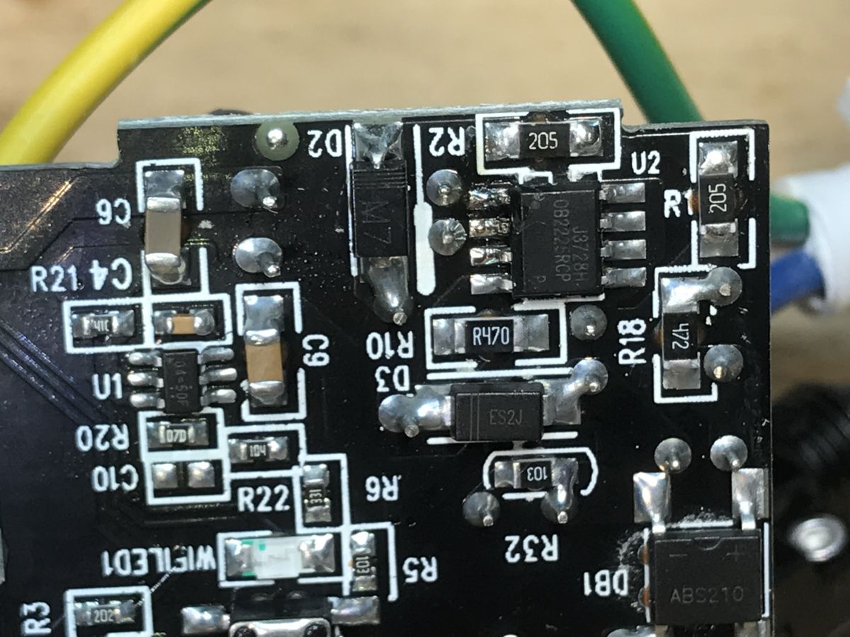

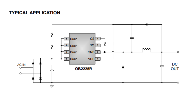

    The PCB power supply with WiFi is built on the OB2225RCP. Its designation is ZLD-44EU(FR)-W-YT V:1.5
    Close-up of the Woox R4027 power strip PCB with electronic components. Close-up of a PCB with electronic components. Close-up of a PCB with electronic components. Close-up of a section of a printed circuit board with markings ZLD-44EU(FR)-W-YT and electronic components.
    Close-up of a section of a printed circuit board with markings ZLD-44EU(FR)-W-YT and electronic components. This is not an isolated power supply, it is a step down converter:
    Typical application schematic for the OB2225R chip.
    Even according to the datasheet it is a circuit for smart home applications:
    Datasheet for OB2225R chip, designed for power applications.

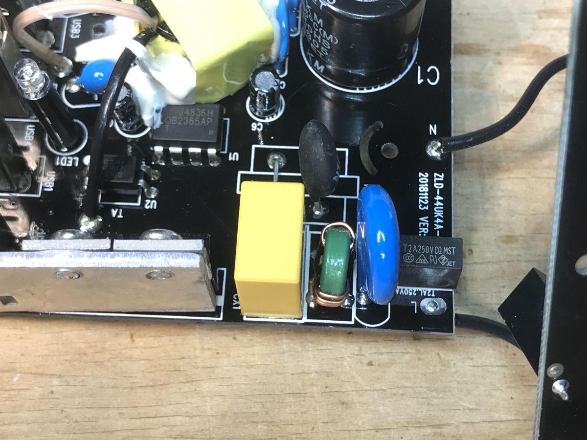

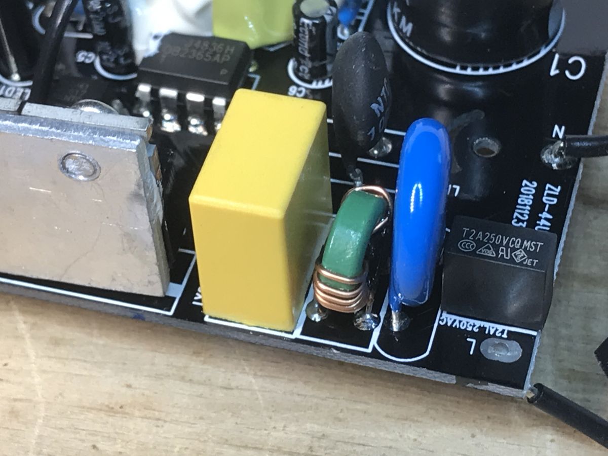

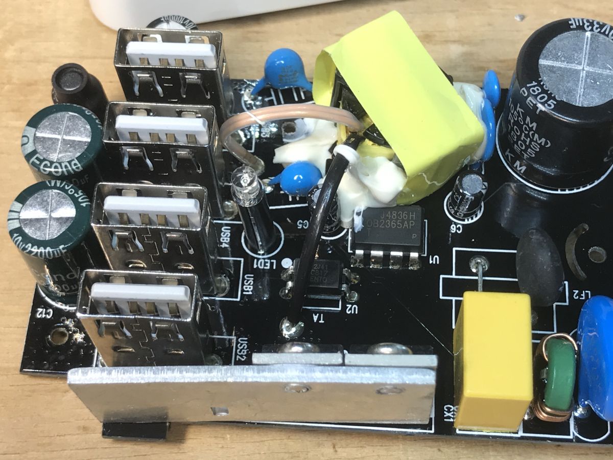

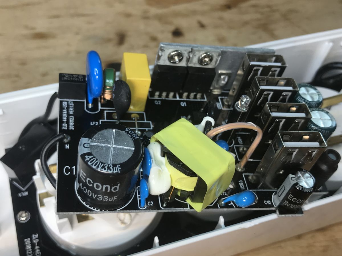

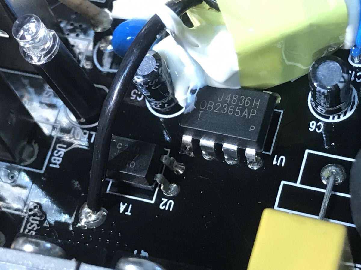

    The USB power supply looks a bit better, it even has filters on the input, varistor, capacitor:
    Internal layout of the Woox R4027 power strip showing USB ports and electronic components. Close-up of the Woox R4027 power strip PCB with circuit components. Close-up of an internal electronic component of the Woox R4027 power strip with various parts.

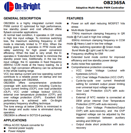

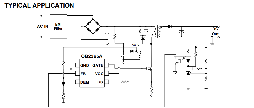

    It is based on OB2365AP:
    Close-up of OB2365AP integrated circuit on a printed circuit board.
    This time it's a flyback:
    Technical information page of the OB2365A PWM controller for a power supply.
    Typical application schematic with OB2365A circuit.
    I'm a bit confused about the leads, in the photo there are 8 legs, in the note there are 6, but I see also an optocoupler in the photo so probably the layout is similar to the one in the note.

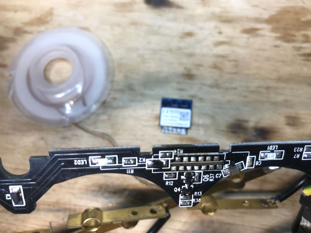

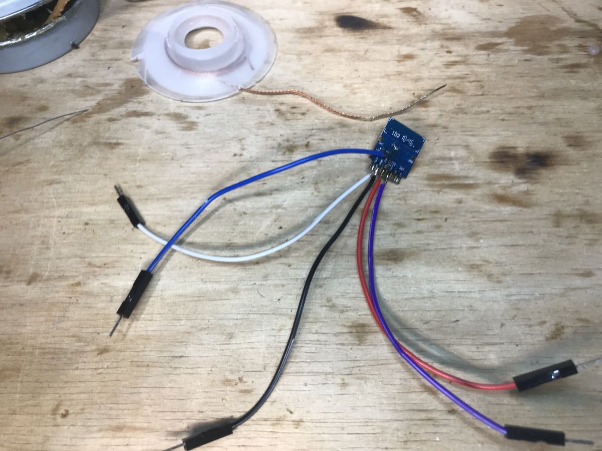

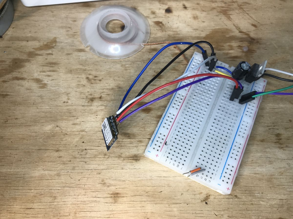

    Changing firmware
    For convenience I soldered the WiFi module using the flux + braid method:
    WiFi module and PCB of Woox R4027 power strip on a wooden background. WiFi module TYWE2S from the dismantled Woox R4027 power strip on a wooden workspace.
    TYWE2S is ESP8266, you need to solder RX, TX, VDD (3.3V), GND and GPIO0:
    PCB with connected wires on a wooden surface. Close-up of ESP8266 WiFi module on a breadboard.
    Programming as usual:
    SmartLife switch - test, interior and programming light switch on WiFi

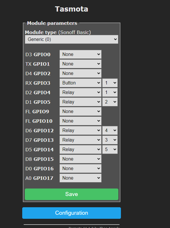

    I uploaded Tasmota via esptool, no problems.
    Role of leads guessed. The TYWE2S only has a few leads, not many options:
    Screenshot of Tasmota configuration for Woox R4027 power strip
    The fifth relay is USB. The first four are sockets.
    I almost forgot - the LED from WiFi is on the TX.
