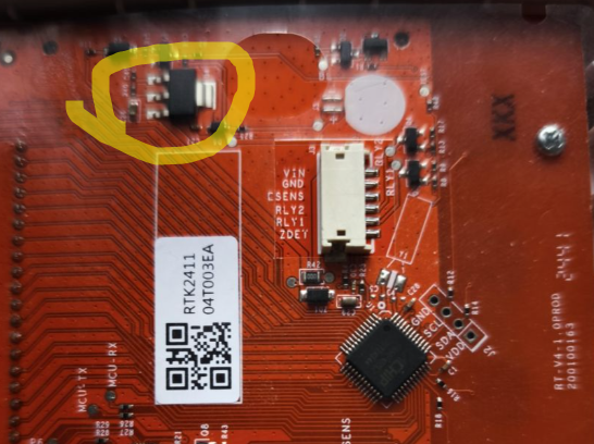

    Ok, so what is on the other board? How it looks like?
    Would you be able to determine what is the voltage on Vin, when device is powered? Do you know how to do it in safe manner? I don't want you to short and burn your device, so take care....

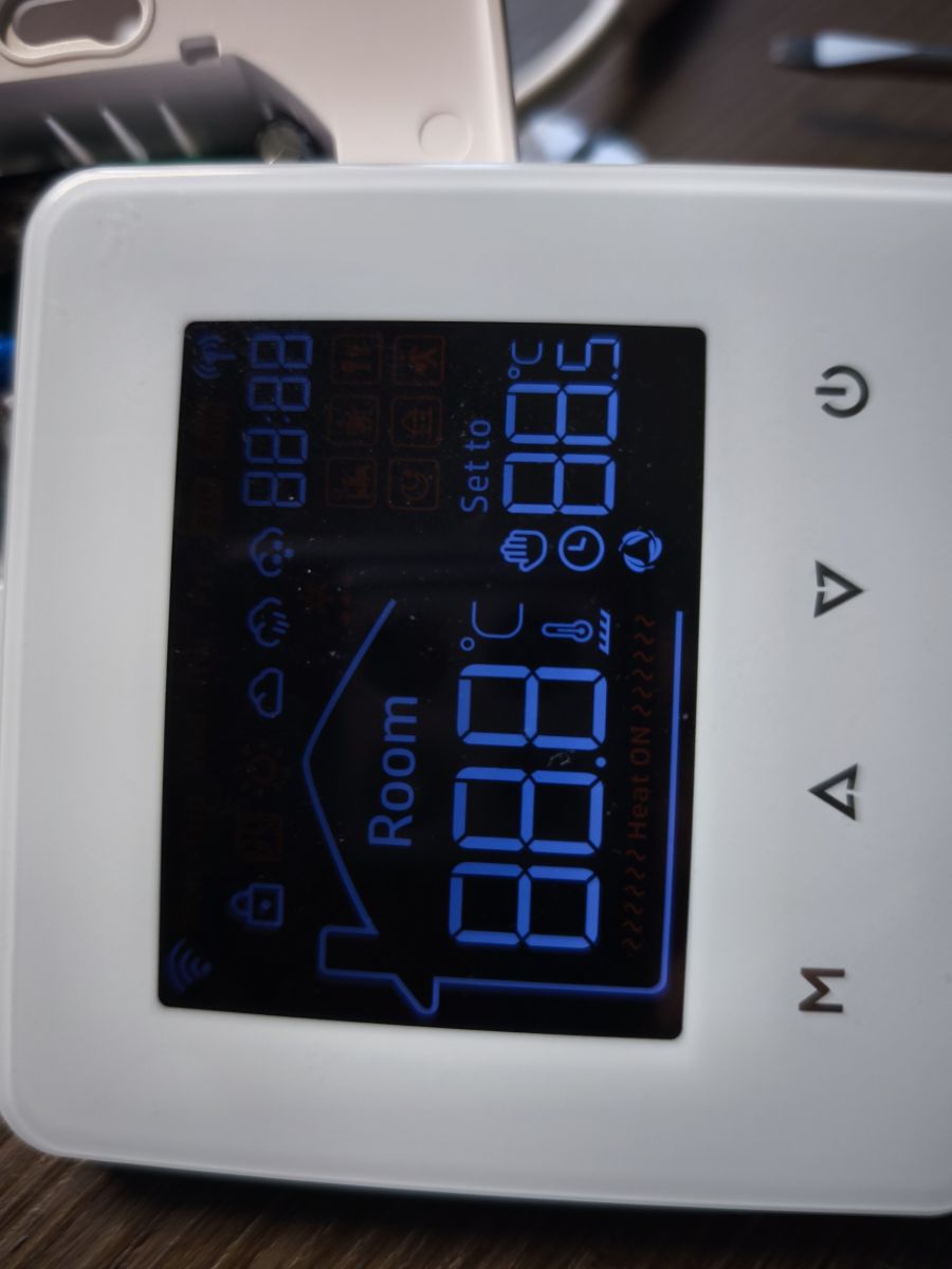

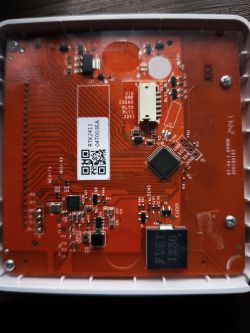

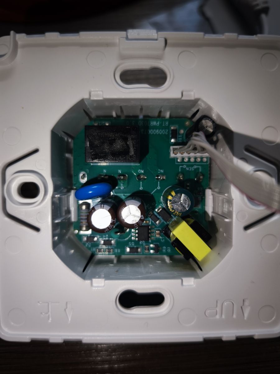

    the chip is near ca51f452l2
    the board is LCD powered, but the settings like in other tuya thermostates.
    Room thermostat display with blue backlight and various function icons.
    Thermostat PCB with capacitors, relay socket, and wire connectors inside housing
    Added after 22 [minutes]:
    and UART2 TX/RX is on my board connected to MCU RX/TX, and then connected to pins on ca51f452l2 chip. it's looks like serial conection from bk7321

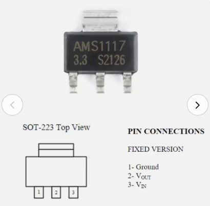

    Is this AMS1117-3.3V? LDO regulator?
    AMS1117 component on red PCB, regulator circled in yellow.
    AMS1117-3.3V view with labeled pin functions and SOT-223 top drawing
    Does VIN connects to the VIN of AMS1117?
  • #35 21645081
    bl00dy
    Posts: 38
    yes, it's AMS1117 3.3
    pin 1 is connected to GND, and
    pin 3 connected to VIN

    So, if you want to do a packets capture in a safe manner, without risking making shorts, connect GND to USB GND, and VIN to 5V from USB. Then RX and TX from the same USB to UART converter can be used, use RX to try capturing packets. So basically, device will be powered through your USB to UART converter, but not directly from 3.3V, but from 5V via AMS1117-3.3V to get 3.3V on MCUs...
    NOTE: Do not confuse connection and do not connect 5V to 3.3V - it will burn chips...

    I am currently see 12V on AMS1117. Is it ok, to provide 5V from USB FT232RL. Do I need to power ON 220V device with a hat? or just use one board?

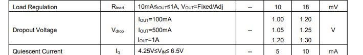

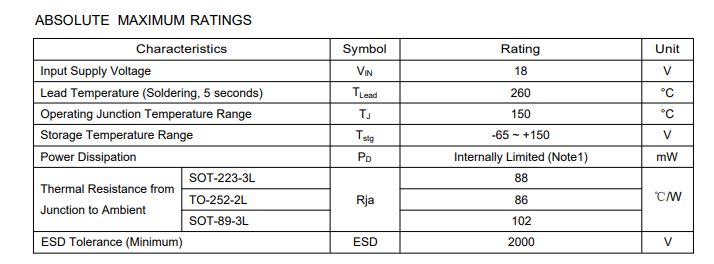

    What, Tuya uses 12V on AMS1117? Really? Well, maybe you are right, it's within range.
    AMS1117 maximum ratings: 18V input, 150°C junction, up to 2000V ESD tolerance
    Ok, so my idea is to feed 5V to VIN. It should be enough for AMS1117 LDO for stable 3.3V output. It's as in title - LDO, low droupout regulator. It should work well with 5V. Dropout voltage is 1.3V top so 5V is enough.
    AMS1117 datasheet excerpt with load regulation, dropout voltage, and quiescent current
    For this test, you do not want to connect it to mains power. This is the whole point - try running it in a safe manner, just WiFi chip and MCU.
    Power everything from single USB to UART converter. If not sure, show photo.

  • #42 21645378
    Posts: 14771
    Rate: 12914
    Are you sure that this UART line connects to MCU? Did you check with multimeter? It looks like debug log.
  • MCU console dump at 38400 8N1 after TX/RX swap
    #43 21645412
    bl00dy
    Posts: 38
    no, it was from console. this is from MCU, speed 38400,8,n1. two parts, changed tx and rx

  • #45 21645491
    Posts: 14771
    Rate: 12914
    This is TX2/RX2? TuyaMCU but at non-standard baud 38400?
  • #46 21645770
    Posts: 14771
    Rate: 12914
    This might work in OBK with tuyaMcu_setBaudRate command.
    Interestingly enough, it's not a standard baud like 115200 or 9600, which are often used in TuyaMCU.
  • #47 21646032
    bl00dy
    Posts: 38
    yes, now I can see Tuya data on UART2 (TX2/RX2), and yes, speed is 38400
