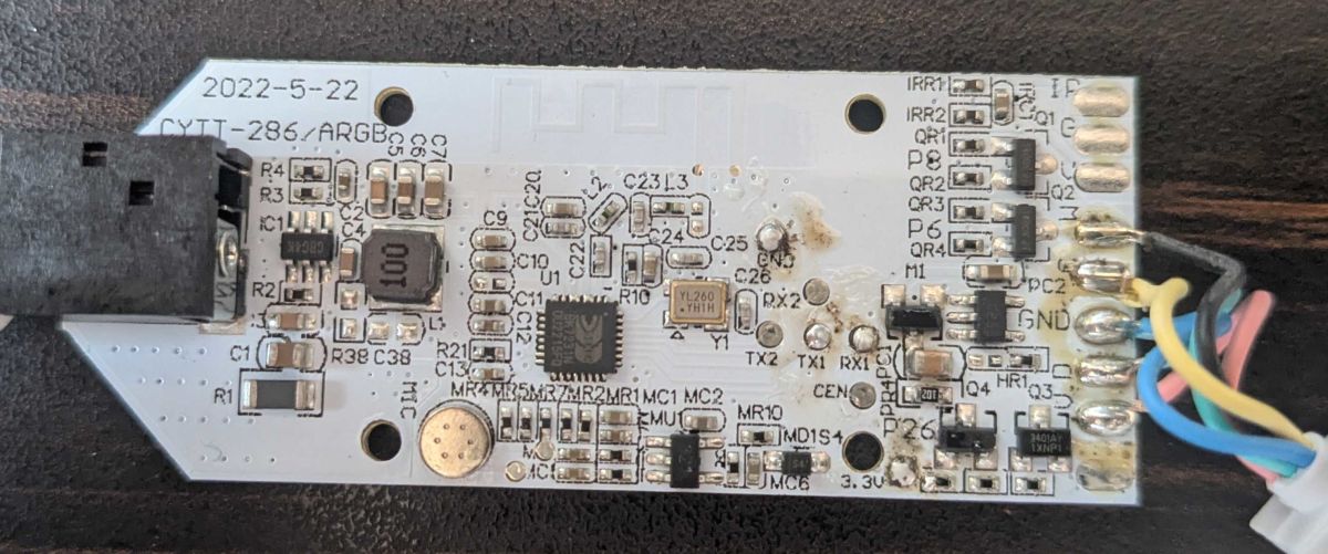

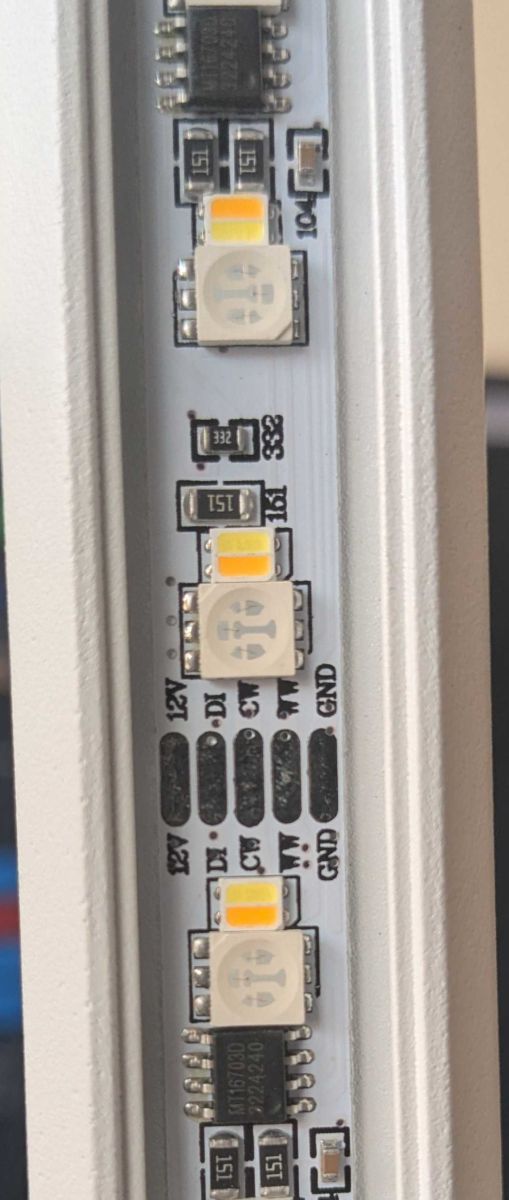

    I have successfully flashed OBK on the Arlec ALP211HA but I'm not sure what the correct module configuration is for OBK. Please see the attached pictures of the PCB and LED strip.
    CYTT-286 PCB board dated 2022-5-22 featuring a BK7231N SOC chip and connected color-coded wires for LED strip control.
    Close-up of an RGB+CCT LED strip with MT16703D control chips and labeled connection pads.
    This product is using the BK7231N SOC and the LED strip is a combined Warm White / Cool White addressable RGB LED strip using the MT16703D. Pins 6 (channel 4) and p8 (channel 5) are PWM pins that control the brightness and colour temperature of the white LEDs, and p26 is the data pin for the MT16703D. The problem is I'm not sure what the correct configuration is for p26 in OBK. A quick Google search indicates that the MT16703D might be compatible with the WS2815 / SM16703P, so I tried setting p26 to SM16703P_DIN and the startup command to:
    startDriver SM16703P
    SM16703P_Init 90
    startDriver PixelAnim
    but regardless of what I set the LED controls to in the OBK web UI, neither the RGB or white LEDs come on. I am able to get the white LEDs to function correctly if I set p26 to high / always on; when I do this, the colour temperature and brightness sliders in the OBK web UI control the white LEDs as expected. The problem with setting p26 high is that the RGB LEDs are also on and at max brightness, producing a bluish white colour. If p26 is floating / low / unassigned in OBK, then none of the LEDs will turn on -it doesn't matter what p6 and p8 are set to.
    I'm new to OpenBK, so any assistance would be appreciated.

    Set P26 to PWM. That should allow you to control brightness.
    SM16703P on BK7231 always use P16.

    Usually we use two PWMs - first for Cool White, second for Warm White.
    Still, it seems you are saying:
    That would indicate that you need to enable alternate CW mode flag, which is used for special case where one PWM controls brightness of CW LEDs, and second PWM controls the temperature.

    #4 21651857
    alexlednoob
    Thanks for your replies.
    I tried setting p26 to PWM, but this leads to strange results, like some of the LEDs blinking random colours. If you have a look at the pictures above, it seems like p26 is wired to the DIN input of the strip, which means it's probably expecting 24-bit colour data rather than PWM on this line. I wasn't able to find a data sheet for the MT16703D, but a few strip manufacturers are saying it's compatible with the WS2815 protocol, which is very similar to the SM16703 (tick rate of 800 kHz with the same timings for the symbols). The main difference appears to be the colour order (RGB for the SM16703 vs. GRB for WS2815); see:
    WS2815
    SM16703
    Regarding the white LEDs, I assumed it was the alternate arrangement (brightness and colour PWM) because other Arlec products work that way, but it turns out not to be the case with this strip, so there is no need to set the alternate CW flag.
    The problem is that the white LEDs don't come on at all if p26 is left unassigned. I'm guessing the white LEDs don't get power unless the MT16703D receives something on DIN.
    In case it helps, here is the Tuya config extracted by the GUI flasher tool:
