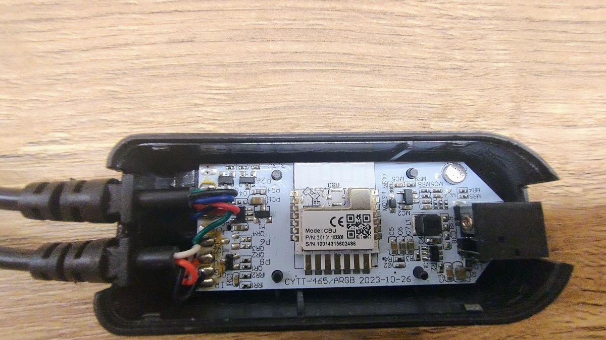

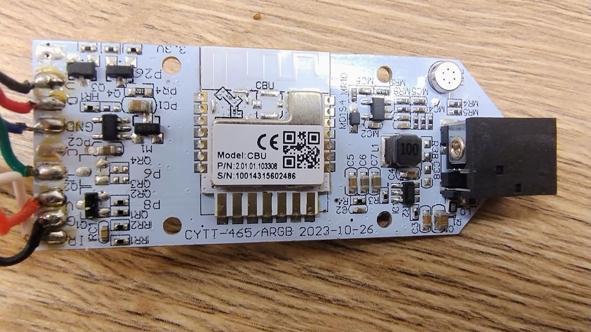

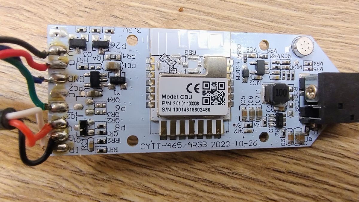

    How to correctly configure a mixed RGB addressable LED lamp driver 28 segments of 3-4 LEDs plus one white colour. This is a LED strip vertical corner lamp 1.4m high
    The driver generally already works on Openbeken, but I can't deal with two issues: I don't know how to control white and RGB colour separately.
    I've traversed, ripped the firmware and configuration. And what I have already come to:
    PWM of white colour - P8
    RGB LED voltage control - P26
    RGB driver D - P16
    IRRecv - P20
    Microphone - P23
    And three buttons: P7, P24 , P22 as C, ON, M.
    I mainly care about being able to switch between white tape and RGB and possibly switch them on at the same time. And to control the brightness separately for white and RGB. The rest I think I can grasp.
    Here are the pictures of the controller:
    LED controller with CBU module and PCB labeled CYIT-465-ARGB
    LED controller board with CBU module and pin labels visible on PCB
    LED controller with CBU module on CYTT-465/ARGB circuit board
