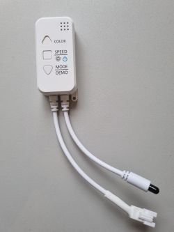

    Hi everyone

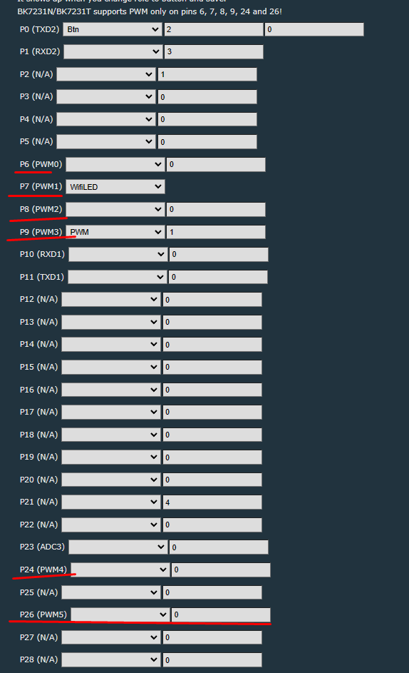

    I have an RGB LED corner lamp that I have flashed with OBK, using Tuya CloudCutter. The lamp is from AliExpress, model KB-1500B. The module is a BK7231N CBU. It includes WiFi, Bluetooth, IR remote and a microphone to sync lights to music. I have traced the buttons and can see the button presses in the web app logs.
    Any tips to find the rest of the config I need?

    If not, please note that BK7231N has six possible PWM pins. You can see that even in our configuration page:
    Configuring OBK-Flashed RGB LED Corner Lamp KB-1500B with BK7231N CBU from Aliexpress
    So, you are looking for 3 PWMs for RGBs and you have 6 possible PWM pins.
    There is not much to test.
    So I'd suggest it: For all 6 PWMs, set a Relay role, set channel 0 for PWM0, channel 1 for PWM 1, etc.
    Then try toggling each relay (while remembering on which PWM pin is it) and note which LED strip color changes.
    That way you can quickly narrow down to the 3 PWM pins you are looking for.
    Once you have already figured out correctly 3 PWM pins, then change their roles to PWM, as they should be, and then setup their channel order so Red is Red, Green is Green, etc... Remember, channel 0 is Red, 1 is green, 2 is blue. It will also work if you start numbering from 1.
    TLDR: guessing 3 PWMs from 6 possible PWMs is quick and easy to do.
    Alternate option would be to open CBU pinout on Tuya page, see which pins are PWMs are probe them with multimeter to see which PWMs are connected to MOSFETs

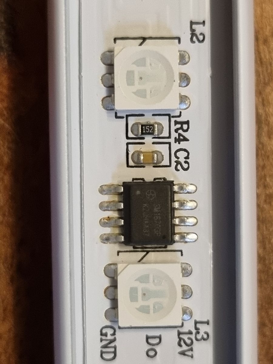

    The chip on the LED strip says SM16703P and KZBSAFAC21
    I don't have the original binary from the device, I stupidly rushed into flashing it in my enthusiasm to try out your work.

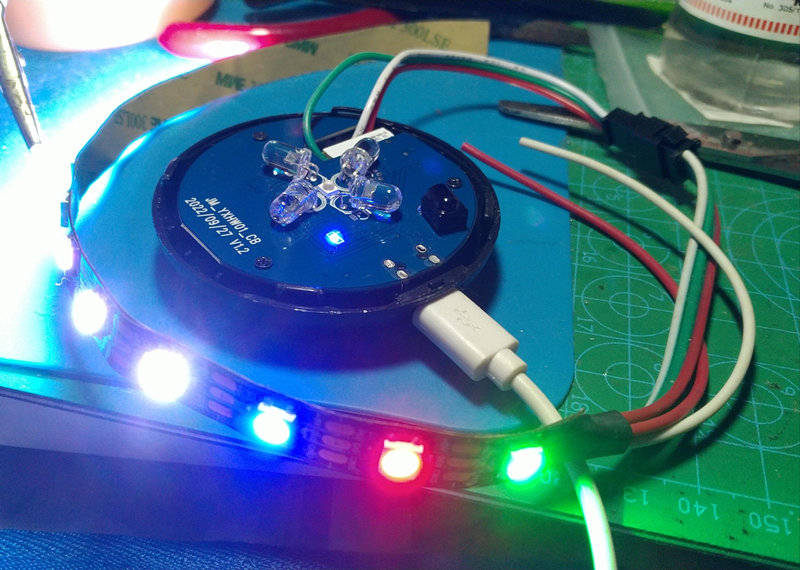

  • SM16703P data only reaches first 12 LEDs
    #7 20725135
    bruceda
    Posts: 7
    @p.kaczmarek2
    Apologies for the slow reply, I just saw your message now. Thank you for suggesting the above commands.
    I have tried applying them and I have included the logged output below. I enabled ExtraDebug to give as much detail as possible. I left MAIN and GEN disabled to cut down on logging noise.

  • Extra blue LEDs indicate wrong pixel mapping
    #9 20726415
    bruceda
    Posts: 7
    I get a similar result but now there are three extra blue LEDs at the top of the colored sequence with the rest still bright white.

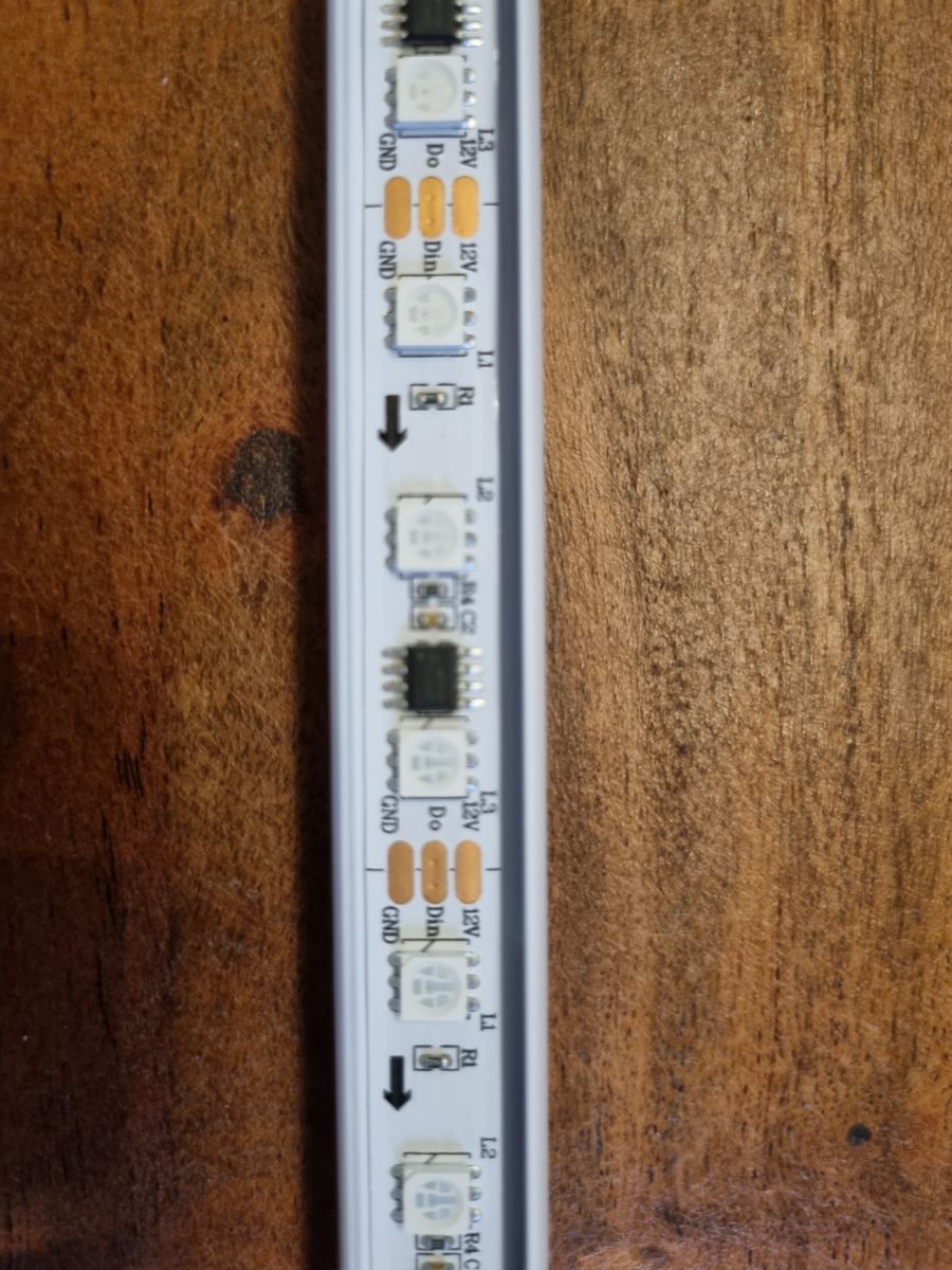

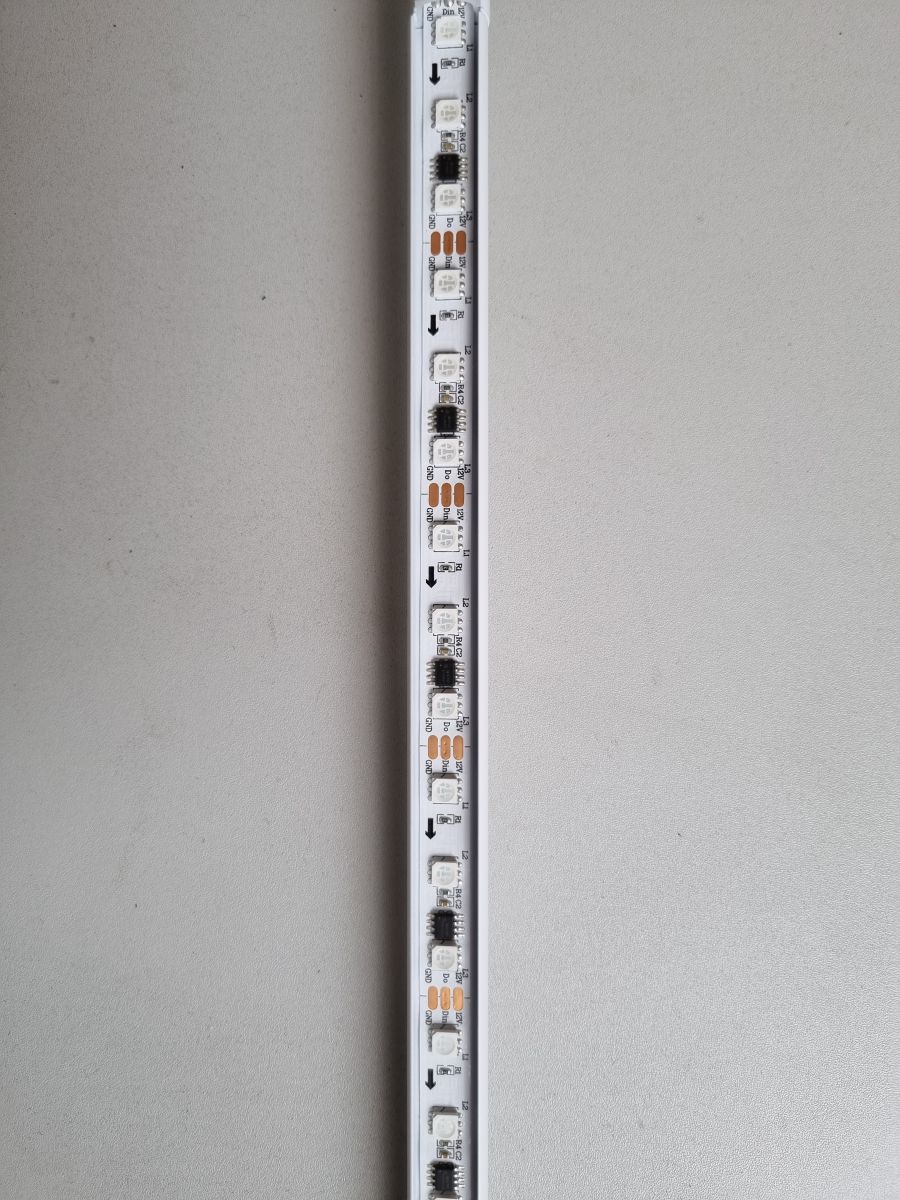

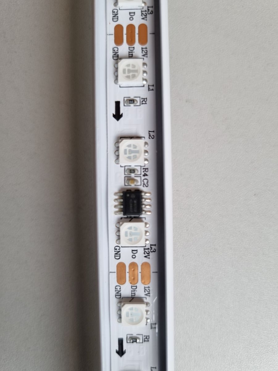

    Found these two images from the internet which suggest that there could be two variants of 16703 chips.
    One says that the chip controls 3 x LEDs the other one (which is SM16703P) controls 6 LEDs.
    If the OP can attach a photo with a longer part of the strip visible we could determine correctly which is what.
    1. MT16703
    Image of LED strips with visible MT16703IC and SM16703P chips, labeled Detail.
    2. SM16703P
    Close-up of an LED strip with SM16703P chip, capable of controlling six LEDs.
  • Strip appears to use MT16703 with one chip per 3 LEDs
    #11 20733874
    bruceda
    Posts: 7
    Welcome to the conversation @jkwim.

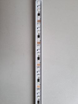

    Here are some additional images. My strip looks closer to the MT16703 image than the SM16703P image that you included. You can see in the second, closer image below that there is one chip per three LEDs. This also matches the behavior I observed when testing the commands noted above.
    Image of an LED strip with three LEDs per chip. Close-up of an LED strip with three LEDs per chip.
  • SM16703P segment mapping and BRG color order
    #12 20733941
    jkwim
    Posts: 186
    Rate: 25
    Ok! Now things make sense.
    SM16703P_SetPixel 1 255 0 0
    SM16703P_SetPixel 2 0 255 0
    SM16703P_SetPixel 3 0 0 255
    SM16703P_SetPixel 4 255 0 0
    SM16703P_SetPixel 5 0 255 0
    SM16703P_SetPixel 6 0 0 255
                 3W, 3B, 3R, 3G, 3B, 3R, 3G
    LED segments 0   1   2   3   4   5   6
    So you got 6 segments covered.
    Add a command for LED Segment 0
    SM16703P_SetPixel 0 255 0 0
    That should turn the first segment into Blue.
    So depending on the number of segments in the strip, add additional SetPixel command and you could have all of them change color.
    However, there is a catch. Generally, the LED strips have a different color order.
    From the look of things, your strip has BRG instead of RGB.
                         B  R G
    So by adopting the correct notation, you could now make them into any color that you want.
    The driver for SM16703 appears to be working.

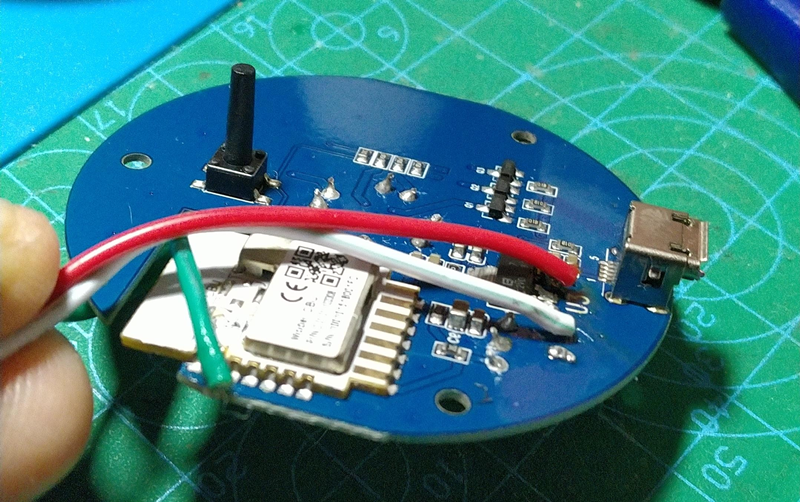

    #14 20734889
    jkwim
    Posts: 186
    Rate: 25
    Great!
    We have smoke now!
    I soldered a JST connector to P16 of CBU module of my IR Remote Controller and connected a WS2812 LED strip. The strip color order is GRB.
    Tapped 5V and GND from AMS1117 regulator input. That is USB +5V and GND theoretically so as long as the USB port receives enough current from an external power supply, the number of LEDs can be increased without compromising the capacity of the AMS1117.
    Close-up of a blue PCB with connected wires, a microcontroller, and a USB port.
    Close-up of an electronic module with a WS2812 LED strip connected to a connector, with LEDs shining in different colors.
    startDriver SM16703P
    SM16703P_Init 16
    SM16703P_SetPixel 1 0 255 0
    SM16703P_SetPixel 2 0 0 255
    SM16703P_Start
    However, I got different observations when I tried your looping script.
    After initial progression, the colors changed in a different manner. I have a feeling that the color gets mixed with previous colors instead of refreshing.
    BTW, I need to understand the "Channels" better as it is not very clear what a Channel is in this context.

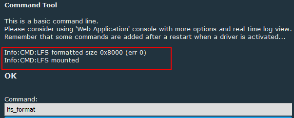

    How can I disable autoexec.bat using the command prompt in basic GUI? App launch is not possible in AP Mode.
  • #16 20736178
    Posts: 14755
    Rate: 12880
    I think you should be still able to use lfs_format, at least after you do unsafe start.
  • Alias cannot be used as if target command
    #17 20736429
    jkwim
    Posts: 186
    Rate: 25
    I think you should still be able to use lfs_format, at least after you do an unsafe start.
    lfs-format
    worked!
    Screenshot of the Command Tool showing messages about formatting and mounting.
    Thank you
