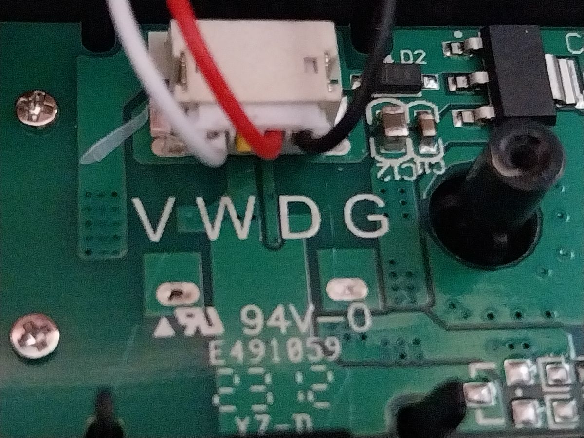

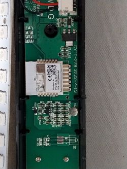

    Close-up of a circuit board with electronic components. A single Arlec Grid Connect Smart Desktop Bar light with a height of 300 mm and a base width of 90 mm. Two vertical LED light bars emitting multicolored light, positioned on black bases. A person holding a phone with a control app for Arlec Grid Connect Smart Desktop Bar Lights in the background.
    Flashing of Main Chip

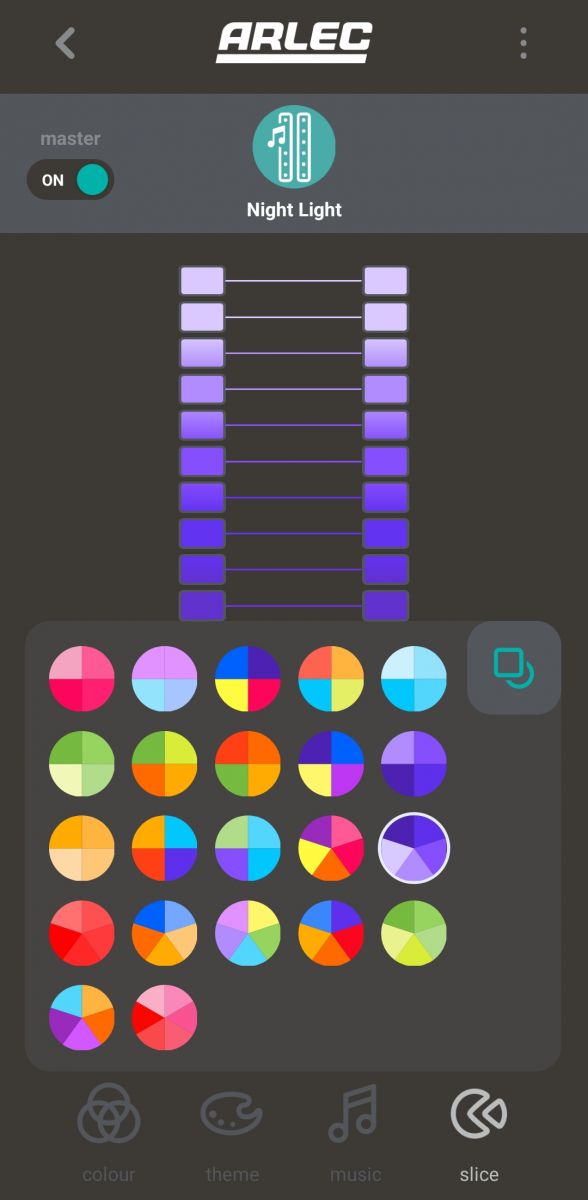

    So far I haven't put OBK on device. I think I'll wait until I can see if OBK can do what the mobile app can do.

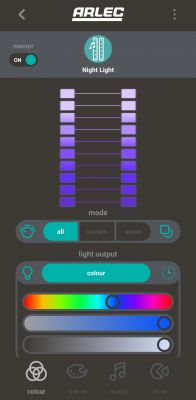

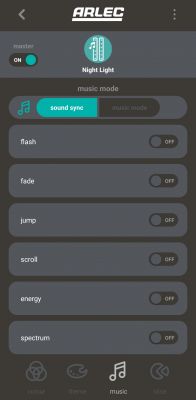

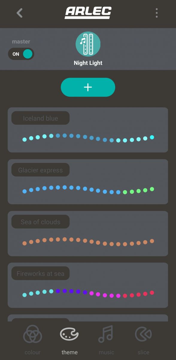

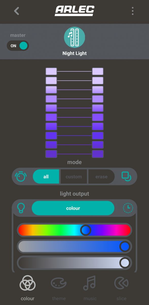

    The device have two separate addressable RGB strips inside with 10 led per strip. It has a mic for music mode as well.
    Arlec Grid Connect app interface for controlling desktop bar lights. Arlec app interface for controlling RGB desktop lights with various lighting themes. Arlec app interface for desktop lights with music mode. Screenshot of the Arlec app showing music modes for light synchronization. Arlec app interface displaying color options and night mode for RGB light strips.

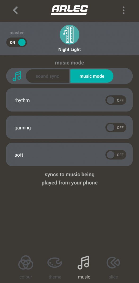

    As far as I can tell OBK does not have the fuctions that the mobile app has. I could use WLED but to keep all my devices the same I would like to use OBK.
    I'm not sure OBK will ever get all the functions that the mobile app has and I would have to create a custom entity in Home Assistant as well to handle this device.
    For now I am not converting this device. The app has some nice transitions and functions that work well for now. Would be great to not have it cloud based though.

    Hello, which GPIOs are used to control the strips?
    Are you sure that they are separate?
    I am asking because we are working on WS2812B driver and on similiar devices and as far as we know at the moment is that due to timing requirements only P16 (MOSI) can be used to drive that kind of LEDs, no other pin will work for that.
    If you want to help with development, you could just make 2MB backup, flash OBK for some testing, and once we're done, restore back to Tuya. What do you think? We could check if current SM16703 driver can handle your device, maybe I could try to help with adding some effects, etc.

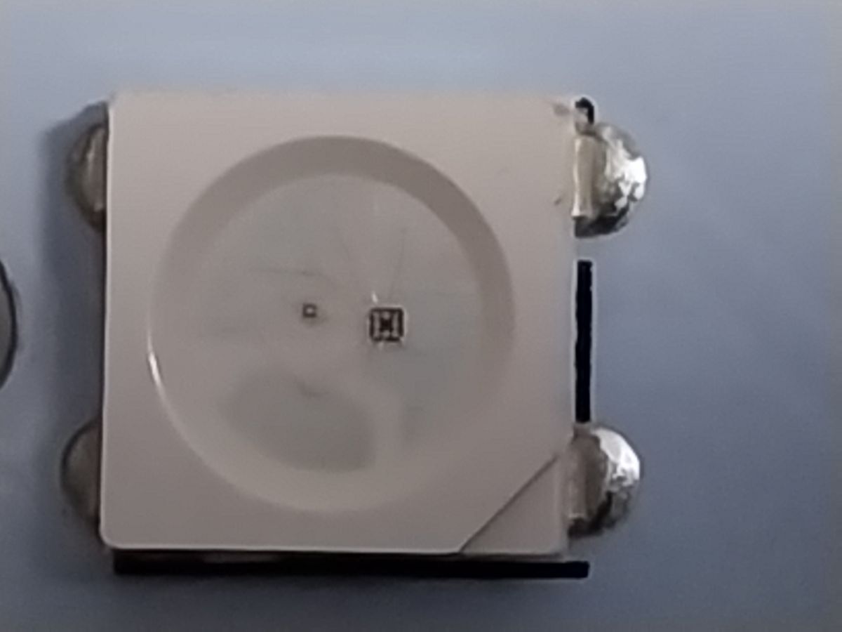

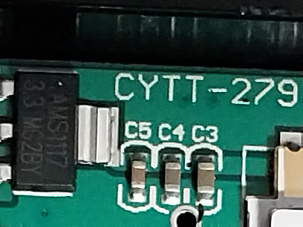

  • Plans to photograph LED strip and dump firmware

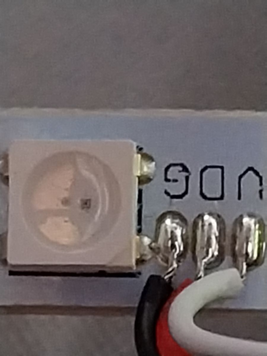

    I will have to tear down the device again and see if I can get a better photo of the LED strip. It is the one thing I forgot to take a photo of.

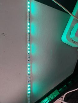

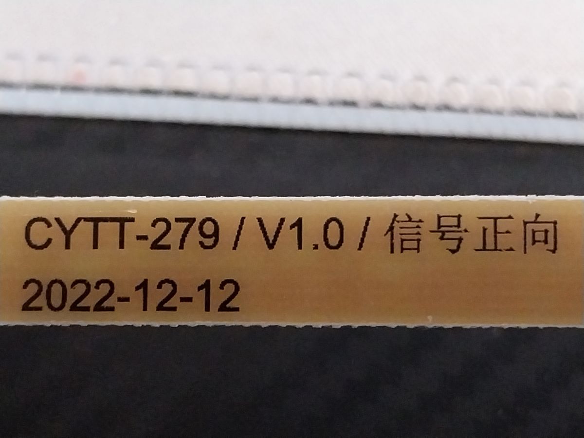

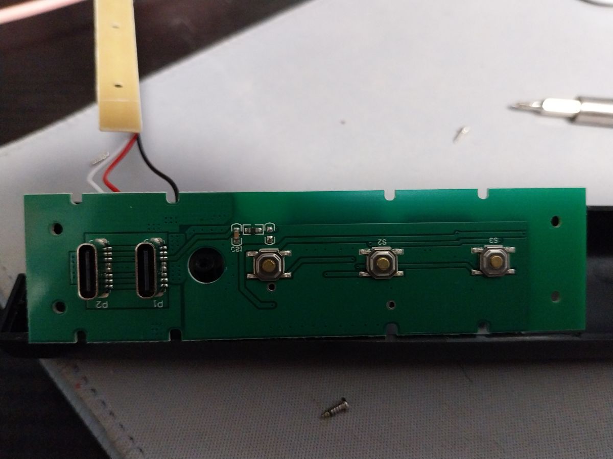

    also took a few photos of the LED strip and IC chip. There are 30 LEDs and depending on what mode you use it will split them up into lots of 3 or if using the custom themes you can set each LED to a different colour
    Circuit board with two USB-C ports and three buttons. Addressable LED strip displaying green-lit diodes. Close-up of an LED on an LED strip with visible soldered wires. Close-up of a single LED on a circuit board. Close-up of an LED strip marked CYTT-279/V1.0 with a date 2022-12-12 and Chinese characters. Close-up of a circuit board with integrated circuits and connectors, marked with VWDG. Close-up of a circuit board showing the CYTT-279 and AMS1117 chip markings on a green PCB.
    I also captured a video of the strip so you can see the addressable LEDs in action

  • Tuya config shows control pin on P26
    #5 20814177
    wolfieeewolf
    Posts: 93
    Help: 7
    Rate: 20
    I have flashed the device with OBK.
    So far no luck in getting this to output anything.
    I used the GPIO finder and I'm getting something on pins 22, 24, and 7.
    Pin 22 is the power on/off button.
    Pin 24 is the color change button.
    Pin 7 is the mode change button.
    I have tried setting Pin 16 to SM16703P_DIN as suggested, but nothing is happening.
    I'm slowly working my way through the list of LED drivers in hope that one of them does something.
    I'm thinking I might have to go back to the stock firmware and see if I can debug it to see if that reveals anything worthwhile.
    I read the Tuya GPIO config from 0x1EE000 and import the BIN file into BKflasher - I get this
    - Control Pin (TODO) on P26
    Device seems to be using CBU module, which is using BK7231N.
    And the Tuya section starts at UNCOMMON POSITION 0

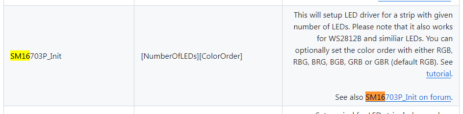

    SM16703P_DIN
    To test SM16703, you do:
    //Start driver, CHANGE [[pixelcount]] to number of leds
    startDriver SM16703P
    //Init Driver
    SM16703P_Init [[pixelcount]]
    //Set Pixel
    SM16703P_SetPixel 1 255 0 0
    SM16703P_SetPixel 2 0 255 0
    SM16703P_SetPixel 3 0 0 255
    //Start Output (each call will trigger one
    SM16703P_Start
    I will remove that DIN role because it seems to confuse people

    I tried the code and the led's light up white but the first few leds are green and red and the end led's are green. There are 30 led per strip and both strips are lit up. In the mobile app you can set the colours different on each strip so not sure if I should be using 60 for the pixel count or not. It didn't make a diffenece setting it to 60.
    From my experince working with leds for my christmas light display the mixed up of colours usually means the wrong pixel type. I guess I could try and put wled on the chip and see if i can work out what pixels it has unless you have another suggestion.

    To be clear, do you know what specific kind of LEDs is used in this device?

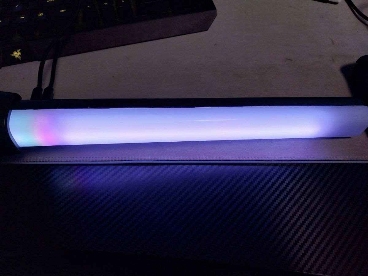

    I have connected the strip to my ESP32 with WLED running and managed to work out the strip is a 5v WS281X with a color order of GRB. All effects work perfectly with WLED.
    Considering that Arlec are known for making cheap devices with cheap parts. I'm guessing the strip is probably a WS2812 or WS2812B. They seem to be the standard.
  • #10 20815639
    Posts: 14755
    Rate: 12878
    Very well, please wait if you can, I can't say at the moment when, but I will try to adjust timings for that WS format and we will retry.
    So the current code lights LEDs at random? In the incorrect way?
  • #11 20815643
    wolfieeewolf
    Posts: 93
    Help: 7
    Rate: 20
    Correct.

  • WLED causes flicker and wrong GRB order
    #18 21037566
    wolfieeewolf
    Posts: 93
    Help: 7
    Rate: 20
    Got around to doing some testing with WLED and OpenRGB.
    I have WLED on a Duinotech ESP32 board. I have set up WLED to receive DDP from my device.
    As soon as it connects to WLED the lights start to flicker. It will output all the effects fine but with flickering. As soon as you disconnect WLED it works fine. I'm guessing new driver and still has a few little bugs to iron out so hopefully will get better over time. Right now the flickering is very noticeable and makes the device unusable with WLED.
    Another issue is that my lights are GRB ordered but WLED will not set them correctly. I have changed it on the WLED interface as well as the autoexec.bat and several combinations of both but the colours are still wrong so not sure what is happening there. They are correct when WLED is not connected.
    I was able to link WLED to OpenRGB using E1.31 and all the effects from OpenRGB work. There is a slight issue when changing solid colours that it will revert to whatever WLED's last set colour was but this could be an issue with WLED and OpenRGB, not OBK. Will have to do some more testing on this to see where the issue lies.
    Would be interested in seeing if adding UDP could fix these issues. This would also open up OBK to a few other programs like Hyperion and Prismatik
    Would be great to see as in Australia we have a pretty good brand called Genio and the crappier Arlec branded LED's that I could sync up with OpenRGB/Hyperion for a cheap whole room Ambilight alternative.
    I'll try and get a video of the flickering and upload that when I can
  • DDP testing shows flicker and GRB color order issues
    #19 21038424
    wolfieeewolf
    Posts: 93
    Help: 7
    Rate: 20
    I've had a chance to do some testing with DDP and some of the software I want to use with these lights.
    First video is the LED's through WLED with DDP. You can see the green flickering. The lights are also meant to be green not red.
    An interesting point is that when you change the LED colour the flickering colour also changes.
    Second video is the LED's running directly through Hyperion.NG. I found that I can link it with UDP DDP.
    The video is a bit washed out but I have it running a colour cycle animation. It does work ok but you can see some slight flickering every few seconds. It also has the colours mixed up. Should be GRB. There could be a way to fix this in Hyperion but it must be in some advanced menu that I haven't found yet.
    The last video is of a pair of downlights running with OpenRGB using WLED with DDP. You can see that the colours change very smoothly and there is a slight lag in the video. It's not that bad just my phone camera sucks.
    The LED light bars kept locking up and I had to reboot them but in the end I couldn't get them to work. Seems they don't play well with OpenRGB. I did get them working the other night so maybe it's just a setting that is wrong somewhere.
    I would like to try to run a few lights directly through Hyperion to see if I can get the lights to copy the screen colours better. Could then have ceiling lights, wall lights, strip lights, and LED Bar all grabbing a different part of the screen. If I get this setup I'll try to get a decent video of it.
  • DDP already uses UDP; GRB byte order option exists
    #20 21038695
    Posts: 14755
    Rate: 12878
    Thank you for testing!
    Regarding flickering, are you saying this happens in OBK? Are you using latest version?
    How to reproduce the problem? Maybe you're just sending too much data? Can you reduce the interval of DDP packets?
    There is option to change byte order:
    Screenshot of a table with LED driver setup instructions, highlighting the text SM16703P_Init.
    What do you mean by "adding UDP"? DDP protocol for LEDs is already using UDP, so there is no way to "add" it.
