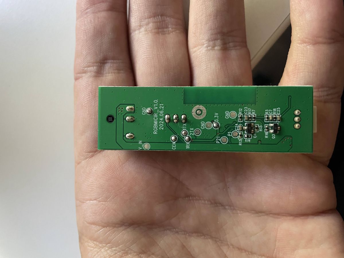

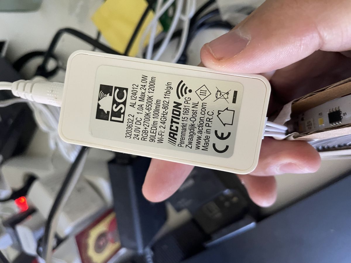

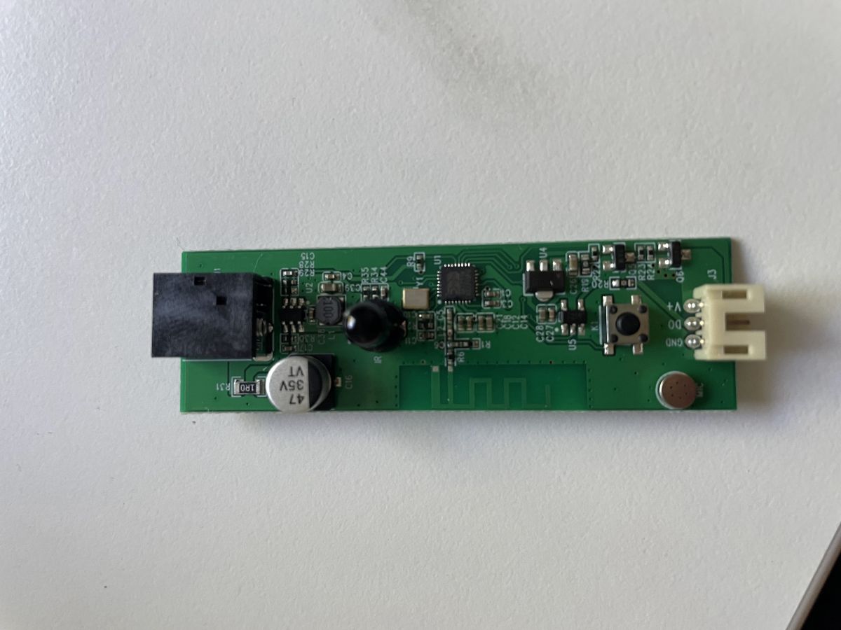

    Hi,
    Seems like LSC (Action) released a new version of the 5m LED strip, model number 3203632.2. It is still based on bk7231n, and flashing is quite easy.
    Pins that are already described here:
    https://community.home-assistant.io/t/using-l...1-rgbic-cctic-ledstrip-with-esphome/812822/35
    But it has only 3 connectors; however, I can't use CW, W leds here, my config:
    and Autoexec.bat:
    PowerSave 0 // otherwise IR won't work
    startDriver SSDP
    startDriver Wemo // for Alexa
    startDriver SM16703P
    SM16703P_Init 120 RBG
    startdriver pixelanim
    startDriver NTP
    // Configure a local NTP server on your LAN so that devices do not need to connect to the internet
    ntp_setServer 192.168.77.145
    addEventHandler2 IR_NEC 0x0 0x6 led_enableAll 1
    addEventHandler2 IR_NEC 0x0 0x1 led_enableAll 0
    addEventHandler2 IR_NEC 0x0 0x10 add_dimmer 10
    addEventHandler2 IR_NEC 0x0 0x3 add_dimmer -10
    Wi-Fi LED controller LSC held in hand, technical specifications visible on label. Green circuit board with electronic components held in a hand. PCB module with electronic components, connectors, and a push button
    Wi-Fi LED controller LSC held in hand, technical specifications visible on label. >
    Does somebody else have the same LED stip and could share with me autoexec.bat?
    AI: Could you specify the exact board version or any markings on the PCB? This might help others with the same hardware share a compatible autoexec.bat.
    RGBMICIR_V1.0.
    2024.06.21

    I've got the same device recently from Action.
    Button is pin 20:
    The 5 m strip is divided into 25 segments, each segment containing two SM16703P controllers.
    First controller per segment is driving the RGB LED; second controller drives one CW and one WW LED.
    Therefore, the Init command should be:
    SM16703P_Init 50 RBG
    By activating only the even controller of the strip, you can control the white LEDs.
    SM16703P_SetPixel 2 0 255 0
    SM16703P_SetPixel 4 0 255 0
