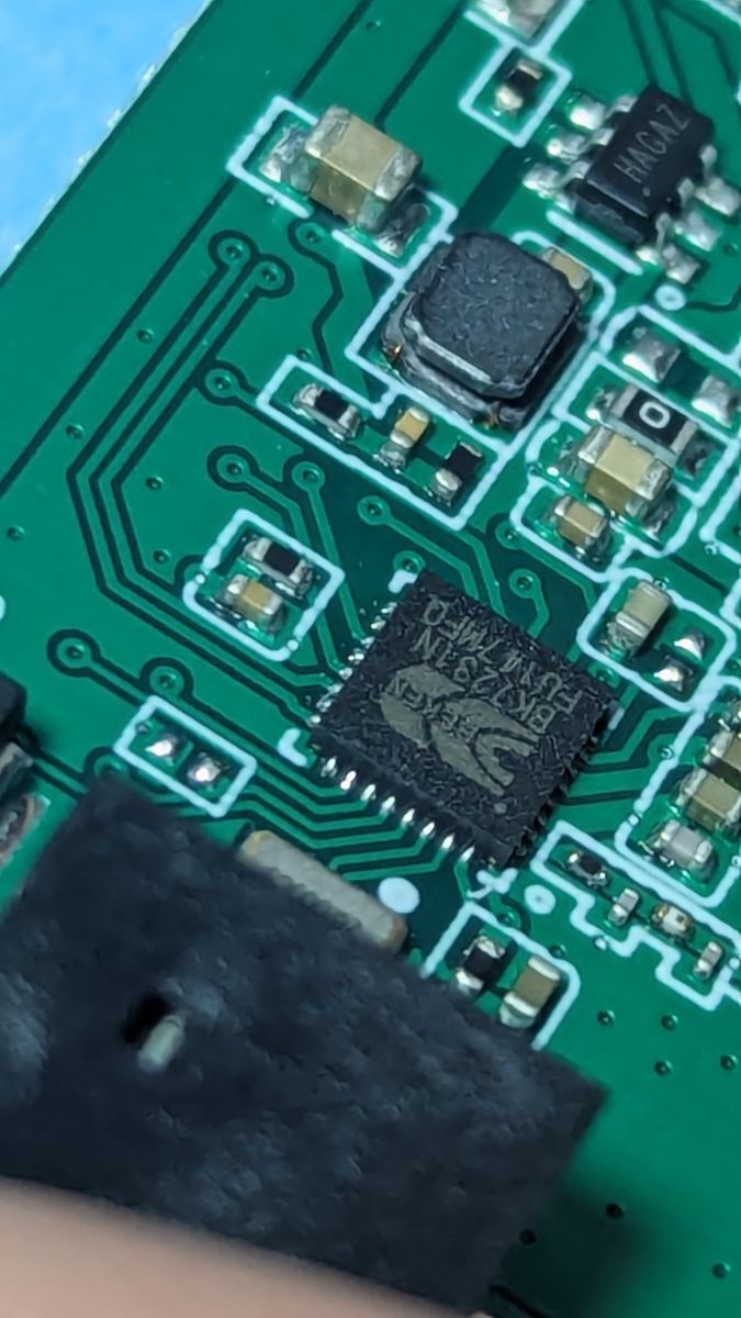

    Hi, there was a new LED strip at action.com store. It is an RGBIC 5m line. I think there is still no driver for this, but you are working on it. Hope you can help to get it running. Would like to test something. I can also dump it when it is needed.

    Hello, please attach 2MB dump. I can flash it later to my CB3S and investigate.

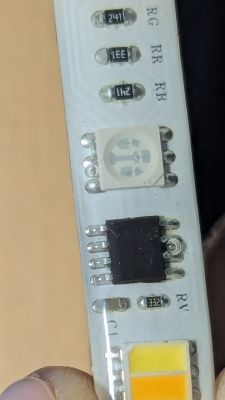

    What kind of LED strip driver is that? We're working on SM16703 currently. Is it that one or something else new?

    Well, is the SOIC chip on the LED strip marked or not?
  • #5 20855628
    alfakenzo
    Posts: 32
    I see nothing on it.

    Well, maybe it's SM16703, let's start with a 2MB flash dump

    Are your LEDs SM16703P?

  • #14 20906416
    alfakenzo
    Posts: 32
    Your LEDs are 6 per string. So 6 LEDs will change only in one color. The next six in other colors. Your whole stripe is 5, so you have 120 LEDs like me too.

    maczarq
    The Beken chip in my LED strip is a BK7231N, and the LED strip controller is an SM16703SP3. I'm including this information here in case it's helpful.
    I've tried countless configurations, and none have worked. I can't get them to turn on.
