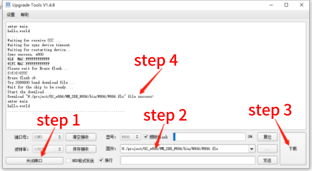

    1. Development Environment Setup
    Program Development Platform: CDK
    Program Download Software: Upgrade_Tools_V1.4.8.exe
    Drivers: CH340 USB-to-Serial Driver
    For related development platform setup and installation, refer to online tutorials. In hardware development scenarios, the development environment often needs to adapt to different peripheral interaction requirements. For instance, some complex projects may simultaneously involve memory chips (such as the w25q32 in this article), display interfaces (e.g., DVI vs HDMI), and timing control modules (e.g., monostable multivibrator). The choice between DVI and HDMI depends on display requirements: For projects requiring only digital video signal transmission (e.g., monochrome display panels in industrial equipment), the DVI interface meets basic needs. For synchronous audio-video transmission (e.g., smart devices with interactive interfaces), the HDMI interface (especially versions 2.0 and above supporting 4K@60Hz) is more suitable. The monostable multivibrator can be utilized for timing calibration. For instance, in SPI communication between the W25Q32 and the host controller, if signal jitter causes data transmission errors, the multivibrator can generate fixed-width trigger pulses to stabilize the SPI clock (CLK) or chip select (CS) signal. This ensures accurate execution of read/write commands — — This module becomes particularly crucial during subsequent complex hardware expansions (e.g., adding display interfaces or sensors), necessitating the pre-reservation of timing debug interfaces within the development environment.

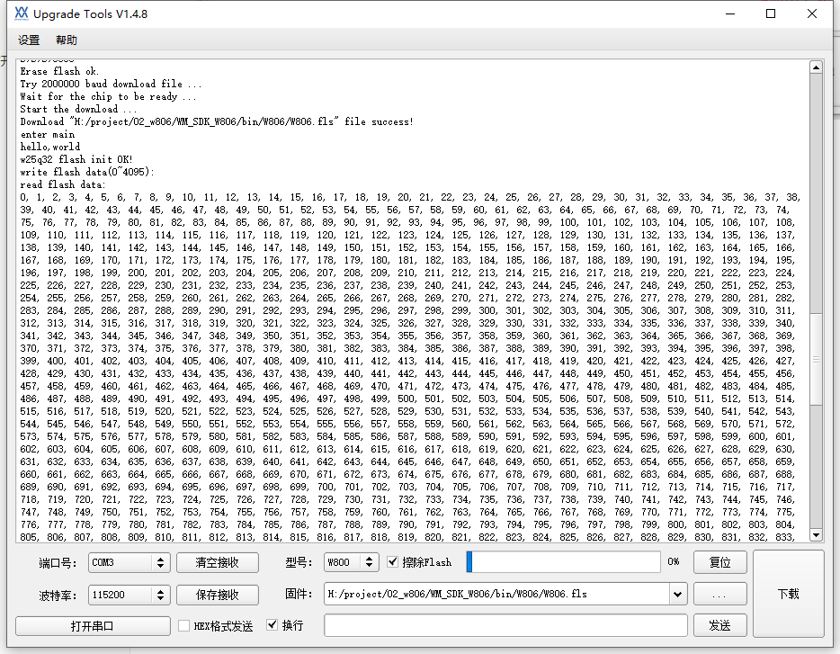

    2. Experiment Objective
    Write values from 0 to 4095 to the first sector of the W25Q32, then read and print the data.

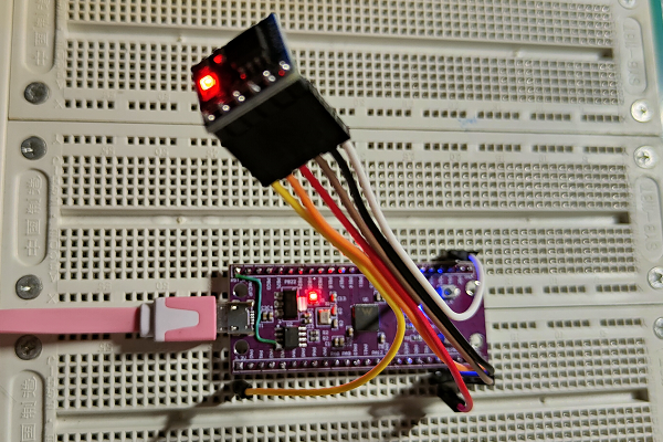

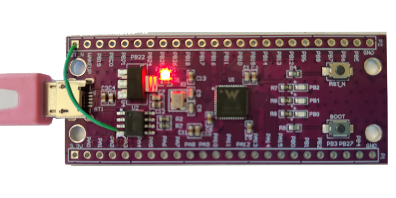

    3. Hardware Platform
    Lianshengde W806-KIT
    As shown in the diagram, the jumper wires enable one-click serial port download, eliminating the need for manual reset.
    Purple development board with microcontroller, USB connection, and lit red LED.

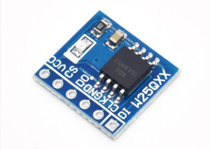

    w25q32 module
    W25QXX flash memory module on blue PCB with 8 pins and surface-mount chip
    Refer to the board schematic for LED pin assignments:
    VCC —> 3.3V
    GND → GND
    CS → PB4
    CLK → PB2
    DI → PB5
    DO → PB3
    Electronic module on breadboard with connected wires and lit red LEDs
    4. Software Development
    This experiment adds four files to the official SDK: spi.c, spi.h, w25qxx.c, and w25qxx.h
    spi.c implements initialization of the SPI peripheral chip

    ​ Launch Upgrade_Tools_V1.4.8.exe to begin downloading the program
    Upgrade Tools v1.4.8 interface with update steps labeled in red
    6. Experimental Results
    Data write and read operations succeeded!
    Upgrade Tools V1.4.8 software window showing flash upload log and memory data
