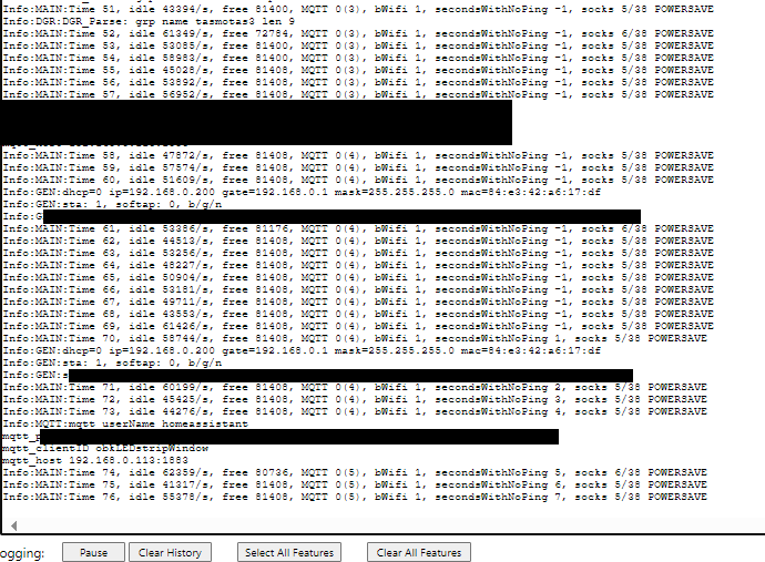

    As a test device, I'm just using my phone as the ping target, and I'm finding that the ping watchdog is taking ages to start - many minutes. The log shows lines like this:
    Info:MAIN:Time 29, idle 192959/s, free 73760, MQTT 0(2), bWifi 1, secondsWithNoPing -1, socks 2/38
    Info:MAIN:Time 31, idle 189275/s, free 73760, MQTT 0(2), bWifi 1, secondsWithNoPing -1, socks 2/38
    Info:MAIN:Time 32, idle 186685/s, free 73760, MQTT 0(2), bWifi 1, secondsWithNoPing -1, socks 2/38

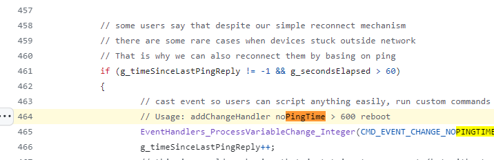

    From digging through the code, I can see that it doesn't try to start until 30 seconds after a successful WiFi connection and reports secondsWithNoPing of -1 until it does. What I'm seeing is the -1 for many minutes after WiFi connects.
    Is this the same value reported in scripts by noPingTime? Because I'm not succeeding in testing for the value being < 0.

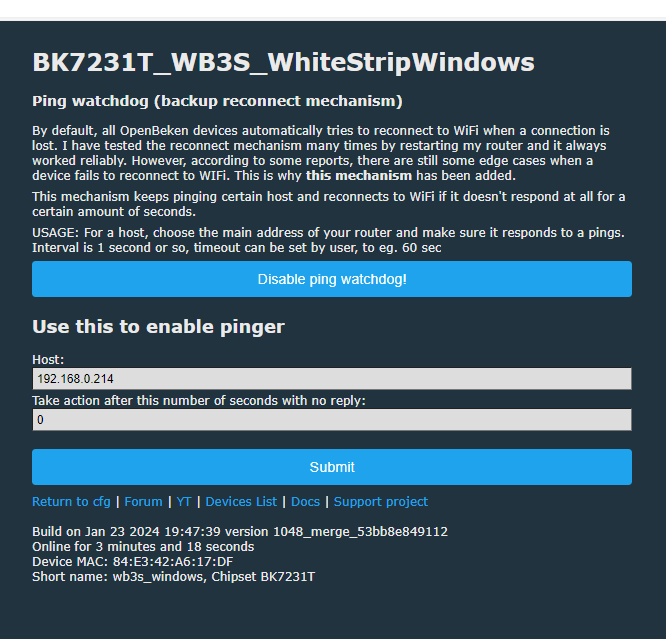

    I've configured non existent IP:
    Configuration screen for the ping watchdog mechanism for the BK7231T device.
    And restarted the device, after an initial delay designed to give things time to settle I get:
    Screenshot showing a log with informational messages regarding network configuration.

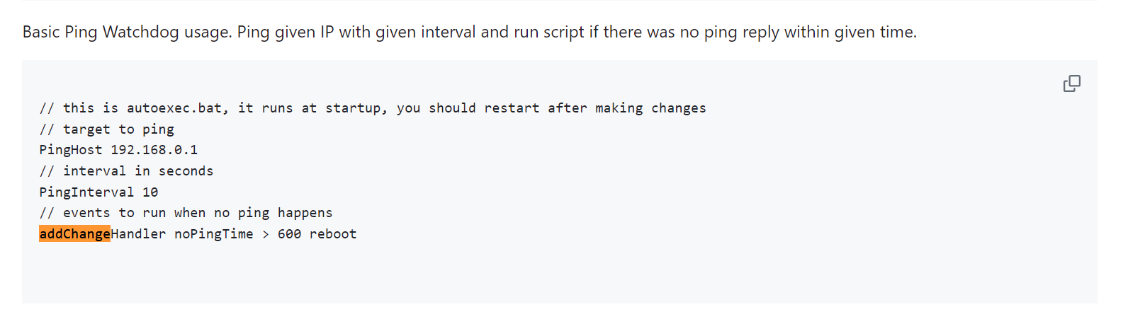

    Now you can use:
    // events to run when no ping happens
    addChangeHandler noPingTime > 600 reboot
    to run an event
    PS: Here is a delayed start condition:
    Screenshot of code snippet showing a ping condition for rebooting a device after a time.
    Did you restart your device after configuration change?

    The example for the AddChangeHandler for noPingTime includes a comparison - specifically ">".
    Basic Ping Watchdog usage with sample autoexec.bat script
    In testing it seems that it doesn't actually use this. I have tried clearing handlers and making a second call of "AddChangeHandler noPingTime < 10 SetChannel 10 2" but it doesn't seem to work. However, it MAY have been because, when I added the handler, noPingTime was already less than 10. Thus there was no change to trigger it.
    But, the ability to use WaitFor noPingTime < 10 would make some of what I'm trying to achieve a LOT easier.
    I think that change handlers by design are called only when the threshold is passed, just as you guessed. As in the title, the "change" has to occur.

    And this is the log.:
    ---------------8<-----------------------
    Info:GEN:26 key_triple_press
    Info:EVENT:EventHandlers_FireEvent: executing command reboot
    Info:CMD:CMD_Restart: will reboot in 3
    Info:MAIN:Time 58, idle 190635/s, free 73576, MQTT 0(3), bWifi 1, secondsWithNoPing -1, socks 2/38
    Info:MAIN:Module reboot in 2...
    Info:MAIN:Time 12, idle 187627/s, free 73696, MQTT 0(0), bWifi 1, secondsWithNoPing -1, socks 2/38
    Info:MQTT:mqtt_host empty, not starting mqtt
    Info:MAIN:Time 13, idle 187834/s, free 73696, MQTT 0(1), bWifi 1, secondsWithNoPing -1, socks 2/38
    Info:MAIN:Time 14, idle 189463/s, free 73696, MQTT 0(1), bWifi 1, secondsWithNoPing -1, socks 2/38
    Info:MAIN:Time 20, idle 191001/s, free 73696, MQTT 0(1), bWifi 1, secondsWithNoPing -1, socks 2/38
    Info:GEN:dhcp=0 ip=XXXXXXX.112 gate=XXXXXXX.1 mask=255.255.255.0 mac=XXXXXXX
    Info:GEN:sta: 1, softap: 0, b/g/n
    Info:GEN:sta:rssi=-30,ssid=XXXXXXX,bssid=XXXXXXX,channel=11,cipher_type:CCMP
    Info:MAIN:Time 21, idle 185775/s, free 73696, MQTT 0(1), bWifi 1, secondsWithNoPing -1, socks 2/38
    Info:GEN:CHANNEL_Set channel 8 has changed to 1 (flags 0)
    Info:MQTT:Channel has changed! Publishing 1 to channel 8
    Info:MAIN:Time 24, idle 191402/s, free 73696, MQTT 0(1), bWifi 1, secondsWithNoPing -1, socks 2/38
    Info:MAIN:Time 25, idle 189987/s, free 73696, MQTT 0(1), bWifi 1, secondsWithNoPing -1, socks 2/38
    Info:MAIN:Time 28, idle 188912/s, free 65088, MQTT 0(1), bWifi 1, secondsWithNoPing -1, socks 3/38
    Info:MAIN:Time 29, idle 188650/s, free 73704, MQTT 0(2), bWifi 1, secondsWithNoPing -1, socks 2/38
    Info:MAIN:Time 33, idle 198353/s, free 73696, MQTT 0(2), bWifi 1, secondsWithNoPing -1, socks 2/38
    Info:MAIN:Time 37, idle 189849/s, free 73696, MQTT 0(2), bWifi 1, secondsWithNoPing -1, socks 2/38
    Info:MAIN:Time 38, idle 189120/s, free 73704, MQTT 0(2), bWifi 1, secondsWithNoPing -1, socks 2/38
    Info:MAIN:Time 41, idle 186364/s, free 73696, MQTT 0(2), bWifi 1, secondsWithNoPing -1, socks 2/38
    Info:MAIN:Time 42, idle 187401/s, free 73704, MQTT 0(2), bWifi 1, secondsWithNoPing -1, socks 2/38
    Info:MAIN:Time 45, idle 187042/s, free 73696, MQTT 0(3), bWifi 1, secondsWithNoPing -1, socks 2/38
    Info:MAIN:Time 46, idle 193917/s, free 73704, MQTT 0(3), bWifi 1, secondsWithNoPing -1, socks 2/38
    Info:MAIN:Time 49, idle 190406/s, free 73696, MQTT 0(3), bWifi 1, secondsWithNoPing -1, socks 2/38
    Info:MAIN:Time 50, idle 192118/s, free 73704, MQTT 0(3), bWifi 1, secondsWithNoPing -1, socks 2/38
    Info:GEN:sta:rssi=-27,ssid=XXXXXXX,bssid=XXXXXXX,channel=11,cipher_type:CCMP
    Info:MAIN:Time 53, idle 186731/s, free 73696, MQTT 0(3), bWifi 1, secondsWithNoPing -1, socks 2/38
    Info:MAIN:Time 54, idle 191768/s, free 73704, MQTT 0(3), bWifi 1, secondsWithNoPing -1, socks 2/38
    Info:MAIN:Time 57, idle 187466/s, free 73704, MQTT 0(3), bWifi 1, secondsWithNoPing -1, socks 2/38
    Info:MAIN:Time 58, idle 195886/s, free 73704, MQTT 0(3), bWifi 1, secondsWithNoPing -1, socks 2/38
    Info:MAIN:Time 61, idle 186968/s, free 73696, MQTT 0(4), bWifi 1, secondsWithNoPing -1, socks 2/38
    Info:MAIN:Time 62, idle 202145/s, free 73704, MQTT 0(4), bWifi 1, secondsWithNoPing -1, socks 2/38
    Info:MAIN:Time 65, idle 191772/s, free 73696, MQTT 0(4), bWifi 1, secondsWithNoPing -1, socks 2/38
    Info:MAIN:Time 66, idle 189007/s, free 73704, MQTT 0(4), bWifi 1, secondsWithNoPing -1, socks 2/38
    Info:MAIN:Time 68, idle 195730/s, free 73696, MQTT 0(4), bWifi 1, secondsWithNoPing -1, socks 2/38
    Info:MAIN:Time 70, idle 189679/s, free 73696, MQTT 0(4), bWifi 1, secondsWithNoPing -1, socks 2/38
    Info:GEN:sta:rssi=-25,ssid=XXXXXXX,bssid=XXXXXXX,channel=11,cipher_type:CCMP
    Info:MAIN:Time 73, idle 184654/s, free 73696, MQTT 0(4), bWifi 1, secondsWithNoPing 3, socks 2/38
    Info:MAIN:Time 74, idle 193679/s, free 73704, MQTT 0(4), bWifi 1, secondsWithNoPing 4, socks 2/38
    Info:MAIN:Time 77, idle 190934/s, free 73704, MQTT 0(5), bWifi 1, secondsWithNoPing 2, socks 2/38
    Info:MAIN:Time 78, idle 188365/s, free 73696, MQTT 0(5), bWifi 1, secondsWithNoPing 3, socks 2/38
    Info:MAIN:Time 81, idle 181530/s, free 73704, MQTT 0(5), bWifi 1, secondsWithNoPing 1, socks 2/38
    Info:MAIN:Time 82, idle 189007/s, free 73704, MQTT 0(5), bWifi 1, secondsWithNoPing 2, socks 2/38
    Info:MAIN:Time 85, idle 185055/s, free 73696, MQTT 0(5), bWifi 1, secondsWithNoPing 5, socks 2/38
