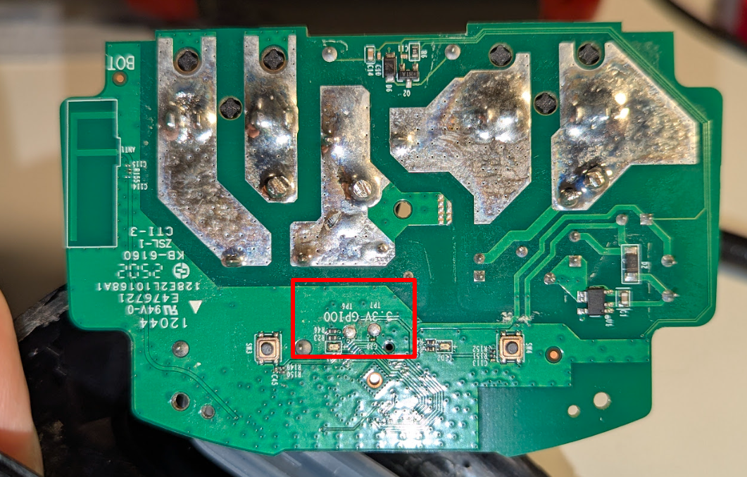

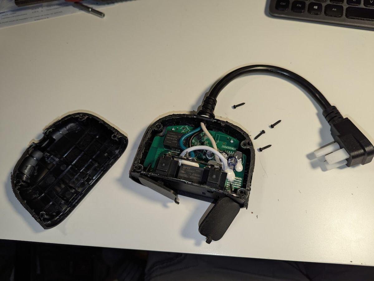

    Here's another guide for a Kasa device!
    You will need to crack the device open with some cutting tools and say goodbye to its IP64 rating... Be Careful; I knocked off a small cap and I had to replace it. 2.2 µF 400 V is not exactly common.
    The process is the same as in Kasa's other devices, for example: https://www.elektroda.com/rtvforum/topic4098414.html

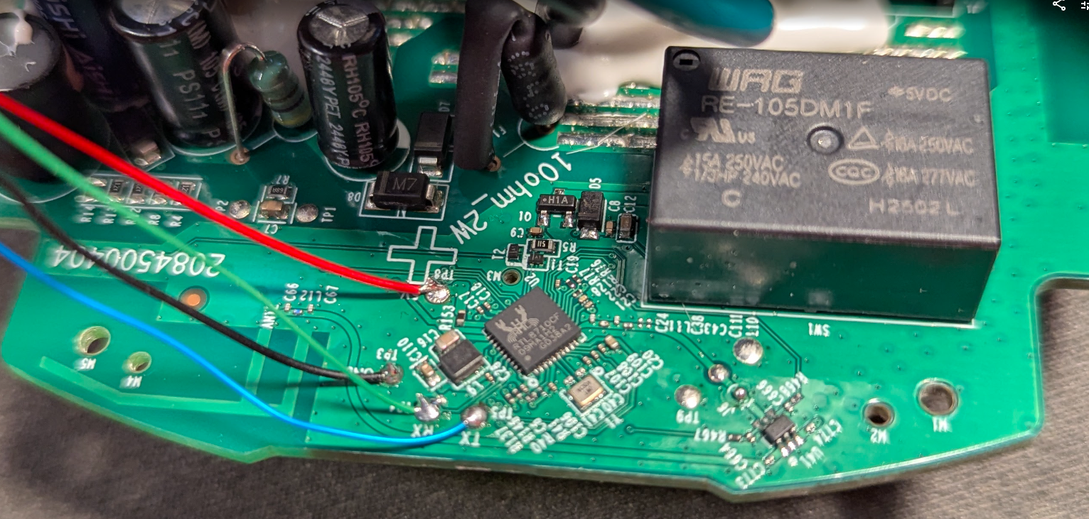

    The pads are clearly labeled on the PCB.
    The screws need a small torx bit. Not sure of the size. I think it is T8.

    I suspect there's a power meter in there but there's no mention of it in the device documentation (although there's not much in there anyway)...
    I'm not sure how to verify that. I'll have a look at the other chips on the board.
  • #5 21688968
    Jerther
    Posts: 30
    Rate: 9
    BP2525: step-down constant voltage driver chip. It's located just under the power supply section so I guess it makes sense.
    SP5: this should actually be a SSM6J505NU, which is a Silicon P-Channel MOS (MOSFET). I believe it drives the WiFi antenna.
    Welp, no power meter related stuff that I can tell. Bummer ;)

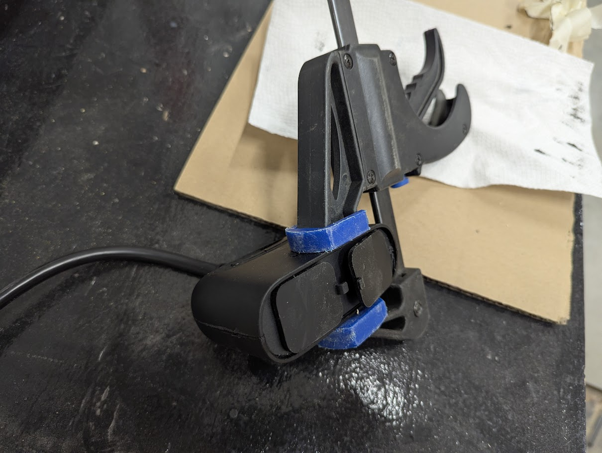

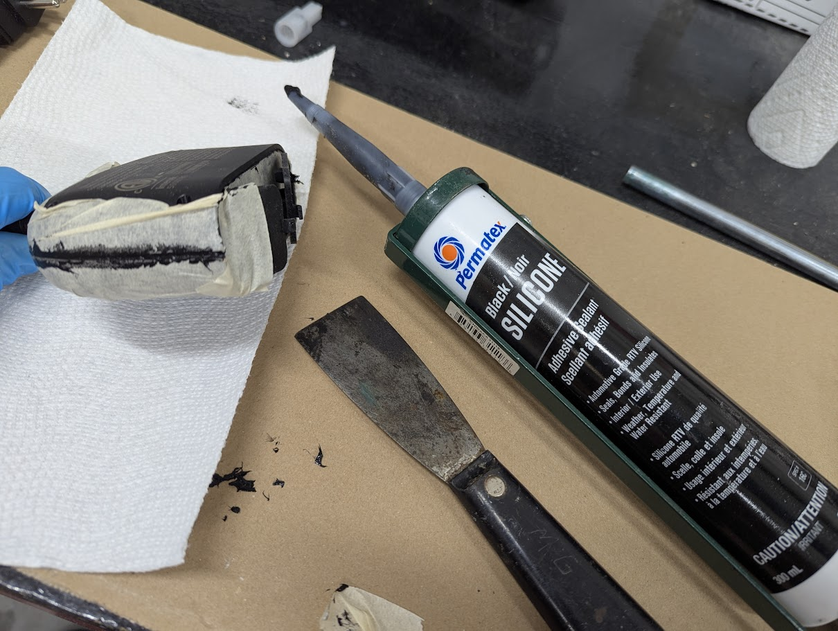

    Some pictures of how I did the reassembly. In an attempt to recover SOME of the waterproof quality, I sealed the case back with some Permatex Black Silicone adhesive sealant I had left from another project.
    I used masking tape because that silicone stuff is really messy. I removed the tape while the sealant was still wet, and I used a clamp to make sure the front was tight.
