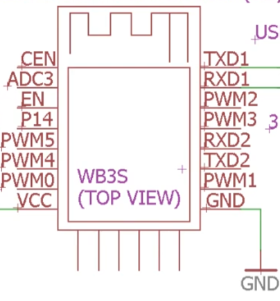

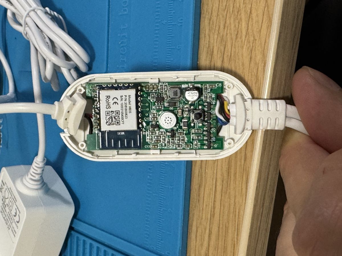

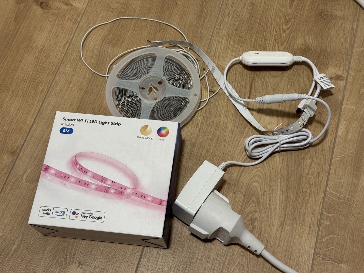

    Dear community,
    I just converted this LED strip to openBKN without issues.
    It could be done with the chip in place, soldering 4 wires to VCC, GND, Tx, Rx (no need for CEN)
    I used BK7231GUIFlashTool-v5
    After some trial-and-error I got the pins sorted pretty fast:
    "pins": {
    "6": "PWM;4",
    "8": "PWM;5",
    "9": "PWM;1",
    "14": "Btn;0",
    "24": "PWM;2",
    "26": "PWM;3"
