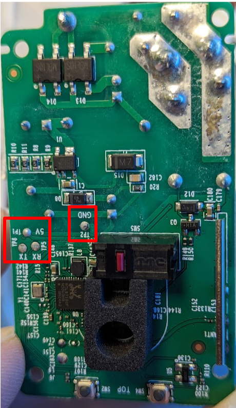

    Kasa Smart Single Pole Light Switch by TP-Link (HS200)
    The case is a bit difficult to crack open, but it's possible by using only a flat head screwdriver and by prying the sides. Here's the PCB on both sides:
    PCB of TP-Link Kasa HS200 light switch with marked pads.

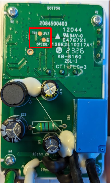

    View of the backside of the TP-Link Kasa HS200 smart light switch PCB with marked GPIO0 and 3V3 pads.
    I connected the 5V pad on the PCB to the 5V rail of the USB Serial Converter. The rest of the pads are clearly labeled in the pictures. It's like it was meant to be reflashed ;)
    Short the GPIO0 pad to the 3V3 pad next to it to enable bootloader mode. Use the "Restart" tact switch to restart the MCU. The "Reset" tact switch is just another input.
    The rest is easy! Follow this guide to flash the firmware: https://www.elektroda.com/rtvforum/topic4097185.html

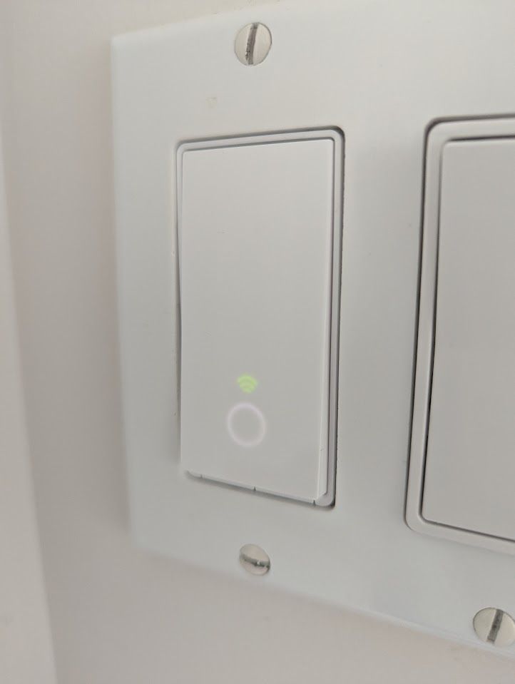

  • #9 21425991
    Jerther
    Posts: 30
    Rate: 9
    Here's what the switch looks like when it's on with my current template. The white circle is on when the switch is on, and it is off when the switch is off. The green wifi LED is always lit.
    Wall switch turned on with green wifi LED and glowing white circle.
