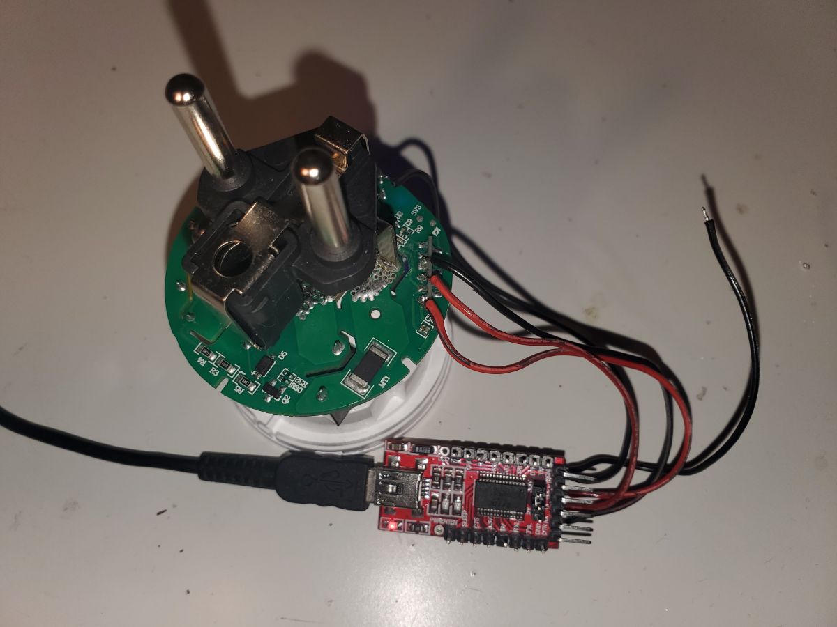

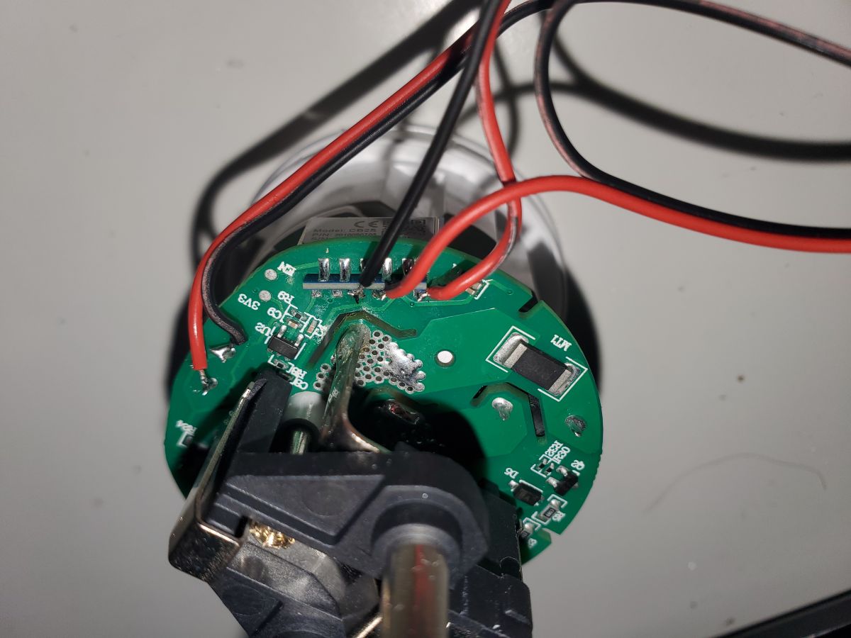

    Flashing works fine. I soldered RX TX GND 3.3V to a serial usb adapter. I reset the device by touching the EN pad with a wire connected to ground.
    This is what the flasher tool tells me:
    these things all work so far.

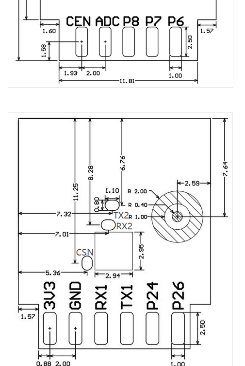

    Device seems to be using CB2S module, which is using BK7231N.

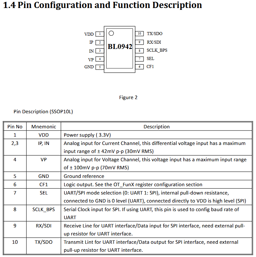

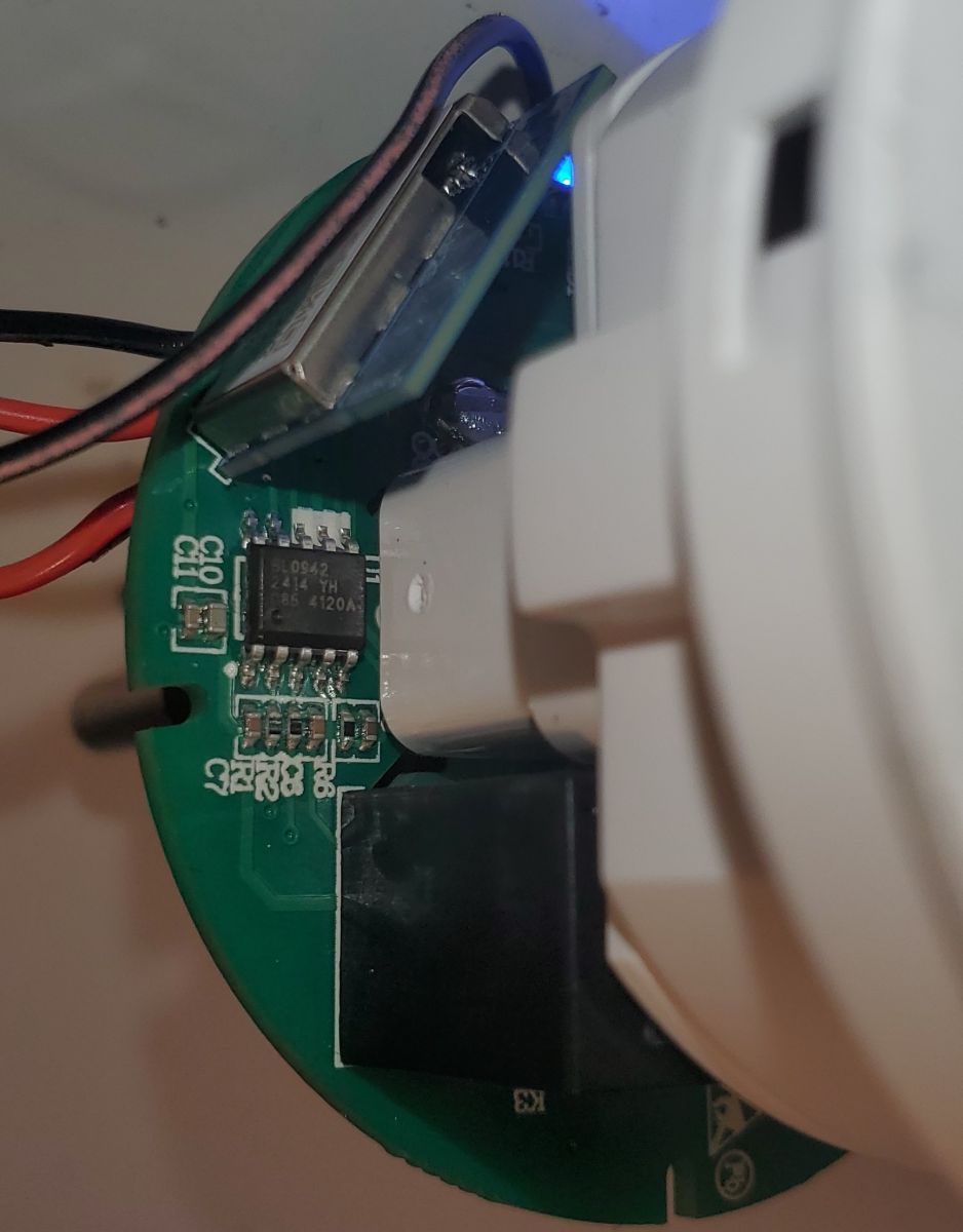

    How do I get the power measurement BL0942 ic work? I don't know how to find the correct pins for the ic.
    It seems to be different than other antela plugs. The reset pad is named EN instead of RES.
    CB2S:
    Pin configuration of the BL0942 chip.
    https://developer.tuya.com/en/docs/iot/cb2s-module-datasheet?id=Kafgfsa2aaypq
    BL0942:
    Connection diagrams of the CB2S module with pin labels and dimensions.
    https://www.belling.com.cn/media/file_object/...oduct_en/BL0942/datasheet/BL0942_V1.04_en.pdf

    >>21409630 Thank you. Works fine now.
