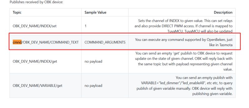

    TannedKimmy
    is there a straightforward documentation on how to write commands through mqtt topics?
    like what's the prefix to change PWM frequency per se, and most importantly how to control different ports on my MCU simultaneously.
    I configure a port as PWM to control it I use the dimmer prefix and if I add other ports as PWM now it turns as LED Temp and RGB. I'm failing to find a documentation or a topic covering the whole thing.

    I think you can just do it like in Tasmota.
    https://github.com/openshwprojects/OpenBK7231T_App/blob/main/docs/mqttTopics.md
    MQTT Command Structure for Controlling Multiple PWM Ports and Frequency on MCU
    If you want to disable auto LED driver, enable "show raw pwms" flag. What are you trying to achieve?
