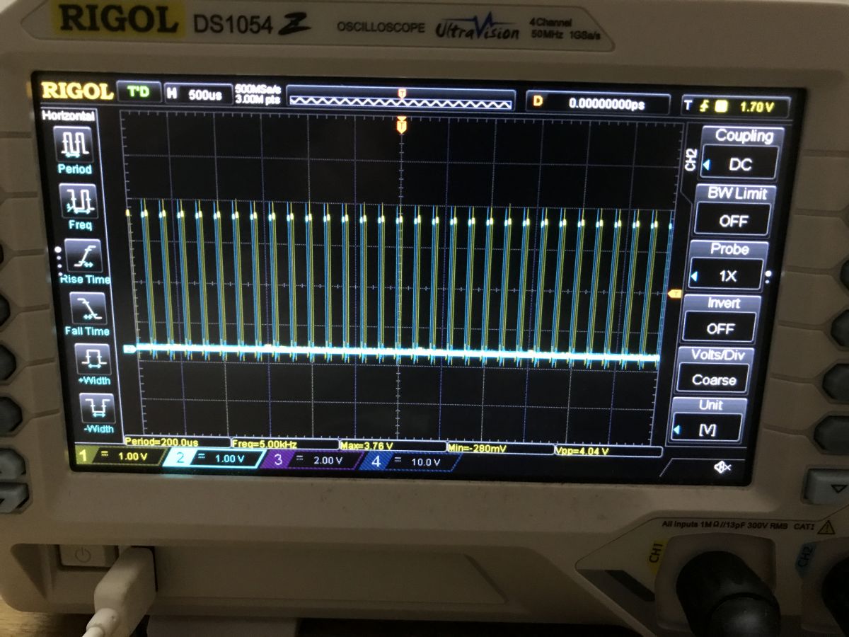

    I've performed some tests with the original version of the code, also by manually setting values for each PWM:
    Code: C / C++
    Result:
    Oscilloscope displaying PWM signal waveforms.
    Test code:
    Code: C / C++
    results:

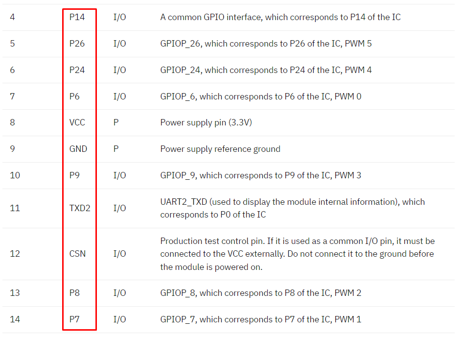

    PWMG_Set Duty1Percent Duty2Percent DeadTimePercent Frequency PinA PinB
    Please note that the following will only work correctly for PWM pairs, like PWM0+PWM1, PWM2+PWM3, etc.
    Futhermore, for PinA/PinB you need to give a P-index, so PWM0 is not 0, it's 6.
    Please see screenshot below for explanation:
    Table showing GPIO interfaces and their corresponding IC pins.
    Of course, when typing command, type just "6", not "P6", like:
    PWMG_Set 10 10 10 1000 6 7

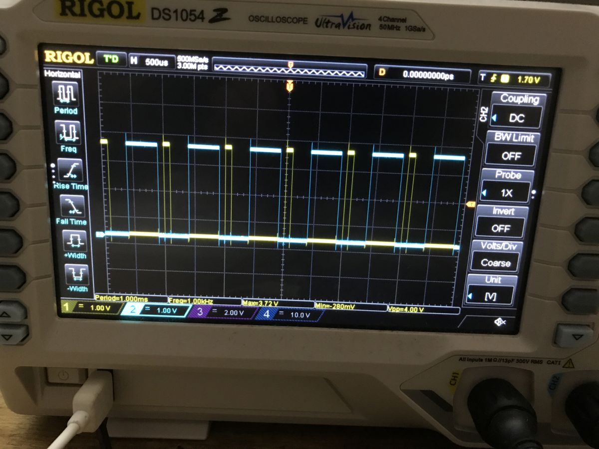

    Examples
    Command (1000Hz, 10% first, second 10%, dead 10%):
    Result:
    Oscilloscope display showing a PWM signal waveform.

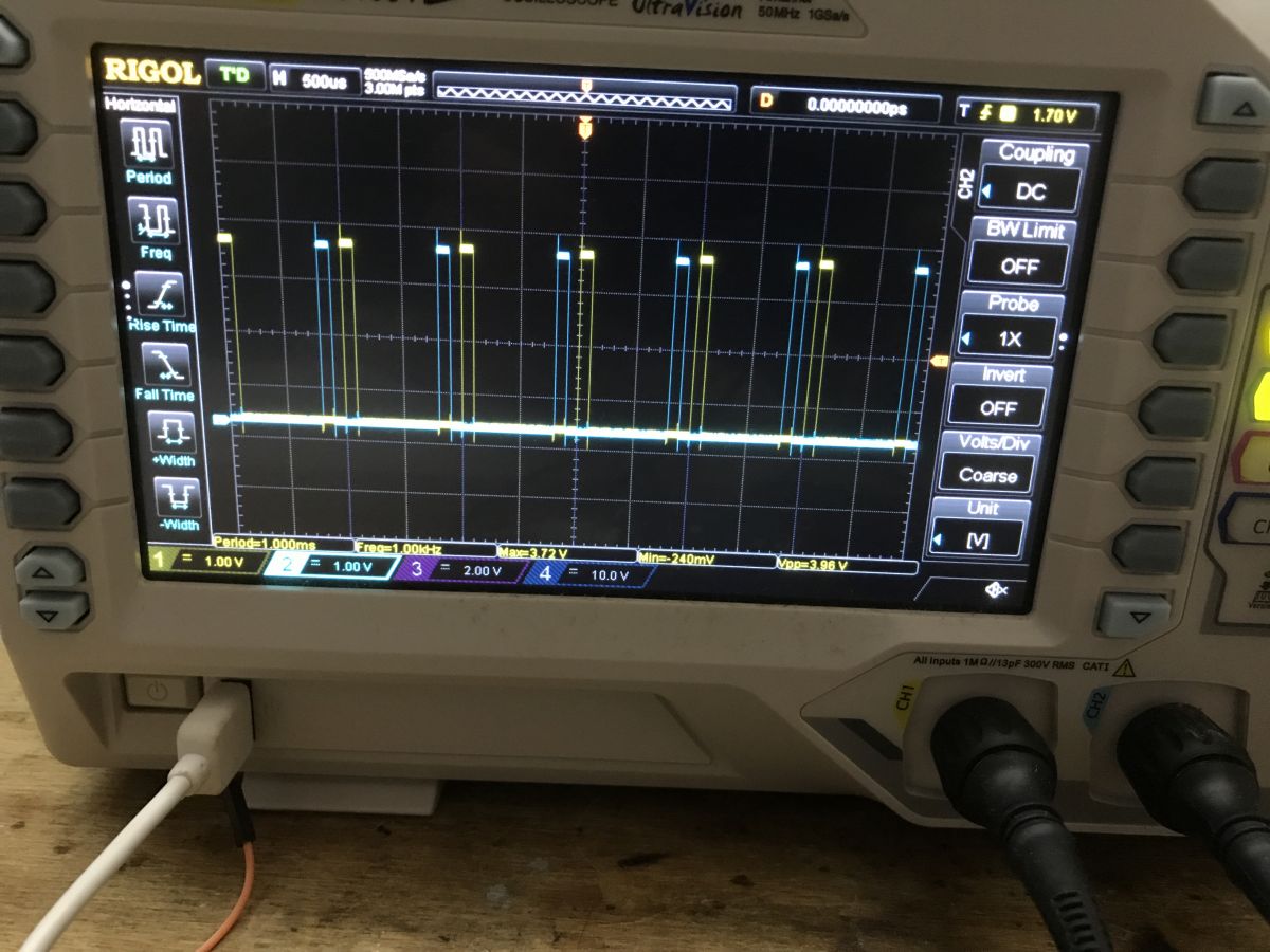

    Command (5000Hz, 10% first, second 10%, dead 10%):
    PWMG_Set 10 10 10 5000
    Result:
    Oscilloscope screen displaying a PWM signal waveform.
