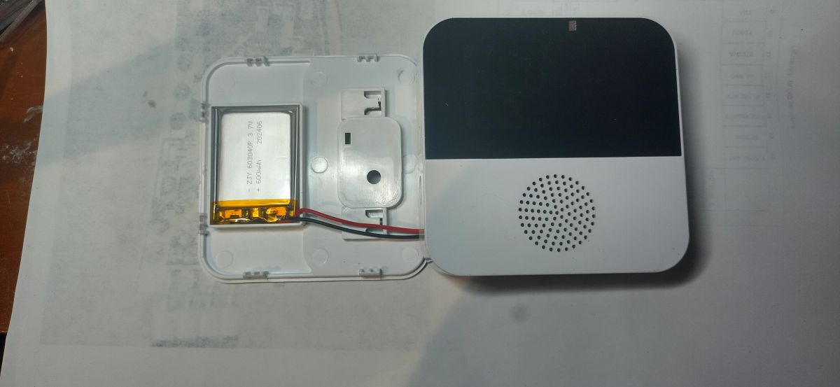

    Open case of an electronic device showing a lithium-polymer battery and speaker

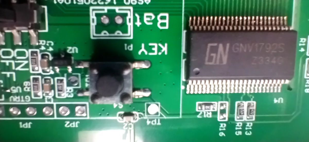

    GNV1792S chip and push button on a green circuit board

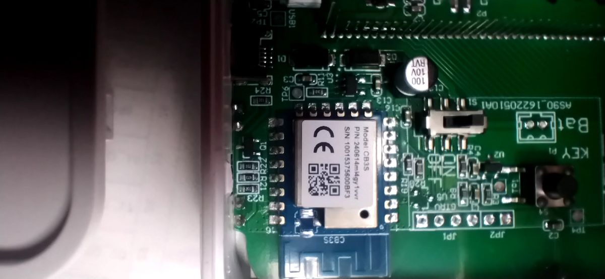

    CB3S communication module on green PCB with switch, button, and electronic components
    bought some months ago cheap smart and humidity meter it worked fine till recently
    today it stopped working showed all digits
    I disassembled this thing and found to my surprise CB3S board
    with following command:
    python3 hid_download_py/uartprogram firmwares/OpenBK7231N_QIO_1.18.177.bin --unprotect -d /dev/ttyUSB0 -w --startaddr 0x0 it worked fine
    after that I got the usual OPENBEKEN screen
    now the question will be how to address display and all the previous functions
    kindly ask you whether anyone has already got this device and also I am curious whether I configure the display and all functionalities
    hoping for some info

    its cheap temu with no brand on it all other data are on photo on the pc the only number I could see apart from CB3S was AS90_1622051 OA the chip driving the display is GNV179S
    AI: do you know what type of display is inside (like segment, I2C, SPI, or chip model), or can you share a photo of the display and how it connects to the CB3S board?
    see in the enclosure
