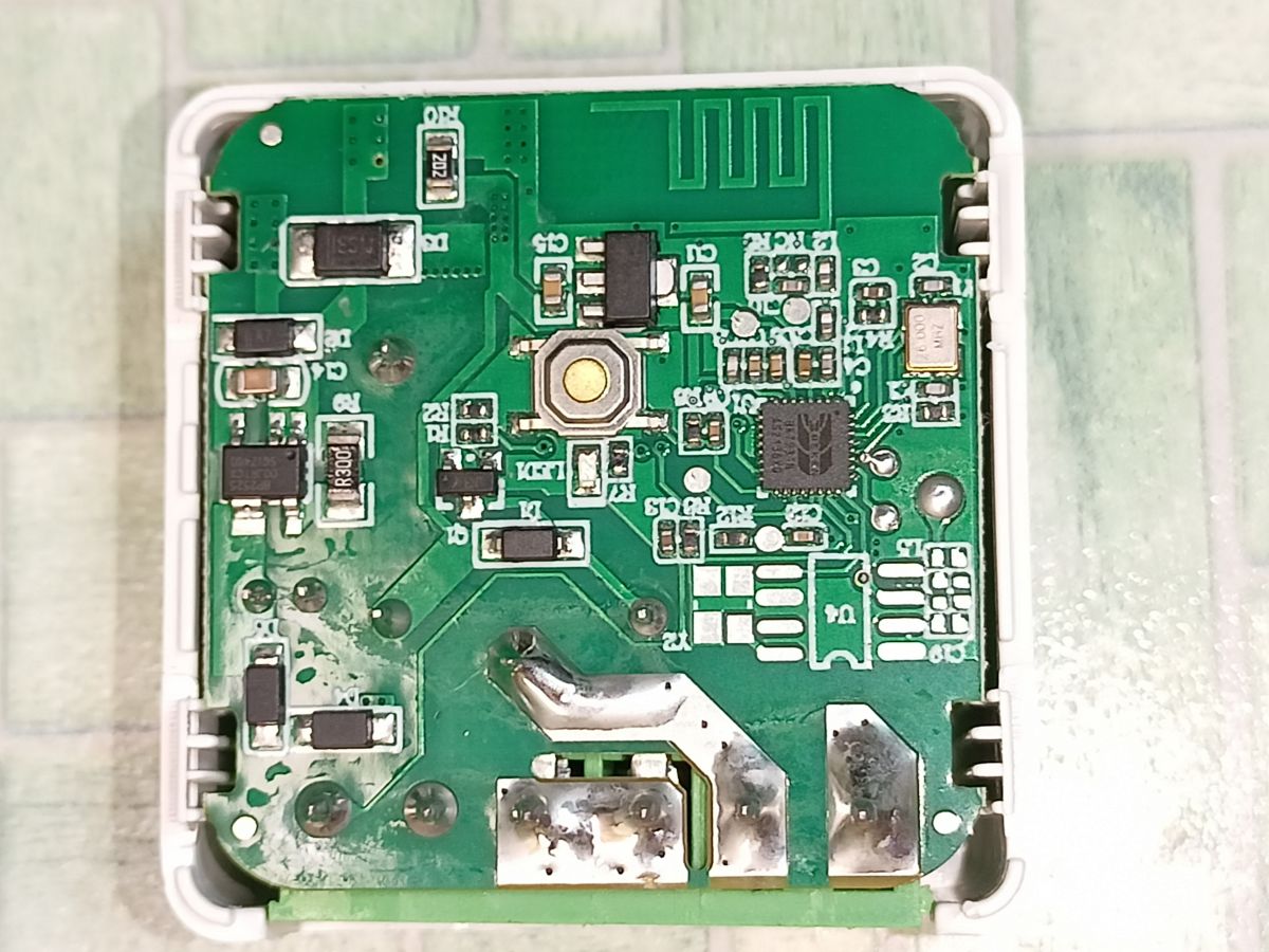

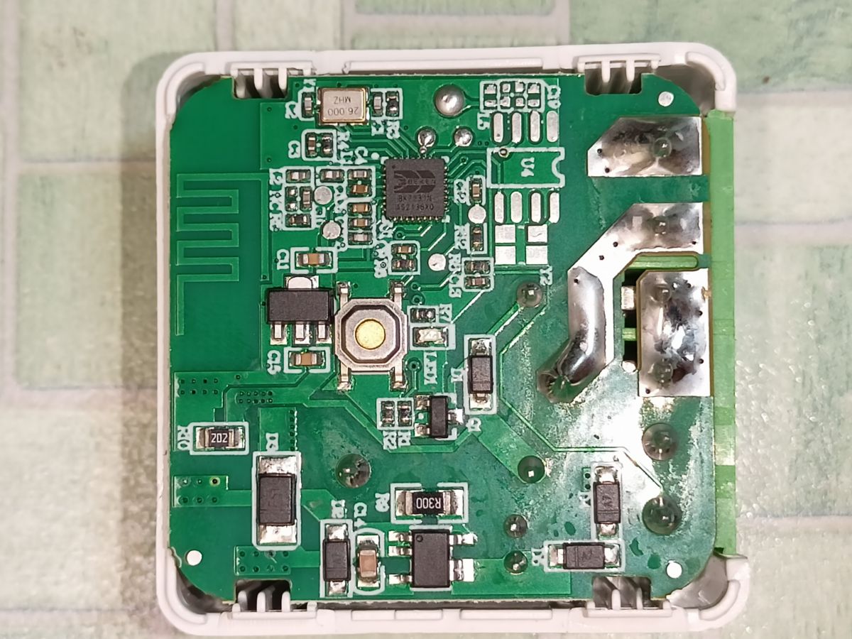

    brizx66
    >>21708115
    Good afternoon. There are two identical switch devices. The chip is BK7231N. Mini Smast Switch. I purchased them, but the seller sent them so that one works with Tuy and the other with Ewelink. I need two Tuya devices. I know how to solder parts and I also use UART. However, I am not a developer, but I can follow the instructions. I believe that I need to take the firmware from the Tuya device and flash it into the Ewelink device. Am I correct?If you can provide links on how to reflash the device from Ewelink to Tuya, I would appreciate it. My email is brizx66(_at_)gmail.com

  • #3 21709387
    Posts: 5216
    Help: 448
    Rate: 917
    this tool can read/write entire flash too for both of those devices https://github.com/openshwprojects/BK7231GUIFlashTool
    I've not seen identical devices before that can be eWeLink or Tuya I don't think. If they are truly identical and fully work the same then I guess they would have the same mac if you cloned the flash to the other. You can change the mac when in OpenBeken though.
  • #4 21709399
    brizx66
    >>21709368
    Oh! I've seen this tool. What actions? Suppose- 1. I make a backup with Tuya and with Ewelink/// 2.I overwrite the backup of the Tuya dump on Ewelink...The question is, how do I change the MAC address to the original one?Do you understand the original task? I don't need to unlink devices from the Tuya cloud. I need to replace the Ewelink firmware with Tuya firmware.
  • #5 21724466
    Posts: 14767
    Rate: 12909
    The MAC address is in RF partition (Tuya has the same like OBK), but I am not sure about Tuya keys.
