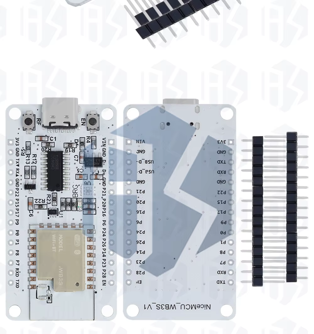

  • NiceMCU XH-WB3S is a very cheap WiFi+Bluetooth development board based on BK7238, aimed at OpenBeken firmware, MQTT, sensors, Home Assistant, and Tasmota Device Groups.
  • Flashing uses BK7231GUIFlashTool in BK7238 mode, starts with a 2MB backup, then moves through WiFi setup, GPIO doctor pin probing, driver commands, and optional scripting.
  • The module uses a 120MHz 32-bit CPU and 2MB of Flash, and the board can cost a few dollars or even $1.
  • The onboard LED is on P6, P24, and P26 with inverted logic, and DHT11, AHT20, MQTT, and Home Assistant discovery all worked.

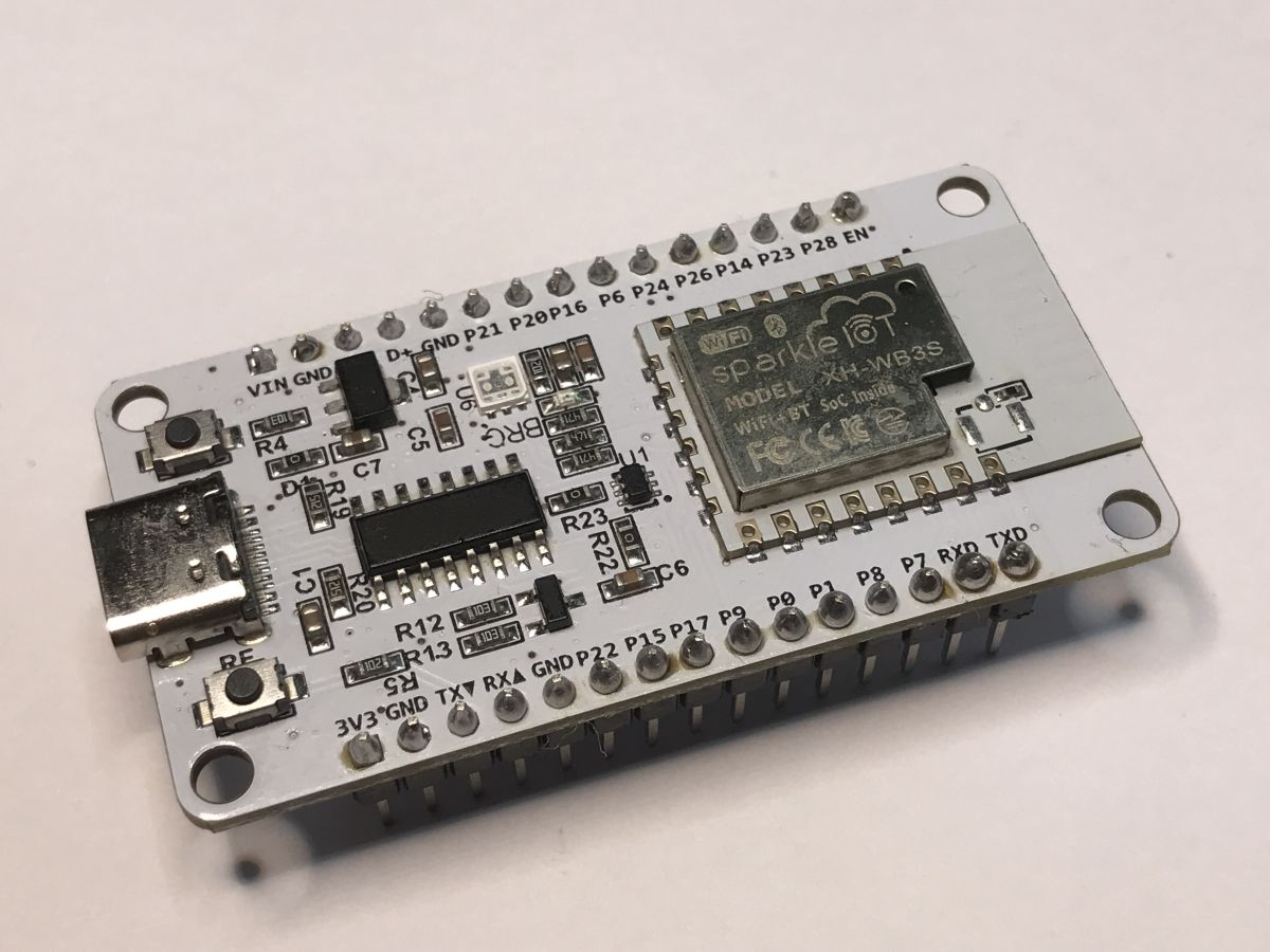

  • NiceMCU XH-WB3S module with microcontroller and USB-C port.

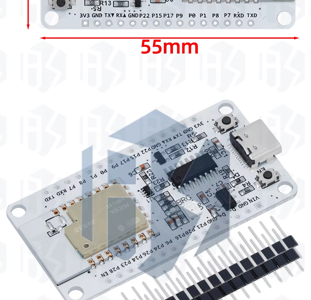

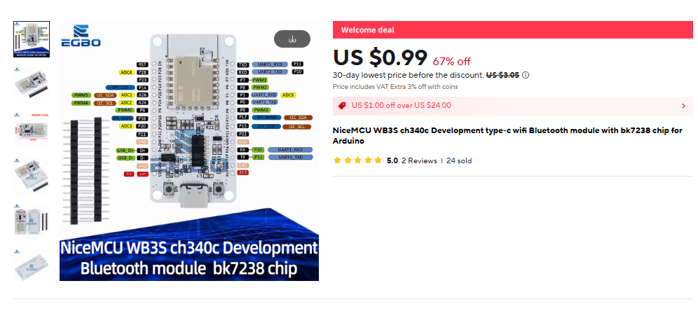

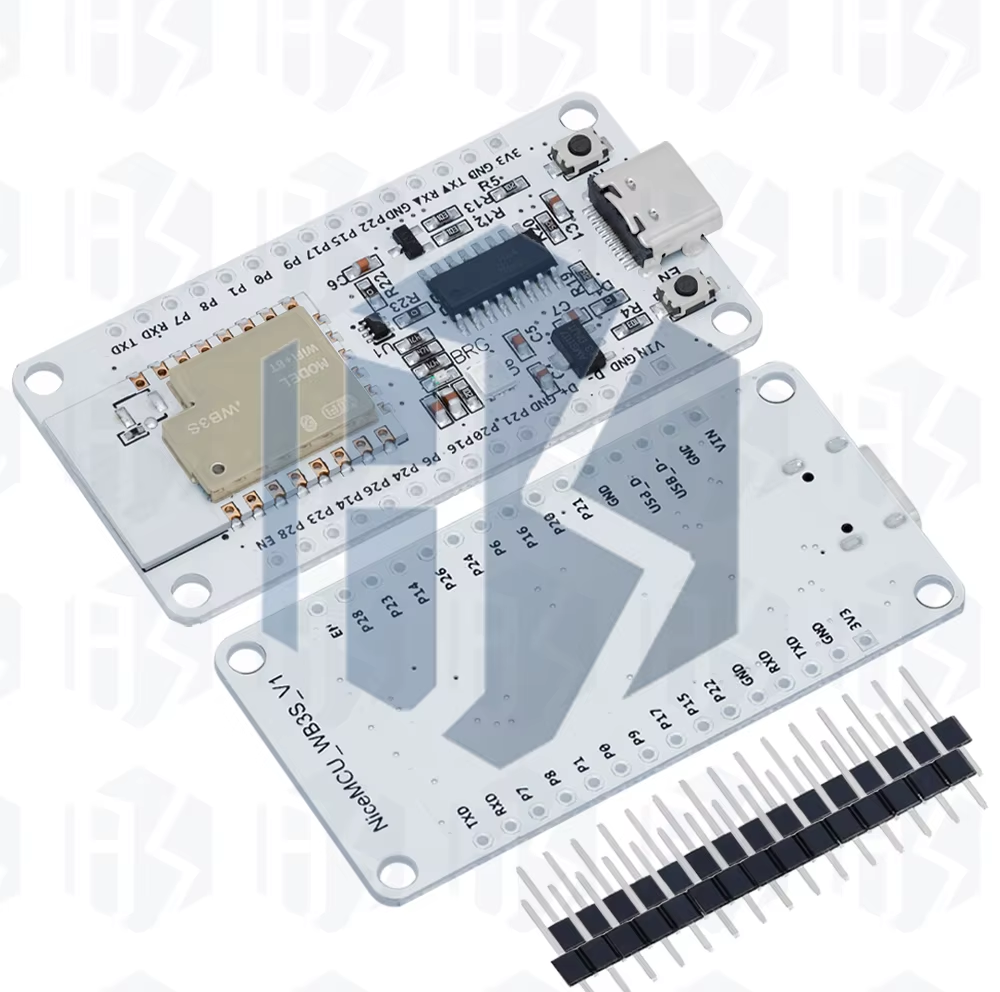

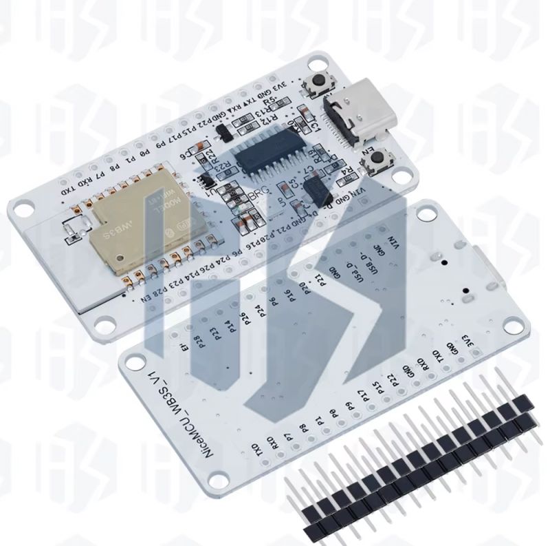

    NiceMCU WB3S is a cheap WiFi+Bluetooth development board featuring 120MHz 32-bit CPU and 2MB of Flash. It can be easily flashed with open source firmware and paired with Home Assistant. Futhermore, you can script it to suit your needs and compile custom firmware versions/drivers online, without having to setup toolchain on your PC.
    The board can be usually bought for few $ and sometimes for as low as 1$:
    NiceMCU WB3S development board with Bluetooth module and bk7238 chip.
    Board module is called WB3S, but it's not using BK7231T, but it's using BK7238, which binary code is different.

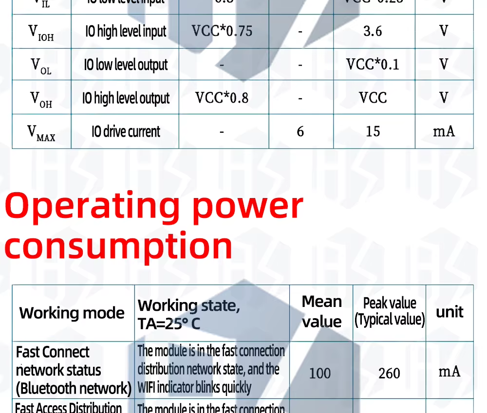

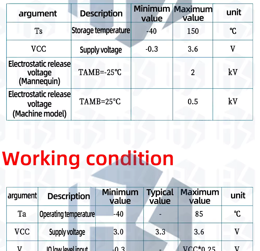

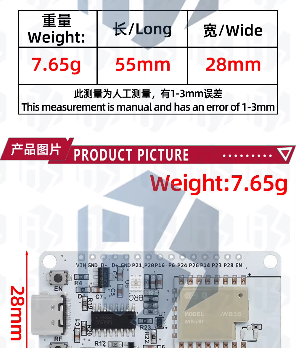

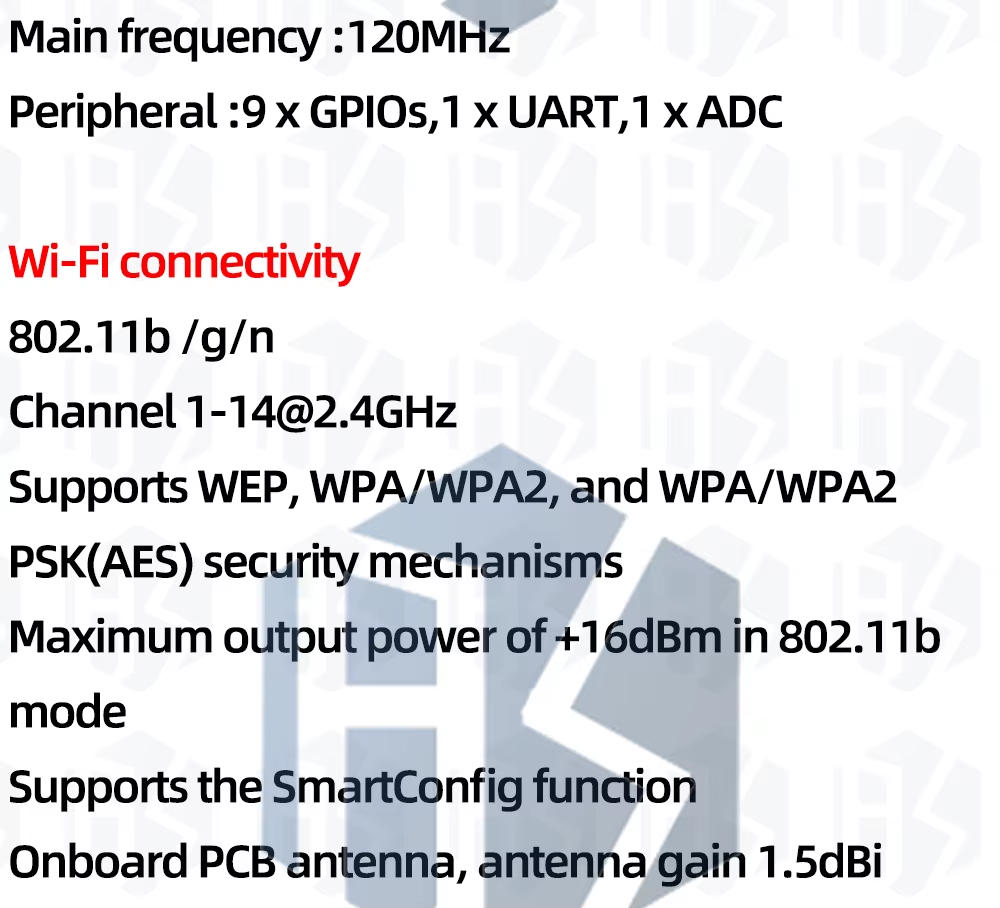

    Here are some basic specs from the seller:
    Information graphic about the NiceMCU WB3S development board
    Wi-Fi connectivity specification of a module with a main frequency of 120MHz.
    Specifications of Bluetooth and electrical parameters of NiceMCU
    Table of minimum and maximum values for storage and operating conditions of an electronic module.
    Electrical specification and power consumption table for NiceMCU WB3S.

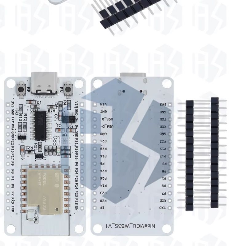

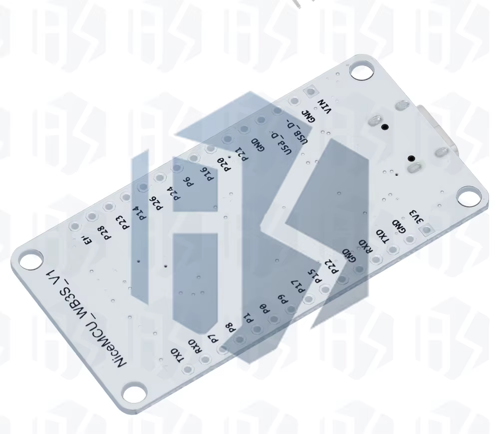

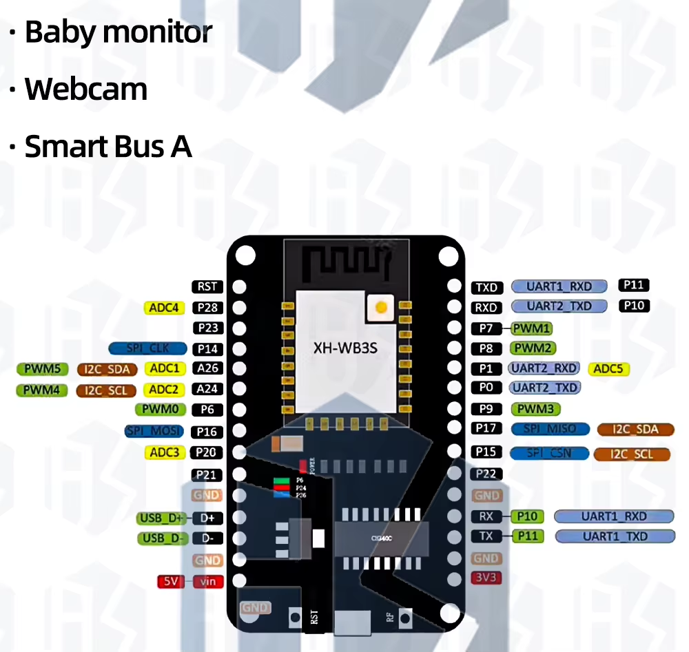

    Diagram of the XH-WB3S development board with pin labels.
    The image shows the NiceMCU WB3S development board with dimensions and weight in a table.
    NiceMCU WB3S with BK7238 processor.
    NiceMCU WB3S development board with pin headers
    NiceMCU WB3S development board with module and connectors
    NiceMCU WB3S development board with pin labels

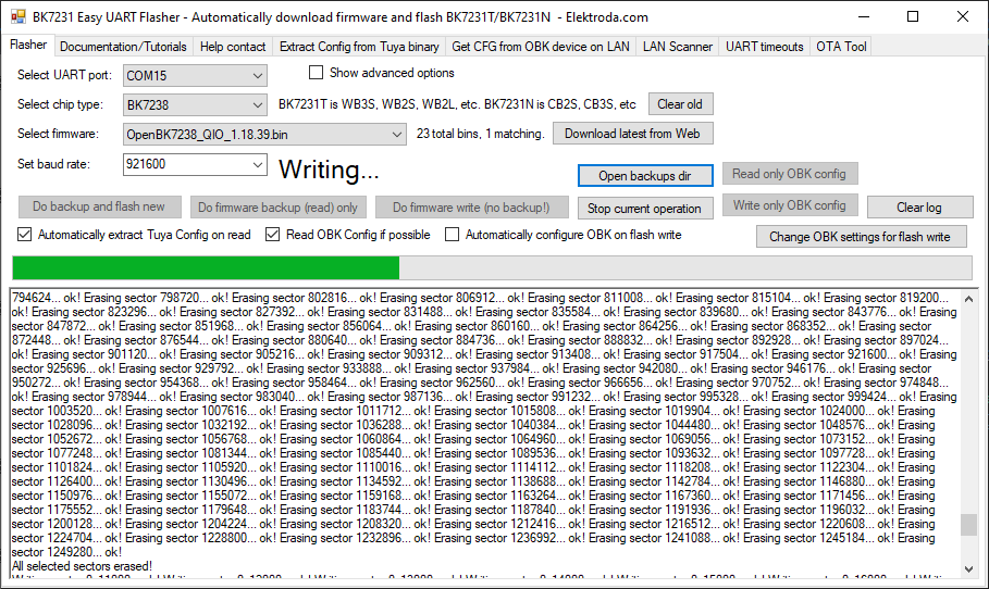

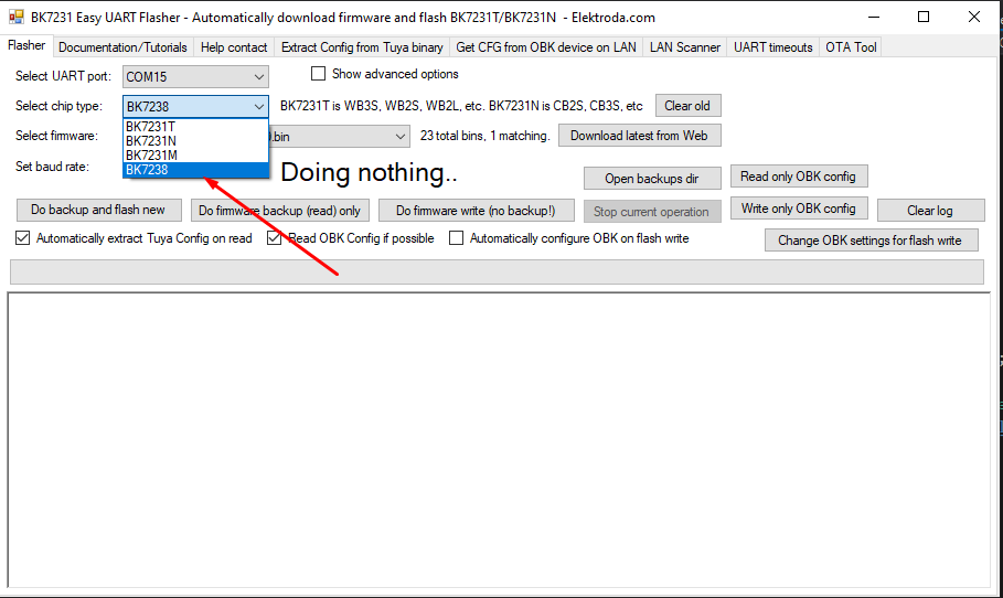

    Flashing new firmware
    Get our flasher from here:
    To be precise, you can download binaries from Releases tab:
    https://github.com/openshwprojects/BK7231GUIFlashTool/releases
    Choose BK7238 mode from the drop-down list:
    BK7231 Easy UART Flasher interface with BK7238 chip selected.

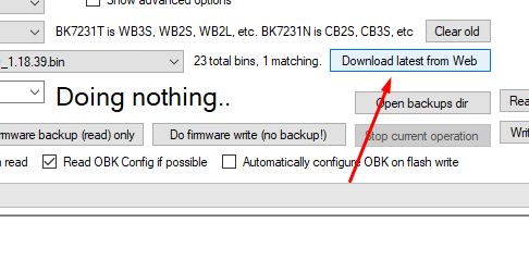

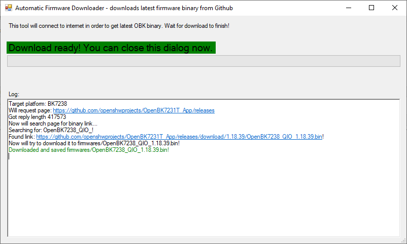

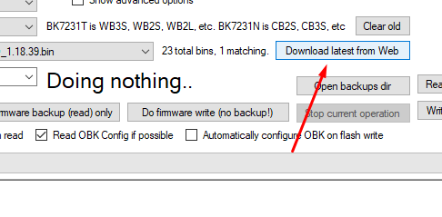

    Click "download latest from web" to get latest firmware from our Github to your PC:
    Screenshot of user interface with Download latest from Web button.
    This will fetch from: https://github.com/openshwprojects/OpenBK7231T_App
    Screenshot of the Automatic Firmware Downloader tool with download completion message.

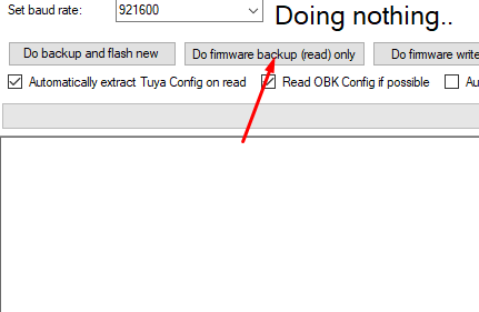

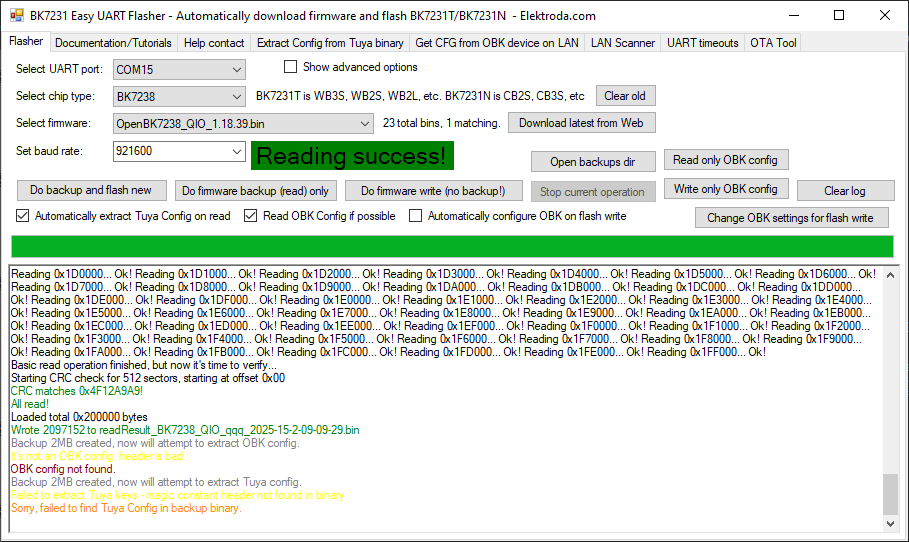

    Then first, please do 2MB flash backup, as usual:
    Window of a flash backup tool with the Do firmware backup (read) only option highlighted.
    While the device is waiting to "get bus", press EN button on PCB once or twice. It may not be needed in the future when we add DTR RESET code on this board.
    In case of raw NiceMCU module, you need to disconnect and reconned power while it's waiting to "get bus".
    BK7231 Easy UART Flasher tool with Reading success! message

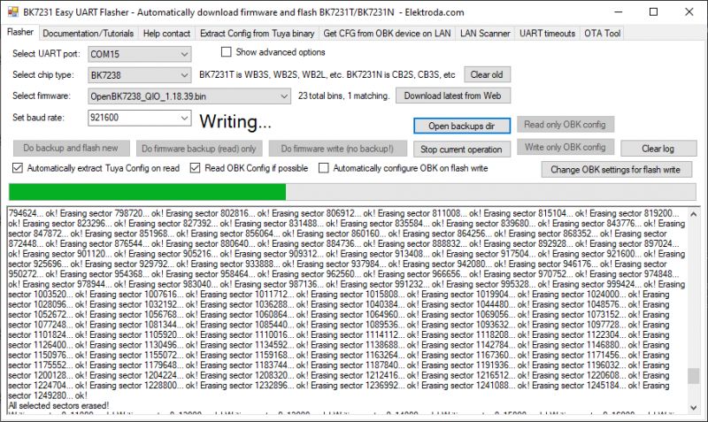

    Then, finally, do firmware write:
    Screenshot of BK7231 Easy UART Flasher application during a flashing operation.
    Press EN button to reboot.

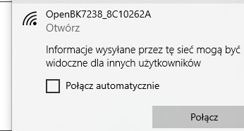

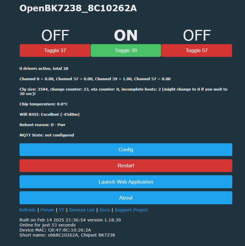

    Initial configuration

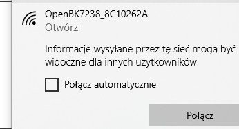

    Connect to OBK access point, just like you'd do with Tasmota:
    Screenshot showing a network connection window for OpenBK7238 WiFi.
    Go to Config->WiFi, enter your SSID and password:
    Screenshot of the OpenBK7238 interface with configuration options.

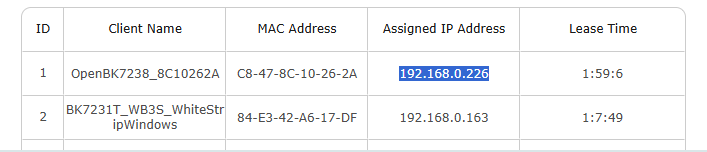

    Get your new device IP from your router:
    IP address table for OpenBK7238 and BK7231T devices.

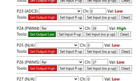

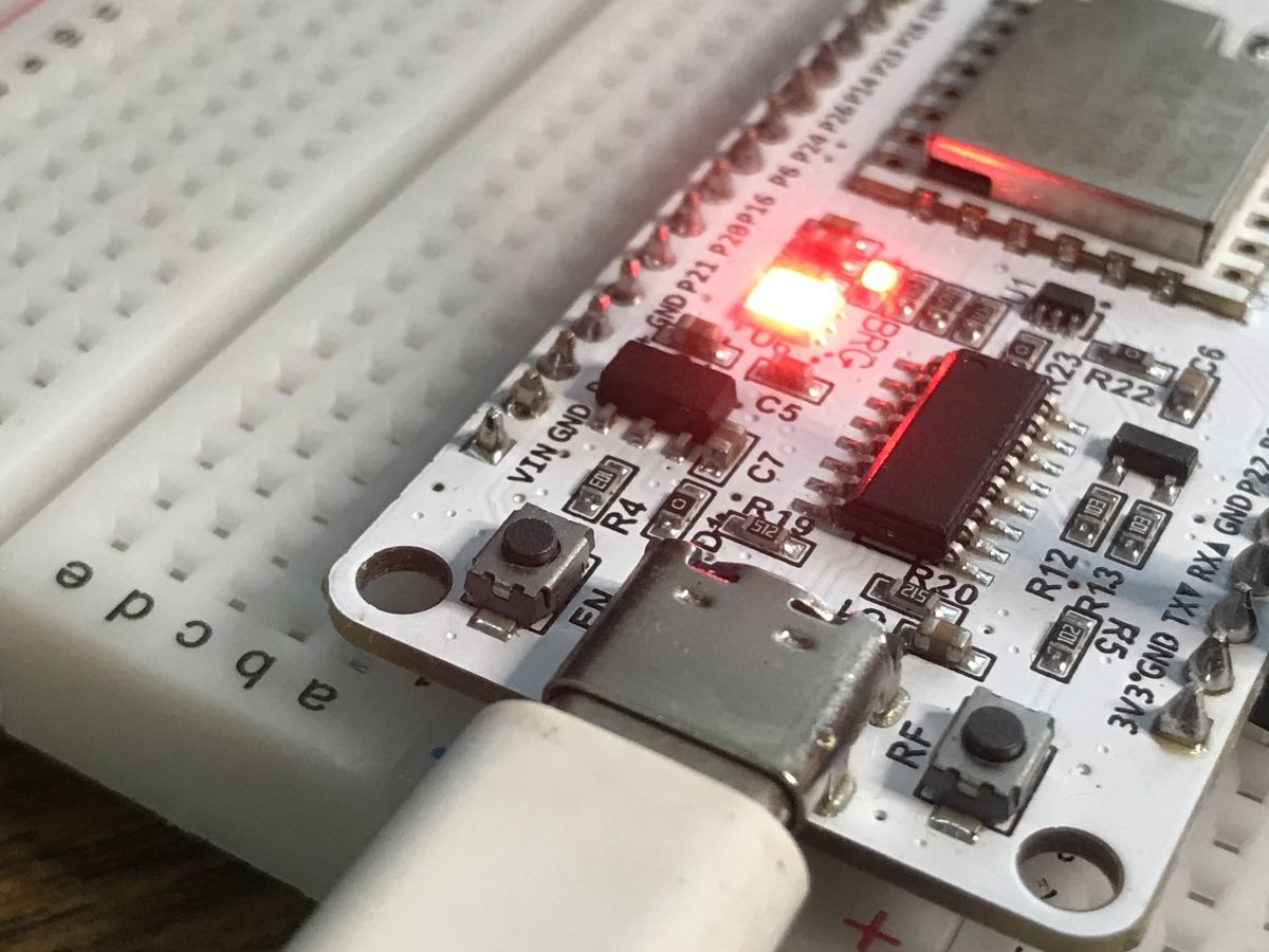

    Playing around with pins
    You can use GPIO doctor from OBK web App to guess roles of the pins:
    Screenshot of the NiceMCU pin configuration interface.

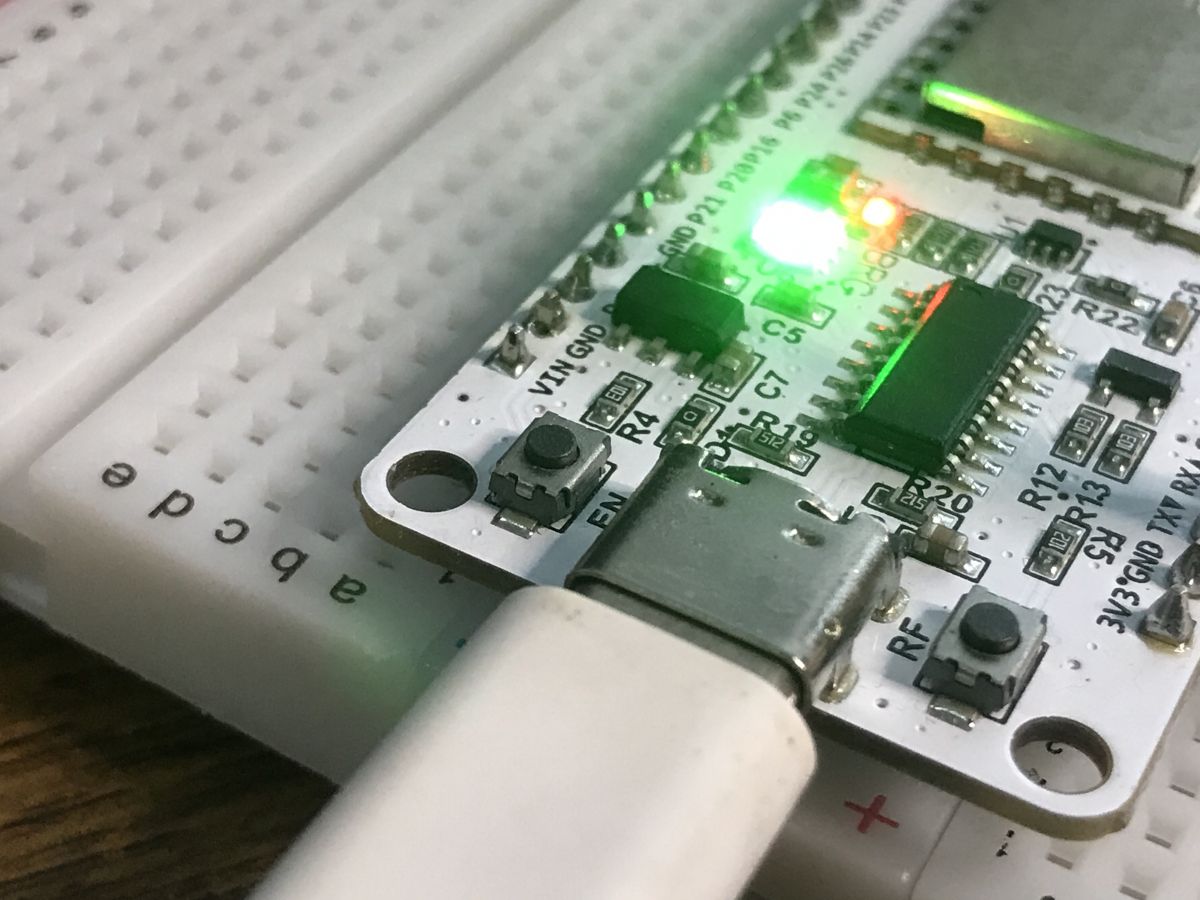

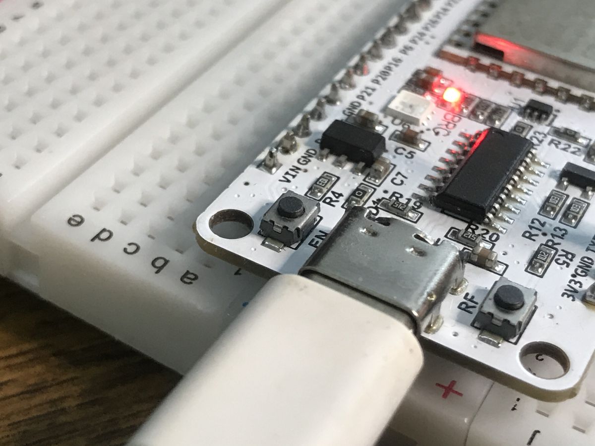

    With this, you can determine that onboard LED is on P6, P24, P26:
    User interface of OpenBK7238 system with control buttons and status information.

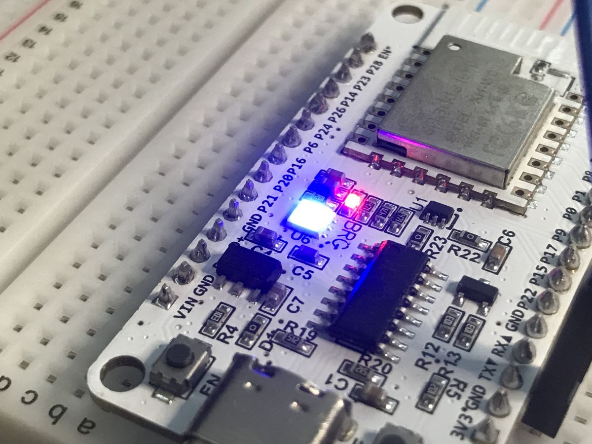

    The logic seems to be inversed here, so you will need either a Relay_n or a PWM_n role.
    Close-up of a development board with a connected USB cable and lit LED.
    Close-up of the NiceMCU WB3S development board with active LEDs on a white breadboard.
    NiceMCU WB3S development board with lit LEDs
    NiceMCU WB3S development board with LED on white background.

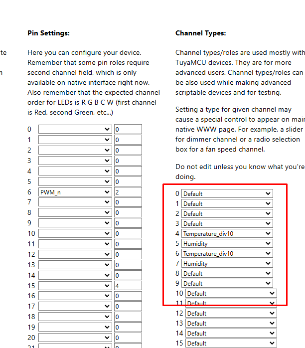

    It is also good to correct channel indexes after using GPIO doctor. They are used to group together buttons and relays and to mark RGBCW PWM indexes (order).
    With this config:
    You can control onboard LED with OBK LED driver:
    Screenshot of OpenBK7238 user interface with LED control options.

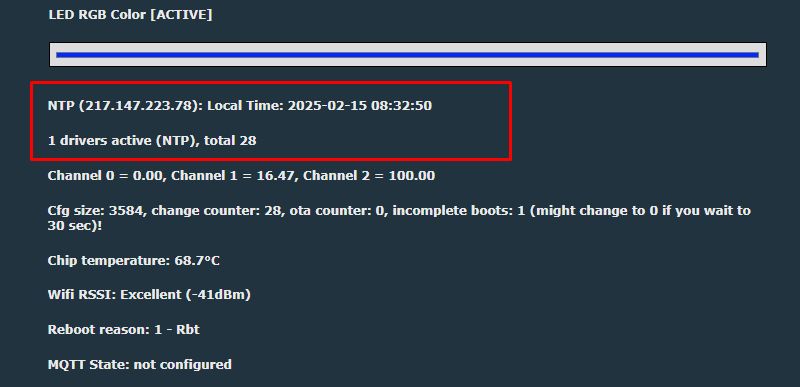

    NTP driver
    Go to Config->Startup command text. Enter:
    startDriver NTP
    And then reboot. Now you will see that NTP driver is running:
    User interface screen with LED RGB and NTP information

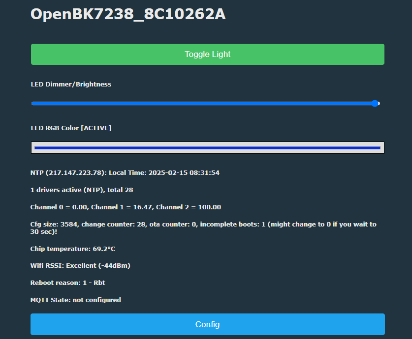

    Save and reboot. LED is now animated:

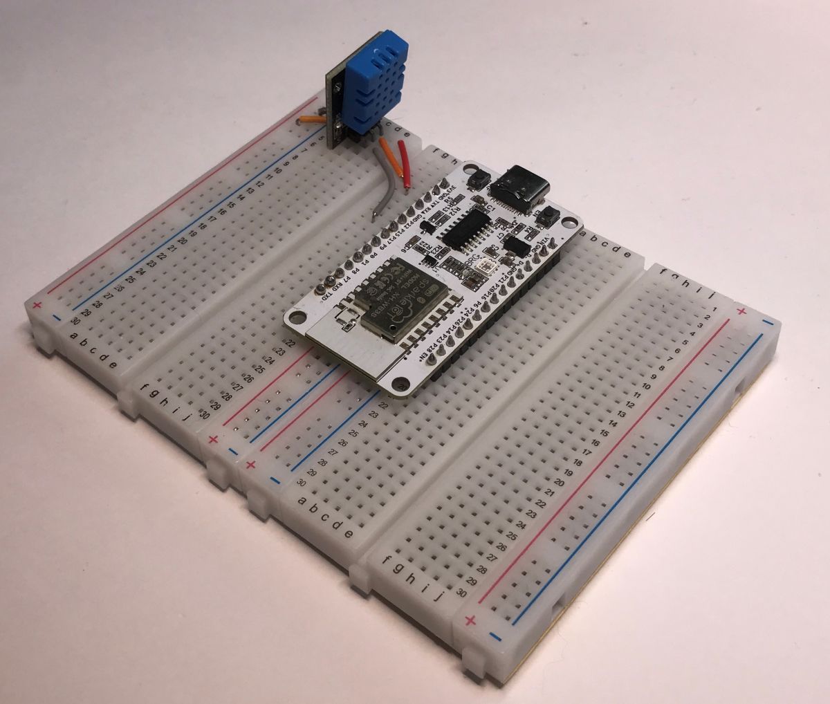

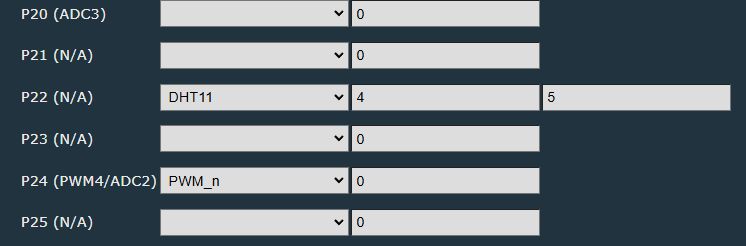

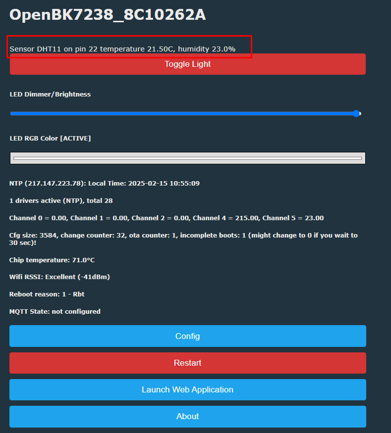

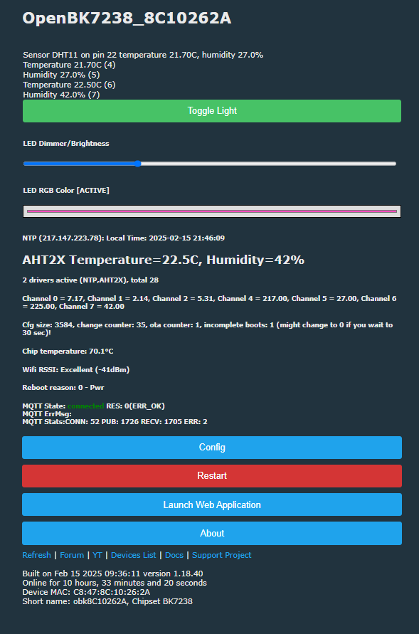

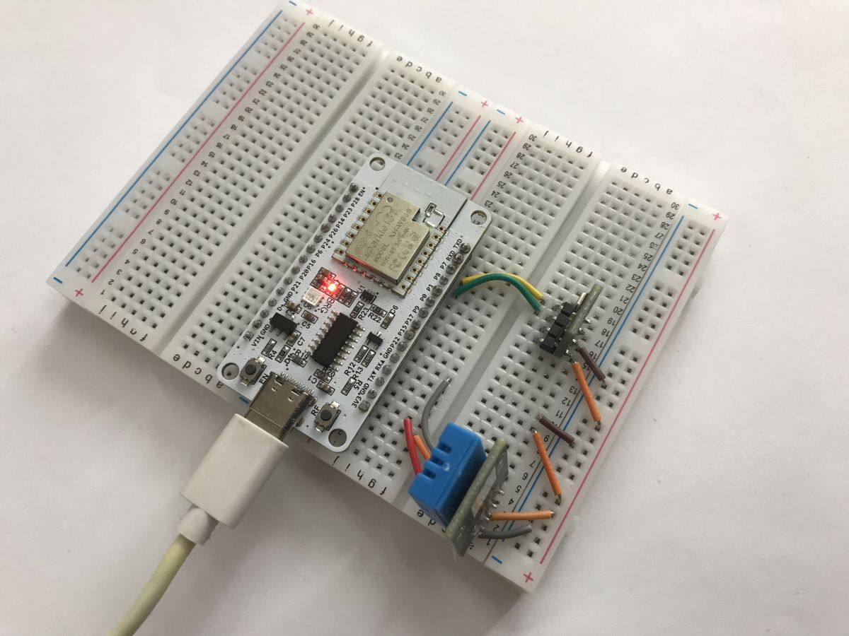

    DHT11 sample
    OBK supports many sensors, including DHT11. It can be easily configured via GUI. You just need to select DHT11 pin and then select two channels used to store temperature and humidity:
    Pin configuration fragment on NiceMCU WB3S with assignments for DHT11 and PWM_n.
    For this purpose, I've chosen pin P22 and did the hardware connection:
    NiceMCU WB3S board on a breadboard with a DHT11 sensor.
    Everything should work out of the box, and keep in mind that DHT family is special and won't show up as a running driver:
    User interface with DHT11 sensor information and LED control.

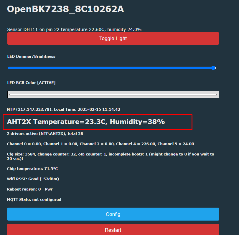

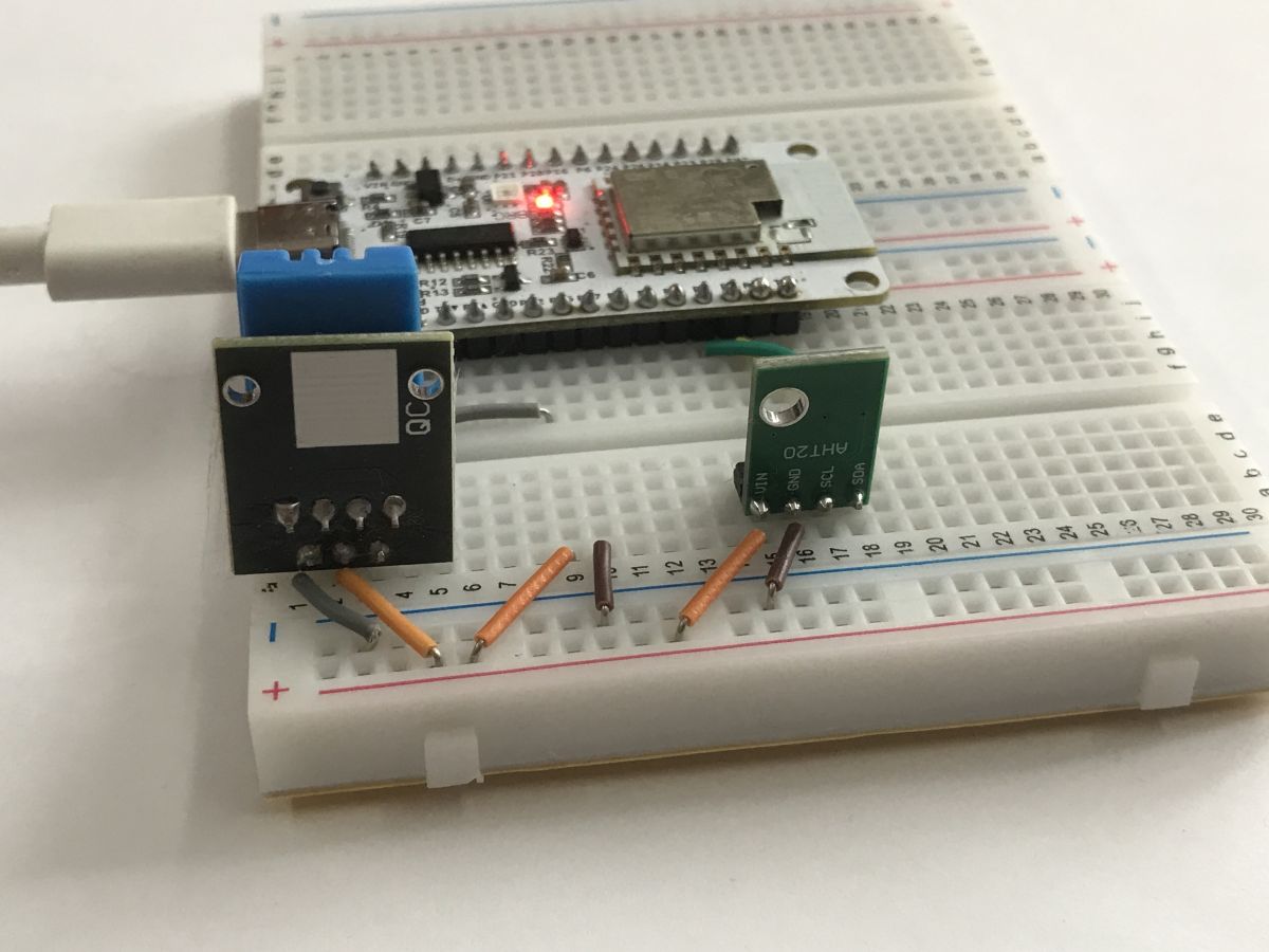

    AHT20 sensor sample
    Let's make another sensor demo. This time we will use AHT20. Connect AHT20 to any two digital pins:
    NiceMCU development board on a breadboard with connected wires.
    Development board with modules connected to a breadboard.
    No pull-ups are needed. Now run it in the firmware.
    First two arguments are pins - I used P8 and P7. Then we have channel indexes for temperature and humidity.
    startDriver AHT2X 8 7 6 7
    This should get you readings on main page:
    OpenBK7238 dashboard with temperature and humidity readings
    If it's not working, and you want to reconfigure without reboot, you can use:
    stopDriver AHT2X
    Remember to add startDriver command to either autoexec.bat or short startup command so it starts with each reboot.

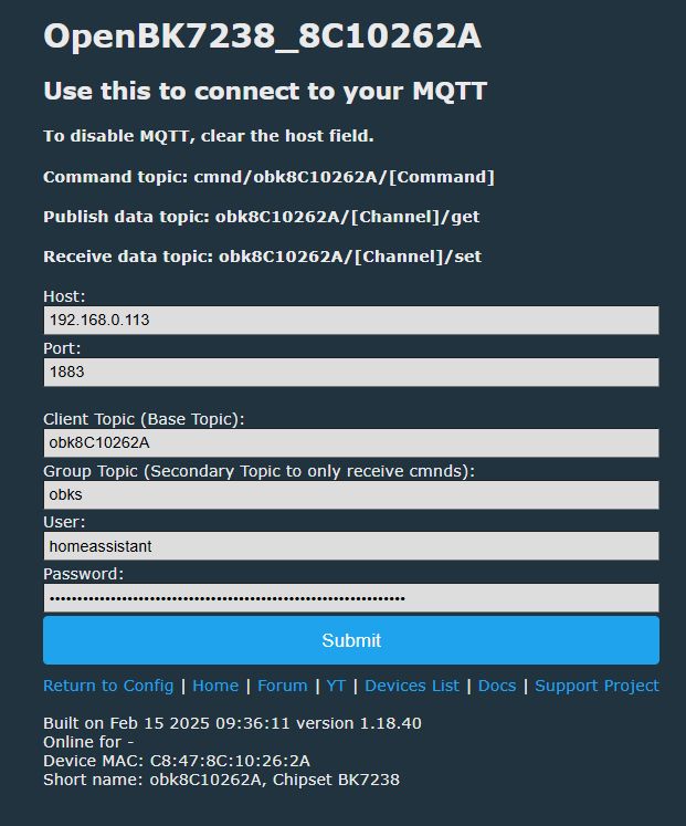

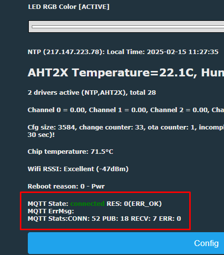

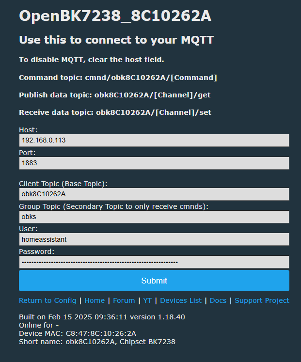

    MQTT Config
    The more detailed information is in the "Pairing with HA" section, but in Config->MQTT you can set your MQTT broker info:
    MQTT configuration panel for OpenBK7238_8C10262A device
    Then you'll have MQTT state shown on the main page:
    Screenshot of an IoT device interface showing MQTT status and system parameters.

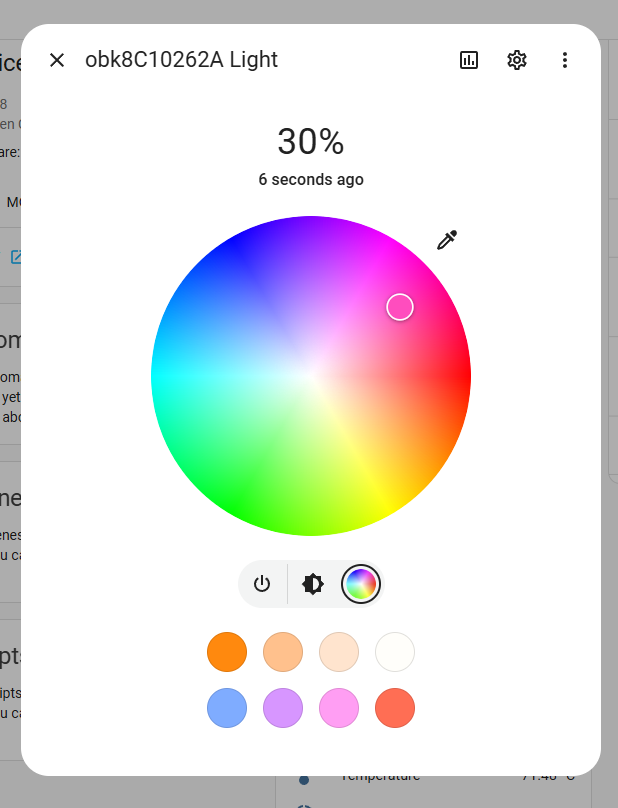

    Pairing with HA
    Now you can pair your simple RGB LED device with Home Assistant. It will show up there with all the necesary controls. Use HA Discovery tutorial:
    Important note: HA Discovery uses channel types to determine how to display channel. Remember to set them in the web app:
    Screenshot of the interface for configuring pin settings and channel types for a device.

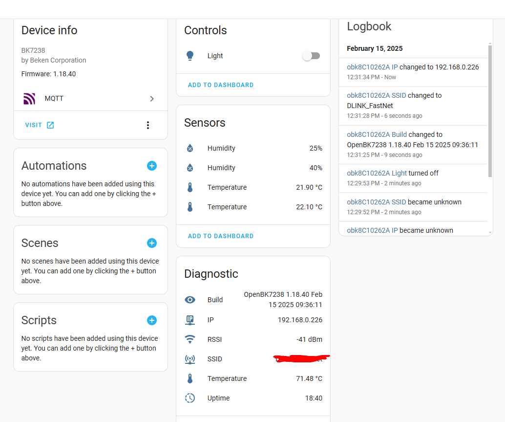

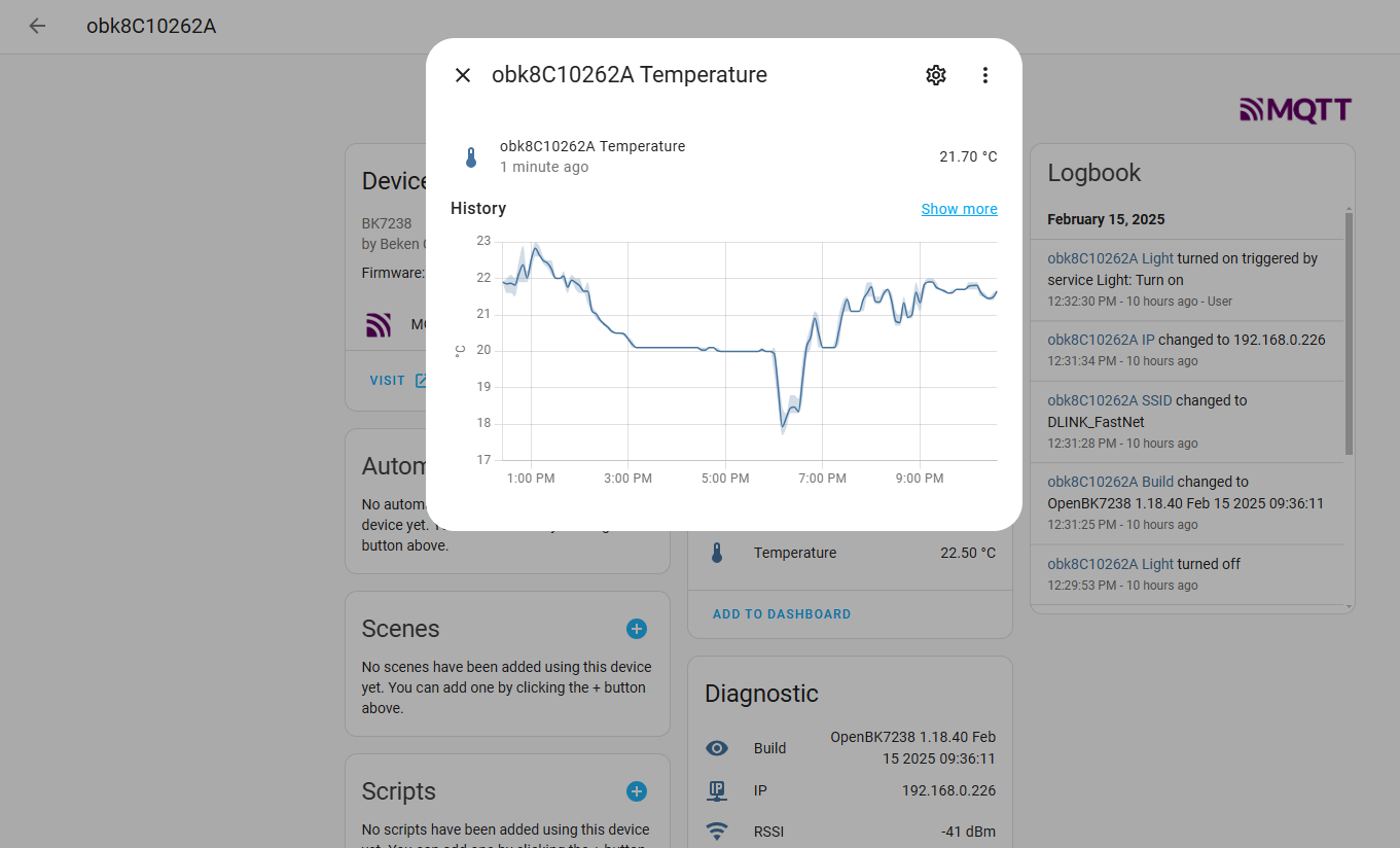

    Here is how my device looks like in HA:
    Screenshot of the Home Assistant user interface showing device BK7238 information.
    LED picker also works:
    Interface for managing light in the Home Assistant app.

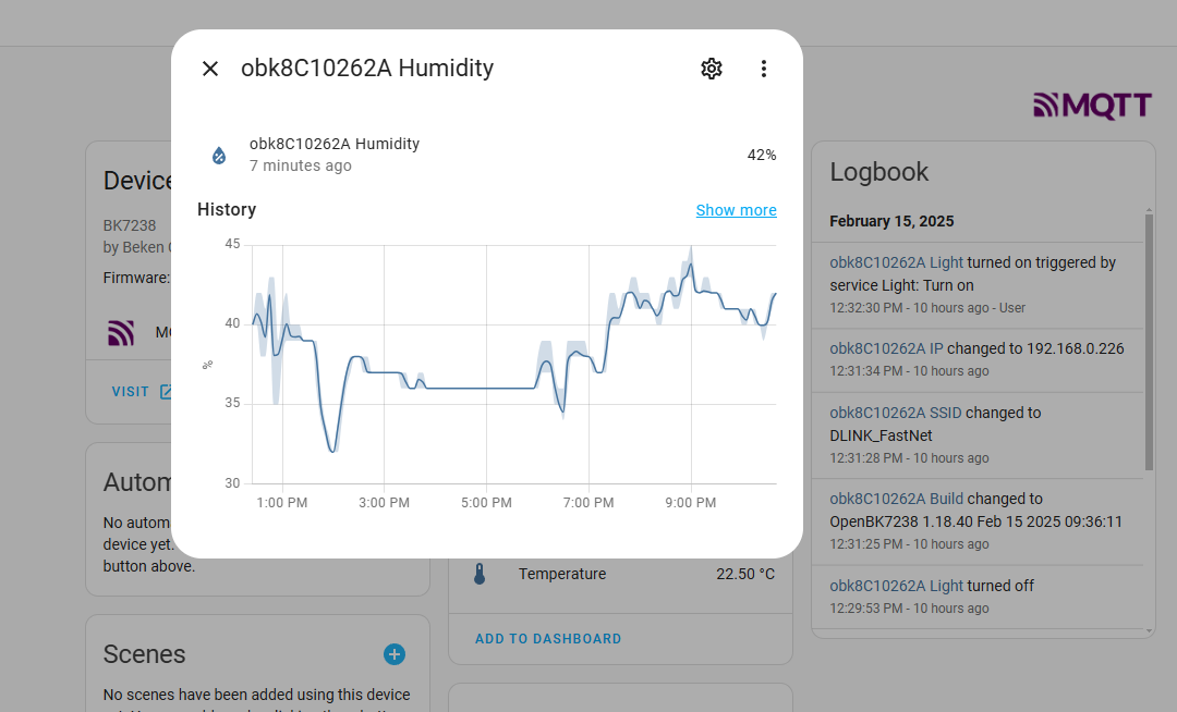

    Added after 10 [hours]:
    More screenshots from Home Assistant:
    Screenshot from Home Assistant showing device temperature history.
    Humidity graph in the Home Assistant app showing changes over time.
    OpenBK7238 user interface with sensor information and LED control.
    Everything seems stable and release-ready.

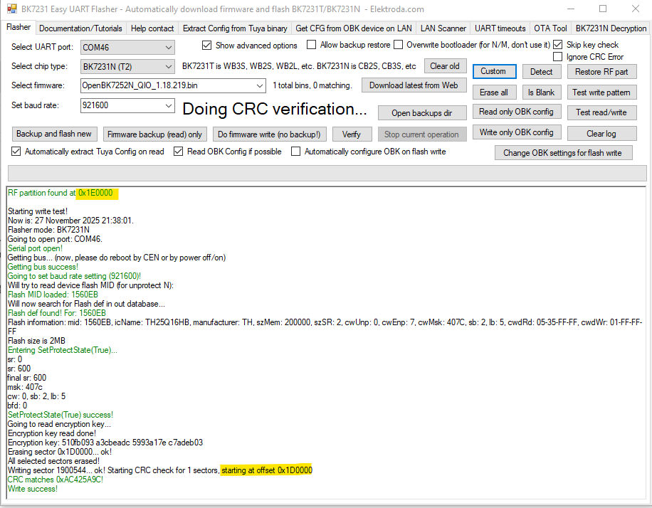

    Hello. I have trouble changing MAC address. For some reason it is the same for 2 switches. C8:47:8C:42:88:48
    Changing the address trough WebUI just makes it disconnect. After reboot its the same MAC.
    Using BK7238 T1, fw 1.18.164
  • #3 21650956

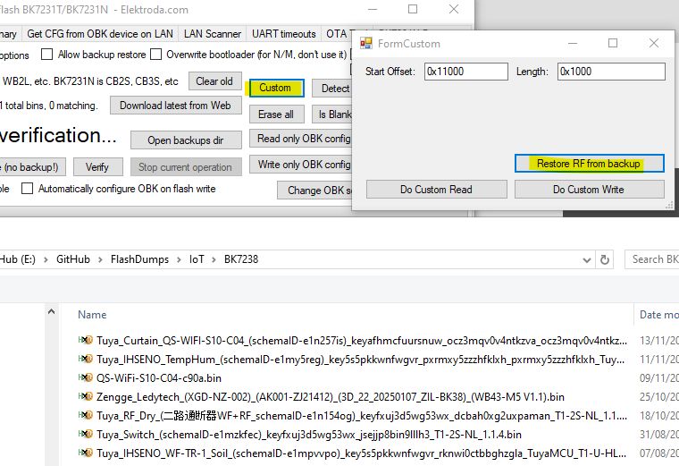

    It seems on T1 RF firmware (mac + calibration) is located at different offset.
    Either move it from 0x1E3000 to 0x1E1000 (like take a backup, move it with hex editor and flash it back) or do "Restore RF Part" in flasher.

  • Restore RF TLV by moving it to 0x1e1000
    #6 21731620
    Recently I purchased a few modules QS-WiFi-S10-C04, apparently based on BK7238 (unlike older items of the same type with BK7231N), and hit the same issue. I flashed OpenBK7238_QIO_1.18.205.bin and the module switched its MAC address to C8:47:8C:42:88:48. TLV at 0x1e3000 got erased (or overwritten).
    I tried the recommended method of moving TLV from 0x1e3000 to 0x1e1000 (I actually made a copy, so there were two copies flashed). That didn't help -- both areas were still untouched after flashing but got overwritten by OpenBK after it booted.
    Any further recommendations or thoughts?
    I'm attaching a flash dump that contains original bootloader, OpenBK, its config data and destroyed TLV at 0x1e3000.
    • QS-WiFi-S10-C04-c90a-OpenBK7238-after-booting.bin.zip (1.15 MB) You must be logged in to download this attachment.

    If you have a backup before flashing OpenBK, in latest flasher versions in "Custom operation" there is a button "Restore RF from backup". Click it, select your backup and it will restore TLV sector at required offset.
  • TLV restore fails at flash erase step
    #8 21731647
    jmkrzyszt
    Posts: 40
    >>21731636
    Thanks @insmod now I understand how restoring the TLV is supposed to work. Unfortunately, something is broken. With Start Offset: 0x1e3000 and Length: 0x1000, I'm getting the following result after pressing Custom Write:
    Apparently the tool is trying to write far more data than I think I requested.

    >>21731647
    Don't use custom write, use "Restore RF from backup"
  • Restore RF from backup unavailable in older flasher versions
    I guess that's not available in the half year old version I sill use.

  • #13 21731686
    jmkrzyszt
    Posts: 40
    OK, I think I'm able to flash the missing TLV with ltchiptool. I flashed it successfully at 0x1e3000, but it didn't survive OpenBK boot and still the fake MAC address was used. The same when flashed at 0x1e1000. Maybe there is another offset where it won't be destroyed, and maybe even examined by OpenBK for correct MAC address?

  • Easy Flasher can restore BK7238 RF backup to BK7231N offset
    #16 21764525
    Posts: 5236
    Help: 450
    Rate: 920
    similar can be achieved in Easy Flasher too
    BK7231N flashing interface with open “FormCustom” window
    here you see EF detecting the RF partition for a BK7238 backup and flashing it to the correct location for BK7231N
    BK7231 Easy UART Flasher interface showing flash and CRC check process
  • OpenBK expects TLV sector at 0x1e0000
    #17 21764552
    jmkrzyszt
    Posts: 40
    Great, my devices now work as expected! The key information was about the location of the TLV sector at 0x1e0000 expected by OpenBK. Based on the discussion before, my understanding was that it should be located at 0x1e1000 (moved from factory 0x1e3000 to OpenBK expected 0x1e1000). Now everything is clear to me: OpenBK is using that data, and it expects to find it at 0x1e0000.
    @insmod , @dufu , @divadiow , thank you for your support!
    PS. For reasons explained before, I'm not using the Easy Flasher, however, uartprogram or ltchiptool, or bk7231tools utility to some extent, do the job for me.
Discussion about flashing and using NiceMCU WB3S / BK7238-based Tuya Wi‑Fi switches with OpenBK/OpenBeken, MQTT, and Home Assistant. The main issue was duplicated or incorrect MAC addresses after flashing, caused by the RF/TLV calibration partition being stored at a different flash offset on BK7238 than expected. Several methods were tested, including moving the TLV sector, restoring RF data from backup, and writing with ltchiptool or uartprogram. The final solution was to restore or flash the RF/TLV sector to the offset expected by OpenBeken BK7238 builds, which use 0x1e0000, while factory Tuya firmware stores it at 0x1e3000. Easy Flasher was also mentioned as able to detect and place the RF partition correctly.
