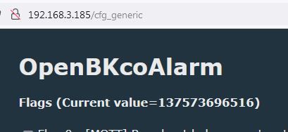

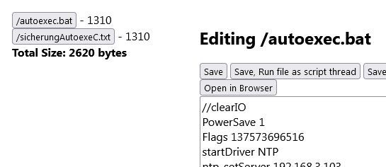

    Something else i noticed, but it is more a cometic thing. The configured flags-code differ:
    Text editor window showing contents of autoexec.bat and file size info
    OpenBKcoAlarm web interface with IP address and flag value
    Screenshot showing chipset BK7231N and software version 1.18.199

    I see, but that's... that's not related to 193/194 release bug and recent changes? We can investigate it next as well.
  • #5 21723606
    blacksun2
    Posts: 59
    No, I noticed it when I investigated the 193/194 release bug.
    It has nothing to do with this bug.
