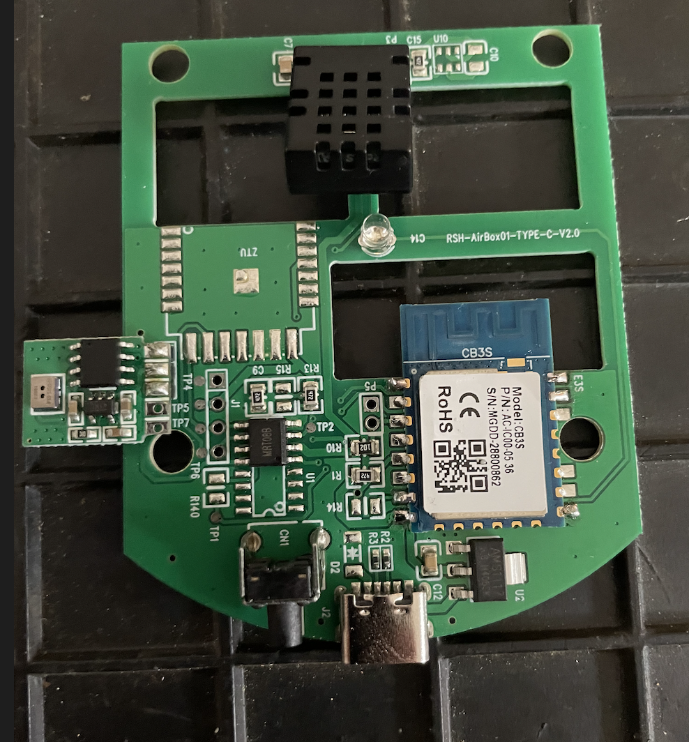

    I have problems getting the values ​​out after switching to OpenBeken
    Printed circuit board with electronic components viewed from above.
    White circular device labeled Tuya Smart Air Box with Tuya, Wi-Fi, and Smart Life logos on top.

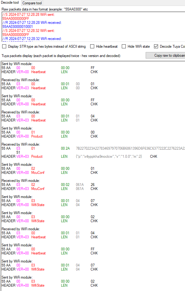

    With original firmware this is read out:
    Table with sensor values read after switching to OpenBeken.
    2 = CH2O mg/m^3, div 100
    18 = Temperature, div 10
    19 = Humidity, div 10
    21 = VOC ppm, div 10
    22 = CO2 ppm

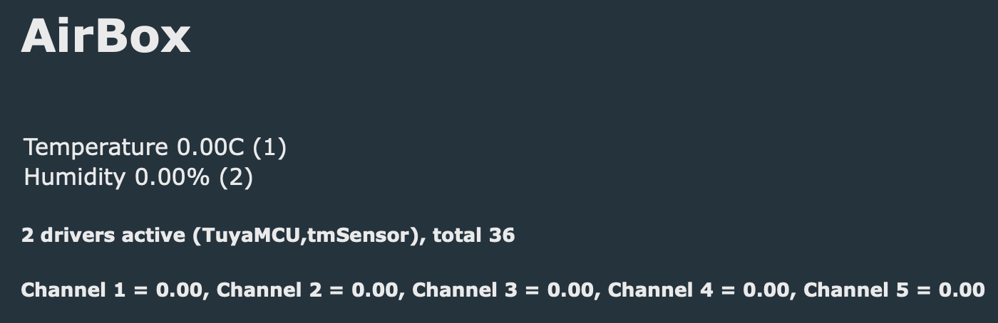

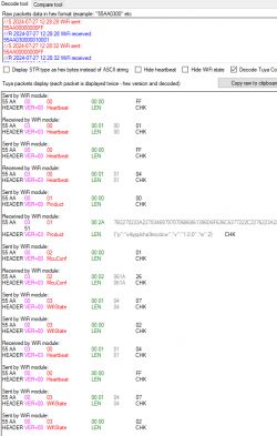

    After I switch to OpenBeken, this is read out
    Screenshot of a WiFi data decoding tool showing raw packets.
    Screenshot of AirBox interface showing all sensor readings at 0.00.
    Anyone have any suggestions what I have missed?

    at what baud did you capture original comms?
    if 115200, add tuyaMcu_setBaudRate 115200 to your autoexec

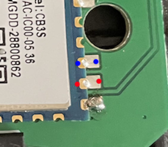

    was the CB3S removed from the PCB for flashing?
    Is there definitely continuity between the module and the pad, between the very edge of the gold contact on the module and the silver pad on PCB, eg between these dots
    CB3S module on a PCB with marked solder points.
    and then continuity onwards to the legs of the MCU it's talking to?
  • #5 21169787
    lars4
    Posts: 14
    >>21169786
    No, it was not removed. No resistors had to be unsoldered either, it was still possible to flash. I have tried to flash back the original firmware and then everything works as it did before

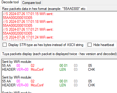

    without startDriver tmSensor

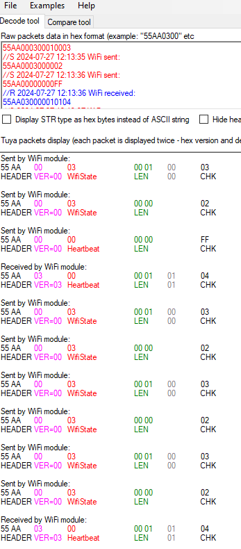

    Screenshot of a data packet analysis tool in hexadecimal format.
  • #10 21169837
    Posts: 5062
    Help: 438
    Rate: 893
    oh hang on. add tuyaMcu_defWiFiState 4 under startDriver TuyaMCU
  • #11 21169842
    lars4
    Posts: 14
    >>21169837
    Still no values :-(

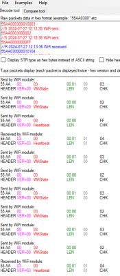

    Screenshot of a packet decoder tool for WiFi communication.
    Autoexec.bat
    startDriver TuyaMCU
    //startDriver tmSensor
    tuyaMcu_setBaudRate 9600
    setChannelType 1 Temperature_div10
    linkTuyaMCUOutputToChannel 18 val 1
    setChannelType 2 Humidity_div10
    linkTuyaMCUOutputToChannel 19 val 2
    setChannelType 3 Custom
    SetChannelLabel 3 CH2O mg/m^3
    linkTuyaMCUOutputToChannel 2 val 3
    setChannelType 4 Custom
    SetChannelLabel 4 VOC ppm
    linkTuyaMCUOutputToChannel 21 val 4
    setChannelType 5 Custom
    SetChannelLabel 5 CO2 ppm
    linkTuyaMCUOutputToChannel 22 val 5
    #12 21169855
    Posts: 5062
    Help: 438
    Rate: 893
    I'm probably forgettng something obvious
    and if you enter command tuyaMcu_sendQueryState do you get all the current dpID statuses returned to the log?
  • #13 21169864
    lars4
    Posts: 14
    >>21169855
    Now I got the values after entering the command tuyaMcu_sendQueryState Thanks!!!

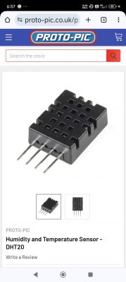

    I wonder if it's a DHT20.
    DHT20 humidity and temperature sensor with four metal pins.
    Added after 8 [minutes]:
    How could the poster confirm apart from desoldering and trying the sensor with one of the DHT sensor driver option or just an Arduino setup?
    https://github.com/search?q=repo%3Aopenshwprojects%2FOpenBK7231T_App+dht&type=code&p=2
    DHT20 isn't mentioned but does the driver support it anyway?
    I guess if a dump of the MCU flash could be had there might be mention in there of the exact sensor

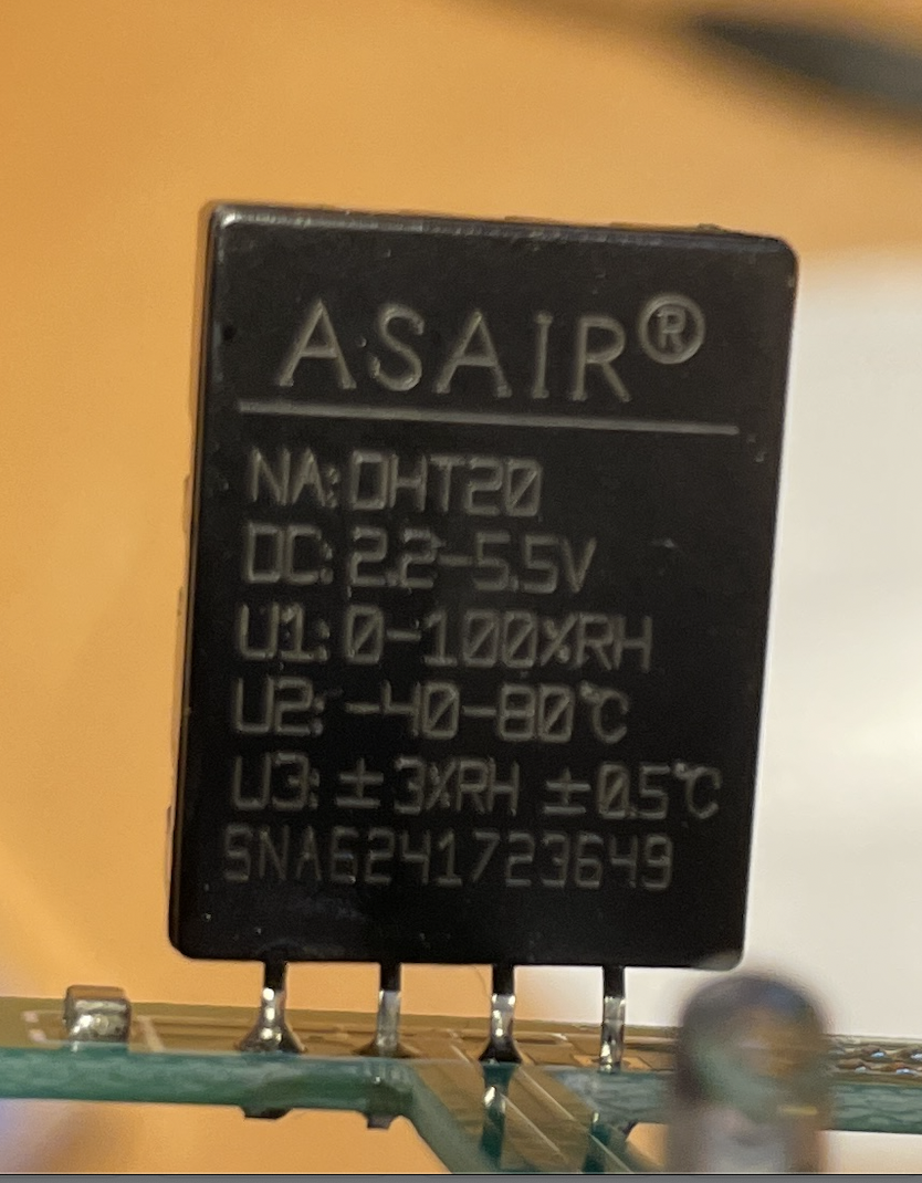

    >>21173494
    Yes it is a DHT20
    Close-up of an ASAIR DHT20 sensor on an electronic board.
    I can't find any information about the second sensor

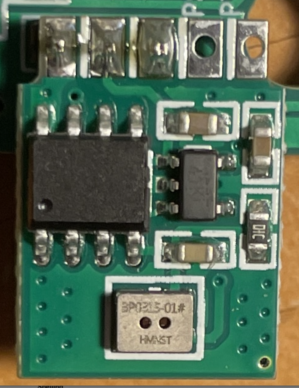

    Image of a circuit board with several electronic components, including a sensor labeled BP0315-01# HMNST.

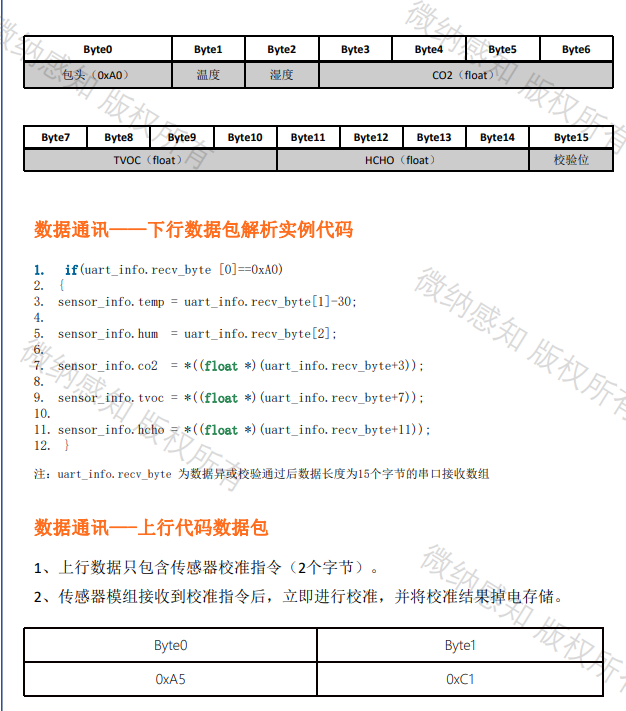

    Guess it says BP0315-01# HMNST
  • #23 21174757
    Posts: 5062
    Help: 438
    Rate: 893
    The Hefei Micro Nano Sensing Technology Co. Ltd (HMNST) contact Lei has stated the sensor on that module is an HGS1000 http://www.hmnst.com/a/products/gas/73.html
    English translated info PDF attached
    • HGS1000_EN.pdf (734.79 KB) You must be logged in to download this attachment.

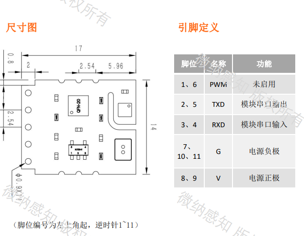

    So it's DHT20 indeed. It should work well with OBK directly, without MCU:
    HGS1000, on the other hand, is not currently supported. I've checked @divadiow 's documents but I can't see any details about the communication protocol used by HGS1000 family. Maybe we would need to hook up a 10$ logic analyzer for that, like I did in some other topics: https://www.elektroda.com/rtvforum/topic4035491.html
    EDIT: It's UART:
    Diagram showing DHT20 and a table with pin descriptions. Fragment of technical documentation for a UART communication protocol, including a data packet structure and example code in a programming language.

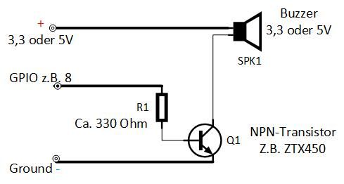

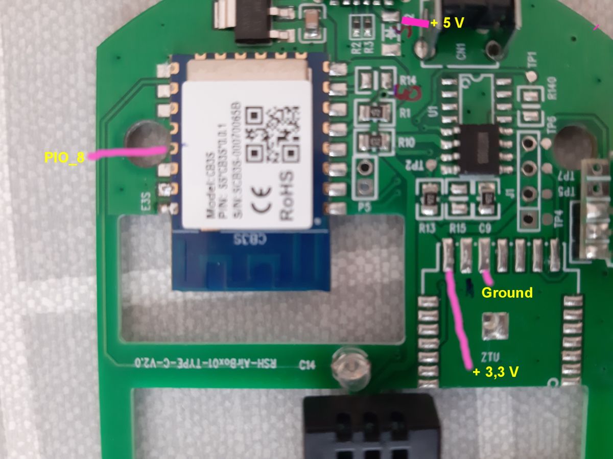

    I'm thinking about an "adapted usage" of this AirBox. It should give an alarm sound when certain values are exceeded.
    To achieve that, I would connect an alarm buzzer (rated 35 mA) to one of the unused Pins of the CB3S. P8 (GPIOP_8) on Pin 13 seems to be available.
    What will I have to add in the autoexec.bat in Post#15, to set P8 to high (or low, whatever is easier), when at least one of these values are exceeded:
    - Channel 1 (temperature) is over 550 (that would be 55 degrees)
    - Channel 2 (humidity) is over 800 (80%)
    - Channel 3 (CH2O) is over 50 (0,5 mg/m3)
    - Channel 4 (VOC) is over 50 (5 ppm)
    - Channel 5 (CO2) is over 700 (700 ppm)

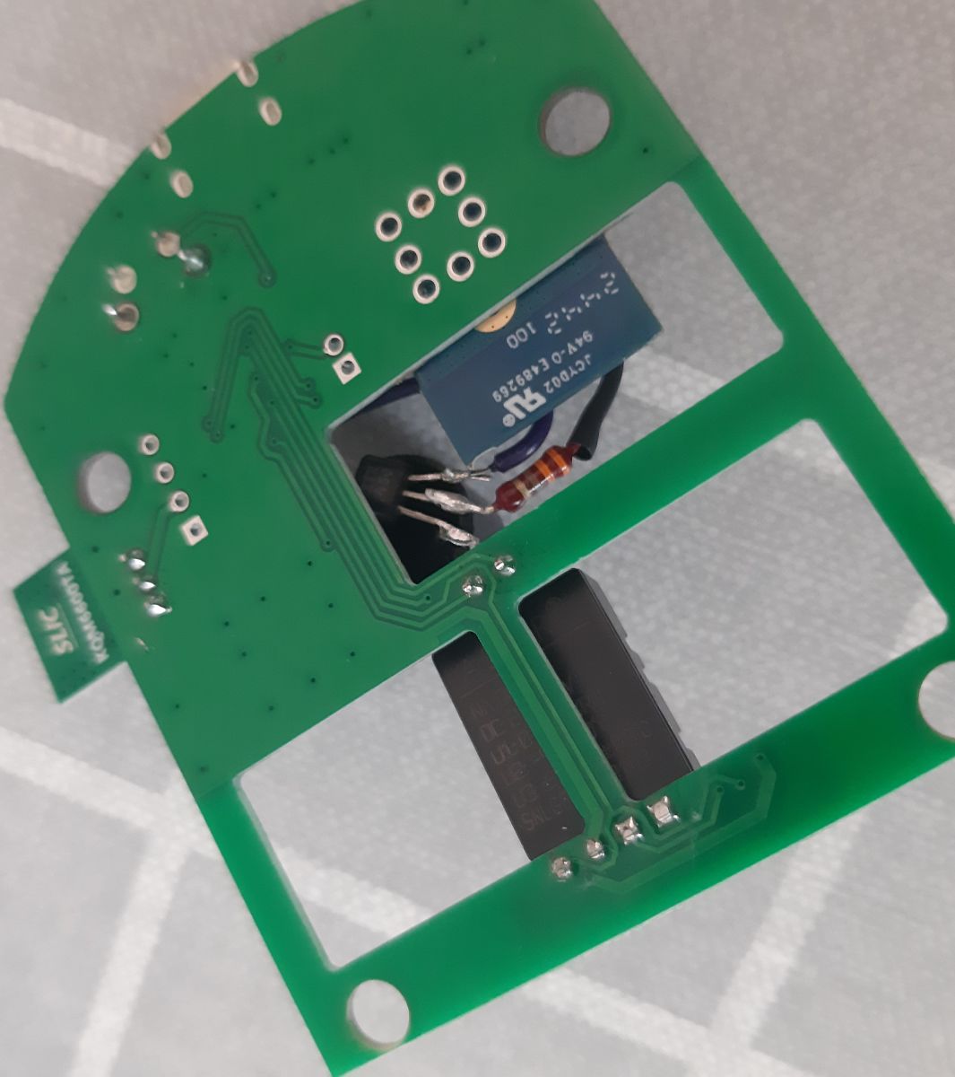

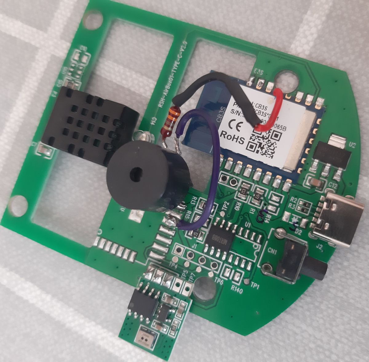

    For those who want to do the same: Don't connect the Buzzer directly to CB3S's IO-Pin. 35mA is too much for that. Use a simple "transitor as switch" circle instead, something like this:
    [BK7231N/CB3S] Tuya Smart Air Box Air Quality Monitor, 5 sensors
    You can take connections from here:
    Done! Not pretty, but working:
    The + Pin of the Buzzer is soldered to the 3,3V pin, the rest is "flying wiring"

    Probably the simplest way would be to create a loop and check every second. The channel indexes, values and condition in sample below should be adjusted.
    alias ALARM_ON setChannel 10 1
    alias ALARM_OFF setChannel 10 0
    again:
    delay_s 1
    if $CH4==0||$CH3>50||$CH2<10 then ALARM_ON else ALARM_OFF
    goto again
  • #30 21593801
    io2345
    Posts: 268
    Rate: 7
    >>21593616 It always takes a while for my brain to catch up with you. But after some thinking I guess that the block to add at the end of the autoexec.bat should be in my case:
    alias ALARM_ON setChannel 8 1
    alias ALARM_OFF setChannel 8 0
    again:
    delay_s 10
    if $CH1>550||$CH2>800||$CH3>50||$CH4>50||$CH5>700
    then ALARM_ON
    else ALARM_OFF
    goto again
    and I'll have to set P8 (PWM2) for example to type "Relay" and channel 8. Or isn't that necessary at all?

  • A working alarm add-on used CB3S P8 with a transistor switch, not a direct buzzer connection. The buzzer was rated 35 mA, and direct drive from the module pin was explicitly discouraged. [#21593564]
  • A practical self-recovery method used NTP plus addClockEvent 13:30:00 0x7F 1 reboot to force one reboot every day. That workaround targeted stuck values after power outages. [#21816233]
  • The thread identified two onboard sensors: a DHT20 for temperature and humidity, and an HMNST HGS1000 gas sensor module. OpenBeken support was clear for DHT20, but not for HGS1000 direct integration. [#21177061]
How do I make a Tuya Smart Air Box with BK7231N/CB3S show temperature, humidity, CH2O, VOC, and CO2 correctly in OpenBeken?
Use TuyaMCU, map the five dpIDs, and send a state query at boot. 1. Start TuyaMCU, set Wi‑Fi state 4, and baud 9600. 2. Link dpIDs 18, 19, 2, 21, 22 to channels for temperature, humidity, CH2O, VOC, and CO2. 3. Add tuyaMcu_sendQueryState to autoexec.bat so values appear after power-up, not only after a manual command. [#21169869]
Why does this Tuya Air Box only start showing sensor values after I run tuyaMcu_sendQueryState in OpenBeken?
Because this device does not reliably push its current TuyaMCU states to OpenBeken on its own at boot. The manual command forces the MCU to return the active dpID values, and that immediately populated all five readings in the log and UI. After each restart, the same query was needed until it was added to autoexec.bat. [#21169864]
What should a working autoexec.bat look like for the Tuya Smart Air Box Air Quality Monitor with dpIDs 2, 18, 19, 21, and 22?
A working file starts TuyaMCU, sets Wi‑Fi state 4, sets baud 9600, maps dpIDs 18/19/2/21/22 to channels 1–5, and ends with tuyaMcu_sendQueryState. Channel 1 is Temperature_div10, channel 2 is Humidity_div10, and channels 3 to 5 are custom labels for CH2O, VOC, and CO2. That exact layout was confirmed to work on July 27, 2024. [#21169869]
Which TuyaMCU settings matter most on this device, such as tuyaMcu_defWiFiState 4 and tuyaMcu_setBaudRate 9600?
The two key settings are tuyaMcu_defWiFiState 4 and tuyaMcu_setBaudRate 9600. On this Air Box, 9600 matched the working serial link, while Wi‑Fi state 4 was recommended during troubleshooting under startDriver TuyaMCU. These settings alone were not enough, but they were part of the final working configuration. [#21169842]

How can I add a buzzer alarm to an unused CB3S pin like P8 and trigger it when temperature, humidity, CH2O, VOC, or CO2 exceed thresholds?
Use a transistor-switched buzzer on P8 and control it from a linked OpenBeken channel. 1. Assign P8 to channel 8 and set its role to Relay, Rel_n, LED, or LED_n. 2. Add alias ALARM_ON setChannel 8 1 and alias ALARM_OFF setChannel 8 0. 3. Run a loop such as if $CH1>580||$CH6>890||$CH3>50||$CH4>200||$CH5>1200 then ALARM_ON else ALARM_OFF. Do not drive a 35 mA buzzer directly from the CB3S pin. [#21595628]

What sensors are inside the Tuya Smart Air Box, and how were the DHT20 and HMNST HGS1000 identified in the thread?
The thread identified a DHT20 for temperature and humidity and an HMNST HGS1000 gas sensor module. The DHT20 was confirmed by a board photo on July 30, 2024, and the HGS1000 name later came from HMNST contact confirmation shared on July 31, 2024. OpenBeken support was described as straightforward for DHT20, while HGS1000 protocol support was not available. [#21174757]
