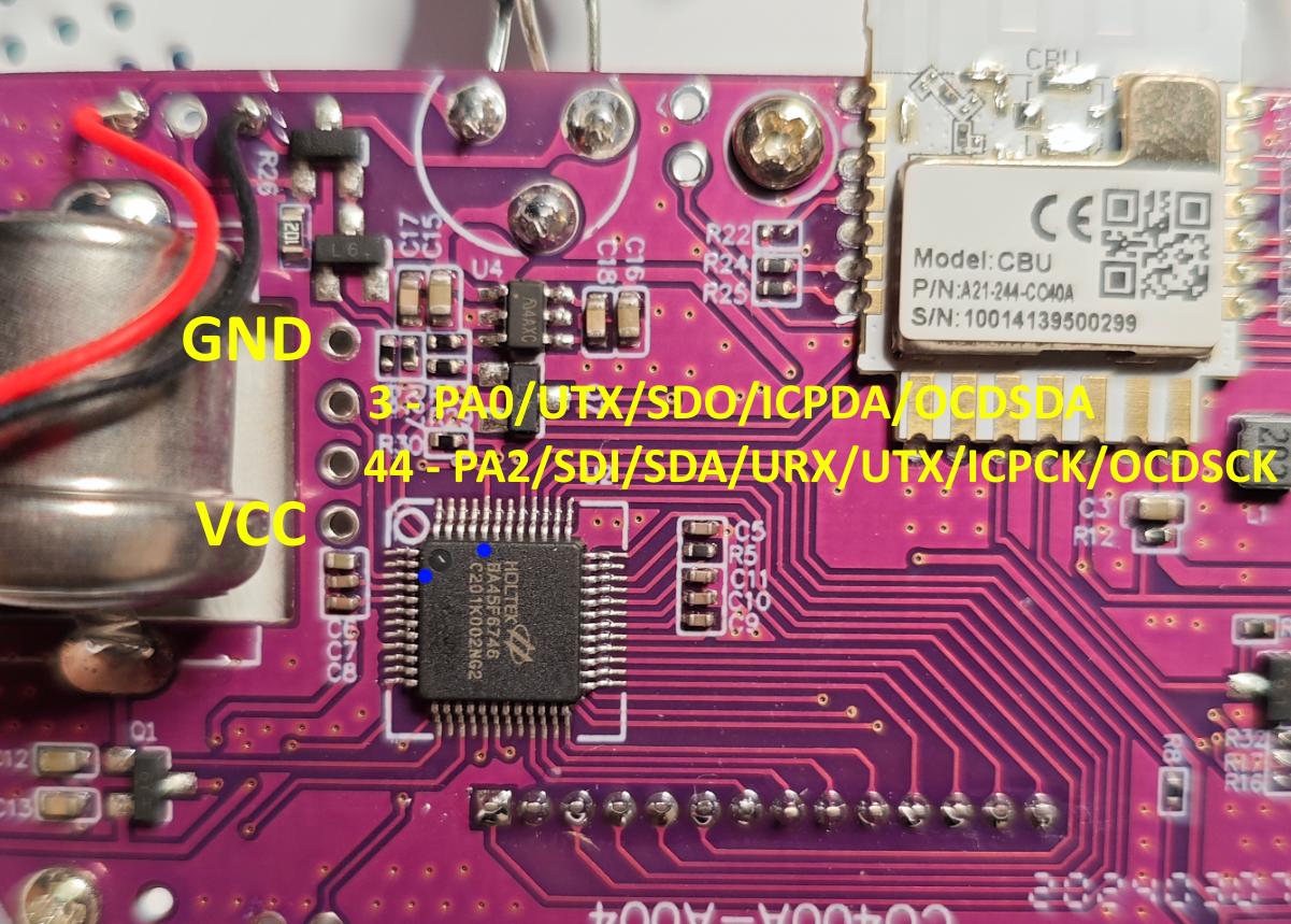

How can I configure a BK7231N-based Tuya CO400A-A004 carbon monoxide detector in OpenBeken, including its GPIO and UART mapping?
This device is not a plain TuyaMCU setup; the BK7231N CBU only handles a few GPIOs while the CO sensing and LCD are handled by a Holtek BA45F6746 over UART, so OpenBeken needs the serial link plus the traced pins rather than a simple TuyaMCU template [#21267322] The traced pins are P24 = side button, P26 = fire alarm active, P6 = blue status LED, P20 = battery relay, and P23 = battery ADC, while the big front test button and the remaining LEDs are on the Holtek side [#21267322] The UART between CBU and Holtek is at 9600 baud, and the working command the CBU sends to read the current state is `00 55 07 03 01 00 00 60`, repeated three times; the reply frame begins `AA 13 ...` and the CO value is in the byte at index 10 (for example `0xA8 = 168 ppm`), with byte 11 indicating alarm/fault and byte 8 needing to change so updates are accepted [#21267895][#21268258][#21353854] The device sleeps for long periods and wakes on alarm/test, so captures are easiest right after boot/reset or during the test-button sequence [#21353854][#21356890] No complete OpenBeken driver was posted in the thread, so the practical path is to wire RX1/TX1 to the Holtek, set UART to 9600, and build the configuration from those pin and frame observations [#21267322][#21356890]

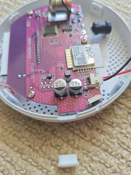

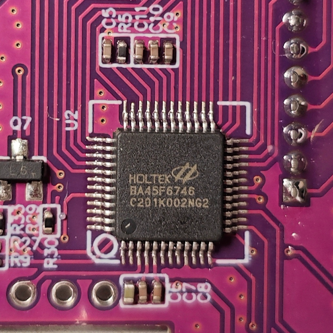

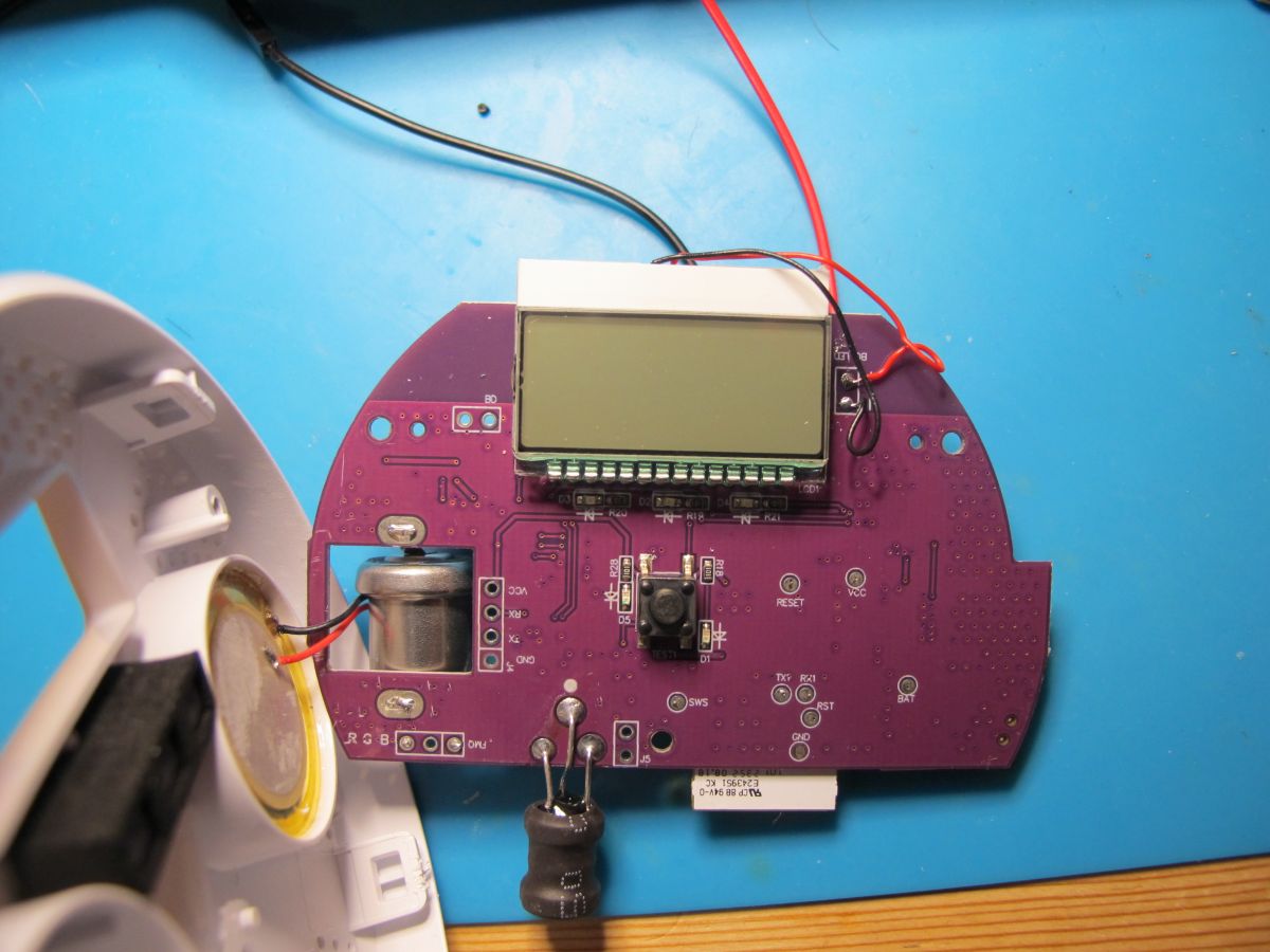

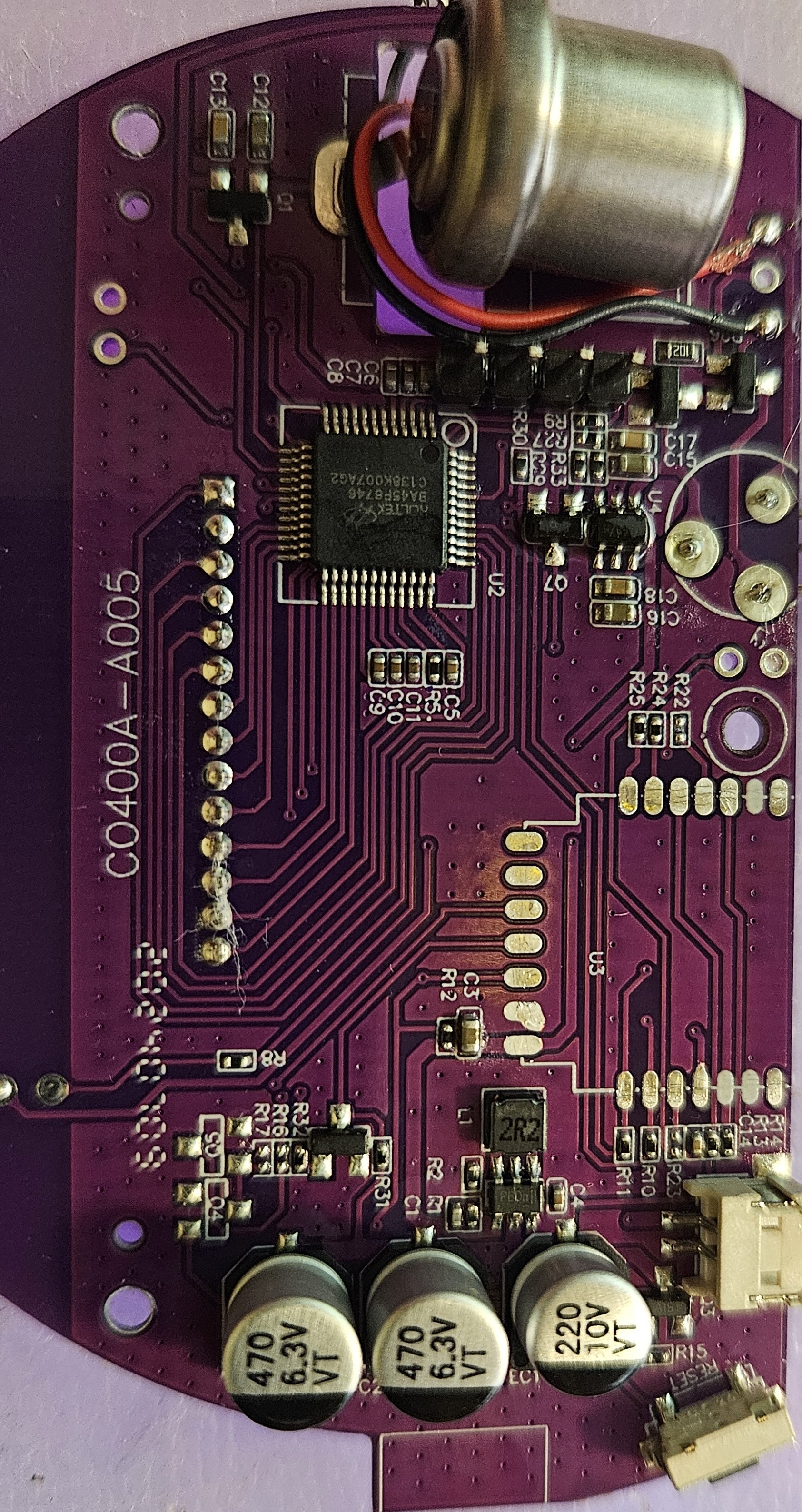

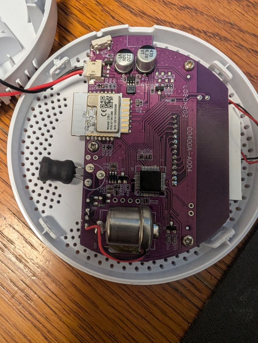

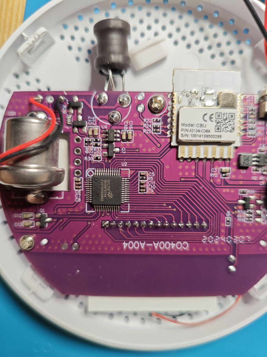

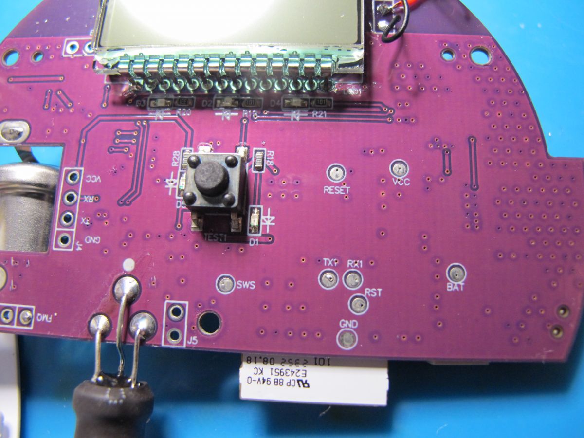

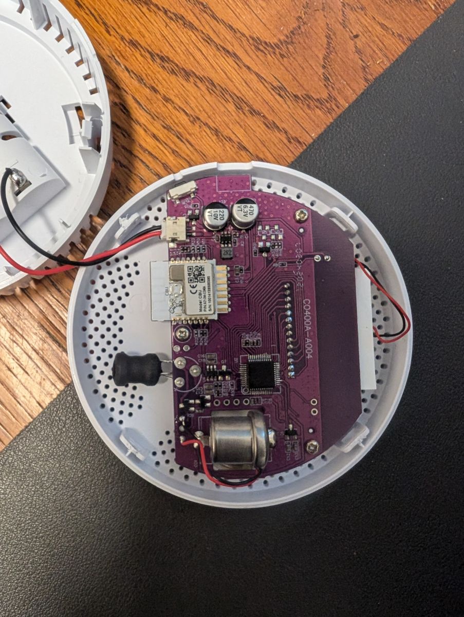

    I just got a Carbon Monoxide Detector from AliExpress and wanted to free this thing from the cloud.
    Basic Information:
    Brand: Tuya?
    Model: CO400A-A004
    Chip: BK7231N (CBU)
    Local vendor: AliExpress
    Teardown Photos:
    Interior of a carbon monoxide detector with visible PCB board. Interior of a carbon monoxide detector with visible electronic components. Packaging of the Tuya WiFi carbon monoxide detector.
    i already flashed OpenBeken on the device since i did this for my smoke detectors i also ordered before, which had the same chip. But now i'm stuck configuring the device (pin setup) to use it with Homeassistant.

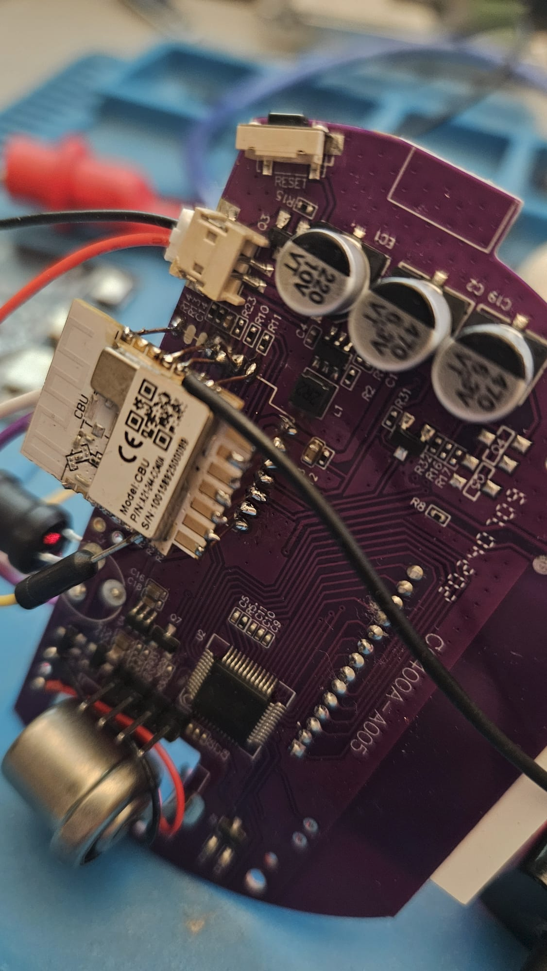

    I would have to have better board pictures to figure that out. Sorry for now I have no idea.

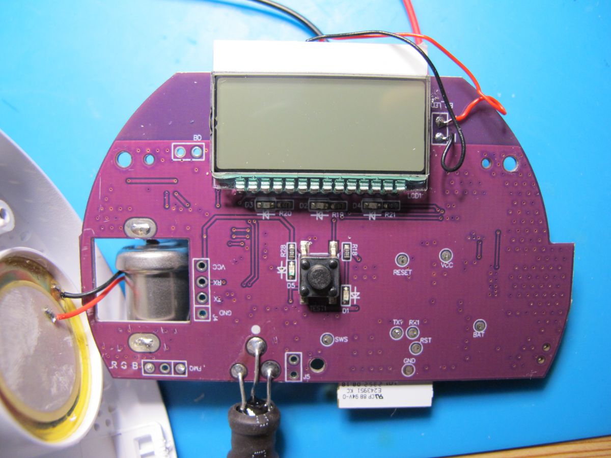

    I will try to make some better pictures tomorrow. I can also check the traces with the multimeter but as far as I can remember I did a little probing on the board today and the CBU RX2/TX2 pins are connected to the chip on the bottom right on the picture.

    Hi. I bought one a few months ago but never got round to looking at it.

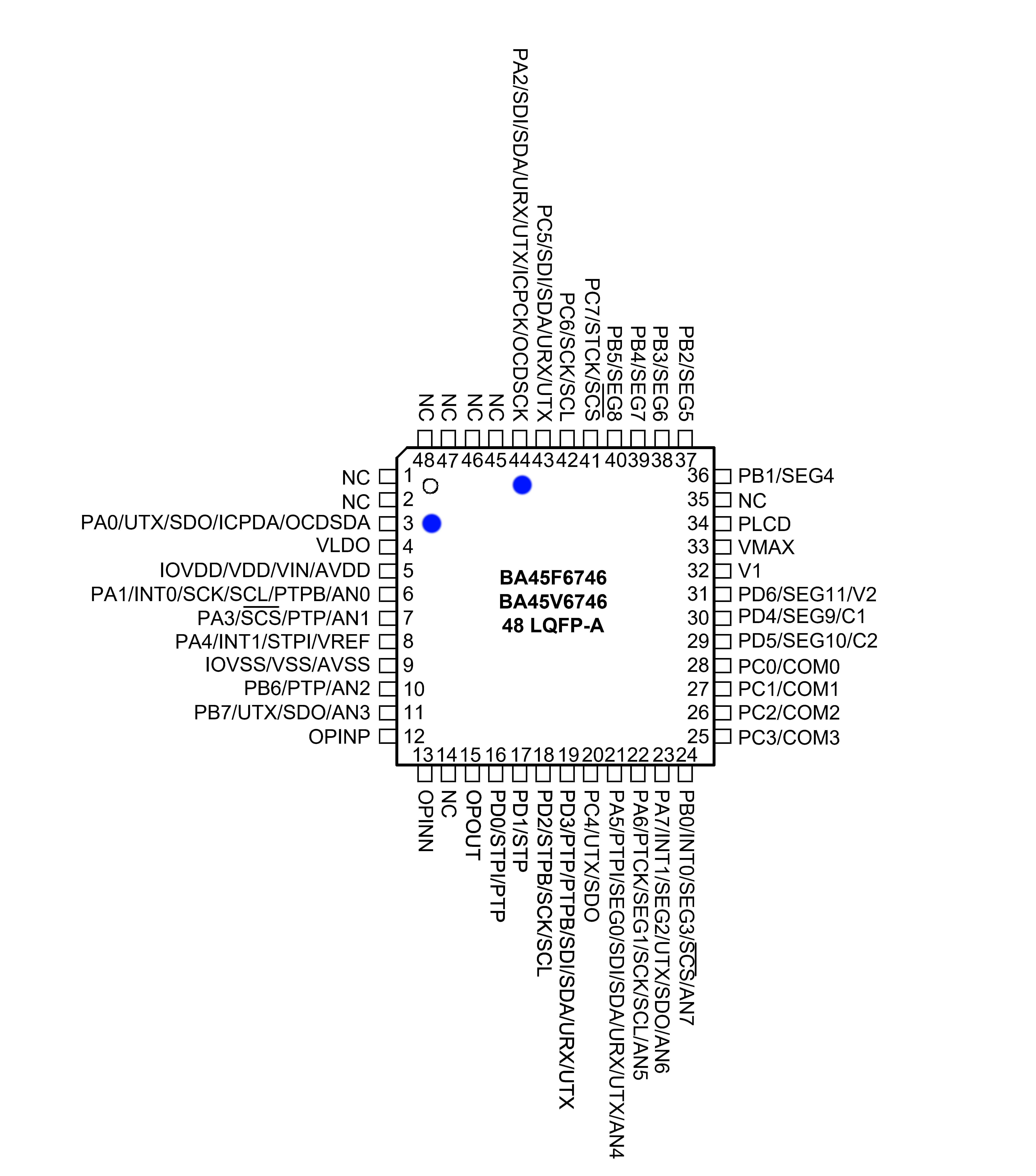

    That 48 pin chip is a Holtek BA45F6746
    Close-up of a 48-pin Holtek BA45F6746 chip on a circuit board. Close-up of a circuit board with a Holtek BA45F6746 chip and other electronic components.
    https://www.holtek.com/page/vg/BA45F6746
    in this device, in part, to drive the LCD on the front one assumes.
    WiFi carbon monoxide detector with LCD display.
    The fw version, 1.0.2, is not patched. A cloudcutter profile was added in April for it.
    Added after 3 [minutes]:
    looks like you got the battery-only version like me. Mine has a white rubber stopper where the USB connector would have gone.
    Image of the interior of a gas detector showing the circuit board and components.
    Added after 1 [hours] 3 [minutes]:
    Close-up of a circuit board with Holtek BA45F6746 chip and yellow labels for GND, VCC. Pin diagram of the 48-pin Holtek BA45F6746 chip.
    • BA45F6746v130.pdf (3.46 MB) You must be logged in to download this attachment.
  • #8 21266187
    Posts: 5236
    Help: 450
    Rate: 919
    ha. should have checked underneath first re test pads
    Close-up of a purple printed circuit board with an LCD display and a test button. Close-up of a circuit board with an LCD screen and various electronic components. Printed circuit board with an LCD display and other electronic components.
  • Tuya MCU test button sends noisy serial data
    #9 21266214
    sofaking
    Posts: 6
    when I press the test button (center front of the device) I get this output in the log
    Info:TuyaMCU:Consumed 121 unwanted non-header byte in Tuya MCU buffer
    Info:TuyaMCU:Skipped data (part) 00 00 F8 00 FE 00 FE 00 FE 00 FE 00 00 F8 00 00 00 E0 00 00 00 E0 00 FE 00 00 00 E0 00 FE 00 FE 00 00 00 E0 00 00 00 00 00 00 00 00 00 00 80 00 FE 00 00 00 00 00 00 00 FE 00 00 00 00 00 00 00 00 F8 00 00 F8 00 FE 00 00 F8 00 00 00 00 00 00 00 00 00 00 80
    Info:TuyaMCU:Consumed 62 unwanted non-header byte in Tuya MCU buffer
    Info:TuyaMCU:Skipped data (part) 00 FE 00 FE 00 FE 00 00 F8 00 00 F8 00 00 00 00 00 00 00 00 00 00 80 00 FE 00 00 00 00 00 00 00 00 F8 00 FE 00 00 00 00 00 00 00 00 F8 00 FE 00 FE 00 FE 00 FE 00 FE 00 FE 00 00 F8 00 FE
    ExtraDebug:TuyaMCU:TuyaMCU heartbeat_valid = 0, product_information_valid=0, self_processing_mode = 1, wifi_state_valid = 0, wifi_state_timer=0
    Info:TuyaMCU:Consumed 183 unwanted non-header byte in Tuya MCU buffer
    i also probed the connections now.
    BA45F6746 PIN19 is connected to TX1 on the CBU
    BA45F6746 PIN20 is connected to RX1 on the CBU
  • Stock firmware DPID mapping for CO400A-A004

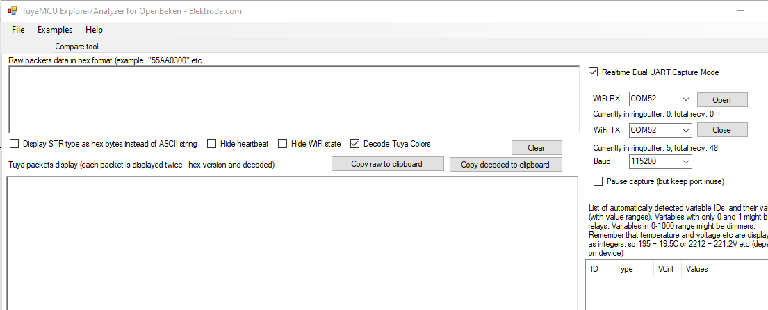

  • No TuyaMCU communication detected over RX/TX
    #13 21267382
    Posts: 5236
    Help: 450
    Rate: 919

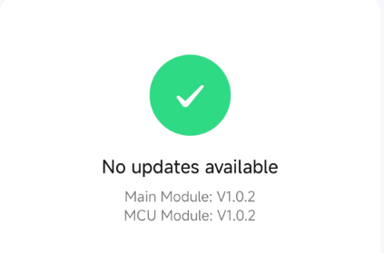

    piotrszulc1 wrote:
    I don't think it's tuya-mcu
    indeed. TuyaMCU devices usually (always?) have a different MCU version number to the Main Module version in the app when paired. No TuyaMCU = same version listed for both.
    Screen indicating no updates available, showing the main module and MCU module version as V1.0.2.
    the question is, is the MCU talking to the CBU over RX/TX at all?
    Added after 6 [minutes]:
    certainly no TuyaMCU analyser hits
    TuyaMCU Explorer/Analyzer program interface with options for analyzing data in hex format.
  • #14 21267461

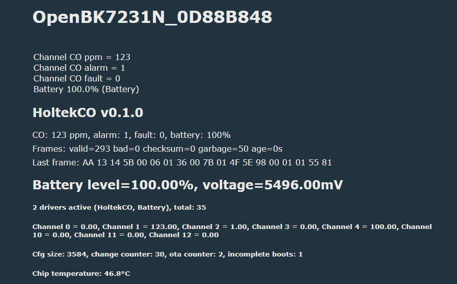

    so i'm back on OpenBeken after this debugging session and had success with doing the following
    1) added  autoexec.bat with the following content (not sure if the uartSendHex is needed at this point)
    uartInit 9600
    uartSendHex 00 55 07 03 01 00 00 60 55 07 03 01 00 00 60 55 07 03 01 00 00 60
    2) went to log and sent the following command again
    then this happens on the OpenBeken log
    Debug:CMD:cmd [uartSendHex 00 55 07 03 01 00 00 60 55 07 03 01 00 00 60 55 07 03 01 00 00 60]
    Info:CMD:[WebApp Cmd 'uartSendHex 00 55 07 03 01 00 00 60 55 07 03 01 00 00 60 55 07 03 01 00 00 60' Result] OK
    Info:CMD:UART received:
    Info:CMD:UART received: AA 13 14 1B 00 07 01 36 00 00 00 04 5D 92 00 01 01 55 74
    Info:MAIN:Time 361, idle 184173/s, free 74792, MQTT 0(22), bWifi 1, secondsWithNoPing 291, socks 2/38
    Info:MAIN:Time 362, idle 188786/s, free 74792, MQTT 0(22), bWifi 1, secondsWithNoPing 292, socks 2/38
    Info:CMD:UART received: AA 13 15 1B 00 07 01 36 00 00 00 04 5C 92 00 01 01 55 74
    Info:MAIN:Time 363, idle 182937/s, free 74792, MQTT 0(22), bWifi 1, secondsWithNoPing 293, socks 2/38
    so this seems to be the command to read out the current CO value *yay*.

    Today I came across this topic by chance, in a separate here .
    have tried to understand the device a little.
    A lot of information is repeated, but maybe my findings will inspire someone.
    Below found commands sent by the MCU:

    edit2:
    I have added my images, with the soldered TuyaMCU, so that you can trace the paths plus my findings.
    edit3:
    I pressed test 3x in a row and watched the outputs. You can see that the UART to TuyaMCU is sending messages 6 times. This is only reported once in the log, and presumably an average is calculated from this.

    1. I disassembled the circuit and sent my commands instead of MCU messages:
    Close-up of a PCB with electronic components and a CBU connector. .
    2. I sent the same wo messages, in (almost) the same order, the change was due to the different behaviour of the application on the same commands.
    I started by resetting the device and playing around after the reboot:
    yesterday's results

  • #25 21752402
    stoatwblr
    Posts: 7
    >>21268258
    Where did you extract this table from? I can't find it on the Holtek website and what's sent is only 19 bytes.
    I'm assuming 0xAA is the start, 0x13 is the message length in bytes (19 bytes), as each message is only 19 bytes.

  • Tuya CO400A-A004 config and sensor test data
    #28 21911862
    Posts: 5236
    Help: 450
    Rate: 919
    >>21267322
    indeed
    from
    0xC9DA4
    in the decrypted uncrcd app partition:
    playing with a driver
    Screenshot of CO sensor and battery readouts: CO 123 ppm, alarm 1, battery 100%
    paper towel lit under sensor to get a reading, otherwise 0ppm
    https://github.com/divadiow/OpenBK7231T_App/tree/CO400A-A004
