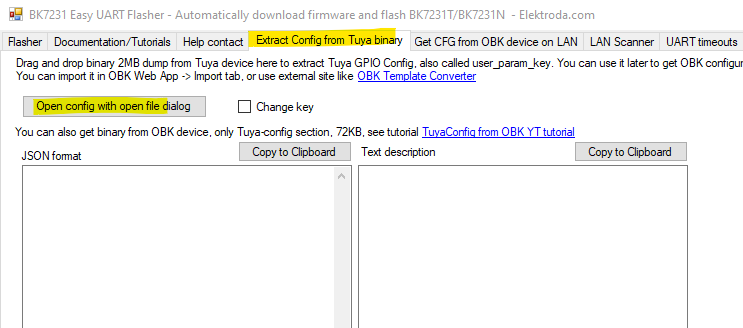

    does Easy Flasher (https://github.com/openshwprojects/BK7231GUIFlashTool/releases) extract any config if you run your backup through it?
    BK7231 Easy UART Flasher interface with Tuya config extraction tab selected

    just re-read and it's SurpLife, so not Tuya anyway - ie no config extraction

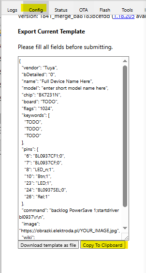

    paste the config, modifying any TODO with relevant info if you can, from the web application config tab:
    Screenshot of configuration tool interface with JSON form and copy button
    additionally, if you have a backup of the factory firmware please post that too. if you paired with SurpLife before the backup it may contain your wifi credentials, in which case you may not want to. Or send to me and I'll reset it and post anything interesting that my be gleaned from it.
