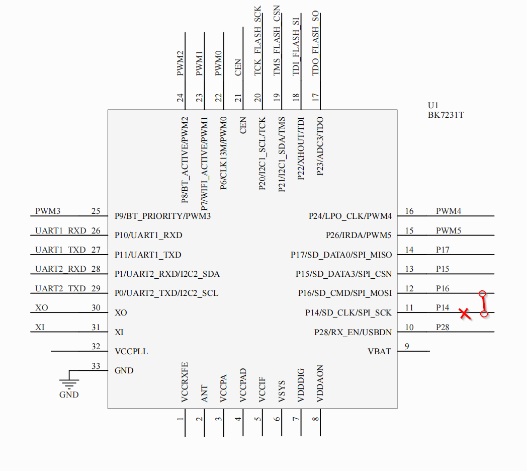

    LEDs can be only connected on P16, which is MOSI pin. This is because we're using SPI DMA driver to get precise timings.
    See our datasheet topic to locate P16:
    BK7231 datasheet, pinout, programming, specification, wiki (BK7231T, BK7231N)
    If your module has no P16 routed out, like a CB2S, you can always route it out yourself:
    How to access hardware SPI port on CB2S? P16 (MOSI) GPIO breakout method

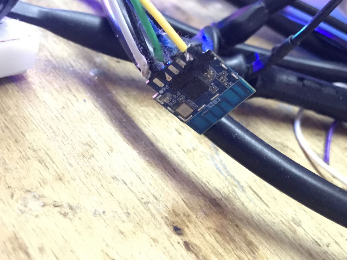

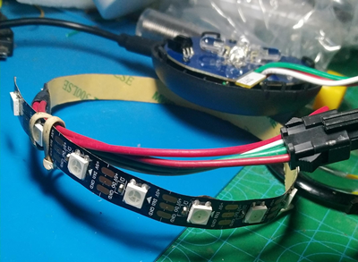

    I don't have any IoT device with individually adressable LEDs, so I just used a CB2S with routed out P16 pin (as in the guide which I mentioned earlier) with the WS2812B strip connected:
    LED strip with multicolored LEDs connected to a breadboard on a wooden table.
    Close-up of a breadboard with multicolored wires and electronic components connected. Close-up of an electronic module soldered to wires.

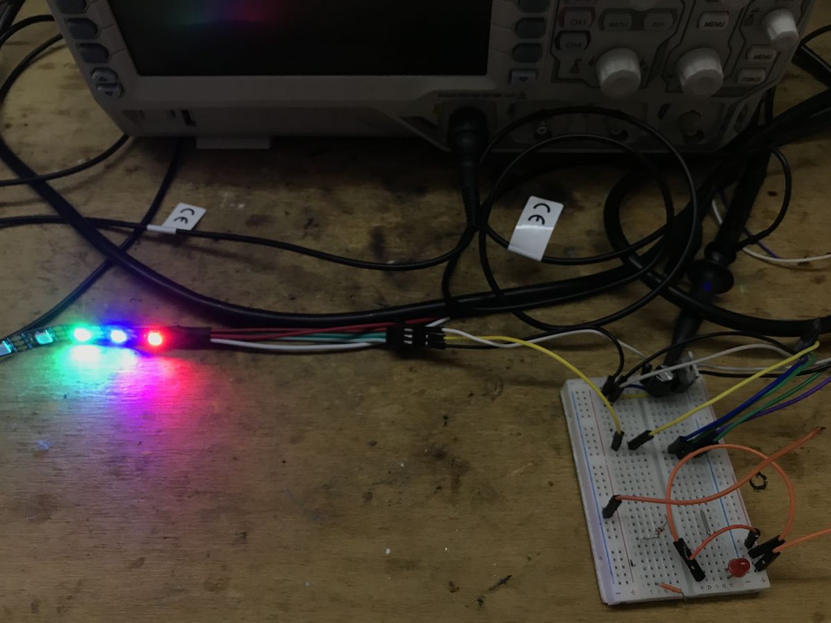

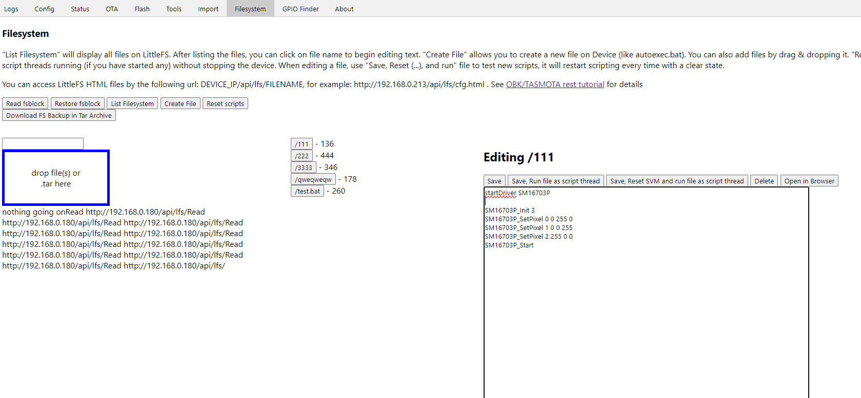

    Sample - RGB test
    Ok, so let's create a sample script. For now, we will just lit two LEDs, just to check if the strip is working. Here's how it looks like on my side:
    OpenBeken user interface with file editor and LED control scripts.
    Here's full script:
    startDriver SM16703P
    SM16703P_Init 3
    SM16703P_SetPixel 0 0 255 0
    SM16703P_SetPixel 1 0 0 255
    SM16703P_SetPixel 2 255 0 0
    SM16703P_Start
    The script is using SM16703P commands, but the same works for WS2812B. It's just that we have first developed SM16703P driver and then discovered that timings are also matching classic WS diodes.

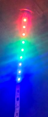

    Result:
    Test setup with LEDs in red, green, and blue on a workbench.

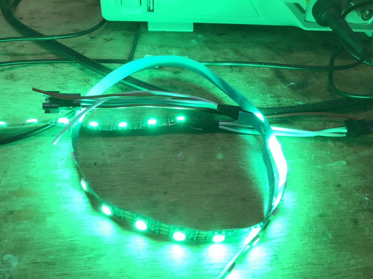

    Sample - Full strip Single Color
    For this example, we can set all the pixels to a single color. There are two ways to do it. First one is to use a loop:
    // number of LEDs
    setChannel 5 60
    // init
    SM16703P_Init $CH5
    // iteration variable
    setChannel 6 0
    // loop for each LEd
    again:
    SM16703P_SetPixel $CH6 0 255 0
    addChannel 6 1
    if $CH6<$CH5 then goto again
    // done
    SM16703P_Start

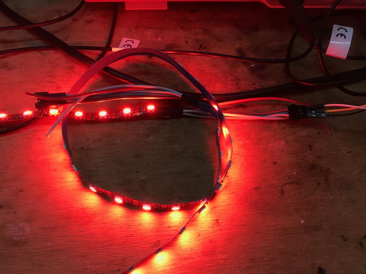

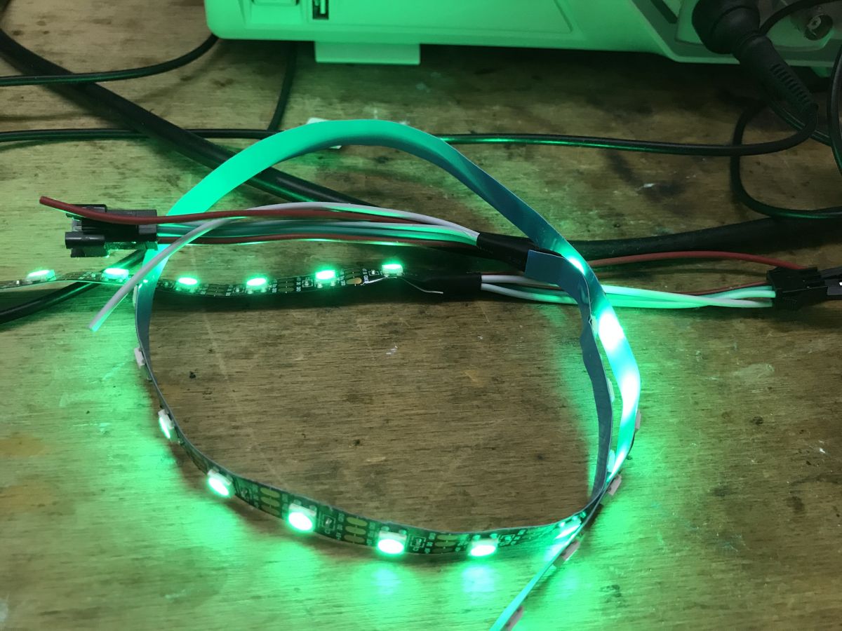

    Second way is much simpler - if you provide 'all' as pixel index, it will set all pixels:
    SM16703P_SetPixel all 0 255 0
    Result:
    Individually addressable LED strip glowing red on a table.

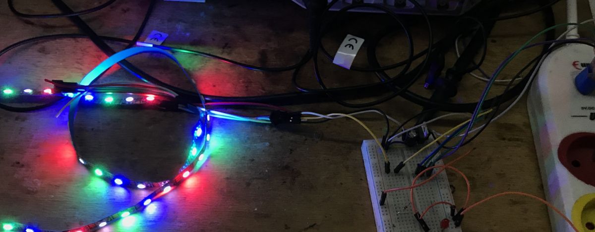

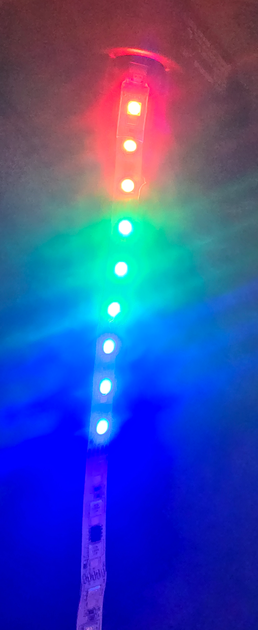

    Sample - Full strip RGB
    A simple loop can be also used to set RGB colors. First red, then green, then blue, but the order of colors can be different if your strip is, for example, GBR standard.
    // number of LEDs
    setChannel 5 60
    // init
    SM16703P_Init $CH5
    setChannel 6 0
    again:
    SM16703P_SetPixel $CH6 255 0 0
    SM16703P_SetPixel $CH6+1 0 255 0
    SM16703P_SetPixel $CH6+2 0 0 255
    addChannel 6 3
    // done
    SM16703P_Start

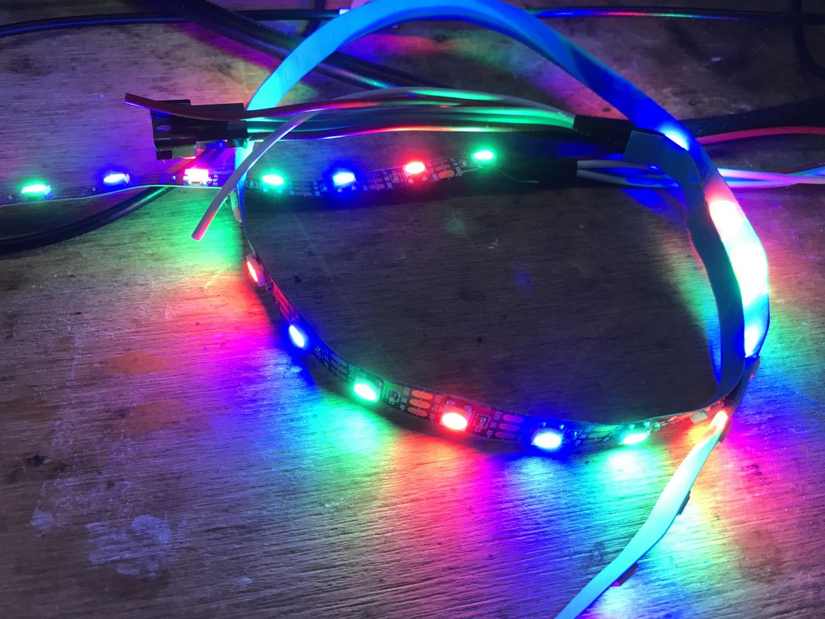

    Result:
    LED strip with multiple colorful lights on a wooden surface.
    Sample - Basic Dimmer
    setChannelType 1 Dimmer256
    // number of LEDs
    setChannel 5 60
    // init
    SM16703P_Init $CH5
    // on channel 1 dimmer change, refresh
    addEventHandler OnChannelChange 1 startScript autoexec.bat refresh
    // refresh function
    refresh:
    setChannel 6 0
    again:
    SM16703P_SetPixel $CH6 $CH1 0 0
    addChannel 6 1
    // done
    SM16703P_Start

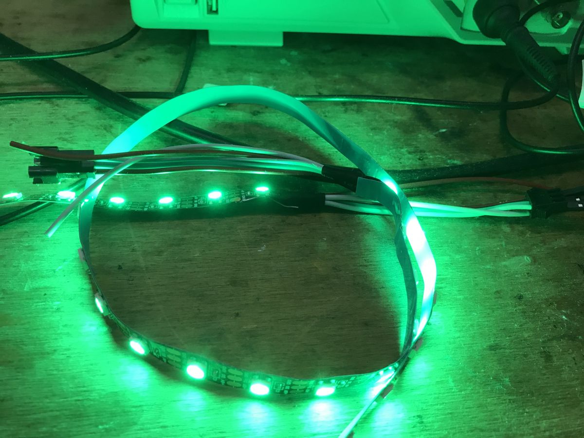

    OBK web panel (ignore the DDP for now):
    OpenBekenX screen displaying packets and system settings
    Effects while playing around with dimmer:
    LED strip with green-lit LEDs connected to a device. LED strip glowing green with connected wires. Green LED strip connected to a device on a wooden table. Illuminated LED strip on a wooden table with connected wires.

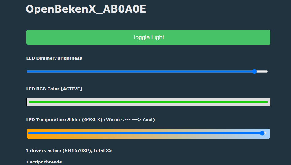

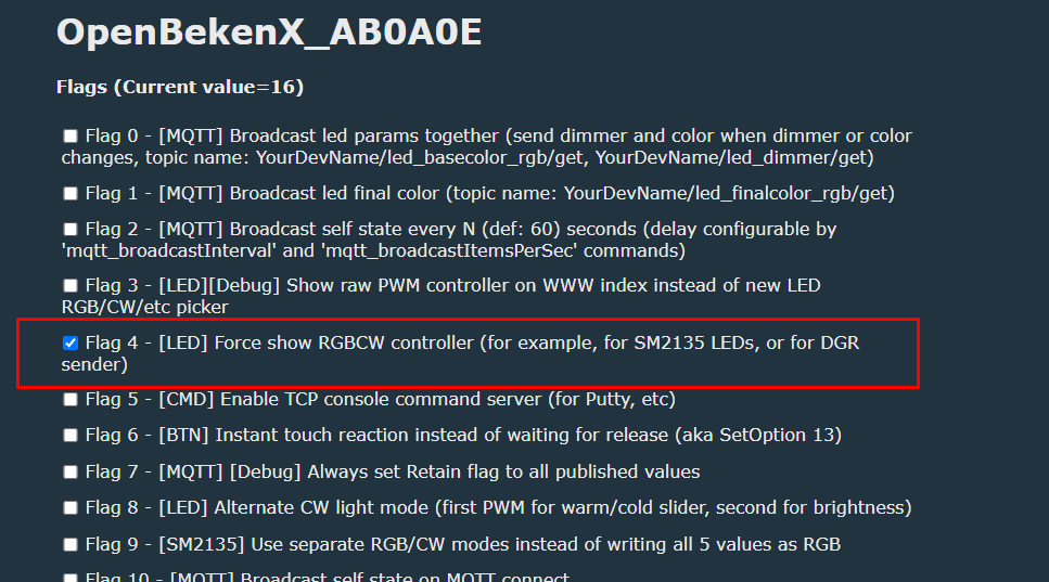

    Class LED controller (single color only)
    Another interesting possibility is 'hacking' the OBK script to control LEDs with old OBK single-color LED interface. For that, you need to enable the following flag:
    Screenshot of OpenBekenX settings with Flag 4 option highlighted regarding RGBCW controller.
    Then, add the following script:
    SM16703P_Init 60
    again:
    SM16703P_SetPixel all $led_enableAll*$led_red*$led_dimmer/255 $led_enableAll*$led_green*$led_dimmer/255 $led_enableAll*$led_blue*$led_dimmer/255
    SM16703P_Start
    delay_s 1
    goto again

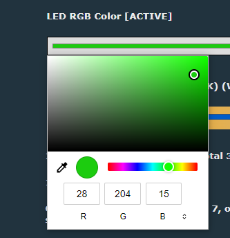

    This will make OBK panel able to control the LEDs:
    Interface for managing LED lighting settings on the OpenBekenX platform.
    Everything except CW controls will work, even the dimmer and color picker:
    RGB color palette with selected green color.

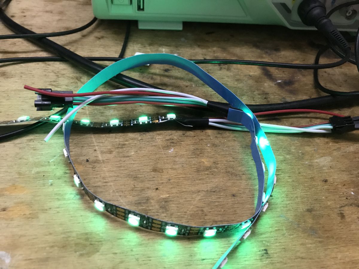

    Raw access
    It is also possible to send raw bytes stream via command. The bytes are sent directly, without converting to colors. This can be done via SM16703P_SetRaw command with the following syntax:
    SM16703P_SetRaw bUpdateAfterSet firstByte hexData
    Here is example usage:
    SM16703P_SetRaw 1 0 FF000000FF000000FF
    This will set first 3 LEDs to green, red and blue on WS2812B.

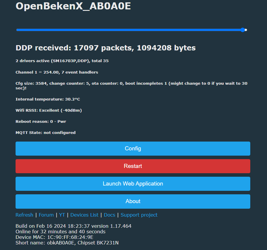

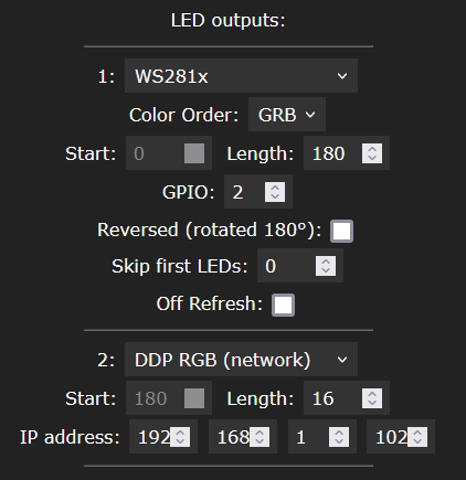

    Xlights control

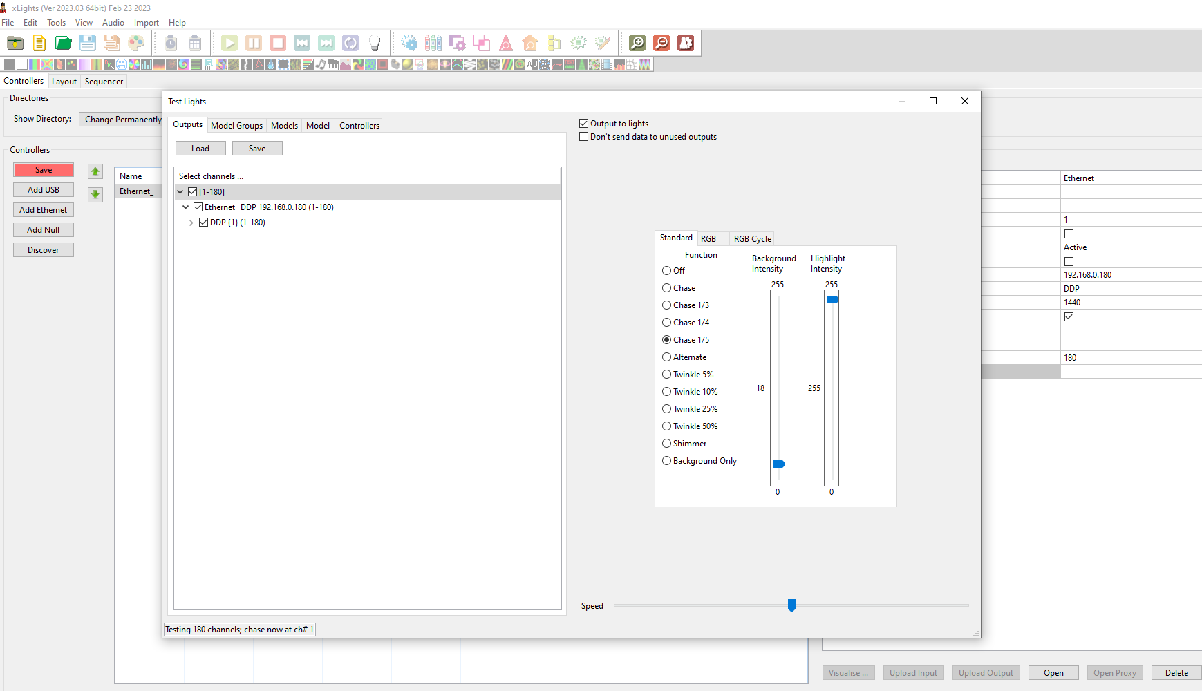

    It is also possible to control LEDs via DDP protocol. Many applications like XLights can be used for that purpose:
    Screenshot of the xLights interface with RGB light settings.
    Required setup on OBK side is minimal:
    startDriver DDP
    SM16703P_Init 60
    Here are some sample effects made by DDP:

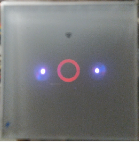

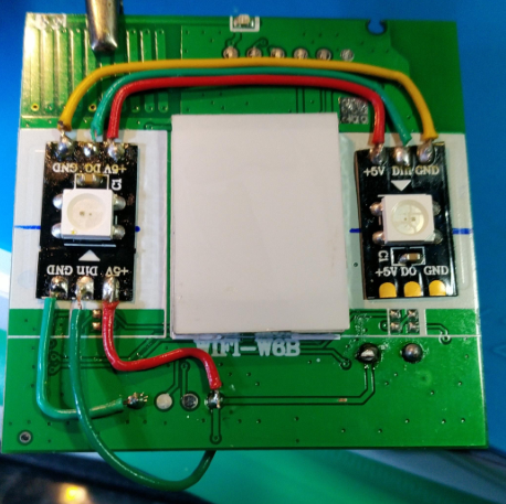

    I have requirement to be able to add a couple of WS2812B LEDs in to a Smart Wall Switch to be used as a Status Indicator Panel.
    Here is what I have done with a ESP8285 based switch and this works great. I am sending the LED commands via MQTT. Different color combinations for different statuses.
    Smart wall switch with LEDs in different colors. Printed circuit board with connected WS2812B LEDs and wires.

    It should be possible right now with the current scripting system.
    The only question would be does your light switches have P16 available?
    Otherwise you'll have to do the P16 hack I described here:
  • #5 20966577
    Posts: 14770
    Rate: 12911
    Hm okay, so please try doing that modification and we will try to add WS2812B LEDs to your wall switch.

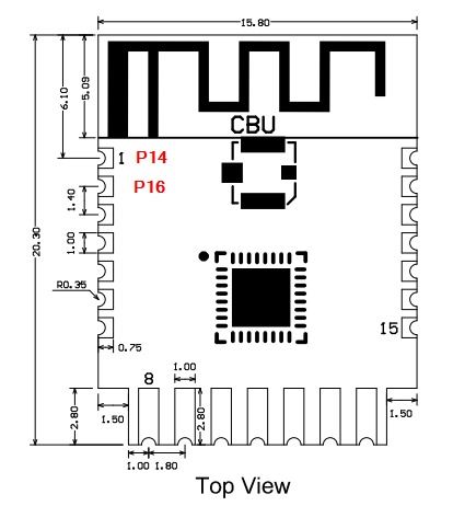

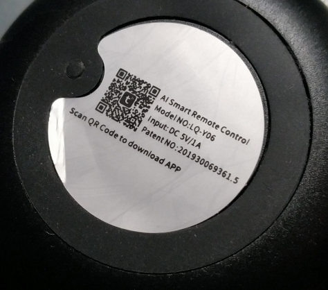

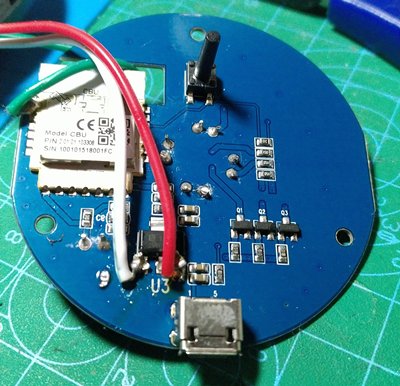

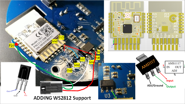

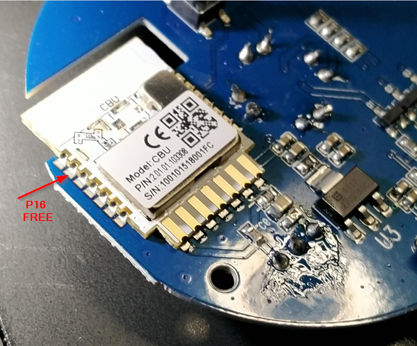

    The CBU based LQ-Y06 can be used as a LED Controller as well:
    Information sticker on AI Smart Remote Control Model LQ-Y06 with a QR code.
    Close-up of a circuit board with LEDs and technical markings.
    Top view of the LQ-Y06 module with labels P14, P16 and the inscription CBU.
    CBU module on a round electronic board with P16 FREE marking.
  • #7 20966716
    Posts: 14770
    Rate: 12911
    Sure, just route out the P16 and the ground. Then you can use external 5V power supply to power the LEDs. Connect all grounds together (don't forget, common ground is required), then P16 to the DIN of WS2812B strip and you can use this device as a LEDs controller.

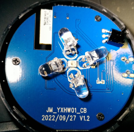

    @bjoerns how that Battletron Lamp is organized, how many LEDs? I would like to help you with creating a final config for that. I am also still planning to add advanced animations system to OpenBeken. Hopefully, soon OBK will be able to control those LEDs without any prior scripting and setup.
  • Two WS2811 controllers limit lamp to two zones
    #10 20967277
    bjoerns
    Posts: 7
    The Battletron lamp uses two WS2811c Controller. One is controlling the nine LED's around the base, the second one powers the six LED's on the top.
    You can only control these two groups indiviual not the single LED's. So there is no chance of with very sophisticated effects etc. The only thing you could dow is something like a two tone effect.

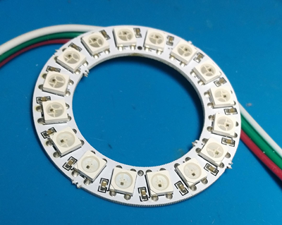

    I tried to repeat my test from last year with WS2812B strip and came up with this slightly modified script:
    // Channel for number of LEDs
    setChannel 5 16
    // init
    SM16703P_Init $CH5
    // Iteration Channel
    setChannel 10 1
    again:
    echo "1: $CH10"
    // Add 1 to Channel 10 with clamping between 0 to 15 and looping back to 0
    addChannel 10 1 0 15 1
    //                                         R B G
    //                                         R G B
    SM16703P_SetPixel $CH10 255 0 0
    SM16703P_Start
    delay_s 2
    SM16703P_SetPixel $CH10 0 0 0
    // loop for each LED
    goto again
    Basically I am looping a single dot across 16 x LEDs.
    I have been getting inconsistant results and have been scratching my head.
    LEDs 0,1,2 gets lit up correctly.
    Next LEDs 3 & 4 both get lit up at the same time
    Next LEDs 5 to 16 get lit up correctly
    Then I found that in the raw data log that 4 x bytes are being sent instead of 3 x bytes :
    Info:GEN:CHANNEL_Set channel 10 has changed to 6 (flags 0)
    Info:CMD:Set Pixel 6 to R 255 G 0 B 0
    Info:CMD:Raw Data 0xee 0xee 0xee 0xee - 0x88 0x88 0x88 0x88 - 0x88 0x88 0x88 0x88
    Error:CMD:before enable tx 0x0000c20c
    Error:CMD:enable tx 0x0000c20d
    Info:MAIN:Time 43, idle 376416/s, free 75088, MQTT 0(2), bWifi 1, secondsWithNoPing -1, socks 2/38
    Info:CMD:Set Pixel 6 to R 0 G 0 B 0
    Info:CMD:Raw Data 0x88 0x88 0x88 0x88 - 0x88 0x88 0x88 0x88 - 0x88 0x88 0x88 0x88
    Info:CMD:"1: $CH10"
    Info:GEN:CHANNEL_AddClamped channel 10 has changed to 7
    Can this be corrected?

    I tried a normal WS2812B strip and also a WS2812B Ring.
    Same observation of LED 0,1,2 (2 lighting up very briefly) and then 3 & 4 getting lit at the same time and then 5 ...
    Close-up of a flexible WS2812B LED strip arranged in an arc on a blue work mat with attached wires.
    WS2812B LED ring with colored wires.

  • Continuous tx enable errors on CBU module
    #15 20967634
    jkwim
    Posts: 186
    Rate: 25
    Tried your script on both versions of LEDs. Same issue is there.
    Changed power supply also (I did the latest test plugging in to laptop USB port) just to eliminate one more variable.
    If there was transient data corruption issue it would not be the same two LEDs no.
    I am really confused. Perhaps something with the CBU module in this HW.

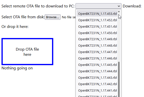

    The issue was with having the wrong version of FW.
    I was expecting to download the latest version and picked the topmost item which was actually 451 on that day (I have ignored the fact that the scroll bar was at the bottom not at the top).
    Screenshot of the software update interface with a drop-down menu of OTA file versions.
    When I looked at config page today suddenly I realized that the latest version is 469.
    Upgraded to 469 and all my issues were gone!
    Even the inconsistent color values are now good.

    After removing the delay statement from the loop this is the max speed that can be observed.
    My setup: Modifying CBU based LQ-Y06 IR Remote Controller to Support WS2812D LED Strip/Ring
    Sticker with information about AI Smart Remote Control on a black surface.
    CBU module on a blue PCB with P16 FREE label
    Close-up of a circuit board modification for WS2812 LED support.
    A circuit board with electronic components, including a Wi-Fi module and wires.

    So I also can confirm that WS2812B support is good to go now.

    Added after 2 [hours] 13 [minutes]:
    DDP Test Successful
    Setup:
    I have a 180LED WLED (https://kno.wled.ge/) setup.
    Defined OpenBK device as 16 LED Length DDP string
    Screenshot showing LED output configuration settings for WS281x and DDP RGB.
    So now WLED will consider these extra 16LEDs as an extension to its physically connected LED string.
    Patterns will be displayed considering a total of 196 LEDs (180 + 16).
    Here are some sample videos. I have the WLED string wrapped on a tube. There is no physical connection from the last LED there. The pattern continues on the Ring which is the DDP string.
    (Note that there is a small issue with my setup in color mapping as a result of mixing RGB and GRB strings.)
    As you can see from the videos below, speed of LED response is not an issue.

    I had a quick test with my device.
    For all the suggested test - 3 leds are picked up instead of 1. For example the RGB test - it will show 3 reds, 3 greens and 3 blues.
    SM16703P_Init 3
    SM16703P_SetPixel 0 255 0 0
    SM16703P_SetPixel 1 0 255 0
    SM16703P_SetPixel 2 0 0 255
    SM16703P_Start
    LED strip with nine diodes displaying red, green, and blue colors.
    Please, @MnM1 , please, post device information when you report an issue. Is you strip SM16703P, the same as the other users tested? Or, by any chance, is your device using a different LED type? Do you have latest OBK version? Try disabling powersave and IR?
    EDIT: Wait a moment, @MnM1 - how your strip looks like? Are you really sure that's a bug what you are seeing? Doesn't your strip have 3 LEDs per LED driver? How did it work with Tuya?

    #28 20970046
    igfotfrank
    Posts: 17
    It has 2 Pwm pins for the white led (brightness/temperatur) and i configured one pin for the sm16703p.
    Rgb led and white leds are seperate and they work together.
    In the moment i have set Flag4 for color selection and in the autoexe.bat i have set the pixel in a loop with the led_red, led_green, led_blue variables.
    The selection works but if i toggle the button or i set the led temperatur or brightness. Both the white led's and rgb led's are on at the same time.
    I like to have a button toggle the white or the rgb leds.
  • Need separate toggle for white and rgb LEDs
