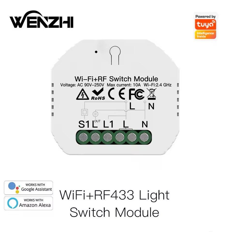

    I recently bought one of these "Wifi+RF switch modules", hoping it would be hackable with OpenBeken.
    https://de.aliexpress.com/item/1005003973194673.html
    WiFi+RF433 light switch module by Wenzhi with ports and connection labels
    I opened it and found a WB2S board inside, which seems to be well supported by OpenBeken. So I soldered a few wires to VBAT, GND, RX1 and TX1 and was able to connect to the device with a USB TTL adapter. As a power supply I'm using a USB DC-DC converter. Using the BK7231GUIFlashTool v148 (running on Fedora 42 with Mono), I was able to backup the existing firmware, and erasing the flash memory (starting at 0x11000) also worked fine. But as soon as I try to write the OpenBK7231T firmware image, I get an error. The logs say:

    OK, apparently the problem is the serial port speed! Interestingly it wouldn't work with 115,200 Baud, but the error goes away when I set it to 230,400 Baud. I thought lower speeds would be more reliable than higher ones, but apparently not in this case. The CRC check was also successful, so I'm going to assume it worked.
