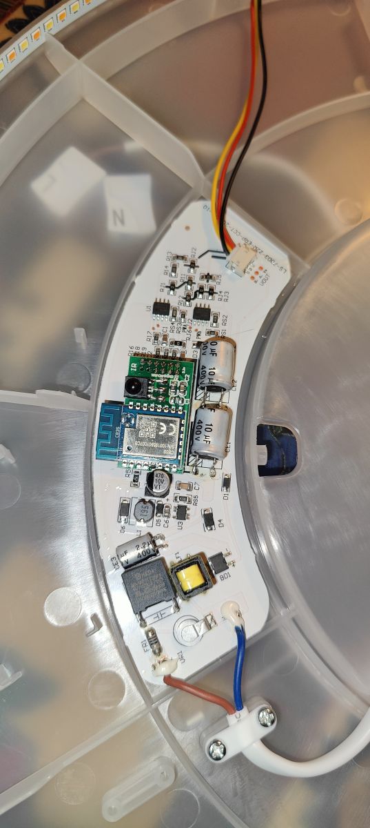

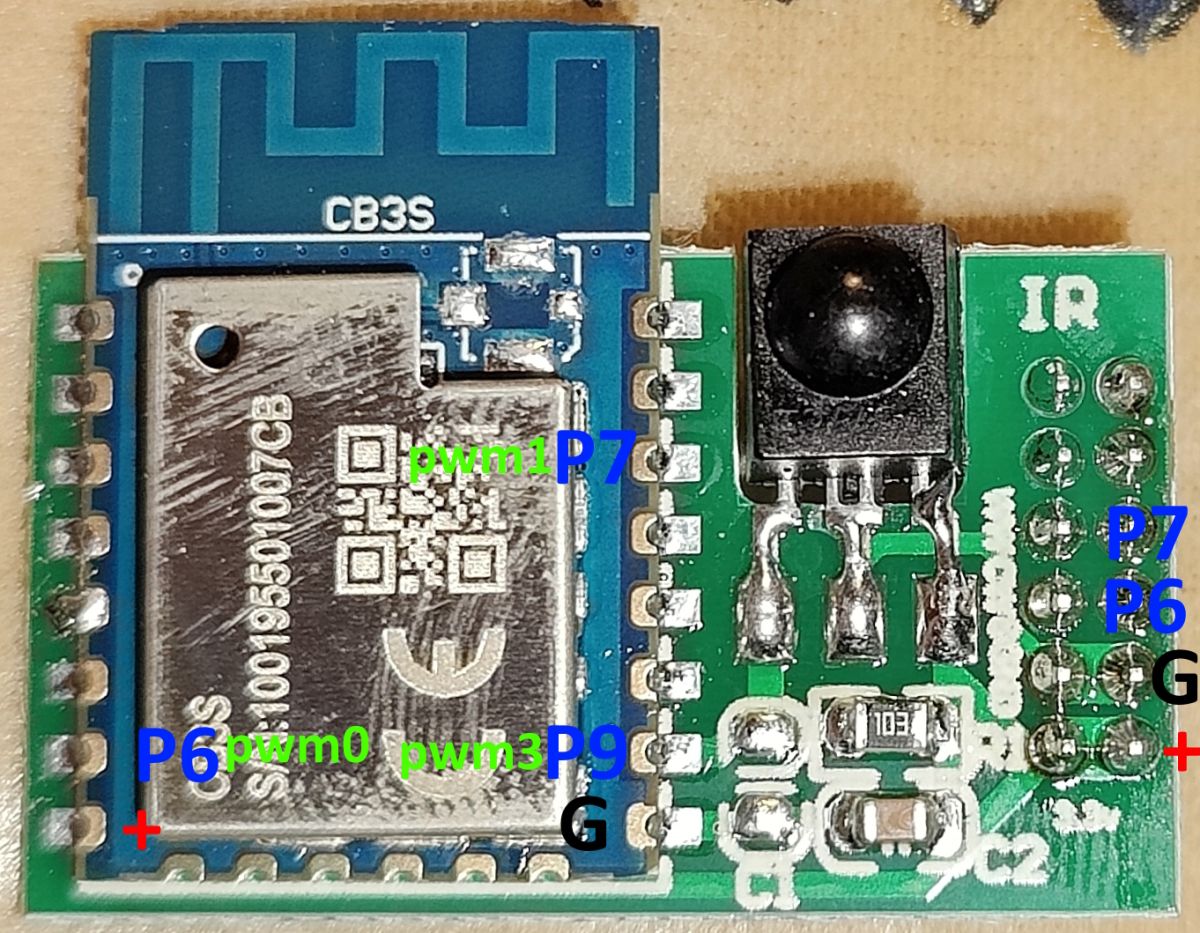

    I have opened the lamp and taken some pictures.

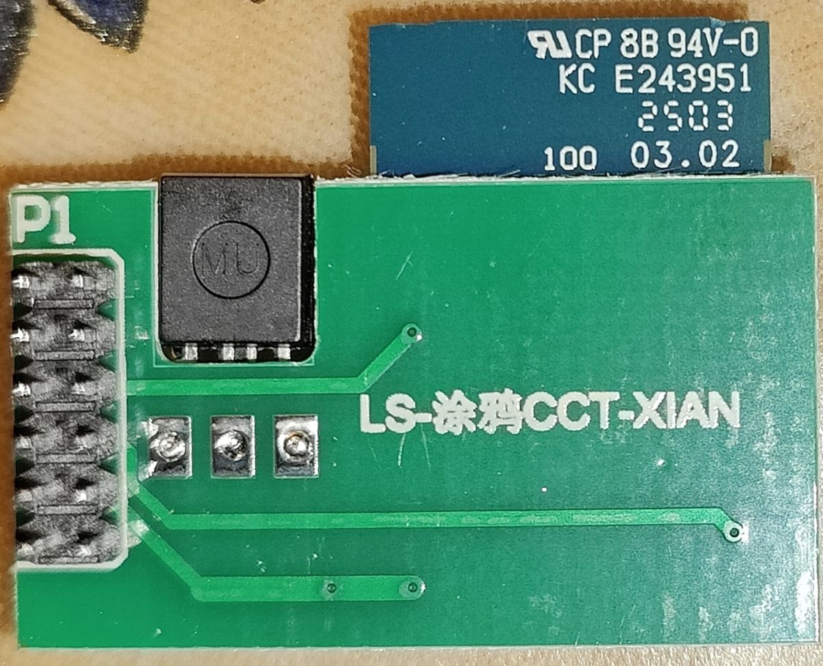

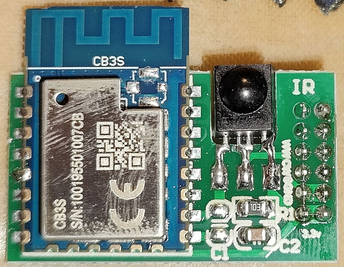

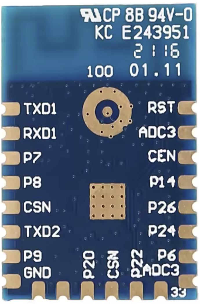

    The chip is CB3S and is mounted on a circuit board that can be easily removed. There is also an IR receiver on the small circuit board.

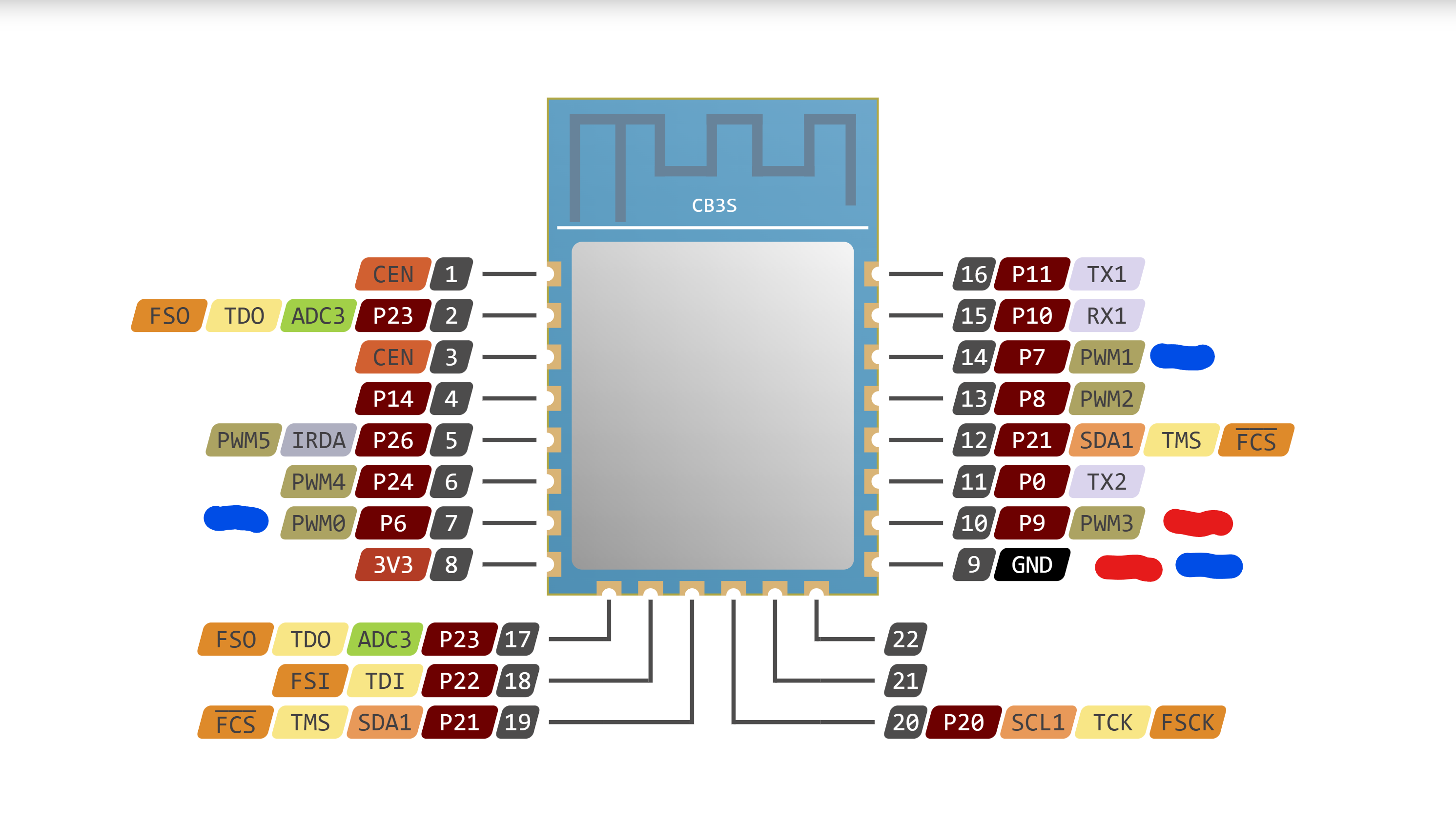

    From what I can see on the circuit board (I have not measured, only seen where the print paths go)
    The following pins are connected out from MCU to the large circuit board:
    3.3 V
    GND
    P6
    P7
    In addition, P9 is connected to one of the legs on the IR receiver. The other 2 legs on the IR receiver are connected to 3.3 V and GND.
    I have Homey Pro as the hub for my smart home. If possible I would like to be able to still integrate the lamp into Homey Pro, but the most important thing is that the lamp remembers the dim level from the last time it was on and that the IR control works more responsively. The app is basically not that important.
    A possible alternative is to replace the MCU with ESP8266 or ESP32-C6, but then I need to know a little more details about the original code so that I can write my own code to control the lamp. And the easiest thing would probably be to make my own custom circuit board.
    I appreciate input and guidance to make this lamp better.
