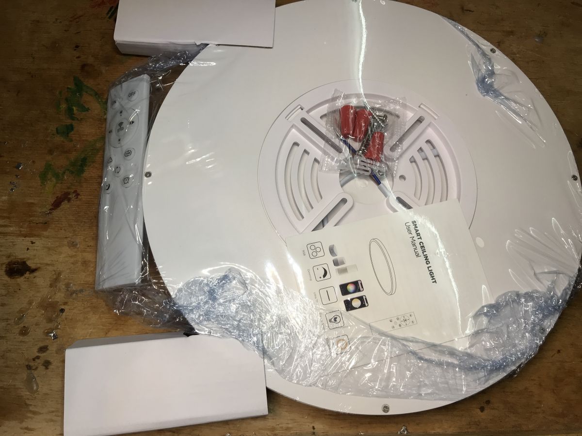

    Packaging:
    Packaging of Tuya RGBCW smart ceiling light. Tuya ceiling lamp packaging with installation instructions.
    Contents, there are even screws:
    Flat Tuya RGBCW 30W ceiling light with accessories and manual on a wooden surface.

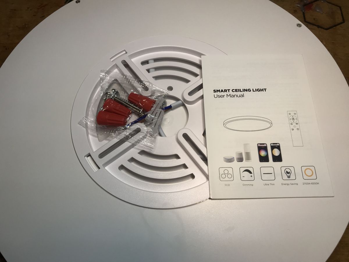

    Mounting:
    View of slim ceiling light with user manual and mounting kit.
    Instruction:
    User manual for a smart ceiling light with remote control. Ceiling lamp installation manual and accessories list.
    User manual for Tuya RGBCW 30W ceiling light. Internal brochure with setup instructions for Tuya smart ceiling light using a mobile app and voice assistants. User manual for Tuya ceiling lamp with setup instructions for Amazon Alexa and Google Assistant.

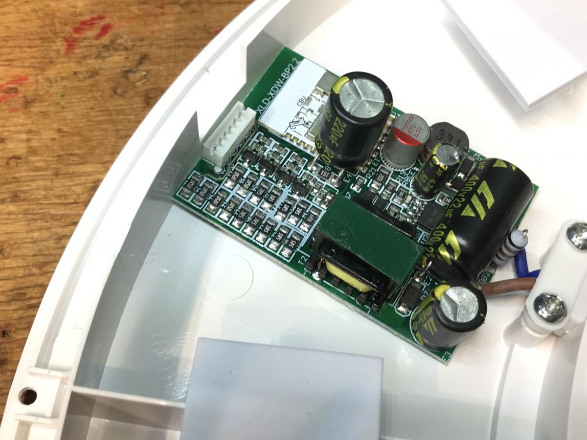

    Interior A228903

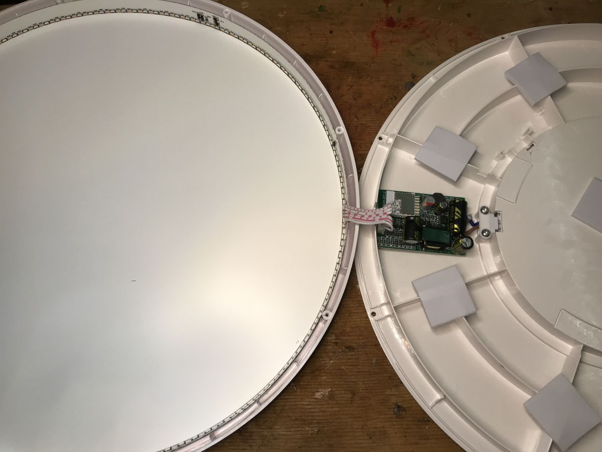

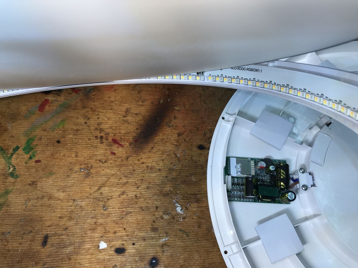

    Unscrew the screws and remove the cover:
    Interior of the Tuya RGBCW 30W ceiling light with visible WiFi module CBU.
    The layout inside is very small. I see the WiFi CBU module there, i.e. BK7231N.
    Disassembled ceiling lamp with visible interior and arranged LED lights.

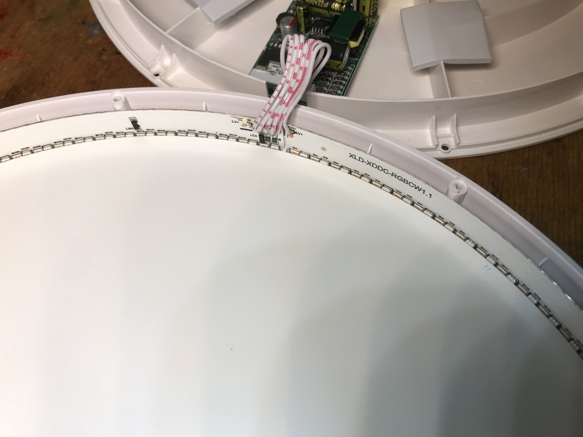

    The LEDs are arranged in a ring:
    Interior of a ceiling lamp with visible electronic components and LED array in a ring.

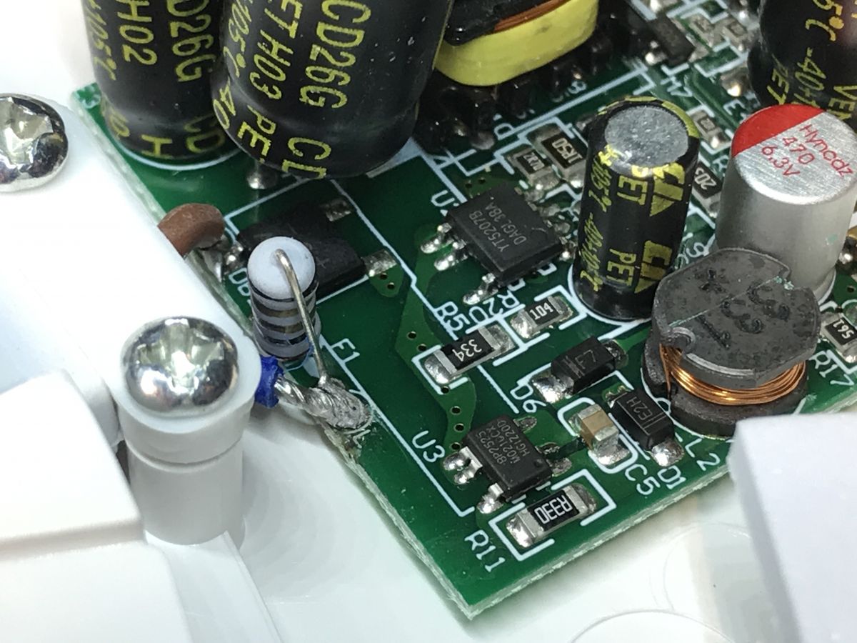

    And here is the module itself, along with the LED control transistors and the power supply itself:
    Interior of Tuya ceiling lamp with visible electronic circuitry.
    In the power supply section, you can see BP2525 (power supply for the WiFi module) and YT5207B (LED power supply) separately:
    Close-up of a circuit board with electronic components.

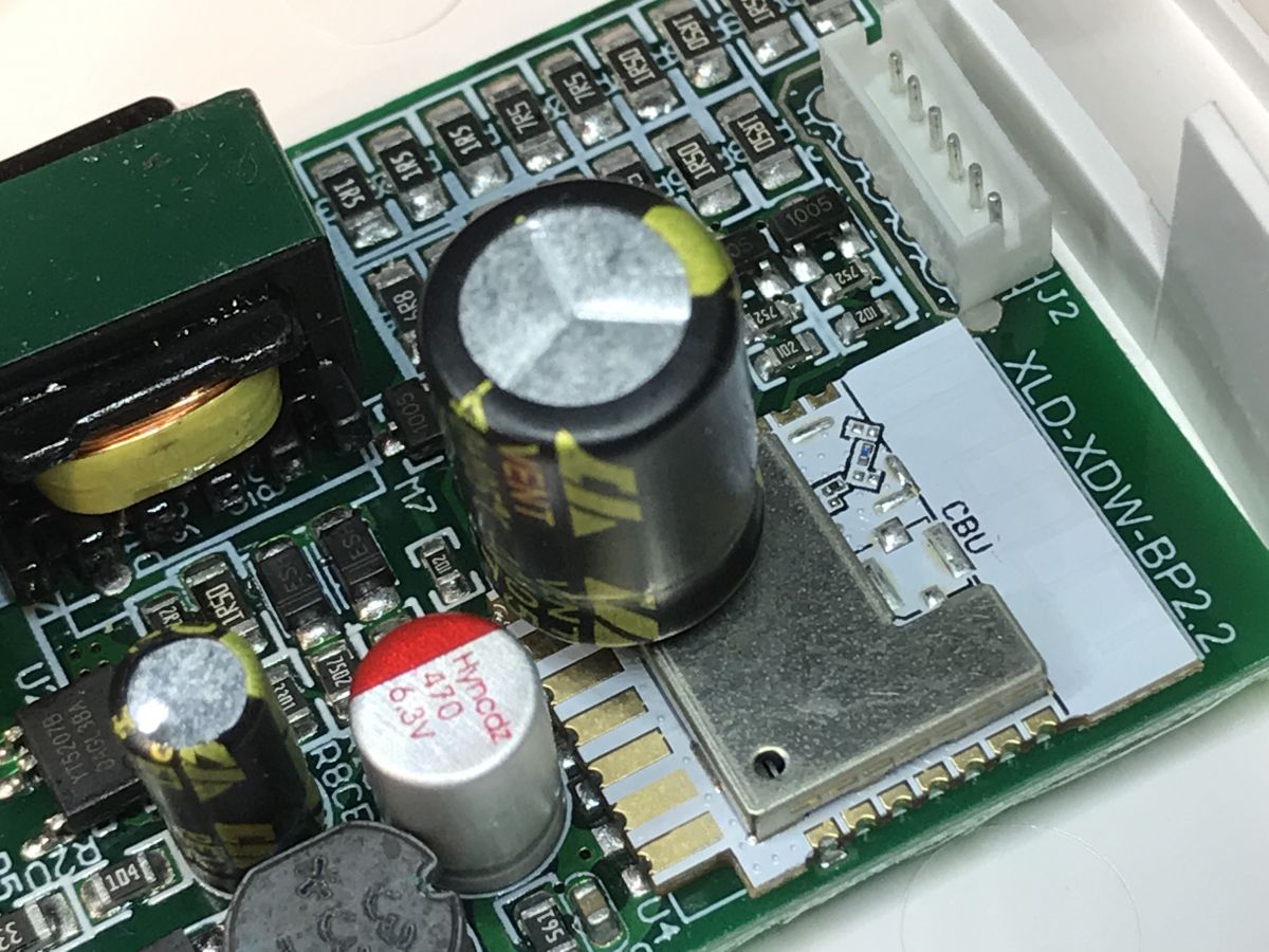

    And here we have the CBU itself:
    Close-up of a ceiling light electronic module with capacitors and CBU component.
    Pinouts: https://developer.tuya.com/en/docs/iot/cbu-module-datasheet?id=Ka07pykl5dk4u

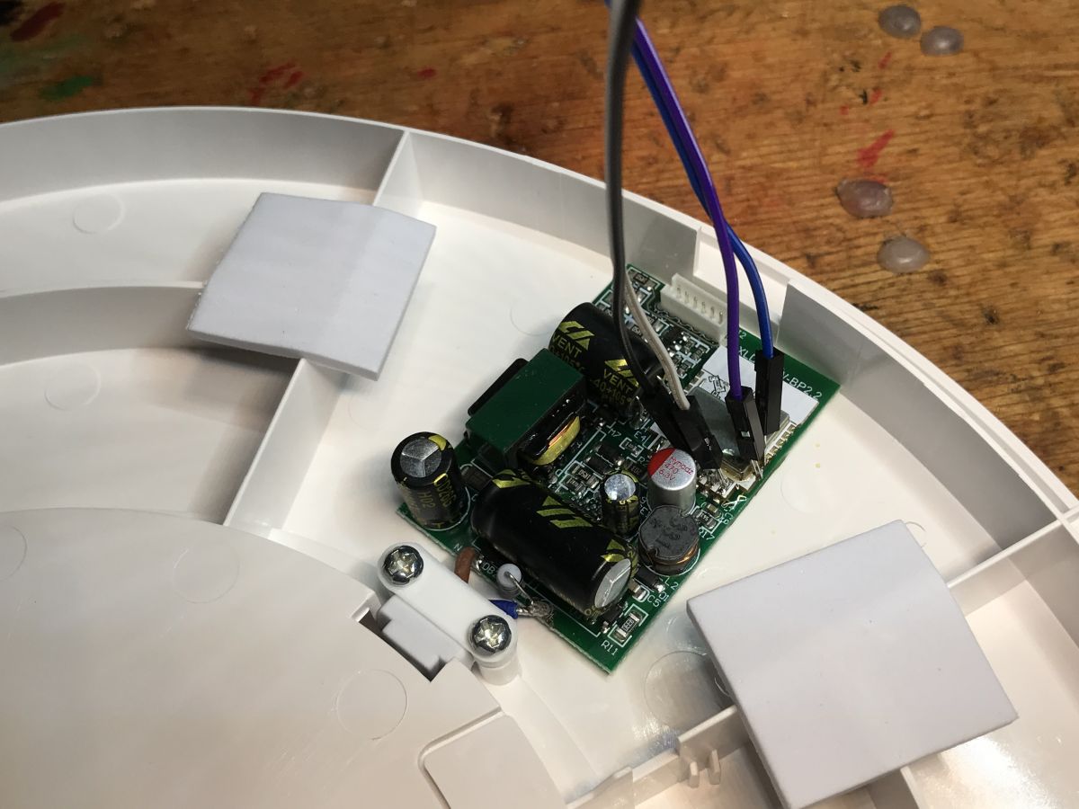

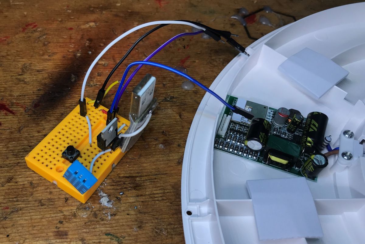

    Batch change A228903
    We connect the programmer as in the manual:
    On the Elektroda channel we have video presentations of this process, in the playlist of firmware changes, search for BK7231N:
    https://www.youtube.com/playlist?list=PLzbXEc2ebpH0CZDbczAXT94BuSGrd_GoM
    4 cables soldered:
    Ceiling light module with connected cables.
    Whole system:
    Connecting a programmer to the Graffiti Slim ceiling lamp.
    There is no problem with the template, there are PWM pins in the CBU:
    8	P8	I/O	Support hardware PWM (Correspond to Pin 24 of the IC)
    9	P7	I/O	Support hardware PWM (Correspond to Pin 23 of the IC)
    10	P6	I/O	Support hardware PWM (Correspond to Pin 22 of the IC)
    11	P26	I/O	Support hardware PWM (Correspond to Pin 15 of the IC)
    12	P24	I/O	Support hardware PWM (Correspond to Pin 16 of the IC)

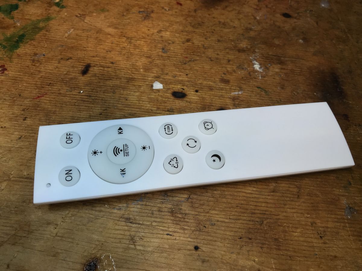

    Template:

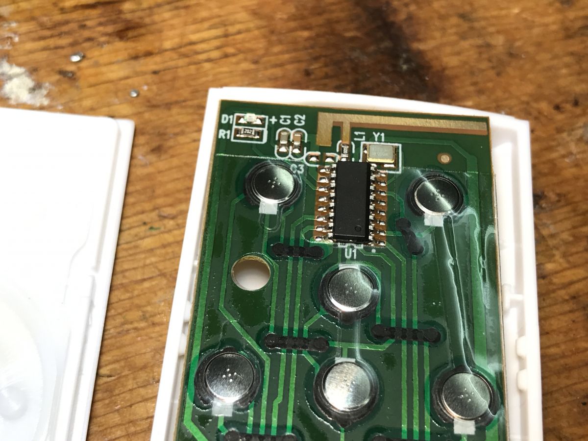

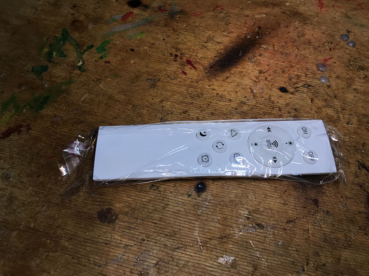

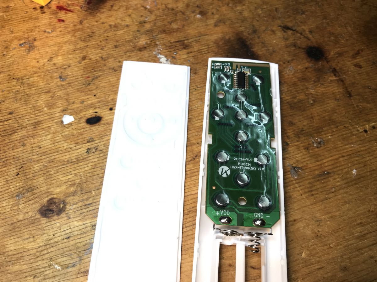

    Mysterious pilot...

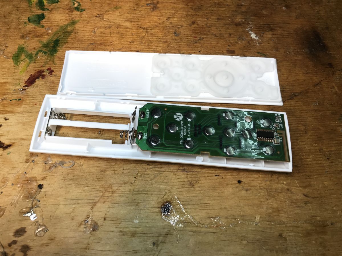

    At first I thought it was a remote control with RF 433MHz, but there is no indication of this. There is no such receiver on the PCB with the WiFi module:
    White remote control with several buttons lying on a wooden table.

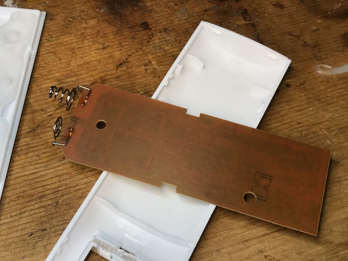

    The interior of the remote control looks a bit like an RF:
    Interior of a ceiling lamp remote on a wooden surface. Interior of the remote control with visible PCB and buttons. Close-up of a remote control circuit board with several buttons and an integrated circuit. Interior of a ceiling lamp remote control with PCB and springs.
    But there is no antenna on the PCB of the lamp.
    At this point, I suspect that it may be a situation similar to this topic:
    https://www.elektroda.com/rtvforum/topic4028226.html
    This remote may be Bluetooth-based in some form, but that`s just my guess. What do you think?

    The only problem is with this remote control - I don`t know how it works at the moment and adding its support will be at least very difficult. There is not even a starting point, you would need to check if there is any way to "intercept" their Bluetooth communication, if it is BT at all... so if we change the load, we lose the remote control for now. If anyone has an idea on how to go about it, I`m open to suggestions. I will have to try to finally get BT communication working on the BK7231. The pilot`s case is opened and will be continued...
