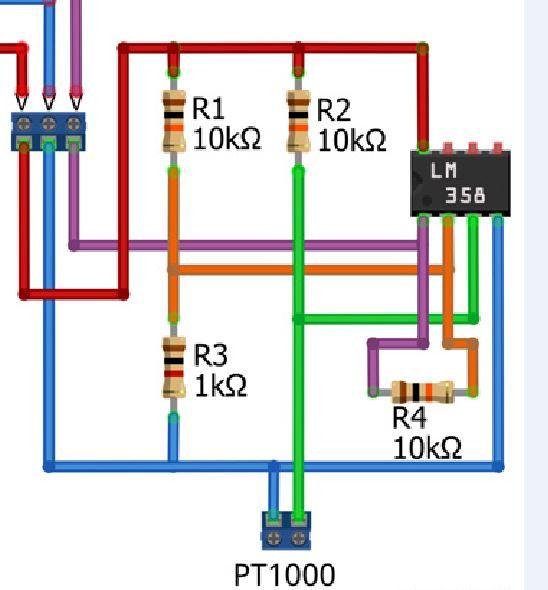

Why does my PT1000 thermometer built with an LM358 only reach about 144°C, and how can I extend the measurable range?
The LM358 output swing is likely the limiting factor, so the analogue stage stops before the full PT1000 range [#21749157] A practical fix was to reduce R4 to 5 kΩ and then rescale the reading in software; after recalibration, the PT1000 measurement range increased successfully [#21749586] [#21749587] If you want a cleaner RTD solution, several replies recommend replacing the LM358 front end with a MAX31865-based PT100/PT1000 module, which is made for this job and has ready-made libraries and examples [#21750183] [#21781376]

    And is it possible to connect an NTC10k Ohm sensor in this circuit ?
    Maybe some other resistor is needed ?

    >>21781026 I don't know why make life difficult for yourself with the LM358. If you want to use PT100 or better PT1000 then MAX31865 and you are done. On the other hand, NTC 5K, NTC10K thermistors (I checked personally) are supported by the MAX6682. They are easy to implement because of available libraries and lots of code examples in C/C++ and Arduino.

    because he bought it, soldered it and wanted to test it. Yes it is an imprecise circuit, but it also has its advantages and disadvantages like any circuit. The advantage of this circuit is that together with the ADS1115 I can connect 4 such sensors and their multiples because it works over i2C.
    The MAX31865 is accurate, I have it, but I have to order myself a pt100 for it and a resistor for the pt1000. Well, and these MAX31865 as I am not mistaken to one esp you can probably only connect one (CLK, SDO).
    You write about this Ma6682- on aliexpres I don't see such a ready-made module like the max31865, but you probably soldered something yourself- I have some NTC 10k sensors from a good company- dietrich uses them for heating, for buffers for example.
